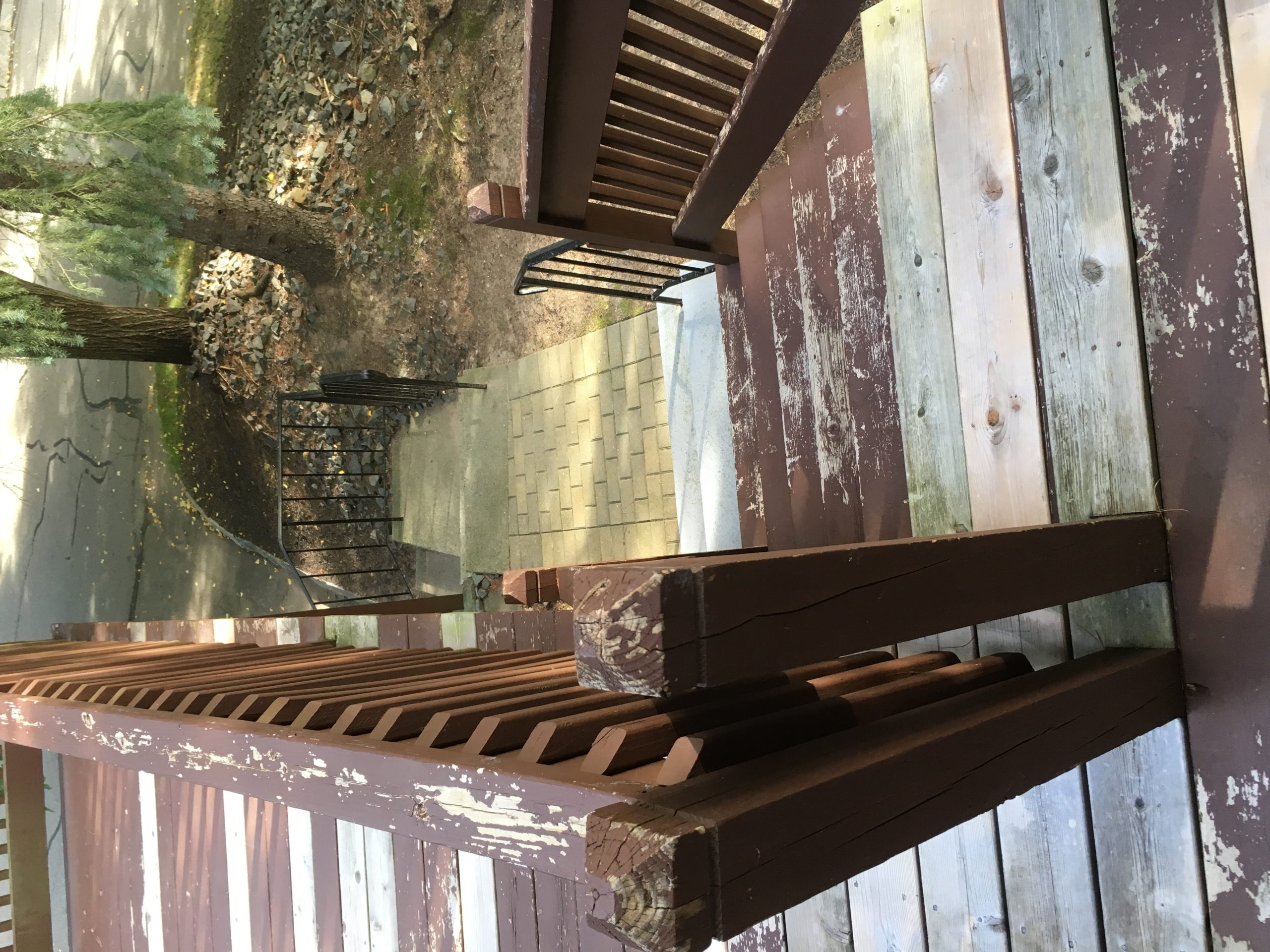

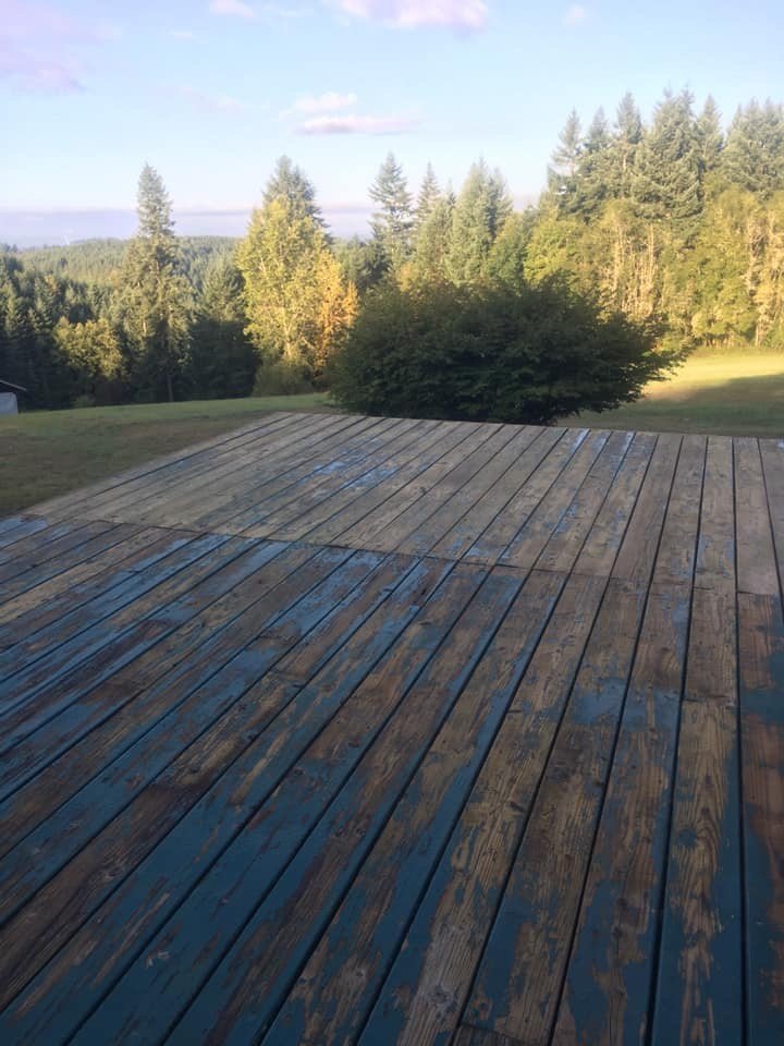

Okay I am the caretaker of my church they had a deck put in awhile ago it was 3 years later that I stained the deck right after the winter it started to peel then it was stained again right after winter it peeled again. How do I fix this so it won’t happen again
Post a picture. What stain brand and type did you use?
okay will do how do I post the picture
Click the picture icon and upload it from the computer.

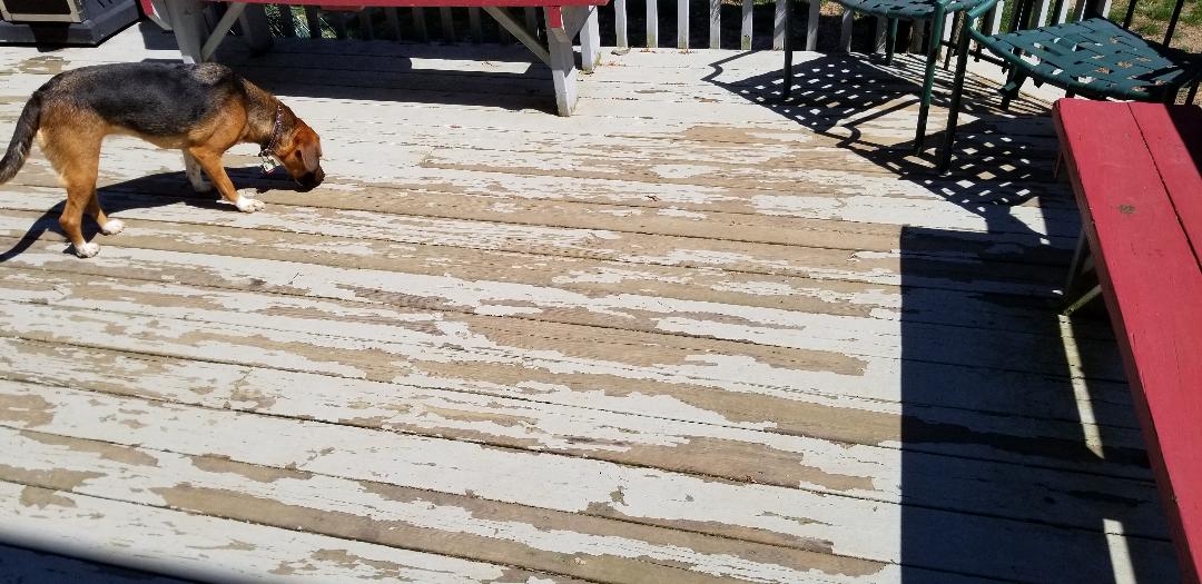

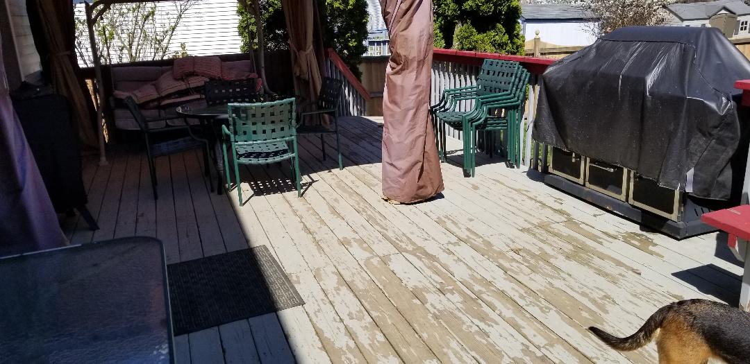

Here is a picture of the deck I was asking about it peels on floor boards and the hand rails any help would be great
Pressure wash for prep, let dry and spot sand any loose paint. Apply another coat of solid stain: https://www.deckstainhelp.com/what-are-the-best-solid-color-deck-stains/
Thank you do i use 60 grit 1st then 80 grit last how long do I let dry to stain
60-80. 48 hours to dry.
Do I use any type of deck wash or just pressure wash. Then I would sand do I need to wash down after I sand or just stain it. I hate asking all these question but it is becoming a pain doing this every year

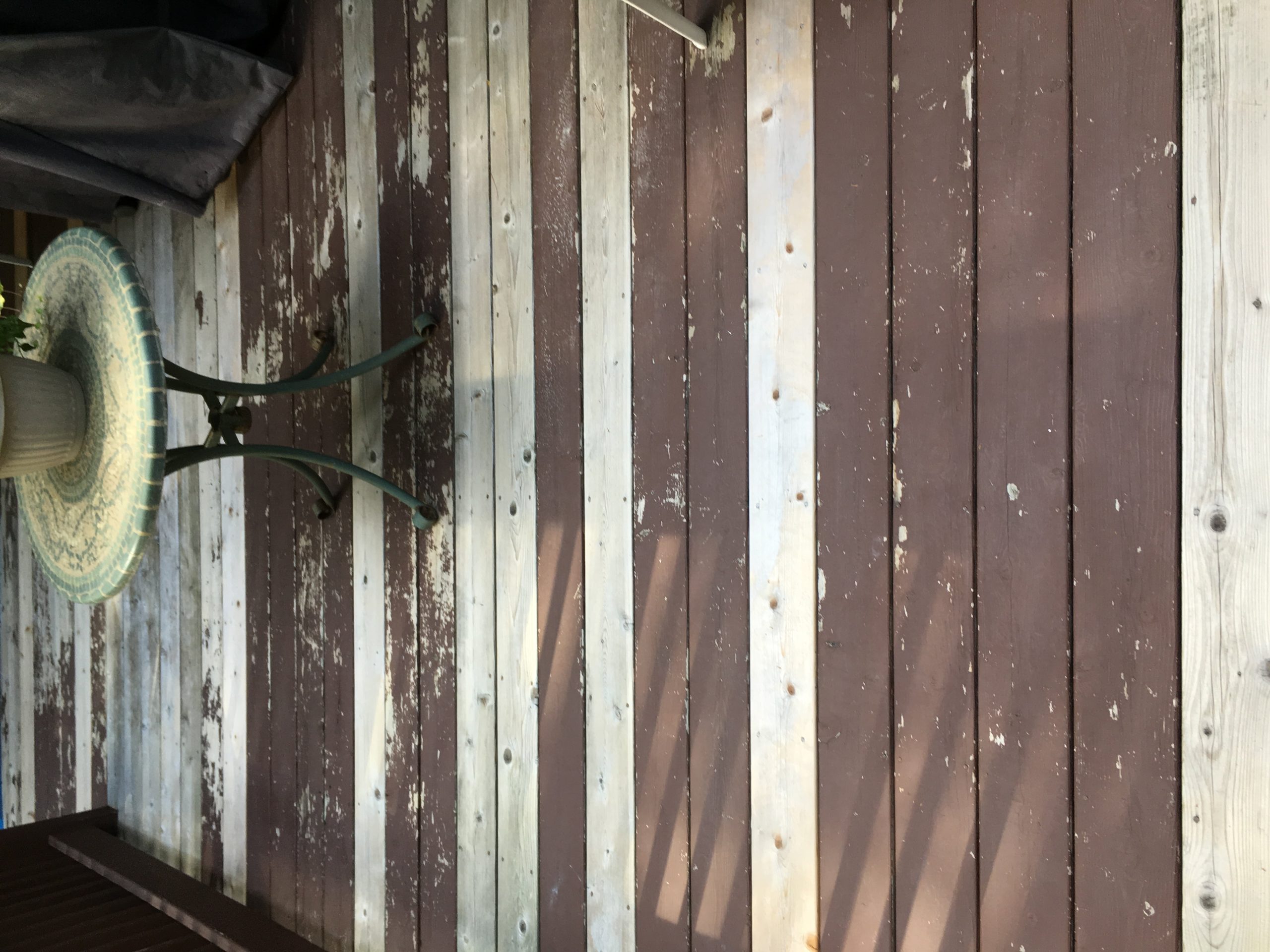

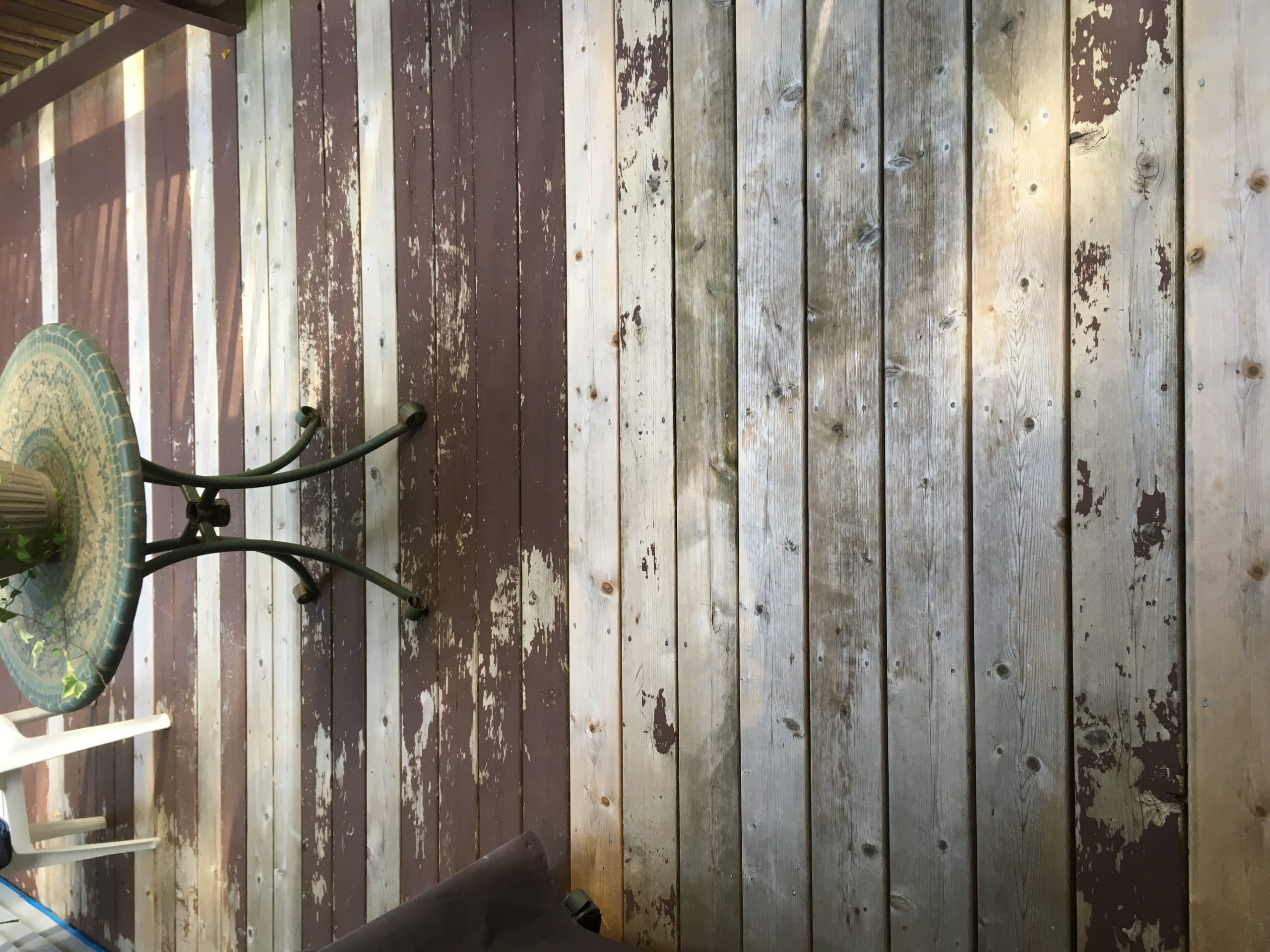

here is a picture on the deck I am having the problems with I don’t remember what stain and what it was stained with the 2nd time all I know the 1st time I got the stain at true value and the 2nd time was at Lowe’s
I hope you got the picture
