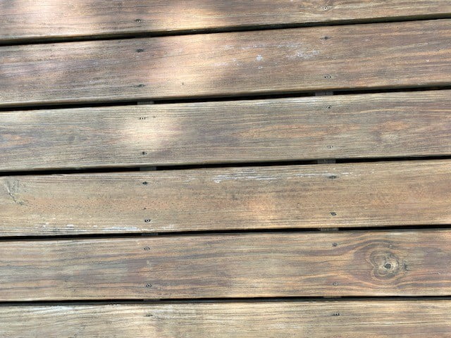

We purchased a home that is 4 years old with a deck that has semi transparent stain on it. There are many areas that have worn off of the deck floor . I planned on restaining and We purchased the exact brand, color, etc station that is already on the deck but I am now wondering, is this ok or must we first remove the old stain?
Varies based on how it has worn. Add some pics in the comments for more help.
Here are the pics. I think most of this is from the sun. (We live in the south).The was some wear when we moved in, but it has gotten worse and we really don’t use the deck a lot. Also the deck is on the west side of the house and within the grain some areas of the deck there are black areas that I am assuming is mold but I’m not sure. I have used deck wash on it before and it is better, but I can’t get all of it out. I have never used a pressure washer on it though.
The stain is currently on the deck is Valspar. Not sure if that’s a great brand or not. I also think that the previous owner applied to stain on pressure treated wood before it was ready. Just a suspicion.
Valspar is a poor stain brand, and instead of penetrating, it films on top of the wood. This is one reason why it has worn unevenly. It is also not truly semi-transparent, but more opaque. They lie about this in their description:
https://www.deckstainhelp.com/valspar-one-coat-stain-sealer-review/
You should fully remove it down to the bare wood and use a true penetrating semi-transparent stain, such as these:
