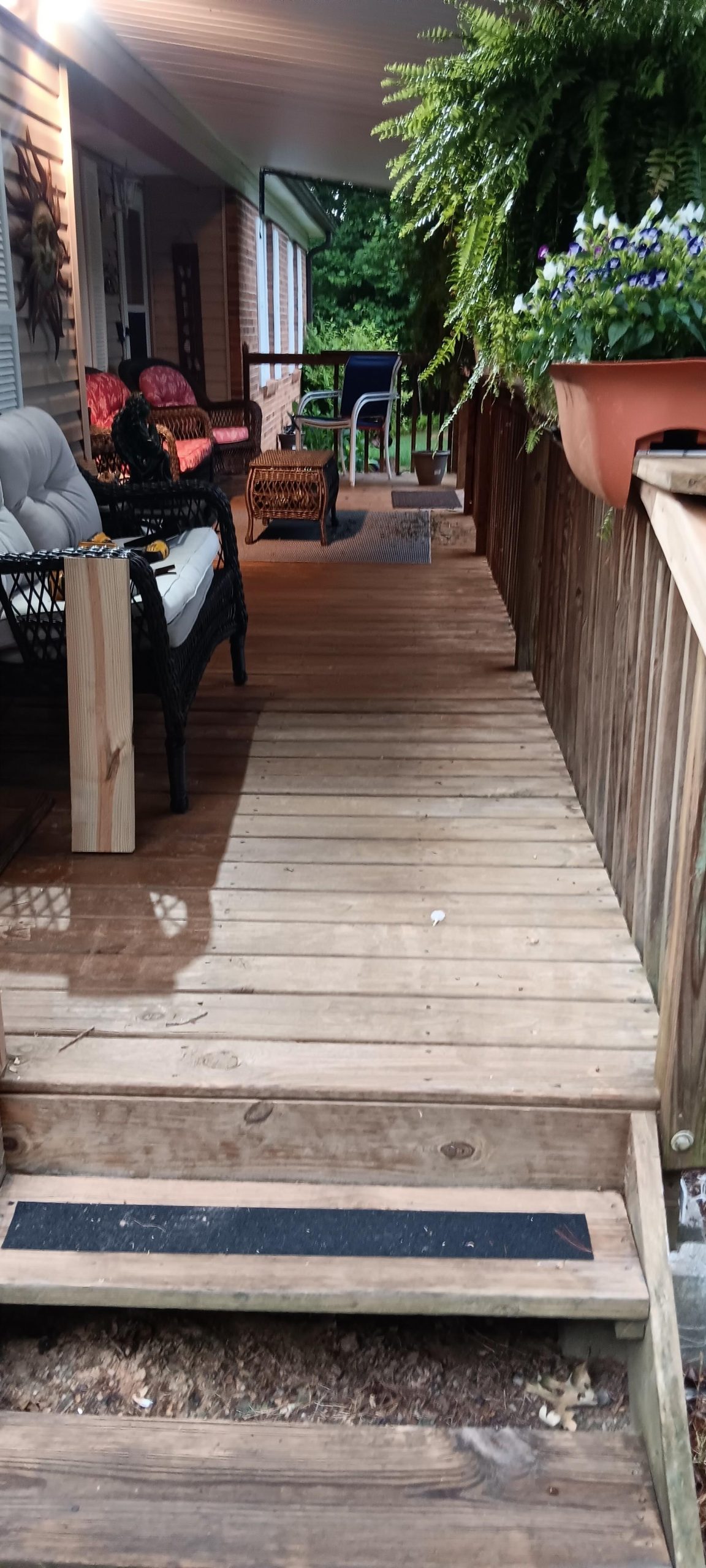

Hi Scott- Your articles are very helpful. I would appreciate advice on how best to prep and restain my deck this year so I don’t have to redo it every 2 years. I live in NYS Finger Lakes region so we have restrictions on product availability.
Made of New Wood or Older Wood? Pressure treated lumber and built 26 years ago.
Does the Deck have a Current Coating?
In 2020 I cleaned the deck with Armor deck cleaner and a power washer to remove dirt and some peeling stain. Then decided to
sand it to the bare wood with commercial floor and hand sanders. I did not use a brightener. In 2020 and again in 2022 (because it was wearing off) I stained with Benjamin Moore Arborcoat oil based Translucent (Natural) stain. In 2024 I restained with Cabot Australian Timber Oil Translucent (Jarrah Brown) oil based. Before staining I washed with water, Tide and a deck brush and let it dry a few days.
Prior to 2020 we used water based stains.
Are you Switching Brands of Deck Stain or Applying a Maintenance Coat of the same Brand and Color? That depends on your recommendation.
What is the Current Deck Stain Type? Oil based – Translucent
Mold or Mildew Issues? – No
Reason for Previous Stain Failure? –Not sure. It was peeling up in certain areas, moreso in the shady half than the half that gets more sun.
The spindles and vertical surfaces last several years. The floor and railing tops start to peel after about a year.
Photos- first one (with hose in upper corner) is before I power washed it. Other 3 photos are after I power washed it using only water to get peeling and loose stain off.
No stain will last longer than 2-3 years on a deck floor. Because of this, it is best to use a penetrating stain that can be cleaned and reapplied as needed. Stay away from any filming stains as they will continue to peel.

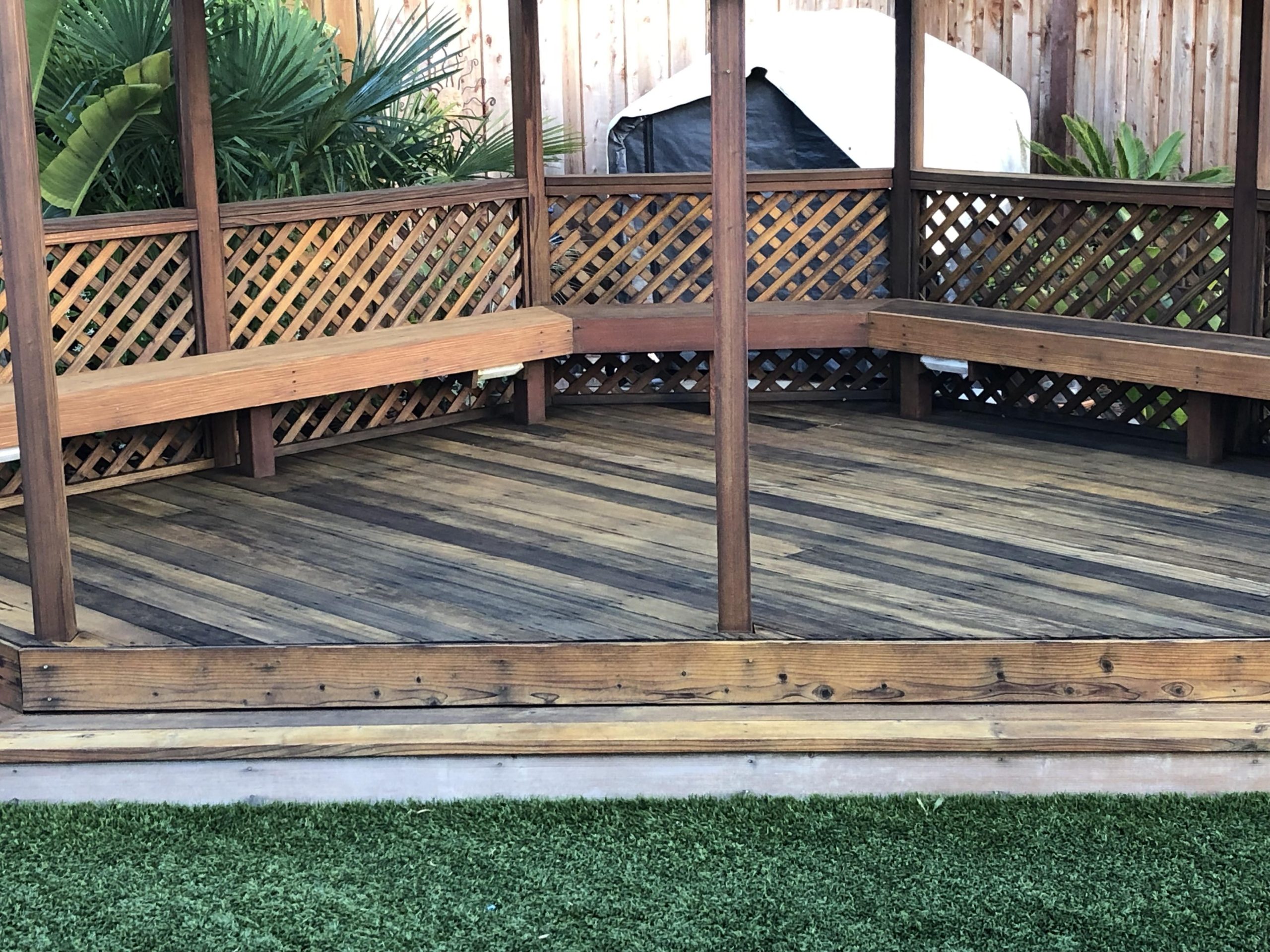

TWP – I hired a contractor to stain a gazebo and steps in my backyard. The gazebo has not been stained for at least 10 years. After the contractor stained the gazebo I noticed it looked very uneven. I pointed this out and they told me it was because some boards are more porous than others. I feel like they didn’t complete the correct prep. I’ve attached photos of before and after stain. The stain is TWP California Redwood. Any feedback you have would be great! I would like the gazebo stained correctly.
He’s correct. The wood itself is the issue, as it is older and very porous. In the darker areas, the wood is that way internally, and the TWP stains cannot make it lighter, nor would the prep.
Thank you. So even though I’ve read that if old boards are prepped properly they can stain, it’s not the case for all?
As we mentioned, it is internal disocloration. Prep cannot change or fix this.

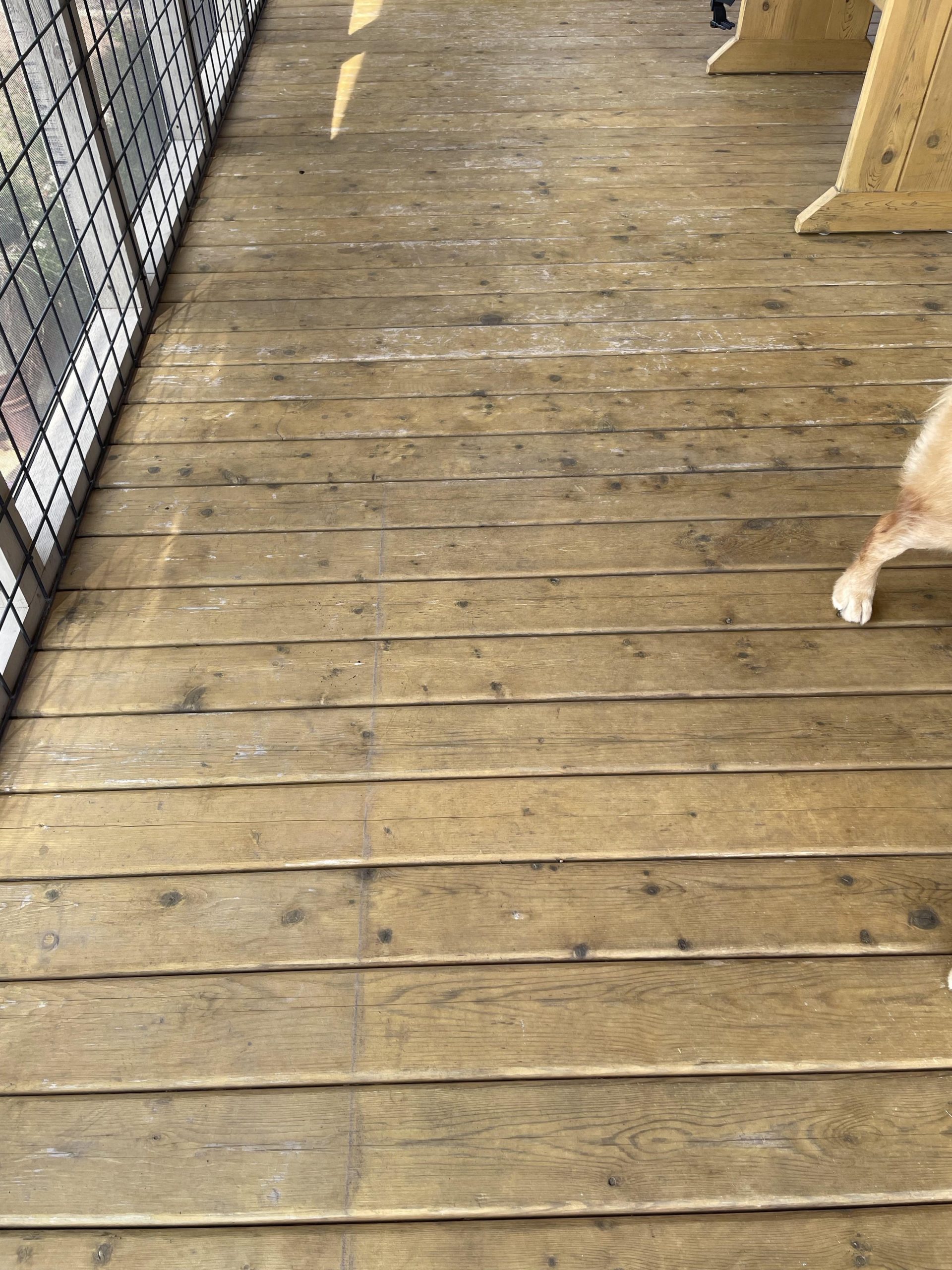

I have 8 year old cedar decks. 5 years ago, they were stained (poorly, not by me) with Sikkens. Looked terrible, I hate that stuff! We just finished sanding it all away—a big job, considering the main deck is covered. Unfortunately, it’s going to rain for the next 4 days. The forecast says we will get a week of dry weather after the rain.
We covered the railings with loose plastic. Will we need to re-sand everything? What will 4 days of rain do? Or can just move forward with allowing the deck to dry before we clean and brighten with RAD and then stain?
Additionally, I bought 2 stains just to make sure I had them—would you recommend RAD semi-transparent cedar or Armstrong-Clark semi-transparent cedar? I’m in the PNW.
No need to sand or cover. Rain will not harm anything. As for the stain, both the AC and RAD stains are very good. Only one coat of the stain since you sanded the wood.

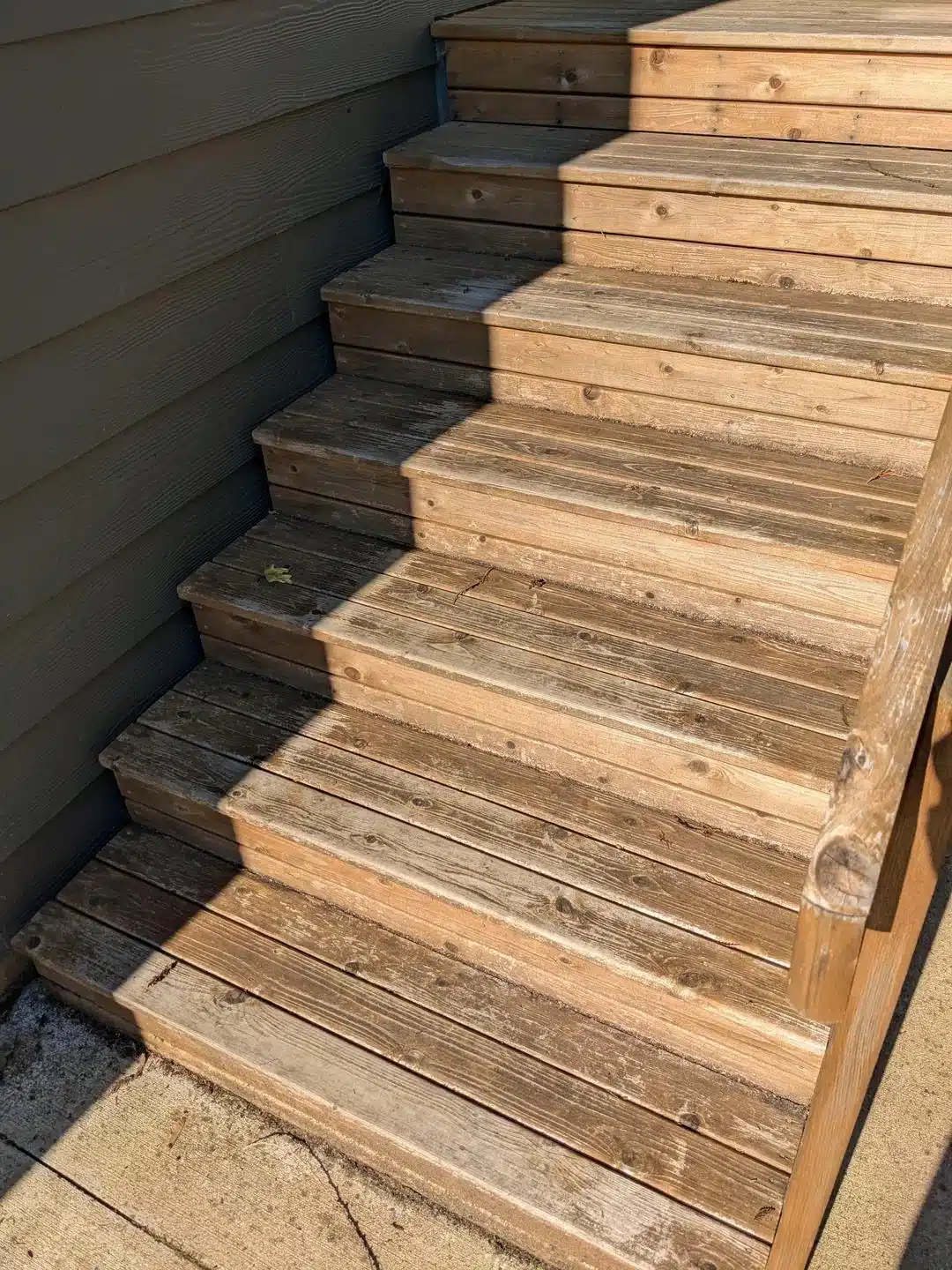

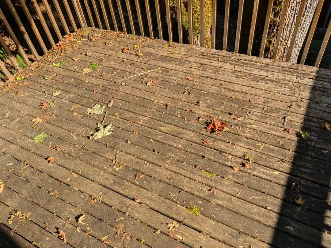

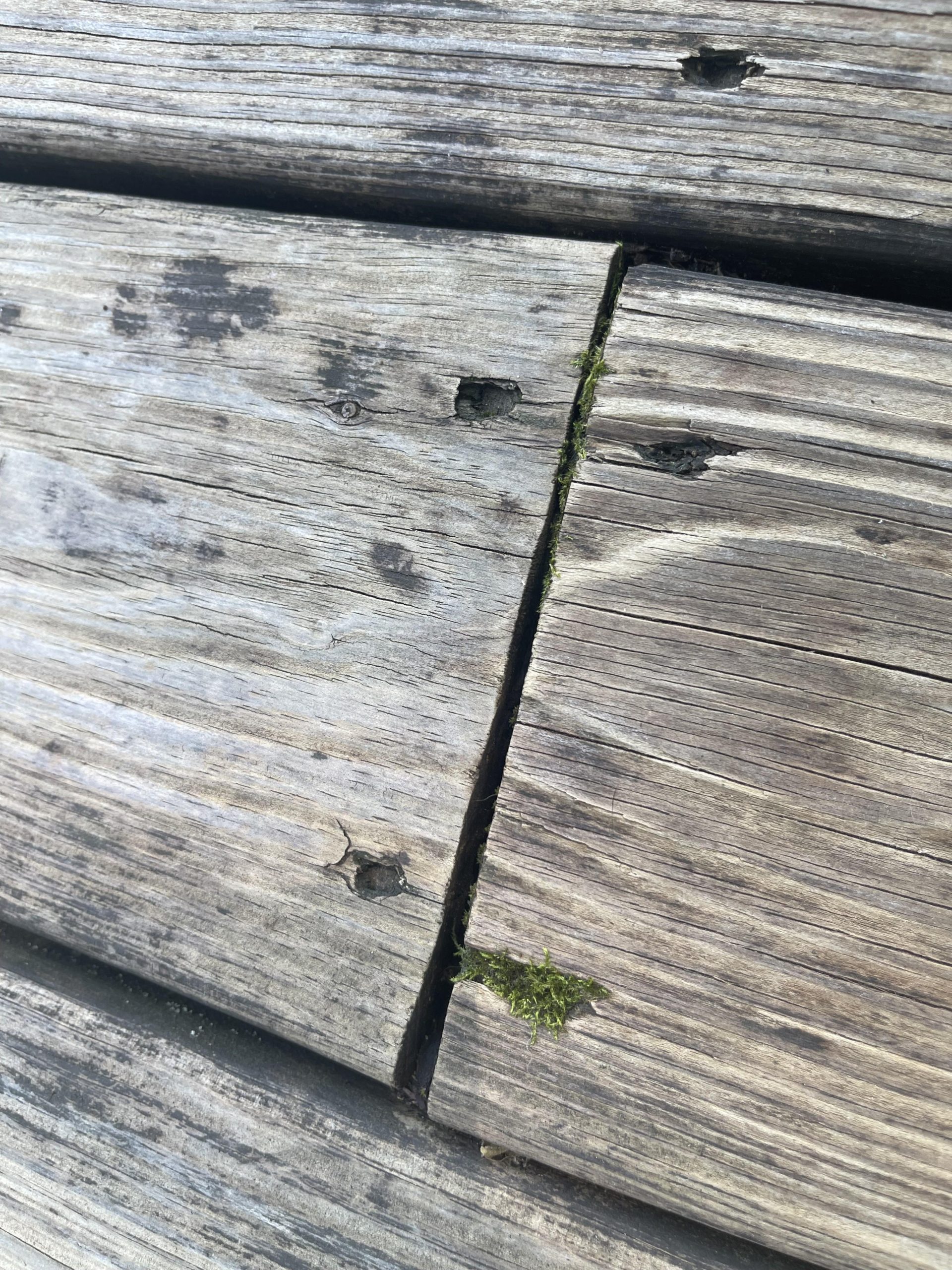

Should 10y/o PT decking (above ground rated) be cleaned + stripped + brightened or just cleaned + brightened? It was never stained or painted, it just has the original orange-colored ACQ PT coating that’s used in the West and PNW regions on it.
Add some pics in the comments.
Hopefully these pics work. None of the boards have been stained, they’re all above ground rated PT lumber but clearly not all the same age. My goal here is to try and get a more uniform appearance from the deck down to the dock and I’m not quite sure how to tackle the orange pressure treated wood.
Clean and brighten the gray flooring for prep. Strip and brighten the orange wood to remove as much of the factory coating as possible.
Strip and brighten for the prep. Look at this kit:

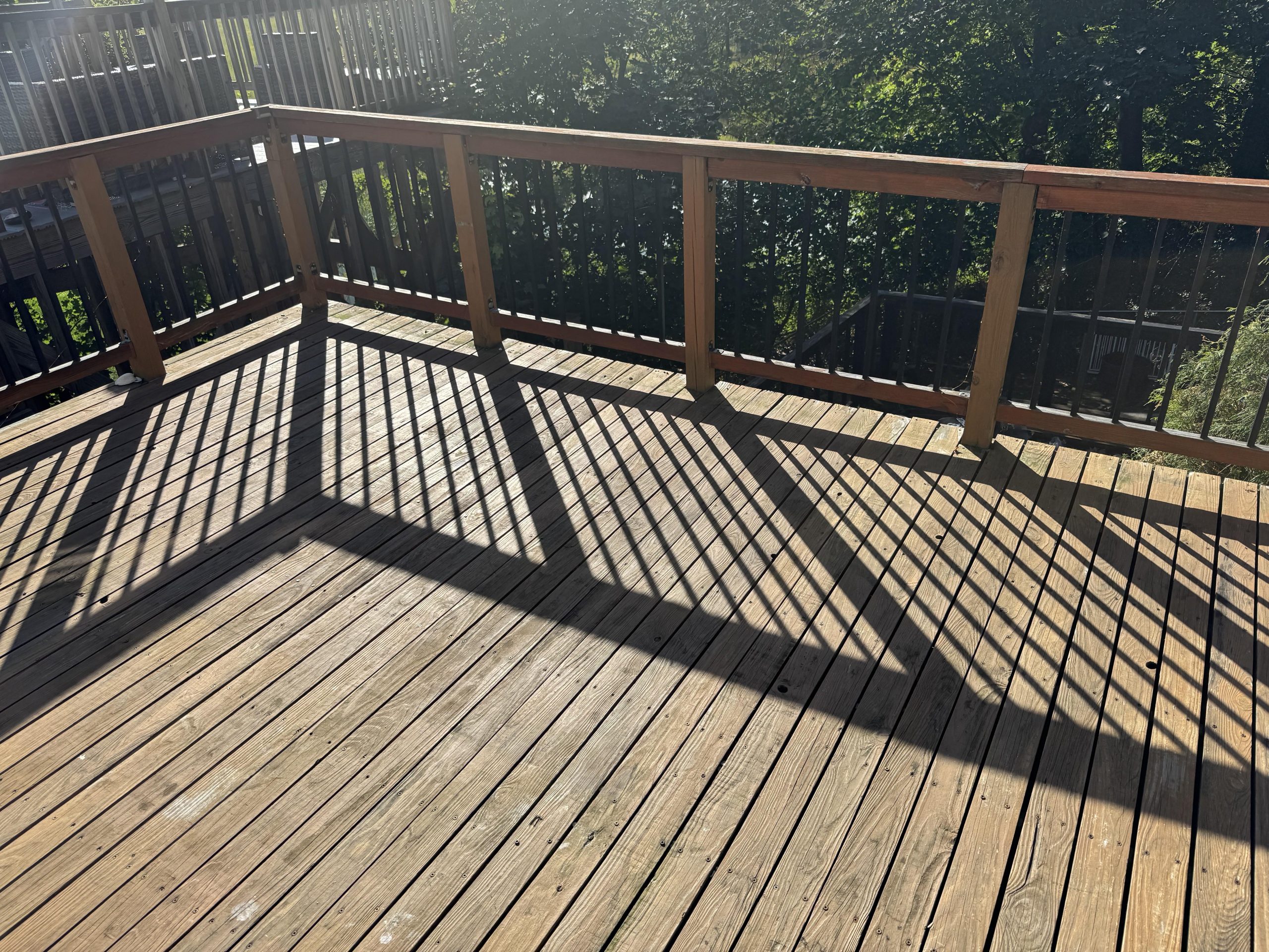

Hi, I’m looking to cover my old deck with Cabot Deck Correct, and mostly want to know if I need to remove all old solid stain. Wonder if you’ve had experience with this product. The facts:
Old PT wood.
Has some remaining solid stain after pressure washing.
Looking to cover old Behr Deck Plus solid color acrylic latex that is about 5 years old with a darker color Cabot Deck Correct.
There was mildew, but washed off fine.
Reason for failure was constantly changing NE weather, and age. Wood is at least 20 years old and looking to get another 2-3 years out of it before fully replacing. No rotting boards.
Photos show the cracks I’m looking to fill and mask with the Deck Correct. Some boards show the existing stain is pretty intact, these were boards protected by a roof overhang. The rest of the surfaces got about 75% cleaned of the stain after cleaning and pressure washing.
I don’t want to have a bad prep. I assume I need the RAD paints strip for the stubborn areas, but not looking forward to sanding.
We would not suggest the Cabot Deck Correct. It has very poor reviews from consumers on this site. Most deck resurface coatings do not work very well:
https://www.deckstainhelp.com/behr-deckover-olympic-rescue-it-rust-oleum-deck-restore-do-they-work/
As for removing all the current solid stain, it is best to follow the directions of the coating manufacturer you end up using.
For prep, use the Restore-A-Deck Stain Stripper with both gel and booster additives. Brightener would be last.

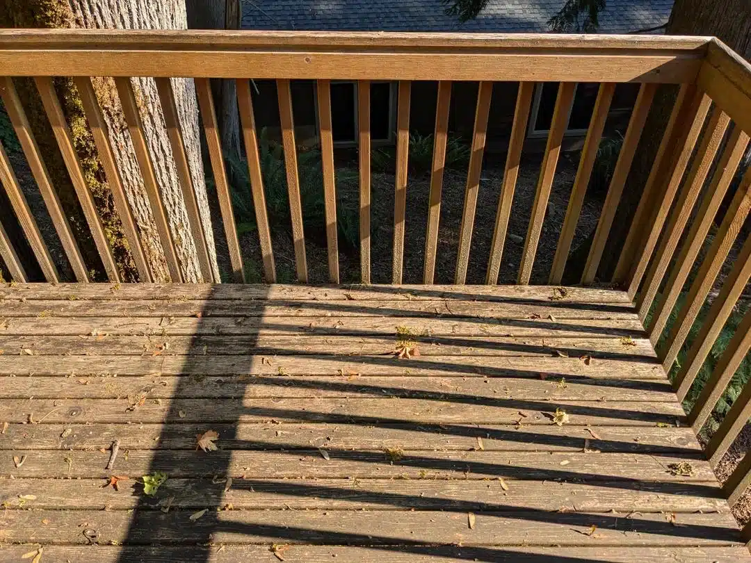

To strip off TWP stains, you would need this kit:
1. Old wood (~11 years), with exception of one railing 4×4 that had to be replaced.
2. No Current Coatings (waterproofing applied ~7-8 yrs ago)
3. N/A (no coatings)
4. No stains, unknown waterproofing brand.
5. No stains
6. Slight mold issues in nail holes/btwn planks, but mostly scrubbed off.
7. No stains used to date.
8. Pics, see attached (before/after scrubbing, mold).
Scott –
I’d love your advice, particularly after reading your deckover reviews (that’s out now!).
I’ve got a large pecan tree that looms over the deck, providing lots of shade, but also lots of dirt, leaves, pollen, and pecans that can stain. I’ve scrubbed the deck to get rid of the dirt, but haven’t used any cleaner or brightener yet. Goal is to coat (stain/paint) to blend/hide the stains, but also protect/extend the life of the deck.
Again, I’d love your input.
Prep with this kit while pressure washing:
Copy that.
Afterward, do you think I’m good with semi-transparent stain (following your two-toned article)?
Yes, it will look great!

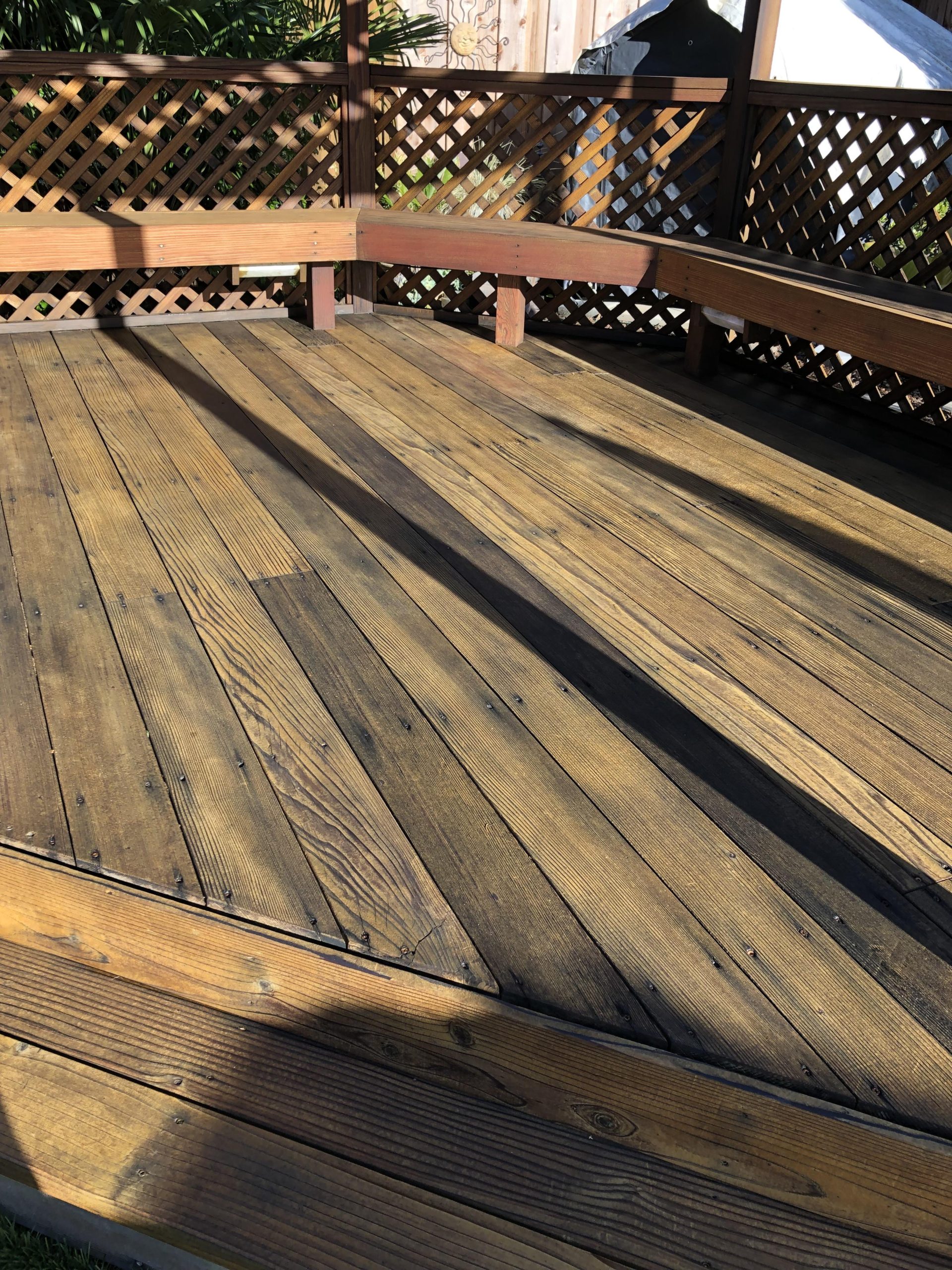

Two-toned tips:
As you can see with the attached pictures, our deck is large & not all uniform – mixture of old(original) boards w/ heavy solid stain (peeling up and can remove in large strips) new replacement boards on upper deck. Lower deck (pool) boards are only about 5-6 years old & need stripped & re-stained (solid stain)
I am trying to complete the full deck at one time – the refresh & uniformity of the solid stain. I did purchase an airless sprayer to utilize on the vertical boards. During my research I have learned that I will need to dilute the solid stain to go in sprayer & for the first coat on the new deck boards. I have deck cleaner, pressure washer & 5 gallons of the solid stain already.
Any time line or order of operations you recommend to make this as least stressful, cost effective and streamlined as possible will be greatly appreciated.
If you want to recoat with a solid stain, see here for prep tips:
Never dilute a solid stain. A solid stain can be easily applied with an airless sprayer without the need for dilution.
Behr Deckover has one of the worst ratings on our site:
https://www.deckstainhelp.com/behr-deckover-review-updated/
