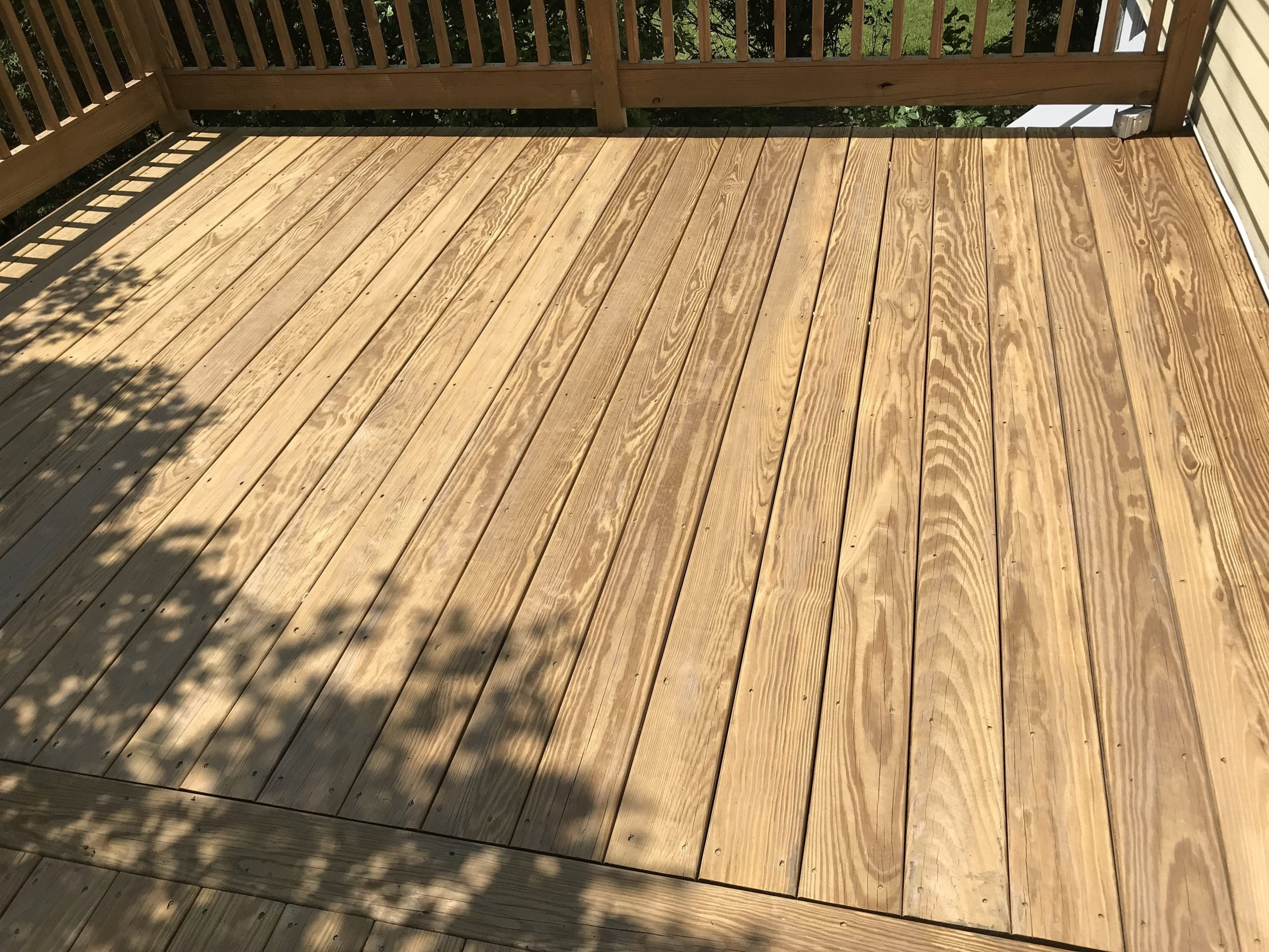

1. Older wood – believe 4 years old, mid-Indiana, partial shade all day.
2. Yes on most of deck: used Pittsburgh deck cleaner on whole deck followed by washing off with garden hose (don’t have power washer), power sanded with 50 grit belt sander deck surface and tops of rails. Posts, slats and cross boards on rails are still stained.
3. Intending to match color to what is still stained.
4. unknown
5. Believe it is semi-solid oil based
6. No mold/mildew, some algae
7. Sun/age, believe it hasn’t been re-stained since previous owner built deck 4 years ago.

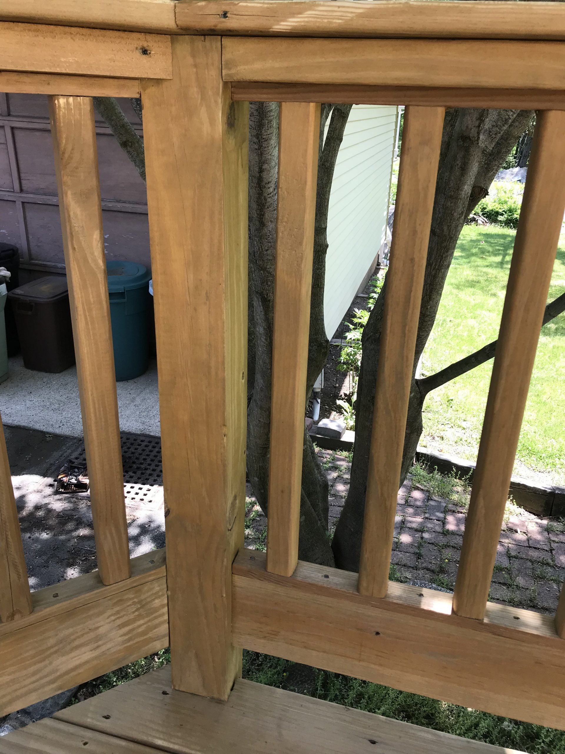

Additional questions, don’t think we need to re-stain the rails and posts yet, appear to be still in good condition. After power sanding to smooth off splintering there still appears to be some remnants of stain (nail heads tended to rip sanding belts 😩 so I mostly went around them). Is that going to be problematic? Wife wants to avoid using a stripper due to the chemicals around the kids and dog. Last, couple boards will need replacing, intending to used AC2 green treated. Will just need to let it weather till next year, then brighten and stain, right?

i powerwashed my deck (20 yo pressure treated wood) and then sanded by hand, orbital and big rental machine. I ordered some readyseal but now i’m thinking about getting a stripper and applying it to the deck just to be sure i get any old residule stain off. 2 concerns—1. it has rained since i’ve sanded…going on 2 weeks now…so after stripping will the wood be pourous enough to take a oil stain? 2. my power washer died on me…so will a garden hose with a nozzle generate enough psi to remove the stripper or should i go out and get a new pw? Thoughts please. thanks in advance. will upload pics shortly
Yes, strip and then brighten this.
1. Yes.
2. Get a new pressure washer. Hose will not work.
thank you—strip and brighten are two separate applications right?
Correct.

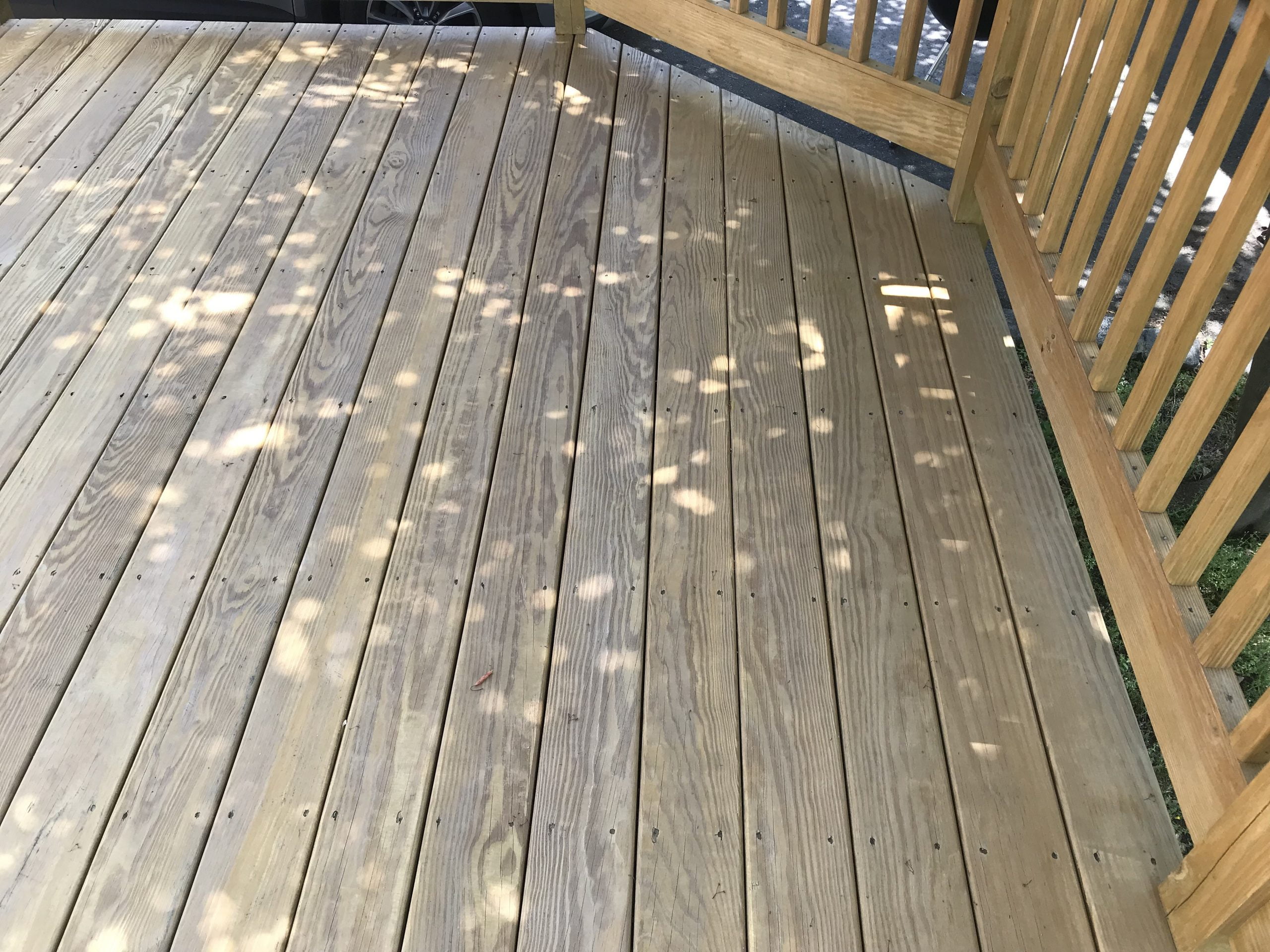

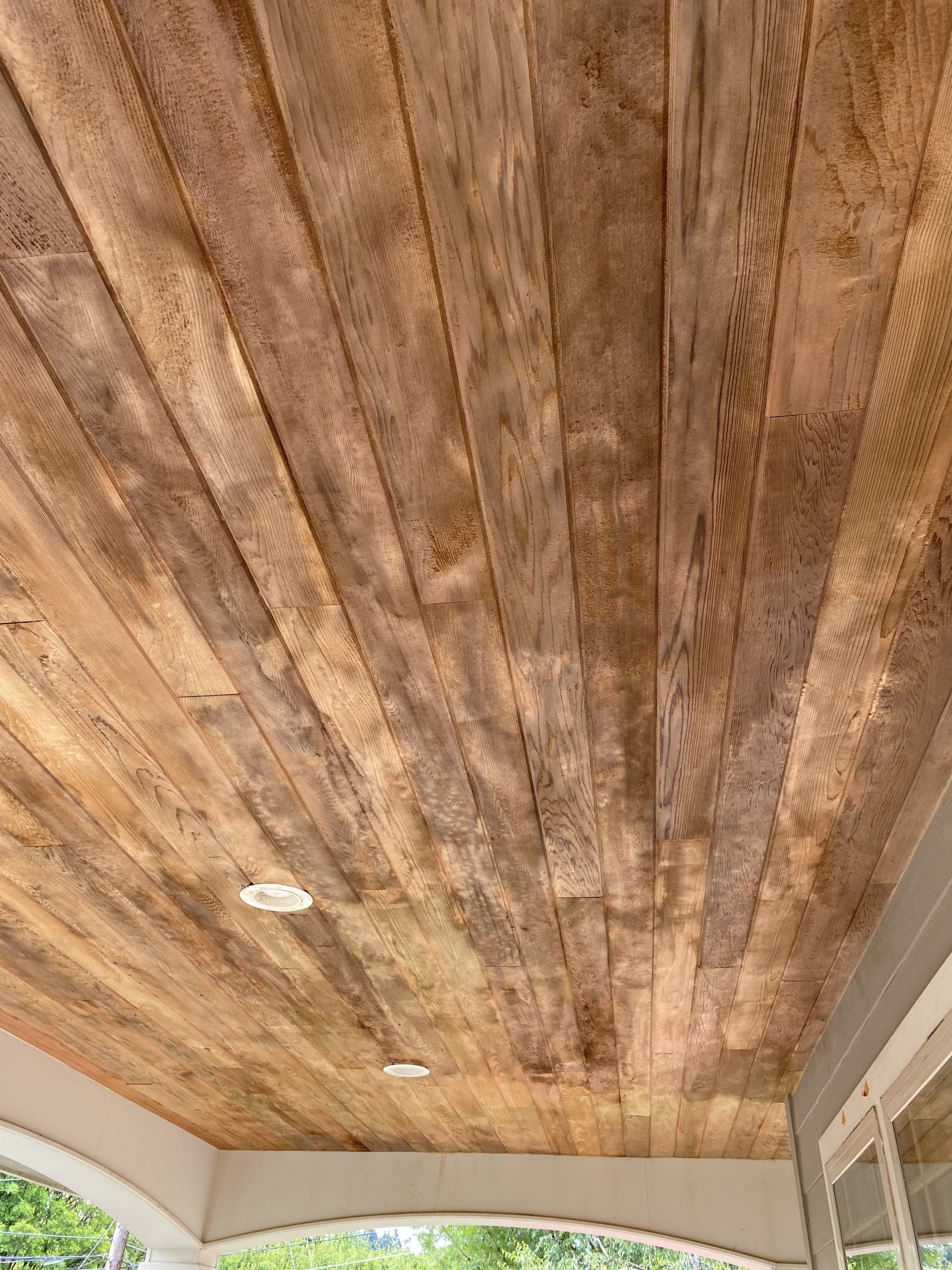

I just apply two coats of stain to my newly constructed deck. Allowed almost 3 months to dry out before I stained. I despise the color. What is the best method for me to start over?
New Wood or Older Wood? 2.5 months old
Does the Deck have a Current Coating? Yes
Are you Switching Brands of Deck Stain or Applying a Maintenance Coat of the same Brand and Color? No
Deck Stain Brand Previously Used? Enter “unknown” if you do not know. Behrs Premium semi-transparent
What is the Current Deck Stain Type? Oil-based or Water-Based? Clear, Transparent, Semi-Transparent, Semi-Solid, or Solid Stain? Semi transparent
Mold or Mildew Issues? No
Reason for Previous Stain Failure? It didn’t fall but I hate the color
You Must Include Picture(s) of the Current Condition.
You will have to power sand this off. Clean and brighten after. Stain with TWP or Armstrong Clark stains.

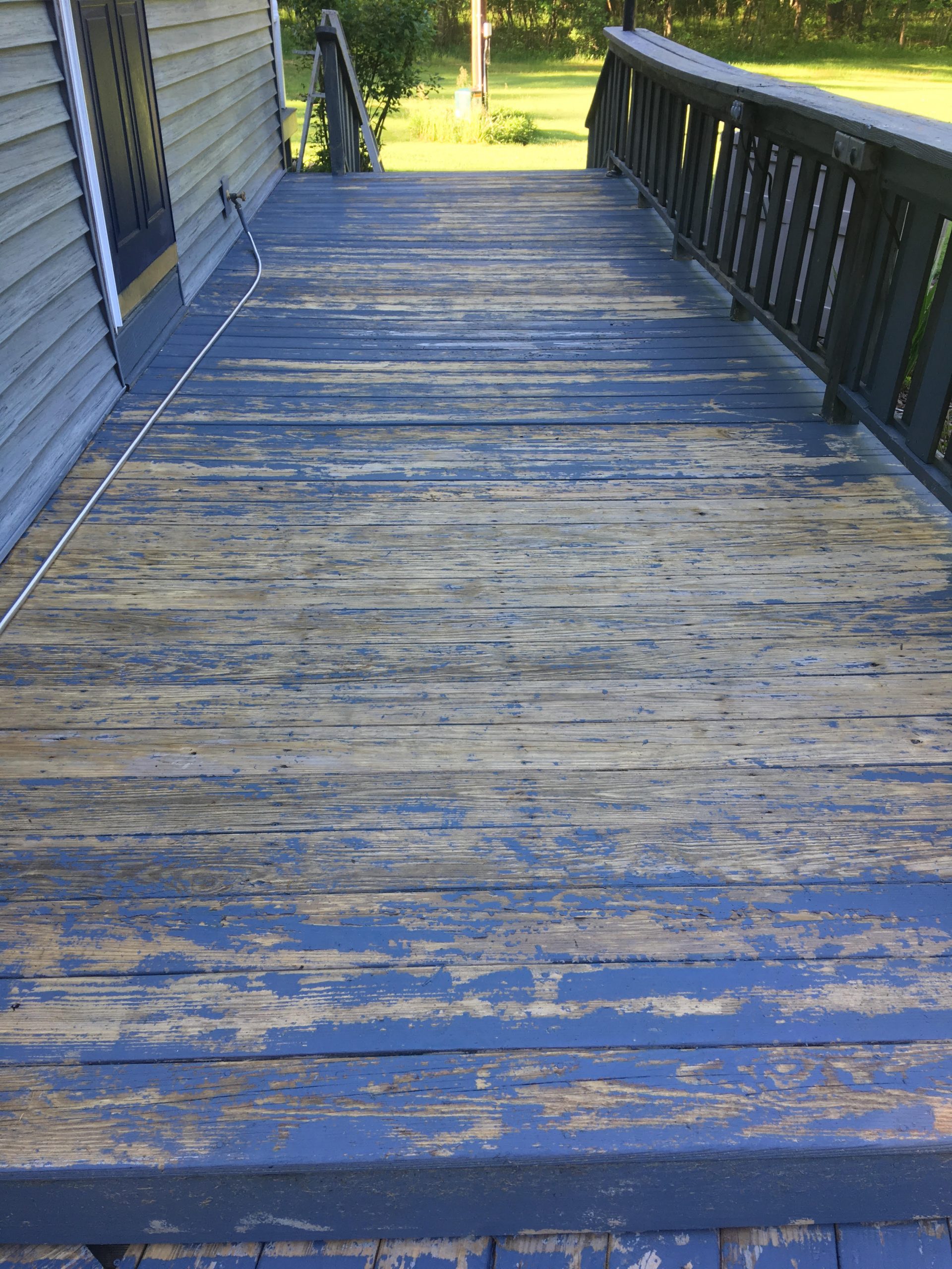

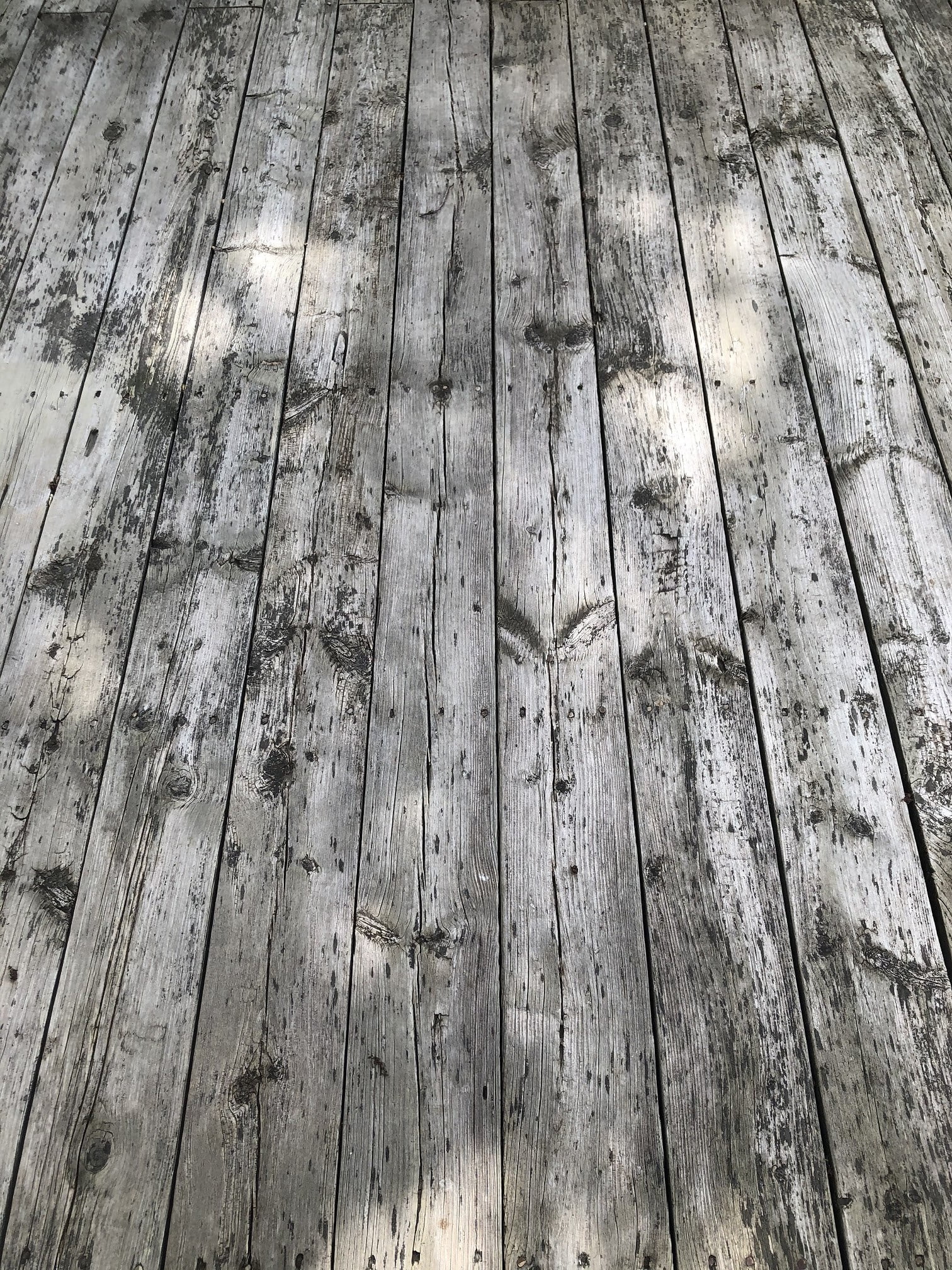

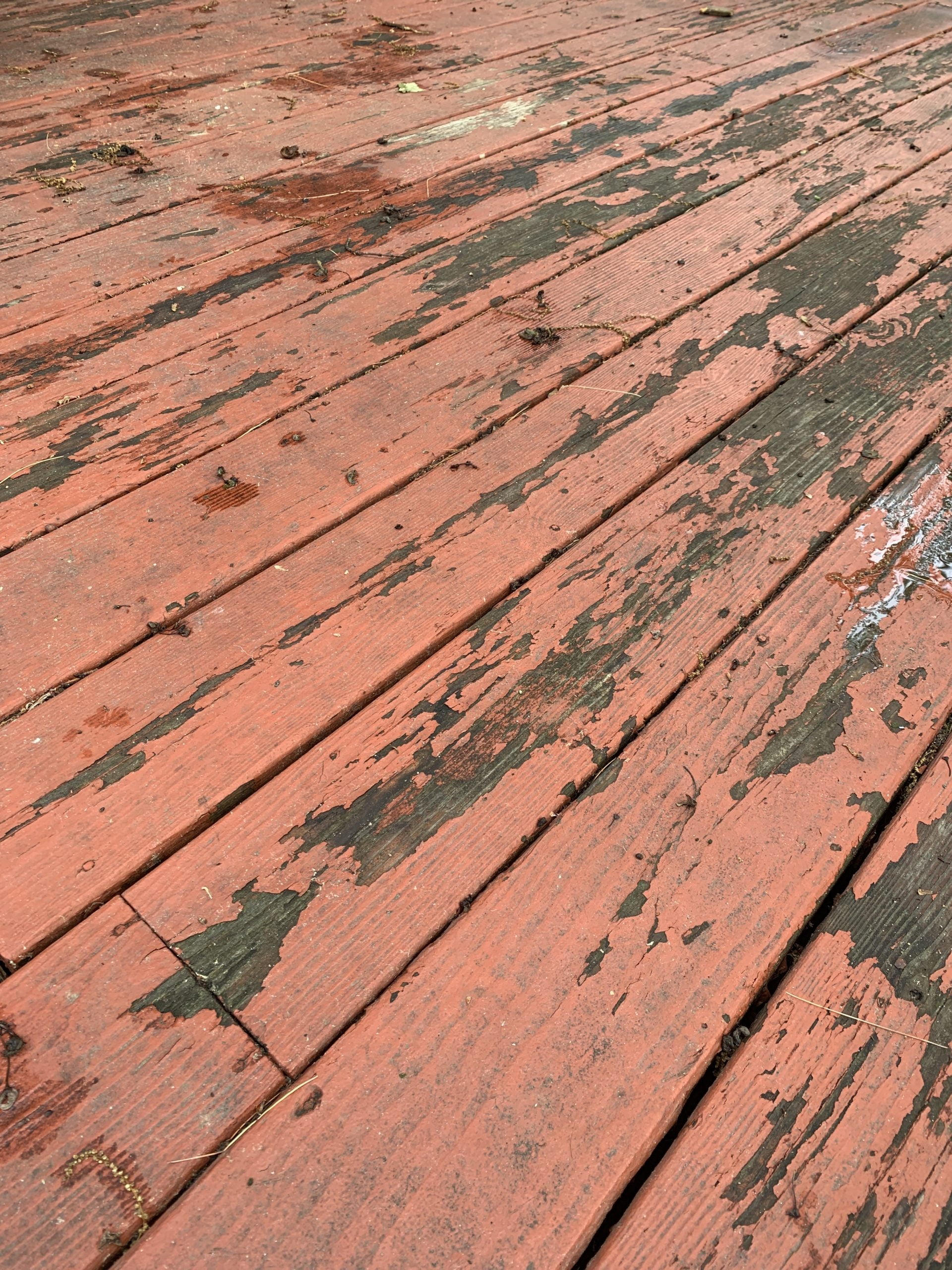

I’m looking for advice on what to do with a failed Fall 2019 stripping/stain job. I think I need to resurface. It’s a 20-year-old deck that hadn’t been maintained too well for the first 15 years. The Restore-a-Deck job took me weeks last year, including stripping and staining (that shows you the level of my inexperience). Now, I think I’d like to resurface, but my question is, do I need to re-strip or can I just clean and resurface? The manufacturers’ instructions on the resurface brands you recommend seem to indicate a complete stripping before applying the resurfacing. Do you agree? Thanks.
New Wood or Older Wood? Older – 1999
Does the Deck have a Current Coating? Yes – Poor result of Restore-a-Deck stain last fall
Are you Switching Brands of Deck Stain or Applying a Maintenance Coat of the same Brand and Color? Will switch to a resurfacer
Deck Stain Brand Previously Used? Enter “unknown” if you do not know. Restore-a-Deck
What is the Current Deck Stain Type? Oil-based or Water-Based? Clear, Transparent, Semi-Transparent, Semi-Solid, or Solid Stain? Semi-transparent, water-based. The stripper seemed to work very well – the deckboards showed just bare wood
Reason for Previous Stain Failure? Not sure. It was my first time. I had completely stripped the old deck covering, which probably hadn’t been stripped in many years. I stripped with Restore-a-Deck, brightened with Restore-a-Deck brightener, then stained with two coats. The result wasn’t that great in the Fall, when complete, and now, in the Spring, it’s just not a good job. Could be my fault
For the prep, you would have to strip off and neutralize. As for Deck Resurface brands, be careful as many are just really bad: https://www.deckstainhelp.com/behr-deckover-olympic-rescue-it-rust-oleum-deck-restore-do-they-work/
This is by far the best one: https://www.deckstainhelp.com/gulf-synthetics-deck-revive-review-2015/

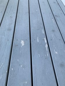

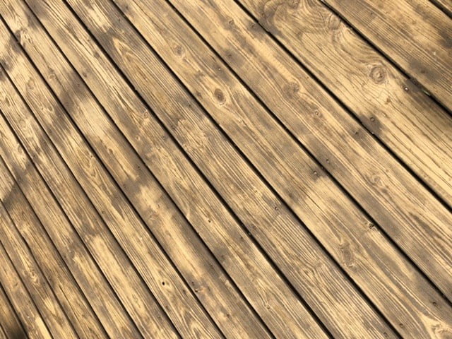

Hi… I power washed yesterday and it looks as if I’ve really messed it up with streaks. I only used water. We were wanting to do a maintenance strain.
1) Old wood that we bought Pre-stained but stained again when we installed 3 years ago.
2) current – acrylic oil semi transparent stain (Pittsburg Ultra)
3) want to stay with brand (Pittsburg Ultra) but do alkyd oil toner in a similar color. We could do the exact same Type & color as before just don’t care for the color.
4) there was minimal mildew. The stain had just worn in high traffic areas.
Thank you for the assist!
You will need a stripper and pressure wash again. Brightener after.

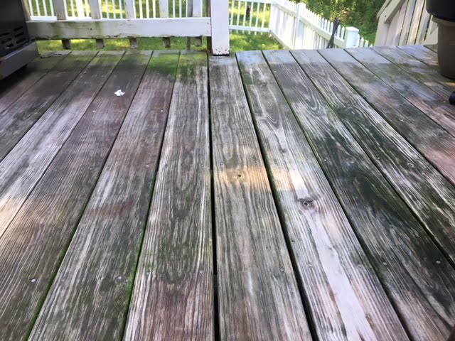

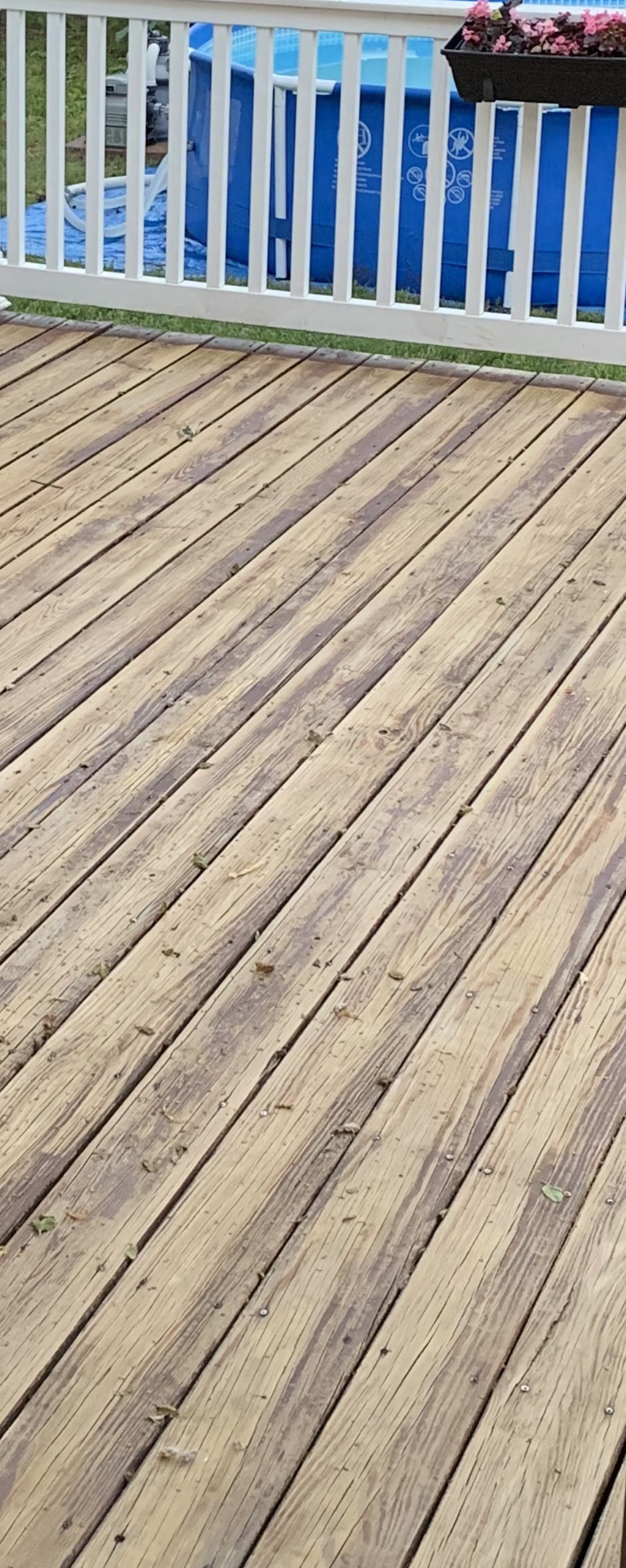

New Wood or Older Wood? Old wood
Does the Deck have a Current Coating? Had Deck Restore, scraped off, powerwashed, used deck cleaner
Deck Stain Brand Previously Used? Enter “unknown” if you do not know. unknown, believe mix of stain and deck restore
Mold or Mildew Issues? some green mld built up on wood.
Reason for Previous Stain Failure? unsure

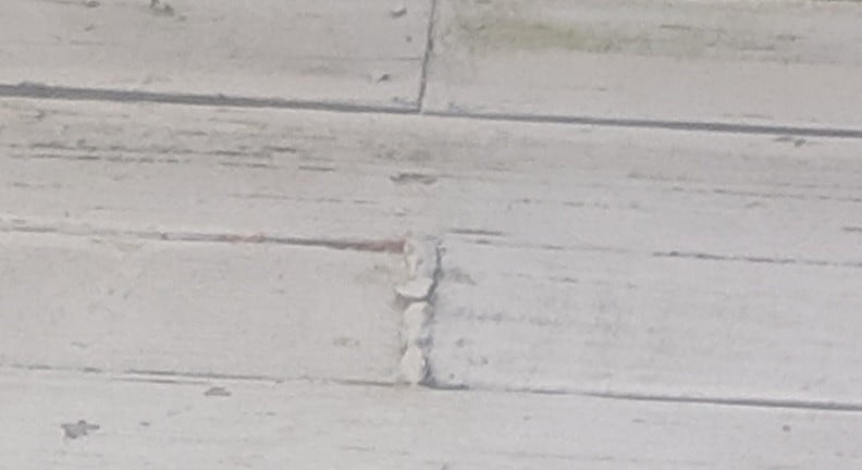

Summary: The previous owners of the house left the deck with patches of deck restore, stain, and bare wood. the bare wood has accumulated mold. We were able to slowly but surely get most of the grey deck restore off, or down to the grain. There are spots where it is embedded in the grain. There is now, after power washing several times and cleaning, still dark brown stain left over. Can we stain over this? I dont want it to show through. Whats the best next step?
Please see grey deck restore bits and dark brown stain in pics. (pics are post wash, still wet)
THANK YOU
Are you Switching Brands of Deck Stain or Applying a Maintenance Coat of the same Brand and Color? using olympic max stain and sealant in canyon brown.
What is the Current Deck Stain Type? Oil-based or Water-Based? Clear, Transparent, Semi-Transparent, Semi-Solid, or Solid Stain? -New stain transparent. Old stain solid, I think.
You cannot cover over the Rust-oleum Deck Restore so you will need to get it all off. Try power sanding to remove.
Thank you! What about the other stain that isnt deck restore? The dark brown parts?
Still need to sand or remove off fully.

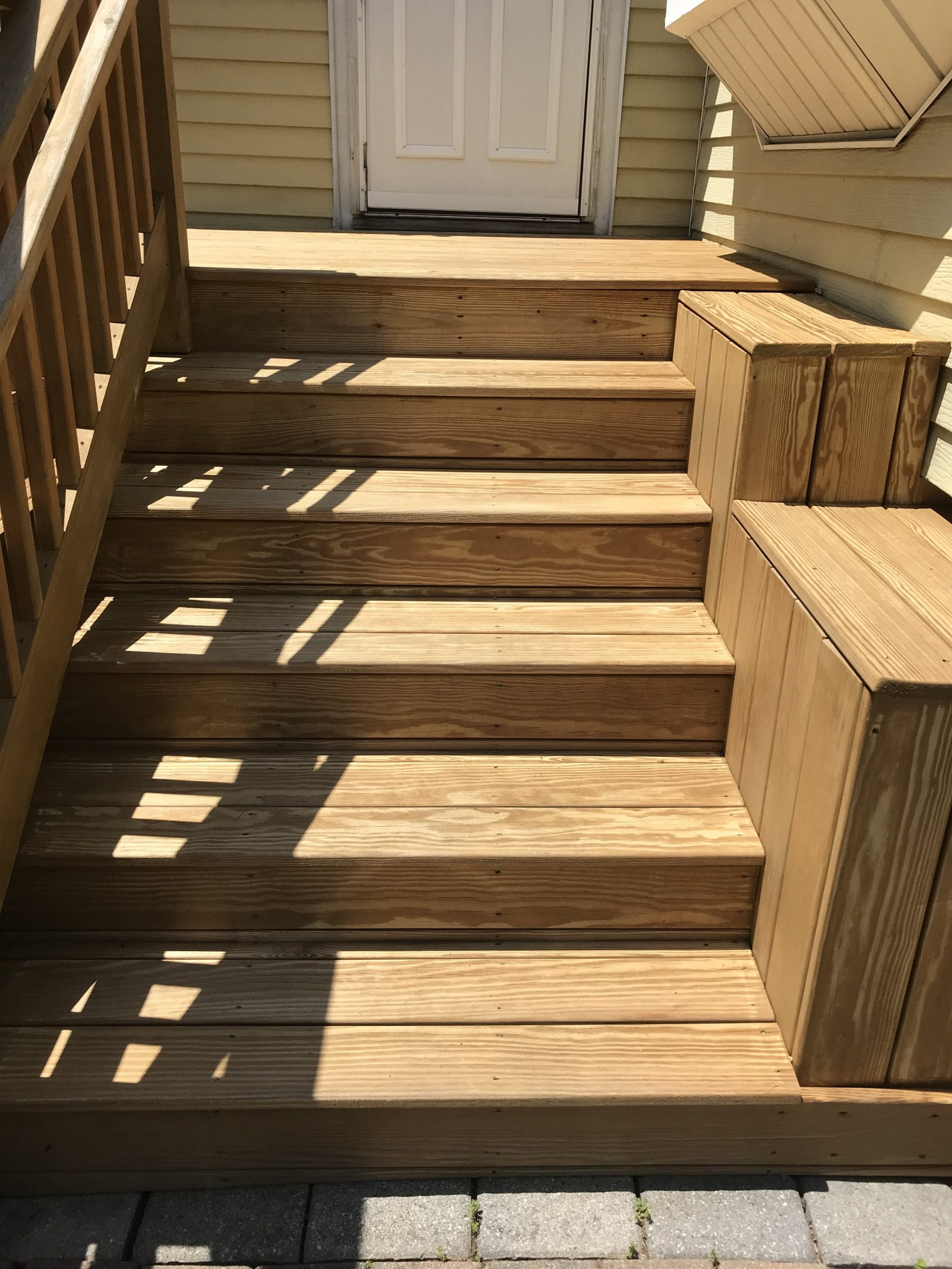

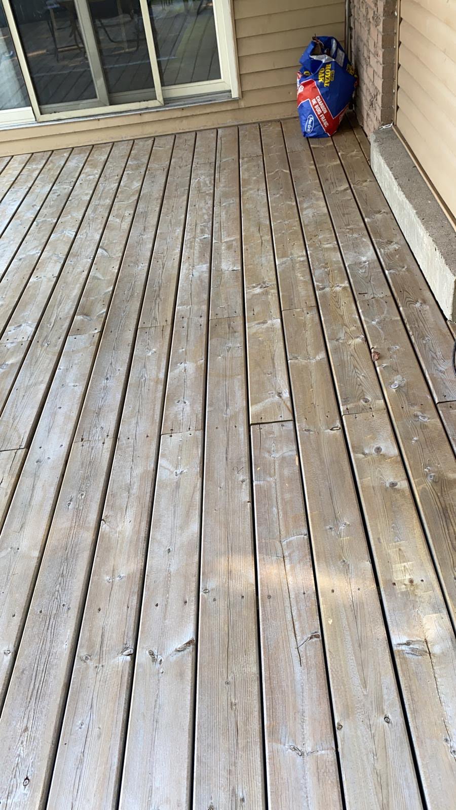

First time home owner. These are 2 different decks on the sides of our house (2 pics each). Unsure if I need to sand or just apply cleaner and brightener.
1. Unknown age
2. I don’t think so
3. No
4. Unknown
5. Unknown
6. The first deck seems a little moist/rotted
7. Age. Time to refresh.
Clean and brighten the wood for prep and stain with Restore A Deck Stains or TWP 1500 Series.

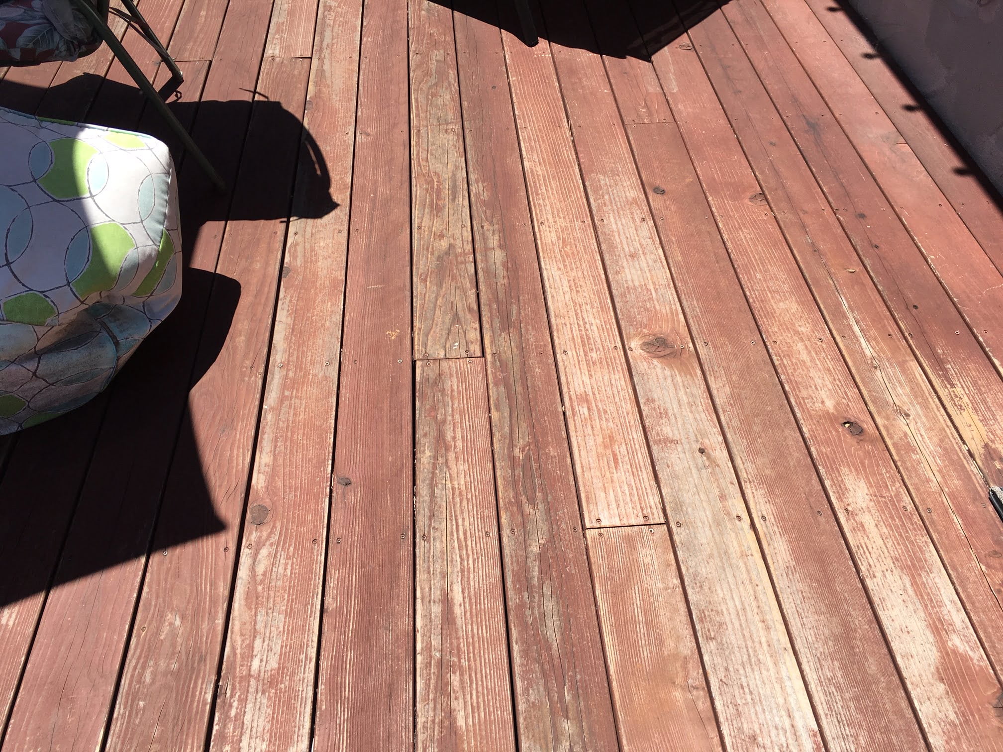

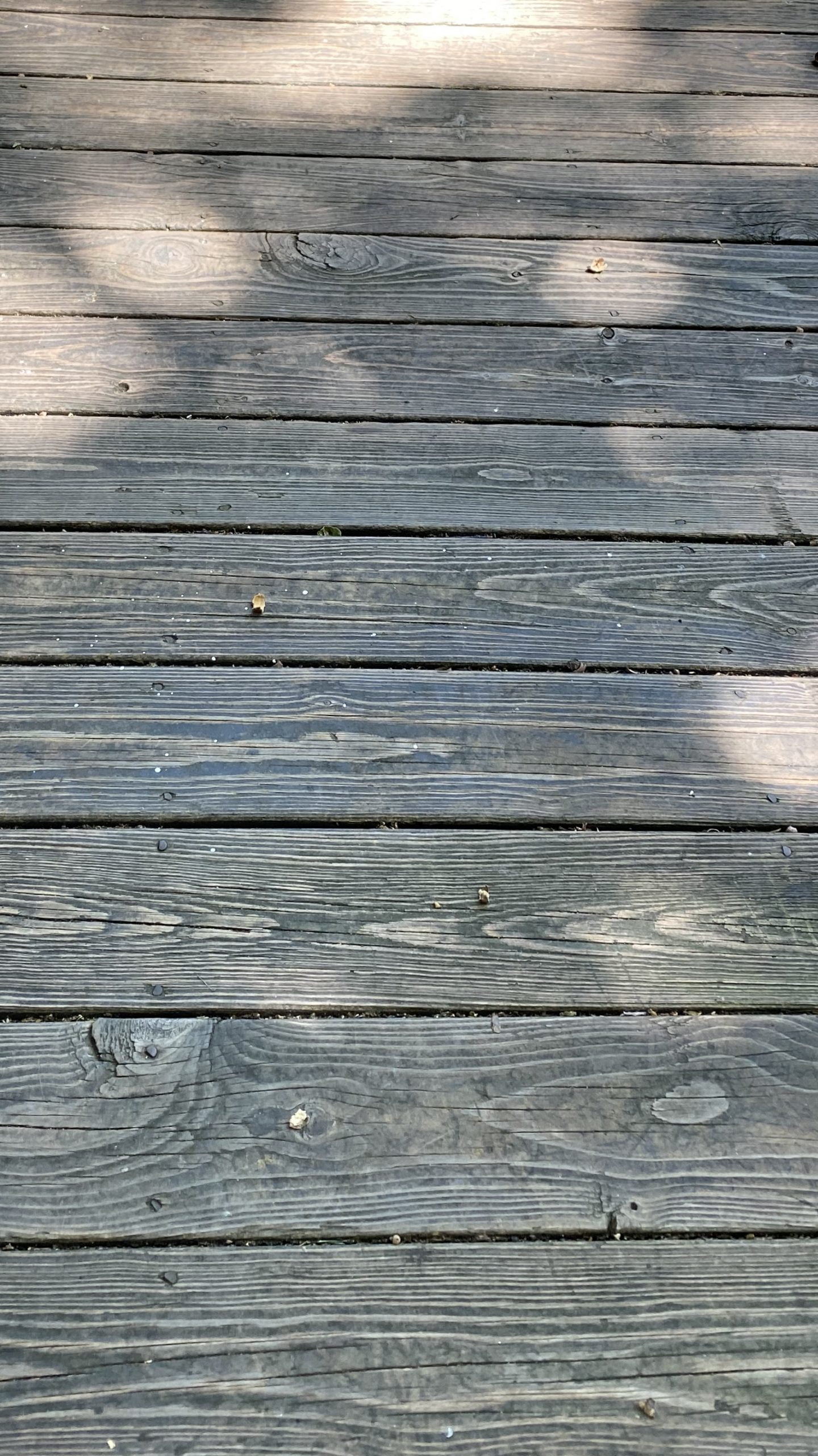

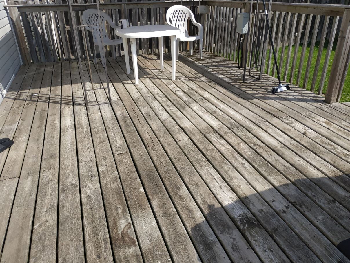

1. Older Wood (very more than 25 years old).
2. Semi-transparent was last applied more than 10 years ago.
3. Switching. Will go with darker oil-based semi-transparent..
4. Unknown
5. semi-transparent oil-based
6. No.
I have already power washed and cleaned. I did not use a chemical stripper and after reviewing info here, just want to get expert advice on whether I can go ahead with a darker oil-based semi-transparent (thinking cedar color) or if I need to redo entire prep with chemical stripper. Hoping that with age of prior stain, and going with a darker semi-transparent, than I don’t need to strip, but expert advice is appreciated!
NOTE: what looks like patches of light color wood in the picture is just spots where sunlight peeks through the shade of a tree [picture has most of the deck in shade, but sunlight peeks through in patches].
You should strip and brighten for this deck.

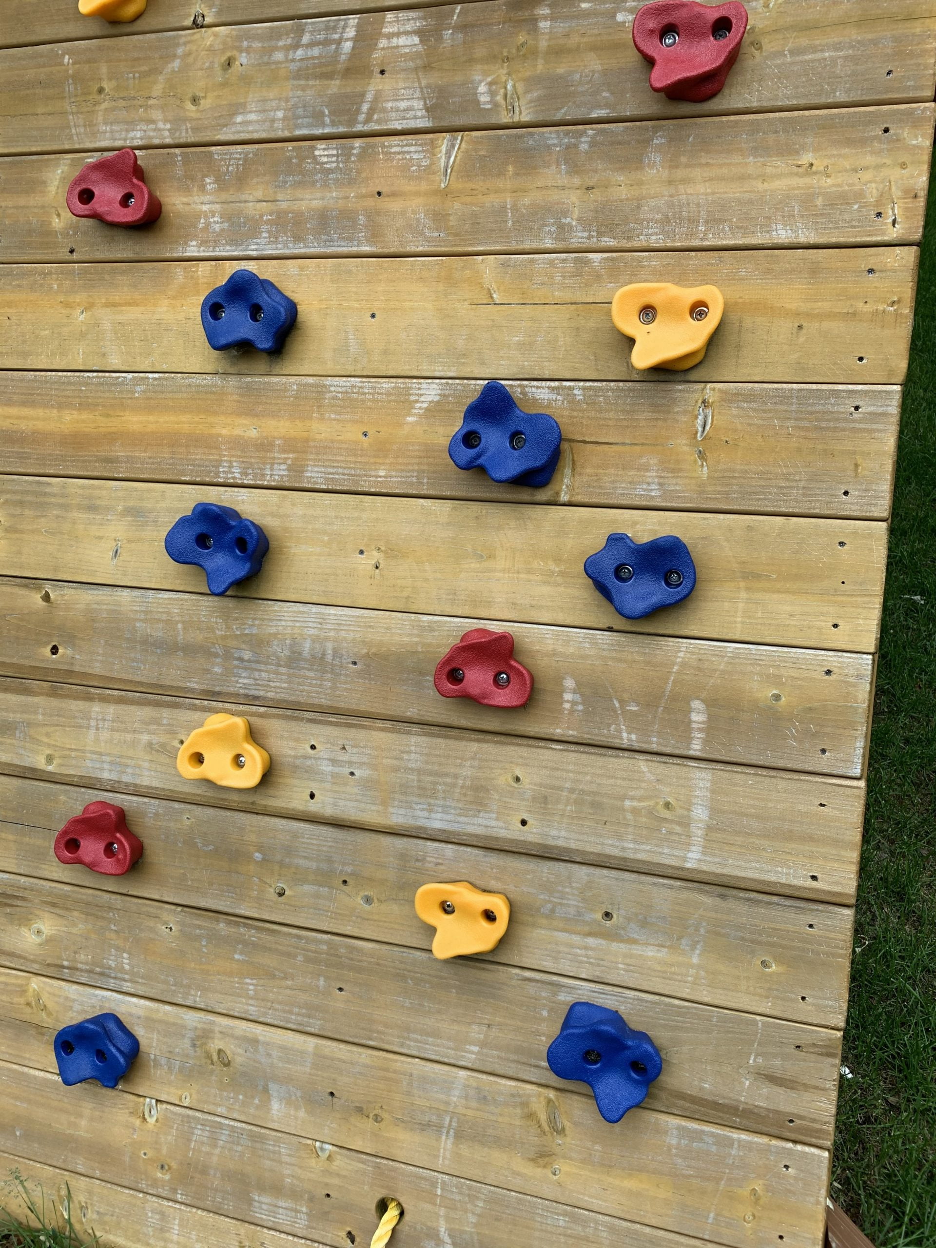

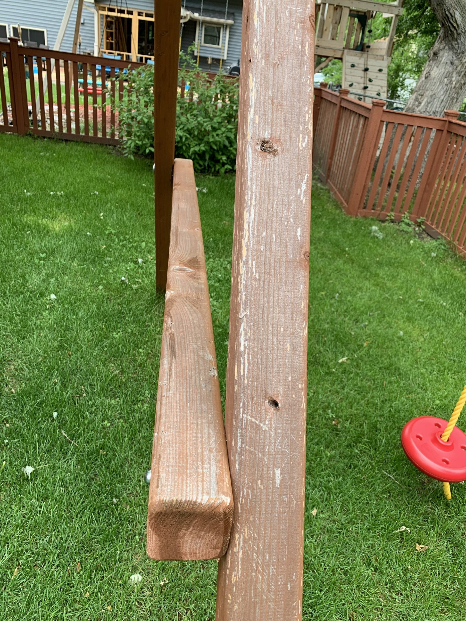

1. 3 year old redwood Rainbow brand playset
2. Factory applied semi-transparent water based stain sealer
3. We’d like to switch to TWP 100 but are wary of the massive amount of work required to strip EVERYTHING.
4. Rainbow brand stain sealer applied by factory
5. Water based semi-transparent
6. No mold or mildew but significant traffic wear on select areas
7. High wear due to kid traffic. The rest of the stain is holding up perfectly as you can see from the railing photo.
We are considering two options.
1. Stick with Rainbow stain. (Questionable quality but maybe a ton less work)
2. Switch to TWP 100 stain. (Excellent quality but massive work to strip everything)
My questions:
1. If we stick with the Rainbow brand stain, will we still have to strip the playset or just clean and brighten it?
2. If we switch to TWP 100, will it be less work in the long run because it’s a better quality stain?
1. Clean and Brighten.
2. Probably but you will need to strip what you can and then sand off the rest. Brightener last.
We’re going to go with 1: Clean and Brighten. But I just discovered I cannot get the Rainbow stain currently. :( Can I use the RAD water based stain if the color is close?
No, you have to strip if switching brands of stain.
1. a mix of both
2. yes, see pic, I have no idea what is on it.
3. I want it stripped and then something new put on..low maintenance..not sure what. no idea what is on it now
4. unkown
5. no idea
6. i dont think so
7. no idea
ps it would only let me upload one pic
another pic
You cannot strip this off. You will have to power sand if you want to remove a solid stain.
How do you know what it is? How can you tell?
It is a solid stain.
Not sure what do do! New pressure treated wood deck, stained it and came out terrible. I would like to put a different brand of stain on, what do I need to do, any help appreciated
See here for new wood tips: https://www.deckstainhelp.com/staining-a-new-deck/
Strip and brighten this to remove.
What grade of sand paper?
Strip not sand it off.
What stain did you put on this?
It was called Techniseal and what do I use to strip it?
Try the Restore A Deck Stain Stripper and then the Brightener.

1.Older Wood
2. No coating can’t see any color or shine. (not sure)
3. Don’t know if any exist and don’t know the brand
4. unknown previous deck stain
5. Unknown
6. had Mold and Mildew before cleaning it with 30 second outdoor cleaner
7.unknown
Seems like power washing has left a very rough surface. This deck hasnt been cleaned or stained for at least 5 years.
Do I need to sand?
Canadian winter resistant stain?
Deck close to the ground does that affect the stain type?
Pictures. Before on the right and after on the left.
Some pictures. pre and post cleaning with 30 second outdoor cleaner and power wash.
Clean again with a deck cleaner and then a wood brightener. Stain with TWP 200 Series or Armstrong Clark for Canada.
Moved into my grandparents house built in 2006, I assume the deck is from 2006 as well.
1. Older Wood, we will replace a few boards that have rotten holes, but most is okay.
2. It had been stained with a reddish solid stain that was never reapplied or kept up and was flaking and worn, we powerwashed it but not all the stain came up.
3. Switching brands and type would prefer semi transparent oil based.
4. Unknown original stain, just that it was solid
5. Solid, spotty coverage
6. slight mildew on one small portion, but mostly just sun exposure
7. Never reapplied
The 4th picture is from 2013, 3rd 2016, 2nd 2019 before powerwashing, 1st 2020 after powerwashing.
You will have to power sand this all off if you want to use a semi-transparent stain. Strippers will not remove this fully.
Based on articles from this site I was planning on stripping, sanding, and then brightening before staining.
You cannot strip this stain. You will have to sand it off.

1. Old Wood (probably 10-20 years, in pretty good shape)
2. Deck has a current coating
3. Looking to change brand and color
4. Looks to be Behr Premium Transparent Redwood 502 (found old cans in the basement – was last stained over 7-8 years ago before we purchased home)
5. Transparent Redwood color
6. Some mold/mildew on stairs/horizontal areas
7. Flaking/mildew
Deck has Trex for the main walking areas and tops of railings. All other areas of deck (spindles/support/stairs) all wood. New pressure treated gate added this year. Would like to stain a medium/dark brown in a semi-transparent. Thanks for your help!
Strip and brighten for prep and try Armstrong Clark Stains or TWP Stains.

1.) Unknown (house is 12 years old, bought a year ago, looks like a few individual boards have been replaced)
2.) Yes
3.) Yes I am switching brands. Prefer to use semi-transparent.
4.) Sherwin Williams
5.) Semi-transparent
6.) No severe issues. Algae in some areas
7.) Figure it just needs a new stain (tag on can of existing stain is from 2013). Appears to be flaking/wearing off.
Seeking assistance on whether to sand or strip/brighten. Much appreciated.
Strip off as much as you can, sand if needed to remove all, brighten wood prior to prep. Stain with one of these brands: https://www.deckstainhelp.com/staining-a-new-deck/

Restore 4x was applied to our deck 5 years ago. It did well but is now starting to peel. Suggestions on where to go from here.
The only way to fix is to sand it all off or replace the wood.
Looks newer
Yes, but not sure of brand or type.
Unknown what was used previously, would just like to spruce up what I have. If I wanted to change the color, will I need to strip what’s already here?
unknown
Some kind of paint, it doesn’t appear to be peeling or anything the wood just looks like it needs help.
No
n/a
That is a solid stain. Pressure wash for prep and apply another solid stain: https://www.deckstainhelp.com/what-are-the-best-solid-color-deck-stains/
Hi, We are having our house painted and part of the process is for them to clean and stain the ceiling on our porch which is exposed wood. Similar to a deck, but on the ceiling. The previous owner power washed the ceiling and there were water spots and power washer lines. The painting company stripped the ceiling the other day and the attached picture is 2-days after the stripping process. They think they will need to sand; do you think it needs sanding?
Do they need to clean and brighten? Before sealing?
Also, I want it stained with a clear stain fully transparent. What do you recommend for this?
Applying a brightener on this should help even it out. Try that first. Look at Defy Extreme Clear for the clear sealer.
Any need to sand and then brighten it? or just brighten?
I have a feeling that I’m going to need to guide the painters… and they are supposedly the best in town :)… Thank you for all the input. This site is great and save us people so much time having a responsive resource.
Just brighten. Strippers are caustic and darken the wood internally. Brighteners neutralize and reset the pH balance. It should hopefully help.

I applied cleaner and then a brightener but the results varied a lot. There was some lightening but there are a number of dark splotches and generally the result generally does not appear to be the correct color of the underlying cedar. Do you have any suggestions?
Strip and brighten this. Also you will need a pressure washer.

Our deck is older redwood. It was previously stained with Sherwin Williams Semi-transparent oil based. It was stained 2 years ago. We get black from the trees and it takes a beating from the sun. The stain did not preform well at all. By your reviews we are switching to TWP Pro 100 Series cedar tone color.
We have started the process of refinishing. We have removed old stain. We didn’t have much luck with the stripper Restore a Deck from TWP. We used oxi clean to remove old stain and pressure washer. It was the only way it would come off! Which it has raised the wood. Now not sure what to do next. Should we sand the deck with 60 to 80 grit sandpaper? Then use the brightener? Then stain? I am sending you pictures. Thank you for your help.
See this for tips: https://www.deckstainhelp.com/wood-fuzzies-furring-on-deck/
When do you do the brightener? before you sand?
After.
What type of prep should I do for semi transparent or solid stain
1. Old wood, 2×6 about 15 years old. I think
2. No coating
3. No existing brand
4. Unknown
5. No stain
6. Some mold and mildew
7. Not sure if there was any existing stain used
Full sun in the afternoon to evening. Why would you recommend for stain or paint? Upstate NY. All season, snow, heat and humidity.
Clean and brighten the wood for prep.
Thank you for your help!
Prep questions:
New Wood or Older Wood? 5 years old
Does the Deck have a Current Coating? Don’t think so. I think the wood used was Micropro Sienna, which had a definite colour to begin with. No coating added after the deck was installed (I didn’t know I was meant to!). The guys who installed it did use some cut stain that was matched to the sienna colour
Are you Switching Brands of Deck Stain or Applying a Maintenance Coat of the same Brand and Color? Neither – the wood has never been stained.
Deck Stain Brand Previously Used? Enter “unknown” if you do not know. N/A
What is the Current Deck Stain Type? Oil-based or Water-Based? Clear, Transparent, Semi-Transparent, Semi-Solid, or Solid Stain? N/A
Mold or Mildew Issues? Some patches here and there where water has sat over winter etc.
Reason for Previous Stain Failure? The deck has aged and some surfaces are grey, while others retain a faded version of the original sienna colour. The vertical surfaces have retained more colour.
Stain questions:
Deck Location State: Ontario, Canada
Full Sun, Partial Shade, Full Shade: Combination of full sun/partial shade – mostly full sun.
Wood Type: Pressure Treated Pine – Micropro Sienna
Mold or Mildew Issues: Minor
Reason for Previous Stain Failure: Faded on flat surfaces, some colour on the verticals
Previous Stain Brand and Type of stain (Solid, Semi-transparent, Transparent, etc): None?
Looking for a reco for products in Canada, e.g. Behr, C.I.L., Dulux. I’ve never treated the deck and am a total novice. We have a shed in the same wood that still has a lot of colour (partial/full shade location, installed at the same time as the deck), so I’m hoping to clean the deck and reinstate the original colour as closely as possible. Can I clean the deck with a pressure washer only? Should I use a semi-transparent waterproofing stain? Is there a brand/colour that’s known to be close to the micropro sienna colour? All help greatly appreciated, thanks.
Strip and brighten the wood for the prep. Stain with Armstrong Clark or TWP 200 Series for Canada.
Thank you! Semi-transparent, or transparent stain?
Semi-transparent

My husband built a new redwood deck last summer about 800 sq ft and the wood was properly dried and was clean when Valspar One Coat Exterior Stain and Sealer Clear was applied. It was completed at the end of July with dry weather before and after for a few weeks. We live in the Pacific Northwest, but in the dry area of Washington state, so other than spring, there isn’t a lot of rain. In October black mold spots were noticed by the customer and it was patchy and blotchy. By March 2020 the whole deck was getting black mold which appeared to be on the surface at the time. Due to spring rains he had to wait for dry weather to start a stripping process. Yesterday, he broomed away the surface mold and dirt and pollen that had accumulated and applied the Sherwin Williams Superdeck Stain and Sealer remover to a small part of the deck according to product instructions. It appears that it removed the sealer, however, there are spots of black stain in the wood (assuming its mold) under the sealer which were accentuated after applying the remover. He has not stripped the entire deck yet as he is not sure what to do next. Before and after pictures are included. This was a very expensive project that my husband built for a customer, he has been building decks for 30 years and has never had this problem. It was his first time to use the Valspar product as the client wanted a clear coating to accentuate the redwood appearance and it was recommended by Lowes. After applying the sealer in July 2019, everything looked perfect. Attaching pictures of completed deck taken 08/06/2019, pictures of the deck in March 2020 after customer reported to him the problems, and a picture of what the deck looked like after applying the Sherwin Williams stripper yesterday. The first photo was taken August 6, 2019, the 2nd taken March 5, 2020, and the third is yesterday, 05/28/20 after stripper was applied. He is extremely stressed at this point as he wants to make sure that what ever he does is the best thing for the customer. He will never use the Valspar product again. Any recommendations for products to use for stripping and getting rid of the mold is much appreciated. Also any deck stain recommendations. Thanks for your help in advance.
The pictures are out of order in the above post. The 1st picture is from March 2020, the 2nd is from the application of the stripper yesterday, and the last two are of the new deck last August.
A stripper should kill the mold. Is he removing all of the Valspar with the current stripper?
He’s not sure what to do. Wondered if the Sherwin Williams stripper was good enough, or was there something better for him to use? If the stripper kills the mold, why is there still so many black areas on the wood?
The only thing I can think of if is not mold is rust. Metal pieces in the wood will turn back once it gets wet. This happens sometimes when people steel wool their decks. Bleach kills mold. A wood brightener removes rust. Try both and see if one works.

We have newer wood with a sikkens semi transparent Light stain. It didn’t age like we had hoped. Looking at getting the light walnut stain. What would be the best prep for the deck?
Strip and brighten the wood.

Hi, I purchased a house with this deck, attached. I have no experience cleaning, staining or identity the wood deck. Can you please let me know whats the best clean/strip and stain for this deck? I live in Ontario, Canada. Thank you so much!
Use a deck cleaner and then a wood brightener for prep. Stain TWP 200 Series or Armstrong Clark of Canada.
I have a mahogany covered porch in good shape. I’m revitalizing it.
It has semi transparent stain. I can either sand or strip them brighten. I don’t like using chemicals but if it’s beat will do this one time then stain again with same product which won’t require stripping again.
So what’s best? Sand or strip and brighten?
Strip off what you can and then sand the rest off. Brightener last.
We had our new deck done in December 2017. We waited to stain it until May 2018, and used a transparent stain & sealer in one. The stain has started to look worn in most places so we figured it was time to redo the stain. We power washed the deck this past weekend hoping to get some of the stain off. Took some off, but not a lot. We are looking at doing a semi-transparent or solid stain this time and want to know if we need to strip and sand the wood to remove the old transparent stain, or just clean it before re-staining with the semi-transparent or solid stain. Thanks in advance!
1. New Wood – 2.5 years old. Southwest facing and gets full sun for most of the day
2. Yes, has a transparent stain & sealer
3. Switching brands, looking at either a semi-transparent or solid stain
4. Currently had Thompson’s Water Seal Waterproofing Stain – Transparent in Harvest Gold
5. Water-based, transparent
6. Small amount on a few boards that are under a tree, easily cleaned off
7. Some boards are looking worn, want to refresh the deck. Also had a tulip tree that produced a sap that has left black residue on parts of the deck. We were able to get some of it off the surface but it appears to have seeped into the wood so would like to try and cover it
8. photos attached
Strip and brighten fully off if you want to use a semi-transparent. Clean and brighten if you want to use a solid stain.
Great, thank you! Some areas need sanding after the power washing, should we sand before or after using the brightener?
Before.
New Wood or Older Wood? Older, west facing, full-sun deck
Does the Deck have a Current Coating? Yes, Sherwin Williams Super Deck Solid Stain, water-based, which was last applied 2 years ago and started peeling within 8 months of application. It was applied by a professional who was covering a previous solid stain. Surface prep included power washing, spot sanding some areas, then 2 coatings of the Sherwin Williams Super Deck.
Are you Switching Brands of Deck Stain or Applying a Maintenance Coat of the same Brand and Color? We are open to whatever you suggest. Probably sticking with a solid stain would be easiest.
Reason for Previous Stain Failure? Poor quality product applied? Poor surface prep? Harsh conditions?
Pressure wash with a stripper to remove the loose stain. Let dray and spot sand as needed. You can cover the intact stain with a new coat of solid stain: https://www.deckstainhelp.com/what-are-the-best-solid-color-deck-stains/
