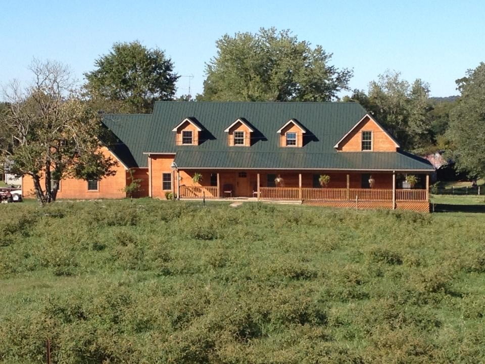

What would you advise using to get this color on our cedar columns? I want to try and take the red tint out but don’t want they grey either.
There is not a stain on those wood columns in the pictures. No stain means it will gray naturally in a matter of months. You cannot achieve that look and have UV protection. Adding a semi-transparent stain will achieve UV protection but will alter or enhance the color based on the tint you choose.
