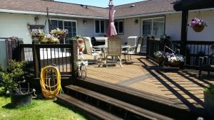

I finished my project a few weeks ago and am very happy with the results. Here are several pictures, some before, during and post project. The deck was originally completed with Sherwin Williams Super Deck oil based transparent (Natural). The contractor sanded too fine, likely resulting in the poor adhesion. To fix this I sanded back to bare wood, allowed to weather for 60 days, pressure washed, then conditioned with TWP 2 step deck brightener. Then stained with TWP 1101 oil based cedar tone, spraying on first coat, then used pad applicator to place second coat before first coat dried. The deck was allowed to dry for 8 days before stepping on it (not intentional, just happened to be away).
Please add the pics!
I thought I had with the comment but appears they were not accepted. Any limit on size or number of pictures?
3 MB per picture.
Testing pic
Here are some pictures, before, during, and after
Looks great!
