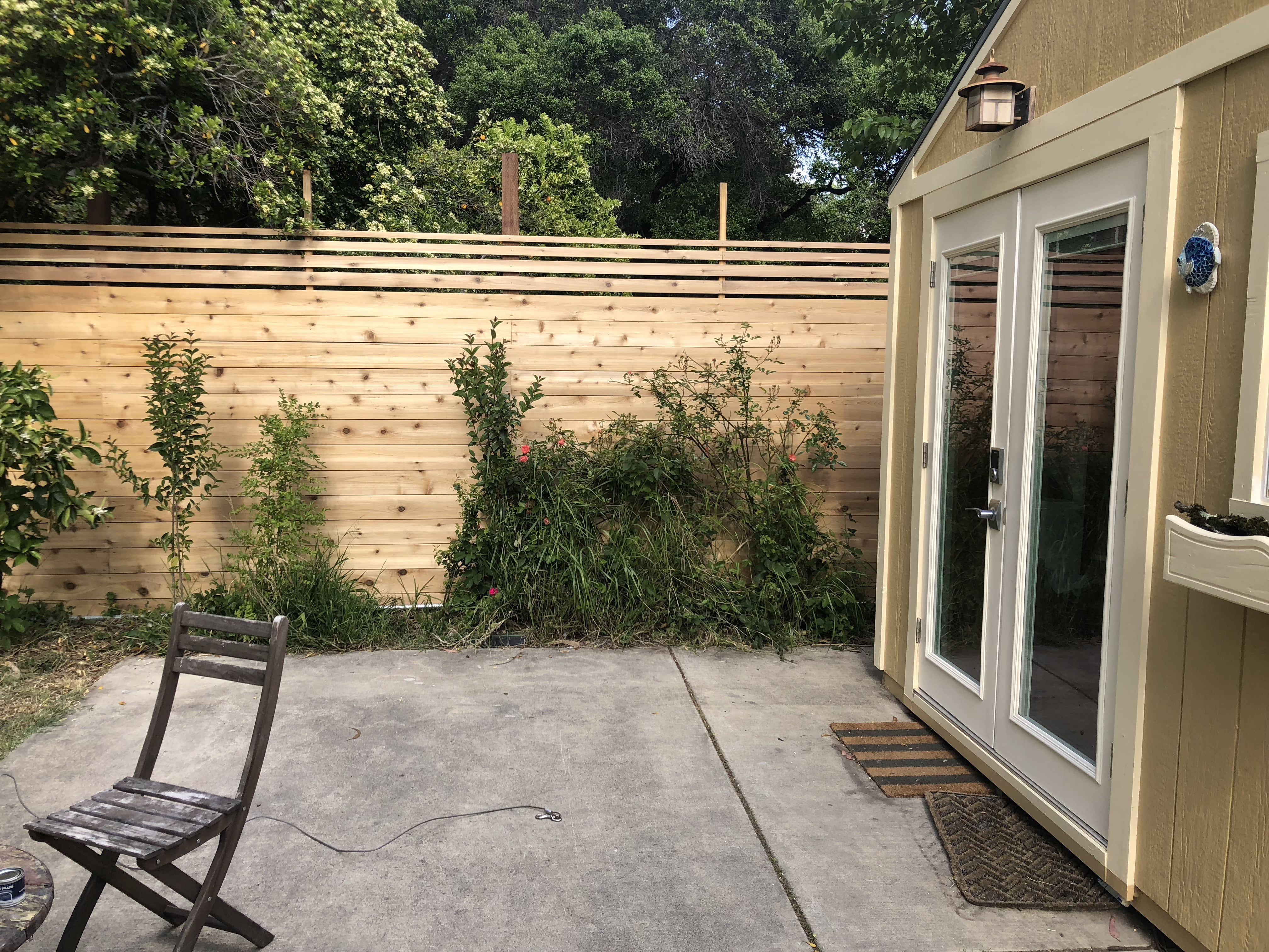

Just put up a new cedar fence. It’s massive. and the wood was beautiful 3.5 weeks ago when it went up. Pink and white. I had to go out of town for a few weeks. Came back it’s much yellower . Very disappointed. Not sure if I could have locked in the pink’s, red’s, white shades if I had oiled immediately. But in any event, it is what it is, and I’m at this point now. What’s the best path forward? Which product? TPW? Messmer’s Something else? Must I so the sodium percarbonate and brightener first? It’s literally nearly brand new. and it’s 1200 sq feet, so it’s a massive task to coat it. My goal is to UV protect it and preserve the color. Which products? How many coats? Also— bonus points for an answer to this please. do I need to cover the Back side of the fence? It’s the neighbor’s view. If I don’t coat that will it negatively impact “my side”? Thanks!!!! From Sonoma County, CA
also— is one coat in fact good enough? and you’re ok with not waiting 2-4 months before application of TWP so long as I clean and brighten first? is that correct?
and finally, do you have a preferred method of application for this smooth, brand new, cedar fence ?
Just one coat for new wood. No, the new smooth wood must weather 4-12 months and then clean and brighten for the prep if using the TWP or any other brand. Use a stain pad or brush.
Whats the harm in not waiting 4-12 months?!
It will soak in correctly and fail.
forgot to mention the wood is kiln dried, and I’ve measured the moisture content, and it comes in at 6-10%. does that impact your guidance at all?
https://www.deckstainhelp.com/staining-a-new-kdat-deck/
