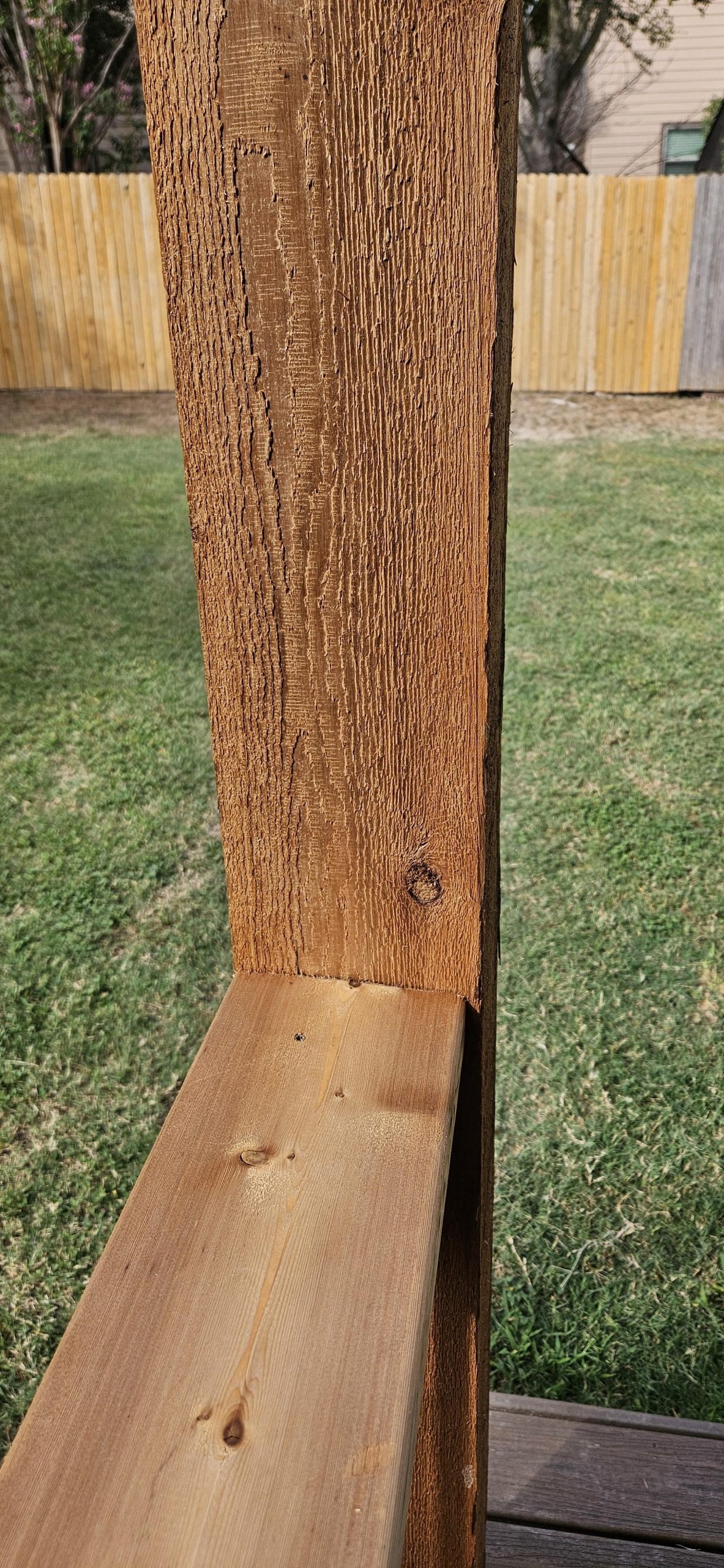

Built a new cedar deck the end of June. I’d like for it to have the “wet cedar” look after I’m done sealing it. What’s the best method to achieving this look? And when should I do it? SW Michigan.

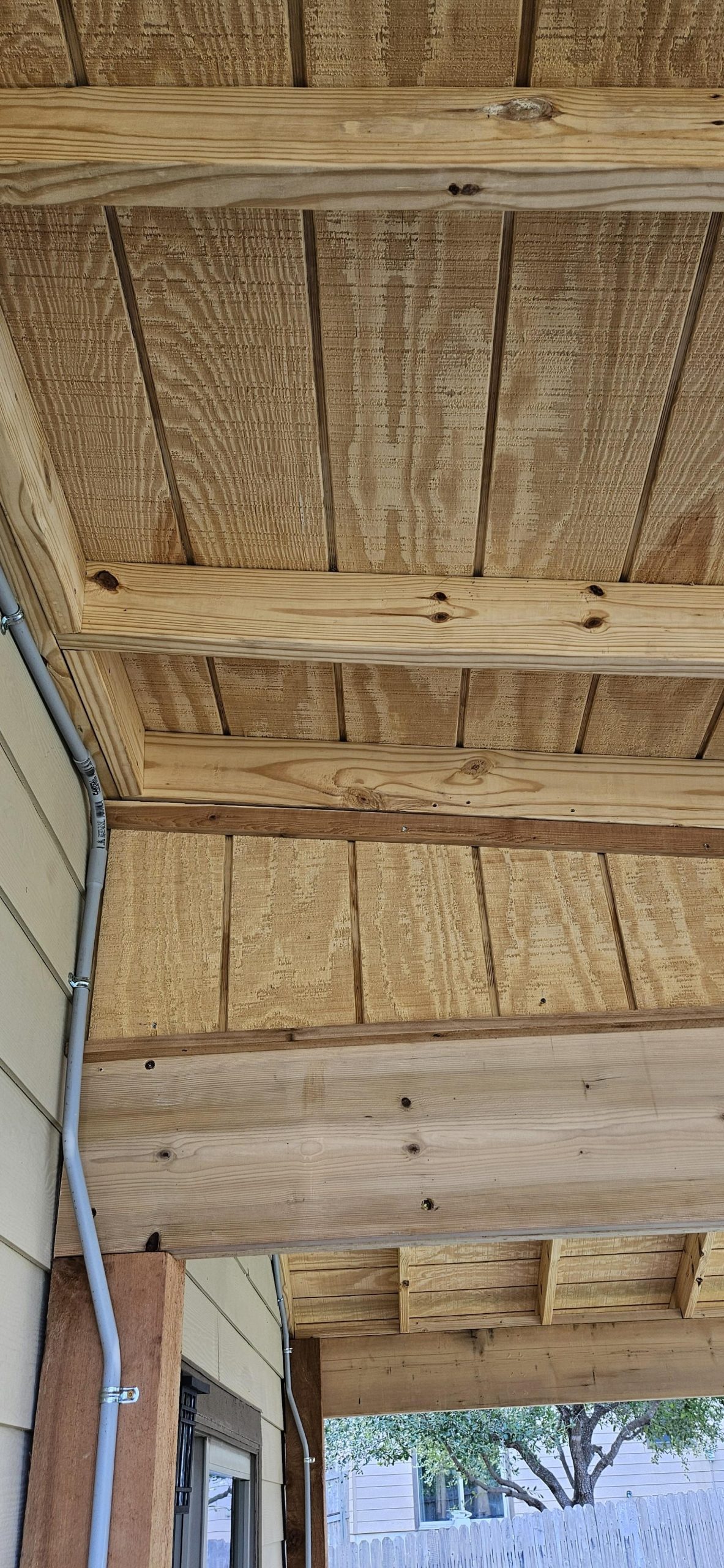

There are several different types of wood used in the construction of my covered deck. Some is pressure treated, some is not. Some is cedar, some is not. I would like to know how long to wait for the wood to dry before applying a semi-transparent stain. stain. Thanks.

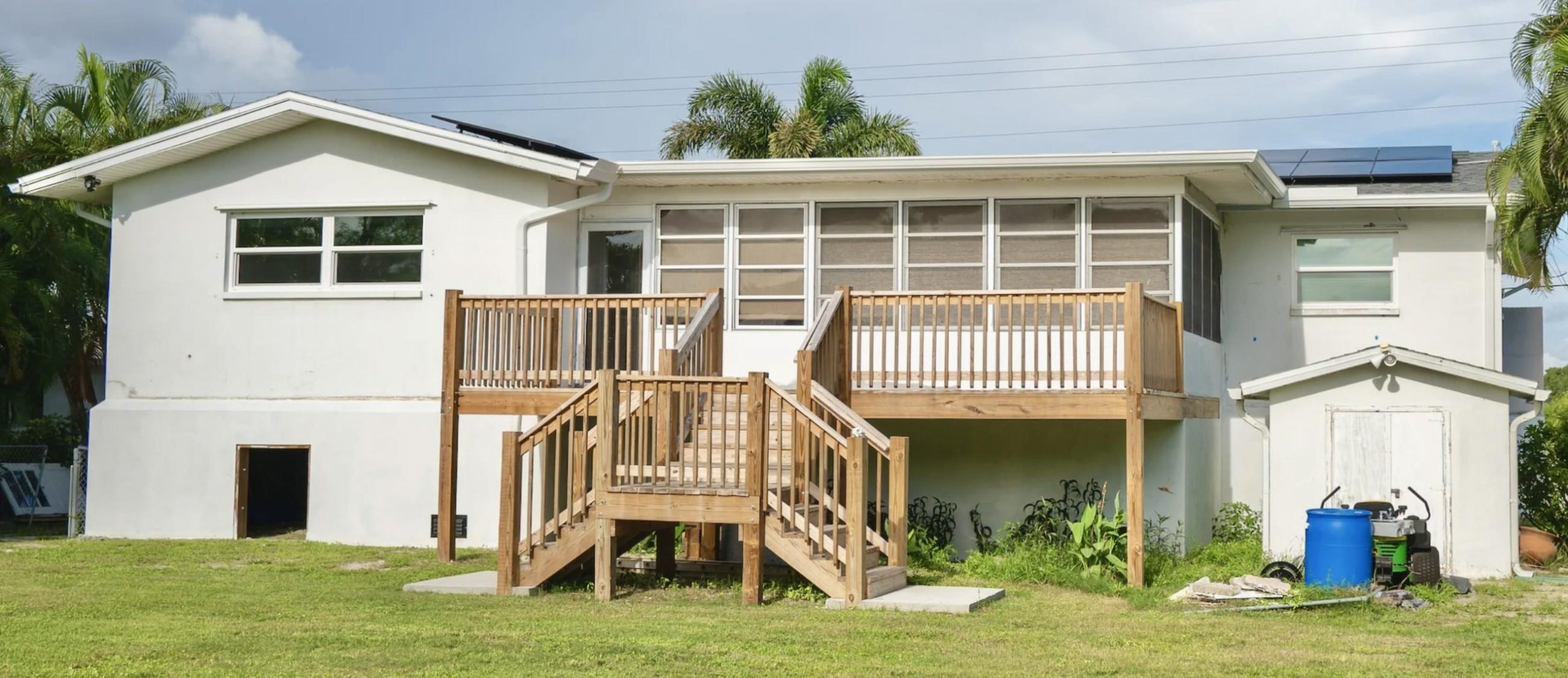

Hi! I’m so glad that I found your website. So helpful because I get conflicting opinions from contractors and lumber sales people.
We’re replacing our current deck and in doubt between Parr Lumber’s tight knot red cedar (vertical boards on shelf) or their own branded Parr cedar (boards horizontal on shelf). Price difference is $0.90/linear feet.
My questions:
  1. We don’t mind seeing knots, but we want to hide them a bit. The difference between the two red cedars is that the tight knot version has fewer knots. Perhaps a semi-transparent stain can hide the knots at some level? And if so, which stain would you recommend?
  2. Do we need to weather the deck or can we stain it after installation when we move forward with Parr Lumber’s red cedar? We live in Portland, Oregon and the deck is facing south.

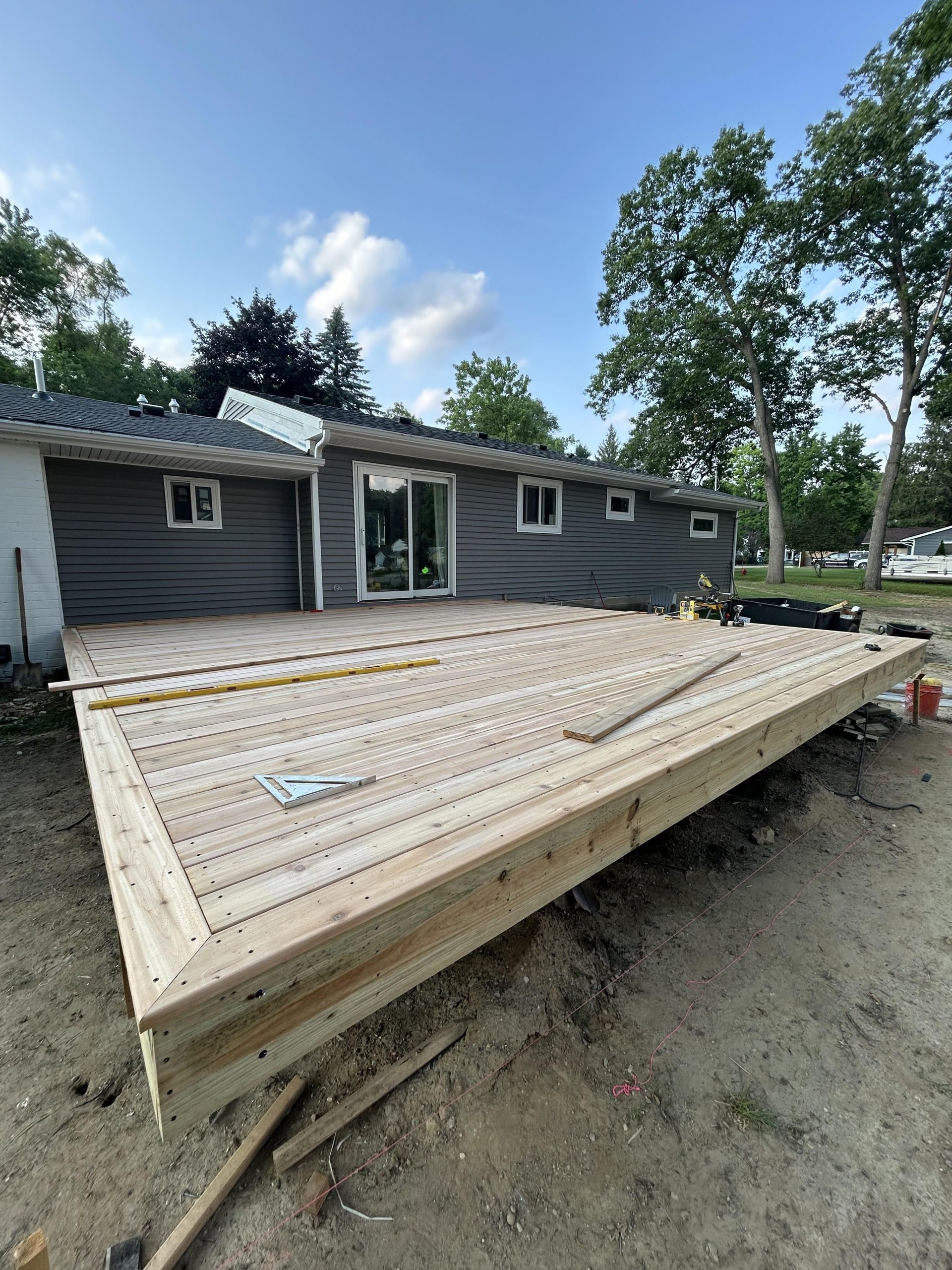

Hi. I have a newer pressure treated wood deck in Illinois nearby St. Louis that is about 6 months old. Never been sealed or stained. I want to use a clear oil based or excellent penetrating water based sealant with some UV protection if possible. Do you have a recommendation. Wife wants the clear and I want some uv protection. DYI project. Never sealed a deck before. Thank you!
