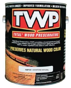

TWP 100 Pro Series Stains
TWP 100 Pro Series stains are only allowed in 35 states; use TWP 1500 stain if you’re in a low-VOC state. TWP 100 Pro Series stain can be used on new wood and deck materials, including pressure-treated pine and cedar.
- Months to Weather New Wood Before Using: Four to 12 months
- Number of Coats Needed for New Wood: One coat
- Consumer Star Rating:
- DeckStainHelp.com Rating: 8.69/10
✅ Tip: If you live in a low-VOC state, use TWP 1500 Series instead.
