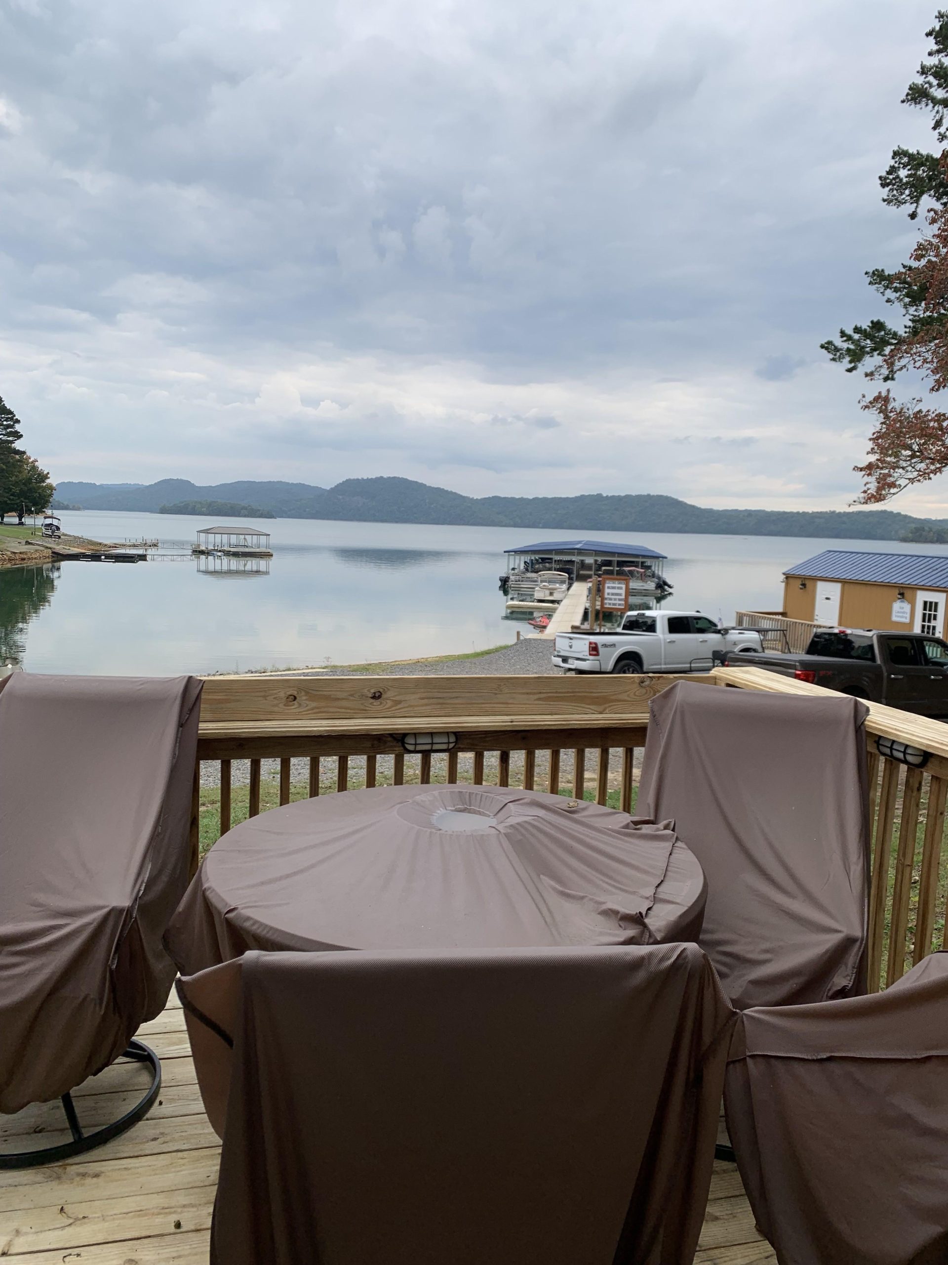

Thank you for your article. My brother and I recently (August 2024) built a 14×30
front deck on my home with preassure treated white pine here in Middle Tennesee. I
purchased the lumber from a local lumber company thinking the quality would be
better. The floor boards are fine but the uprights are rough, splintery, and some
splitting. I have a couple of questions:
Melissa
-Wait until Spring.
-Depends on the stain brand but in general, 50-90 F.
-If needed, lightly sand with 60-80 grit before the cleaner and brightener prep.
-Any of the stain brands we suggest in this new wood article would work great. Make sure to do the prep.
