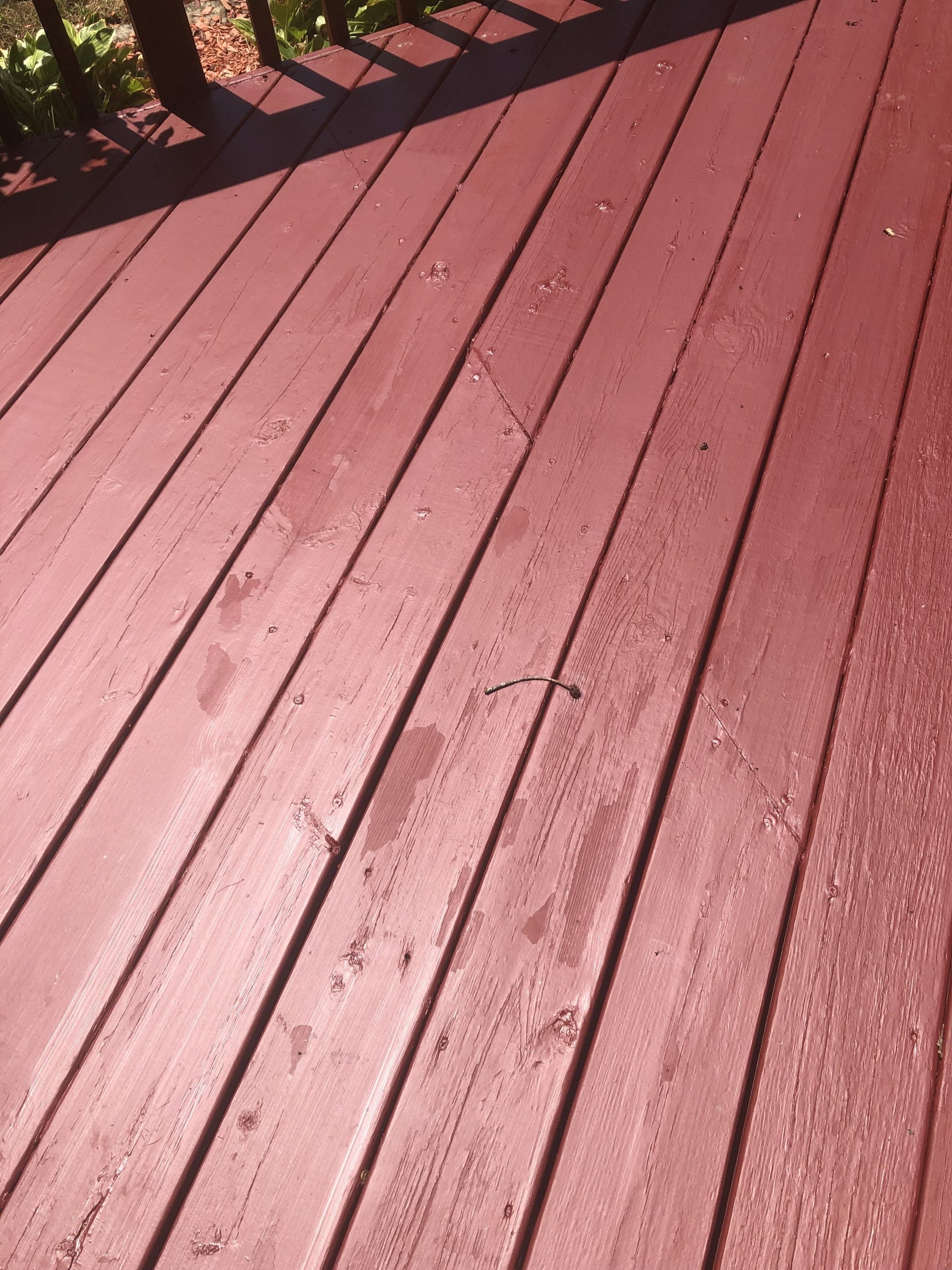

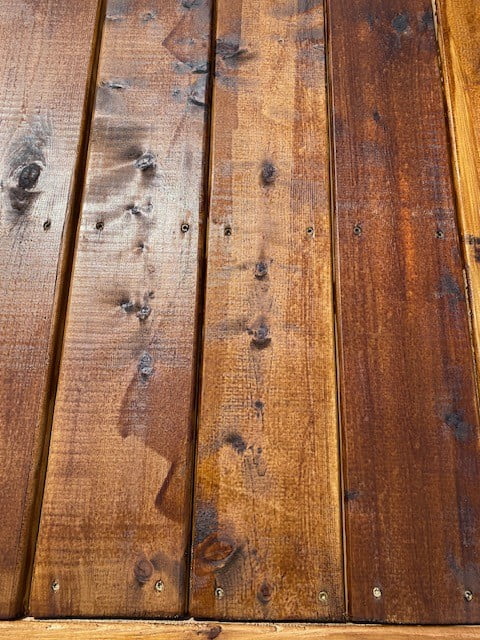

Why does one board on a recently stained deck puddle like this? Very odd. Does it mean the product didn’t adhere to this board?
IMG_2381
This was not new wood – about 15 years old and sanded – first with 40 grit and then 80. Cabot’s Australian timber oil was used. Sorry please remove triple post.

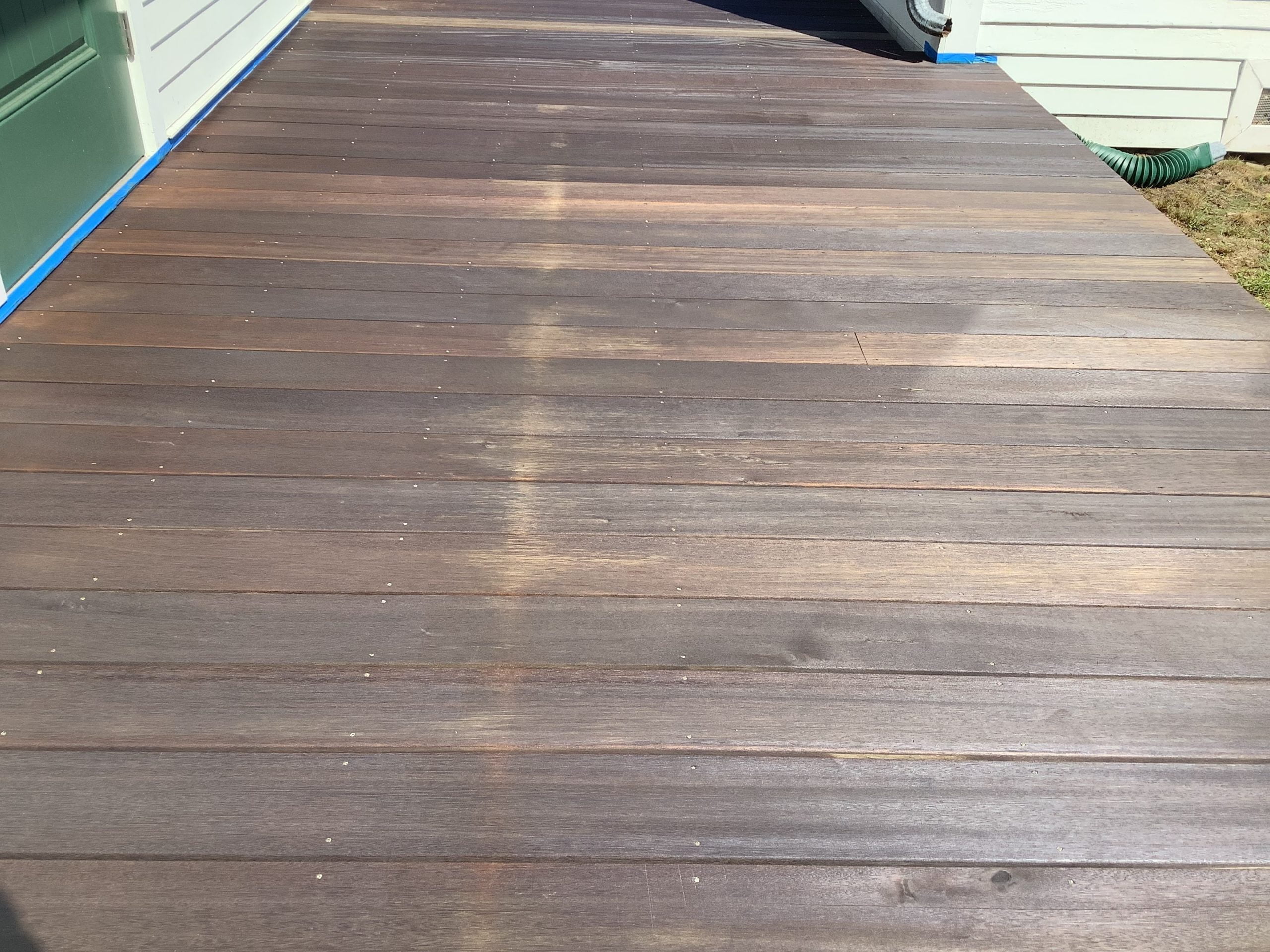

Hi Scott. First of all, thanks for all the valuable advice you provide. I’ve had my deck restained, and it looks great, EXCEPT:
there are darker areas around the perimeter, where a hand brush was used. (Photo attached.)
How do you recommend we fix that? Do we need to sand and redo? If so, do we still need to use brightener? The deck was cleaned thoroughly, stripped, cleaned again, then treated with brightener, before stain was applied. Hoping a sanding will suffice.

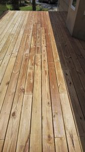

I stripped, sanded, and brightened my 256 PT deck, and finished 2 days ago. I planned to stain it tomorrow with TWP 1500 – Cedartone. The original weather forecast was that it would be clear for 48 hours. Now the forecast has changed, and rain is expected about 36 hours after staining. Should I hold off or go ahead and stain the deck.

Hired a company to paint house and stain deck. They pressure washed, sanded, then stained with Cabot Australian Timber Oil. It rained two hours later. Water pooled on the wood. It looks awful, splotchy and scaly. The pics show it several days after staining was done. Contractor thinks “more stain”, I had to stop them and ask them to go get educated before doing anything. That’s what I’m trying to do here…
What an awesome resource to be able to ask the opinion of others to figure out what to do, thank you!
Randy T
Randy T
One more question if I may, could something else have caused this condition or is it rain water for sure? Thank you in advance.
Randy T
Randy T
Sorry to ask more questions… the contractor had the crew pressure wash the stain off the wood instead of sanding. The wood looks “fuzzy” and I see lines in the wood from the pressure washing…
How deep of doo-doo am I in?

Handyman used messmers oil for ipe deck. He said it would rain the next day but wouldn’t be a Problem. Rainingvhsrd 12 hours later. Deck seems to have oil mixing with the rain. Will deck need to be redone? He also did not wait half an hour to wipe off excess in some places he just coated and wiped is this a problem?

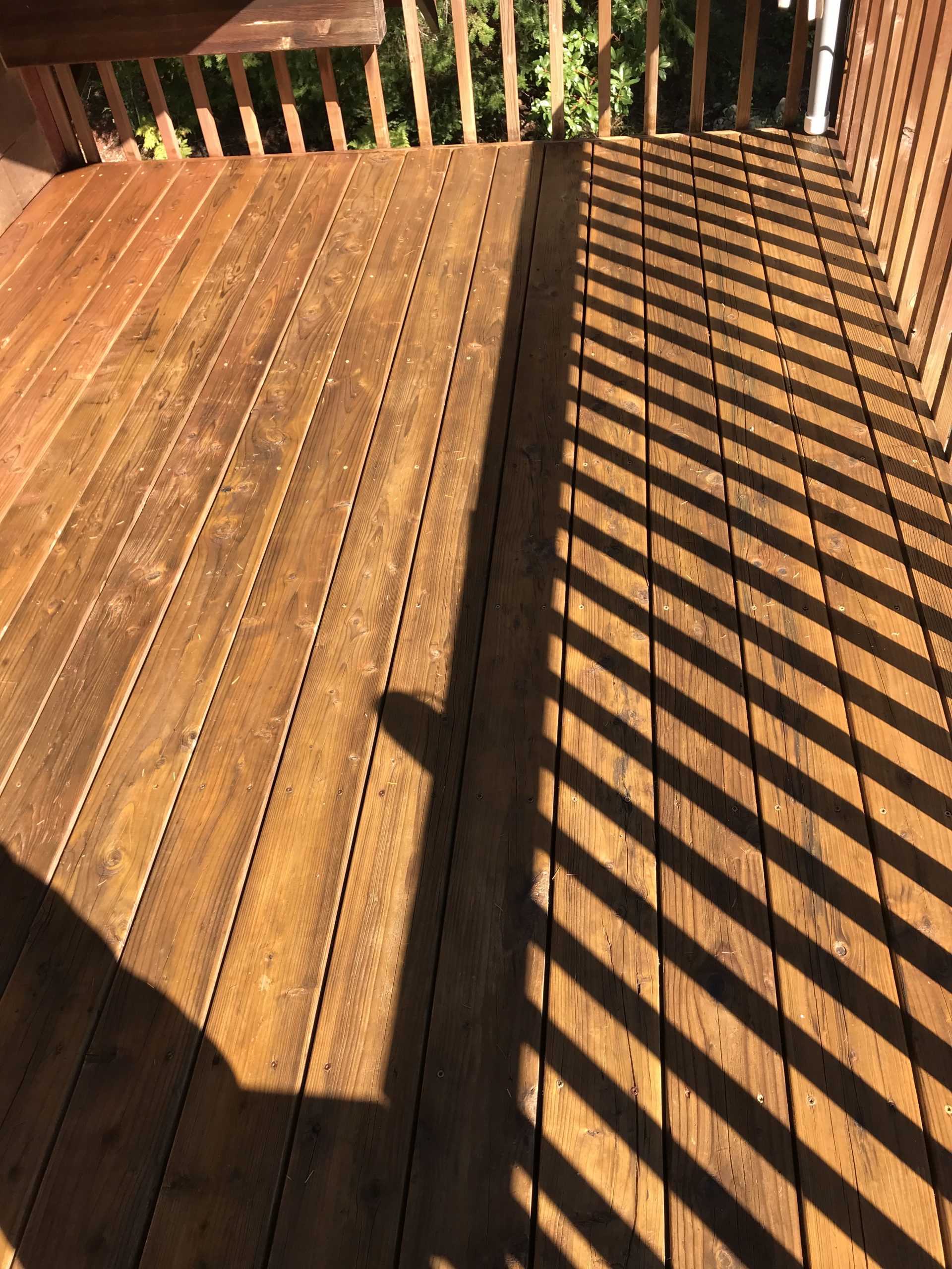

We live in western Washington state and applied Australian Timber Oil to our deck that has not been maintained since being built about 14 years ago. We cleaned it and pressure washed it first and allowed it to dry. Of course it rained that night. The sections under the roof seemed to fair okay and are dry but the sections that got rained on are still kinda tacky. Even after drying all the way. When it rained really hard over the weekend the water seemed to seep into the stain and it created a yellow kinda film on the top that I could scrape off with my finger nail. Is there anything I can do to get rid of the sticky parts to keep excess dirt and grime from collecting over the winter? I know this is most likely a start over in the spring situation but it’d be nice if it wasn’t sticky all winter. Thanks for any advice. I’ll attach pics of the dry deck. The lighter spots are where the yellow film forms when it’s wet.

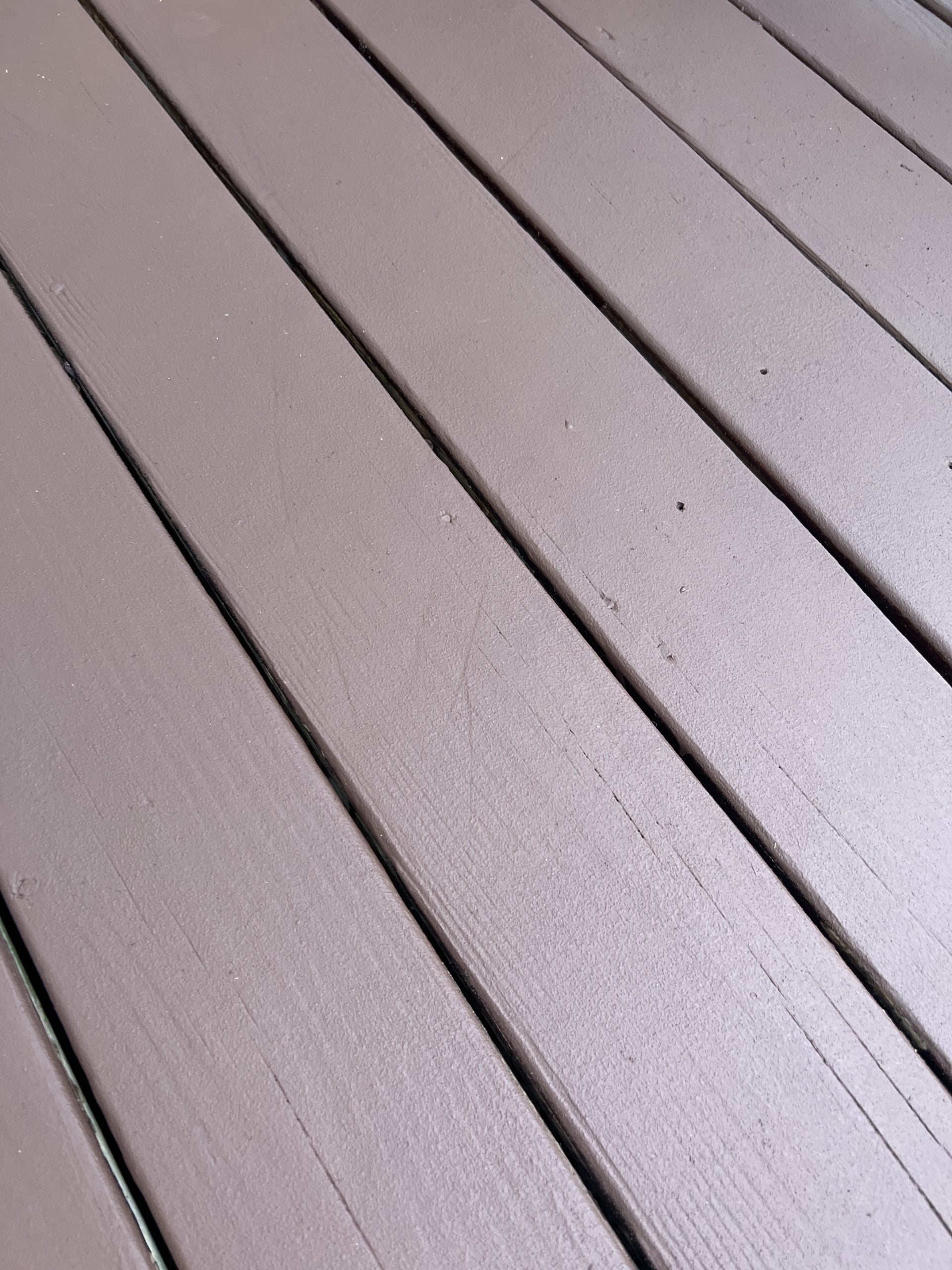

Hello, similar story to others here: I think unexpected rain might have messed up the deck seal we applied. Either that or I was a bit heavy handed in applying the deck seal.
It’s a new deck and we used Behr transparent deck seal. It rained maybe 6-8 hours after we sealed the deck. It was overnight so I couldn’t tell how hard it rained but there was water pooled on the deck the next morning.
Question is: should we pressure wash and re seal it or is it okay for the upcoming winter? What do you recommend?

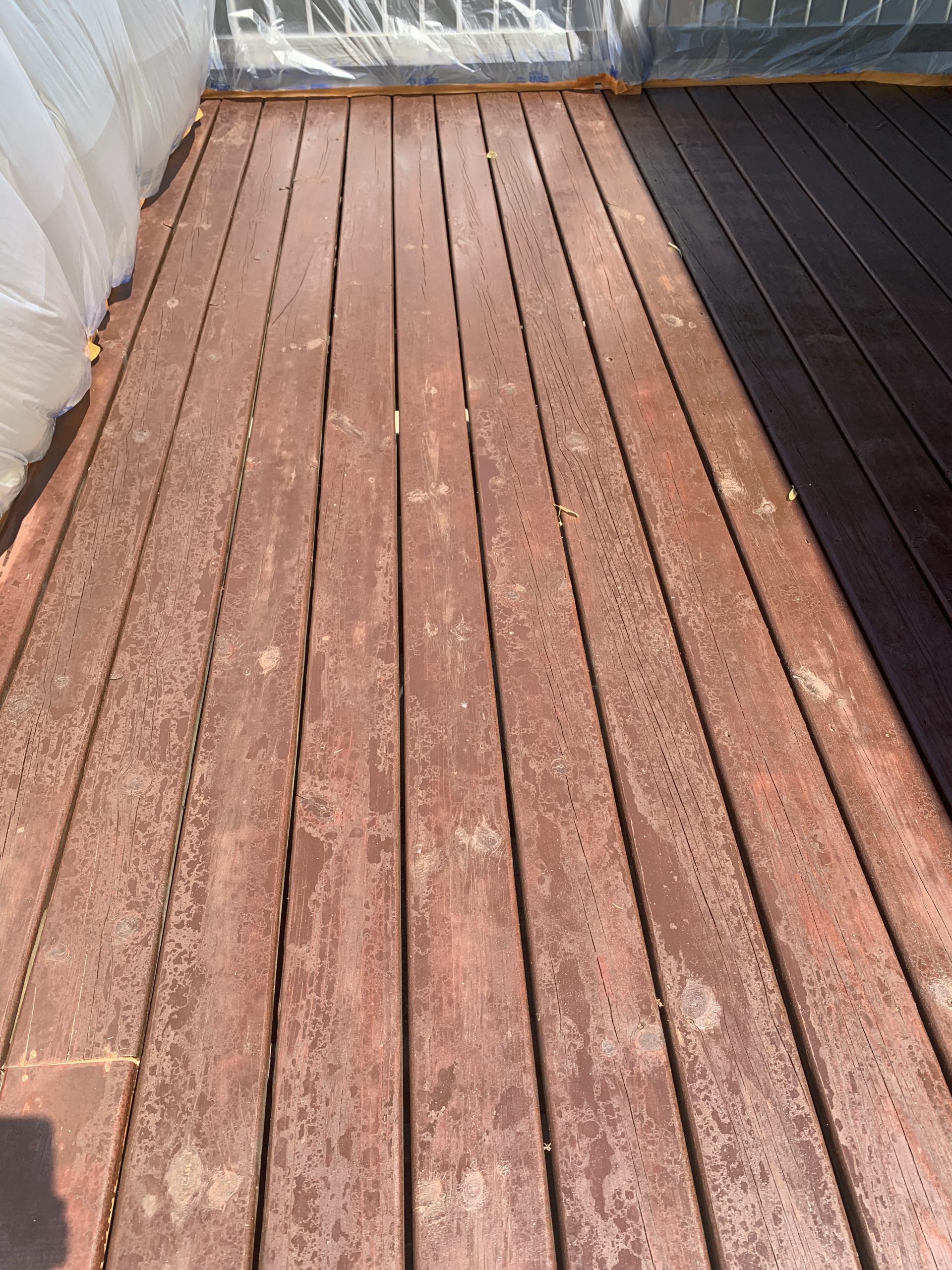

Sorry I thought the pictures were loaded! Here they are.
Shannon
Shannon
Notice in some areas the colour is more saturated and shiny despite it feeling completely dry.
