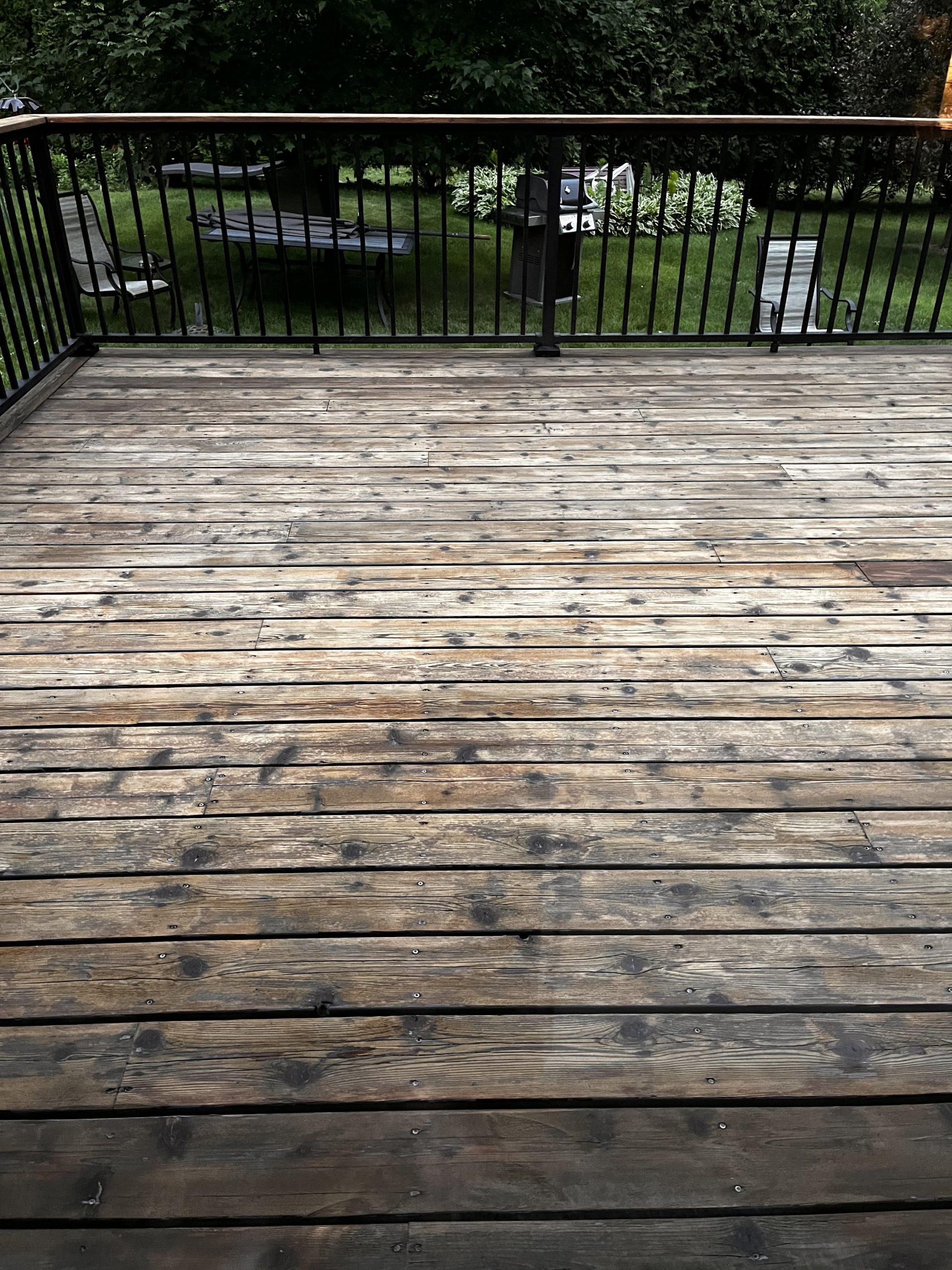

Question about Armstrong Clark. I had cedar deck prepped by removing existing stain (water based Benjamin Moore Arbor Coat) that was flaking off everywhere. Method to remove was sanding. When stain applied it looks mottled over most of the deck. The color used was black walnut and it dried really light like a natural cedar. Temp about 75 to 80 degrees in full sun. Can you offer any suggestion as to why this happened and if there’s a fix? Thanks
Add some pics in the comments, and what grit did you use for the final sanding?
this was done by a contractor and not sure of the grit. They didn’t appear to have experience with staining. I’ve done a lot of it but just had knee replacement and not able to do it myself. Thi was done yesterday. Today it’s raining. Can I put second coat on after it dries or should I just wait until spring. I’m really disappointed. I ordered a sample of stain and sanded a small section myself and it worked fine. I used 120 grit I believe for the test spot. I know you shouldn’t use any grit above that. The deck is repelling the rain so that’s a plus. Just doesn’t look as I had hoped
You cannot sand finer than 60-80 grit. 120 is way too fine a grit. It is hard to tell here if the prep was the issue or the application. It is very possible they did not mix it well before applying. Pigment does settle, and if not mixed correctly, it will not give a proper final appearance.
Try to apply a coat to one board after the rain stops. See if it dries better and with more color. If so, reapply to all wood.

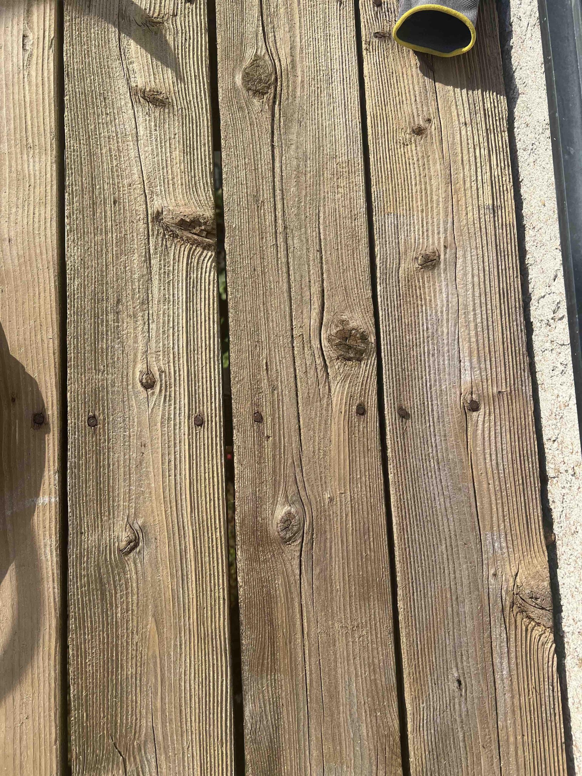

Not sure about grit. Here’s a picture

Freshly sanded deck of old stain . Bare wood now . What’s next step ? Deck wash or stain ?
How fine a grit did you sand? Tips on sanding:
80 grit was last grit used . Have finer if needed
Never finer than 80 grit. Clean and brighten for final prep. Then stain.

Good morning Scott – looking for some assistance on staining our second story deck for the first time. We purchased a fourplex in Kalama, WA (SW Washington; very rainy and mild temps) which has a 10’x27′ +/- second-story deck. Upstairs tenants raised the concern that deck is very slick and they have slipped several times. I recently cleaned the deck with Olympic cleaner, and now I want to stain and add some kind of an anti-slip surface, initially thinking mixing this product to a stain:
What is your recommendation on stain? Looking at historical satellite imagery, the deck appears to be 10+ years old. I care about what the deck looks like, but more importantly, I care about the safety of the tenants. Want it to be slip-resistant.
State: Southwest Washington (very wet and mild)
Sun/shade: deck is on west side of house. Sees full sun after noon, see attached image.
Type of wood: Unsure, pressure treated. Grey and weared. Structurally solid.
Mold/mildew: No mold. Possibly mildew makes the surface slick?
Previous stain failure: honestly I don’t know if it was originally stained. If so, its long overdue.
Type of stain: unknown.
Any advice is greatly appreciated, thanks!
The best stains are penetrating deck stains, such as these:
Since they penetrate into the wood grain (not film on top) they are not prone to being slippery. You cannot add a grip additive to a penetrating stain, only filming coatings such as solid color deck stains or paints.
No image was added.
Thanks Scott. You’re right. My apologies forgot to add pictures. Please see attached pictures for reference.
Good to know that I cannot add the grip additive. Assuming it will not bond appropriately since the stain will penetrate the wood grain and not sit on top of the wood?
Any further recommendations based on the attached pictures? If not, thanks again for the advice on the linked stains.
Have a blessed day,
You will need to do more prep. Do you have any pictures of the wood dry and a close-up of the floors and railings?
I will go grab some pictures tonight after work. This picture is before I cleaned with Olympic deck cleaner. I sprayed deck cleaner on in a couple coats, let it sit for 5-10 minutes, then hand scrubbed with a deck brush and warm water for about an hour. Several passes. Then rinsed with a hose. More to follow!
Here are some pics of the deck.
You still have an old stain on the wood that needs to be removed. You will need to strip, brighten, and use a pressure washer. Tips:

Hi there, I just replace the boards of my deck with fresh pressure treated wood in Ontario. Winter is coming and I’m curious if I can stain right away? I see some advice to wait 3-6 months but I don’t want to leave unprotected over winter with salt being used for snow. Can I use restoradeck? If it’s new can I skip to step 3? Thank you
No, you can’t stain right away. Wait until Spring to prep and stain:
Should I protect it in anyway from snow and salt? Its in the front porch
No need to
