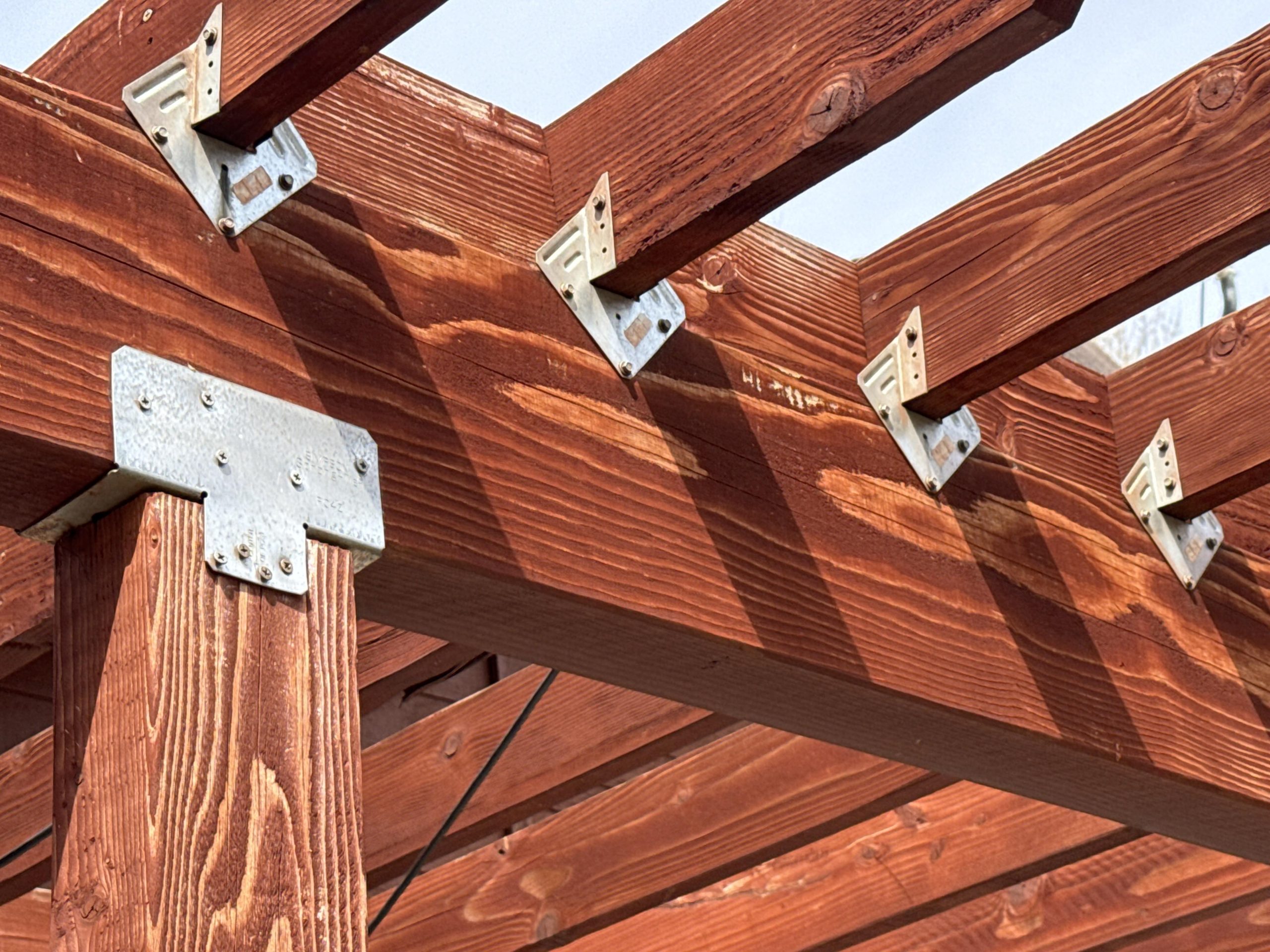

panicking, time is of the essence, supposed to be staining tomorrow, Sunday 3/29/26
Really hoping someone can pop a quick answer back 1133am CDT Sat 3/28
We have cleaned, brightened with the defy products which did amazing the prior two years – mistake made was that I was scared to use oil, so did water based clear sealer, which is the devil.
Finally flipping to oil now
We are doing all of this ourselves, have had a professional deck guy helping mentor us with advice
He looked at it and said that he thinks I should do more rinsing because of the white areas still showing in between the grain, still remaining after sanding with 80 grit on cedar-in Omaha Nebraska if that makes a difference
I am really dreading starting the whole rinsing process all over again, and waiting for low moisture content to 13% at least.
I have the time off these next several days to get this done before precipitation starts hitting us on Wednesday
Will you please look and tell me if you feel that it is necessary to do yet another rinse session, as I’m already 50 hours into this myself with physical challenges; and while I don’t wanna have to start the rinse process again, I certainly don’t want all of this time invested only to end up with residual leeching through the stain once supplied – if, another final rinse truly is needed.
we’re starting to wonder if maybe this person is hoping that we get frustrated enough to hire him to finish the job, although that’s not an option as we cannot afford it
I do know that the 1 post photo I am sending to you definitely needs to re-rinsing, it is clear that that layer is definitely bleaching through
But I am not convinced yet, that the rest of the deck and beams need an entire re-rinsing
And I do understand “furries” and that we do have some still present despite sanding
You are overthinking it. Looks good to stain now.
