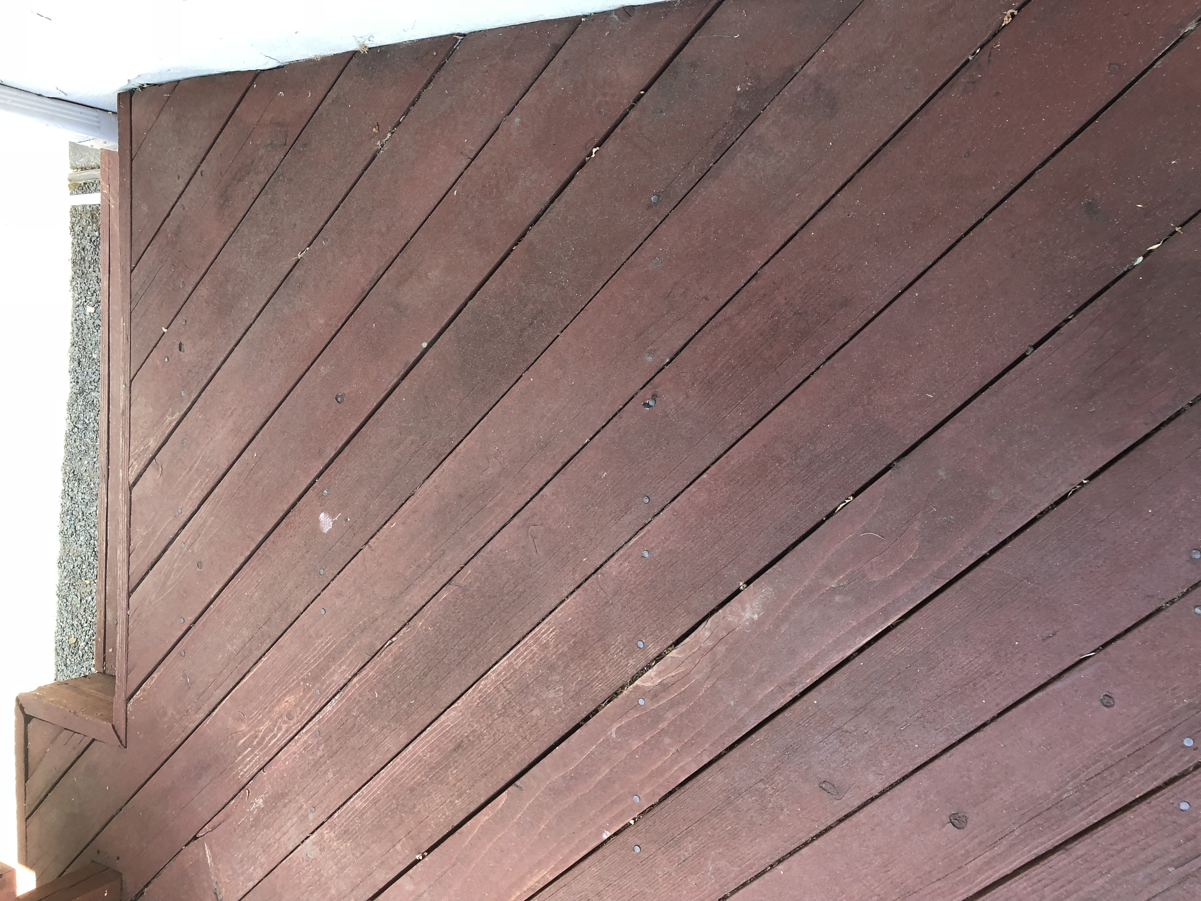

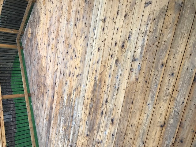

I have strip this deck with a stripping agent and pressure washer. Can I go to the neutralize part? I apply it by the instructions and some parts just remove a little,others totally.
It is not stripped fully in the pictures. You will need to strip it some more. Shoot for 95% or more removal. Brighten after.

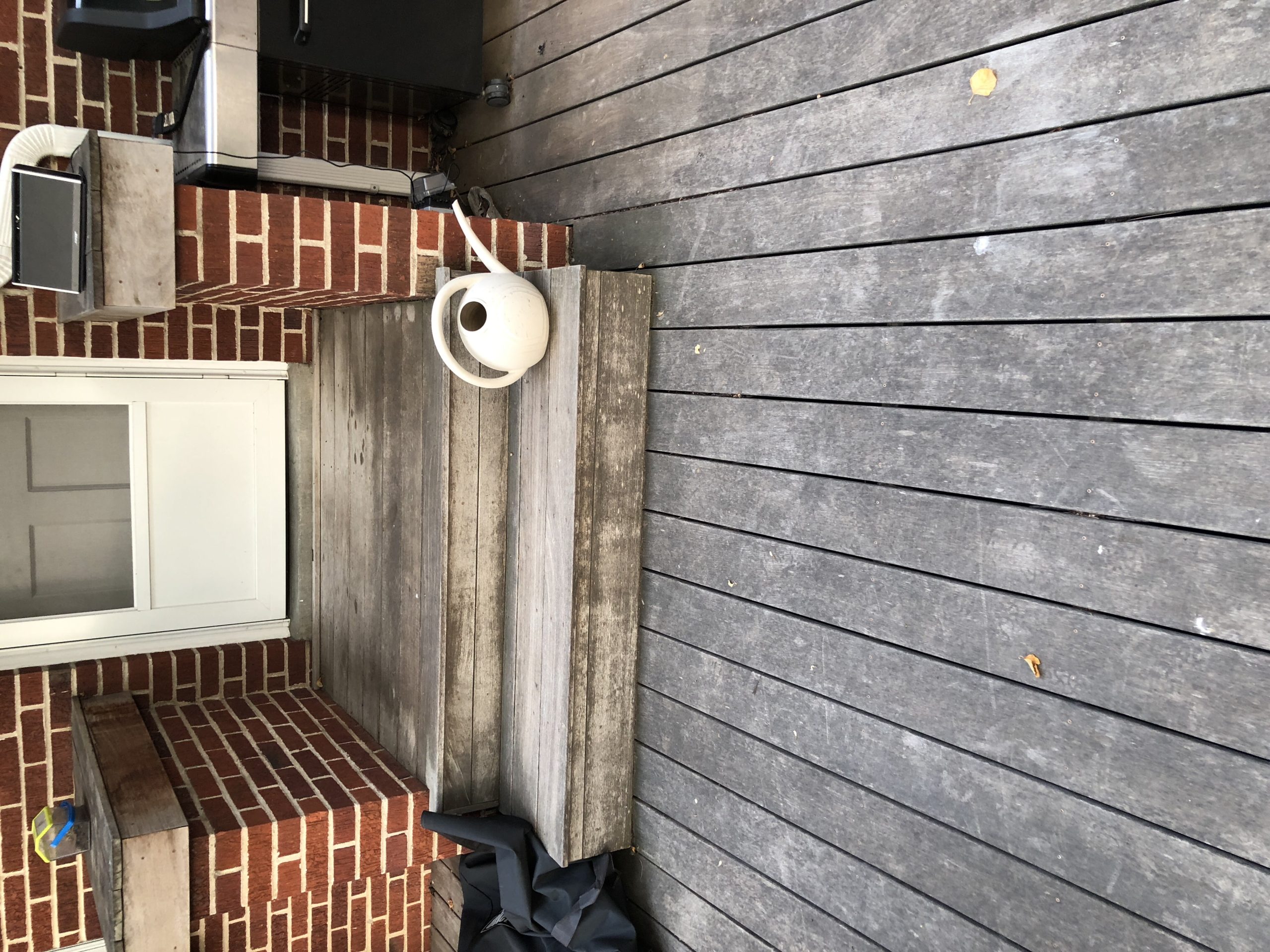

Hi. We have a deck made of some type of Brazilian hardwood. I was able to get a bunch of dirt and grime off using just water and a brush which makes me think we just need a cleaner prior to staining. What do you think? Here are a couple photos where you can see the cleaner part and some others. Thanks in advance! 🙂

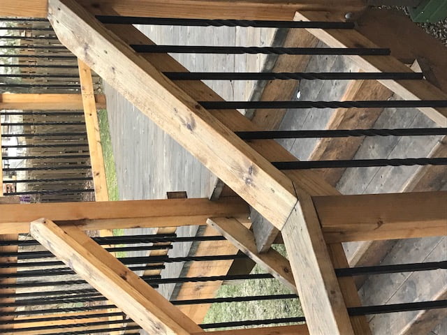

I have some photos. Please let me know.

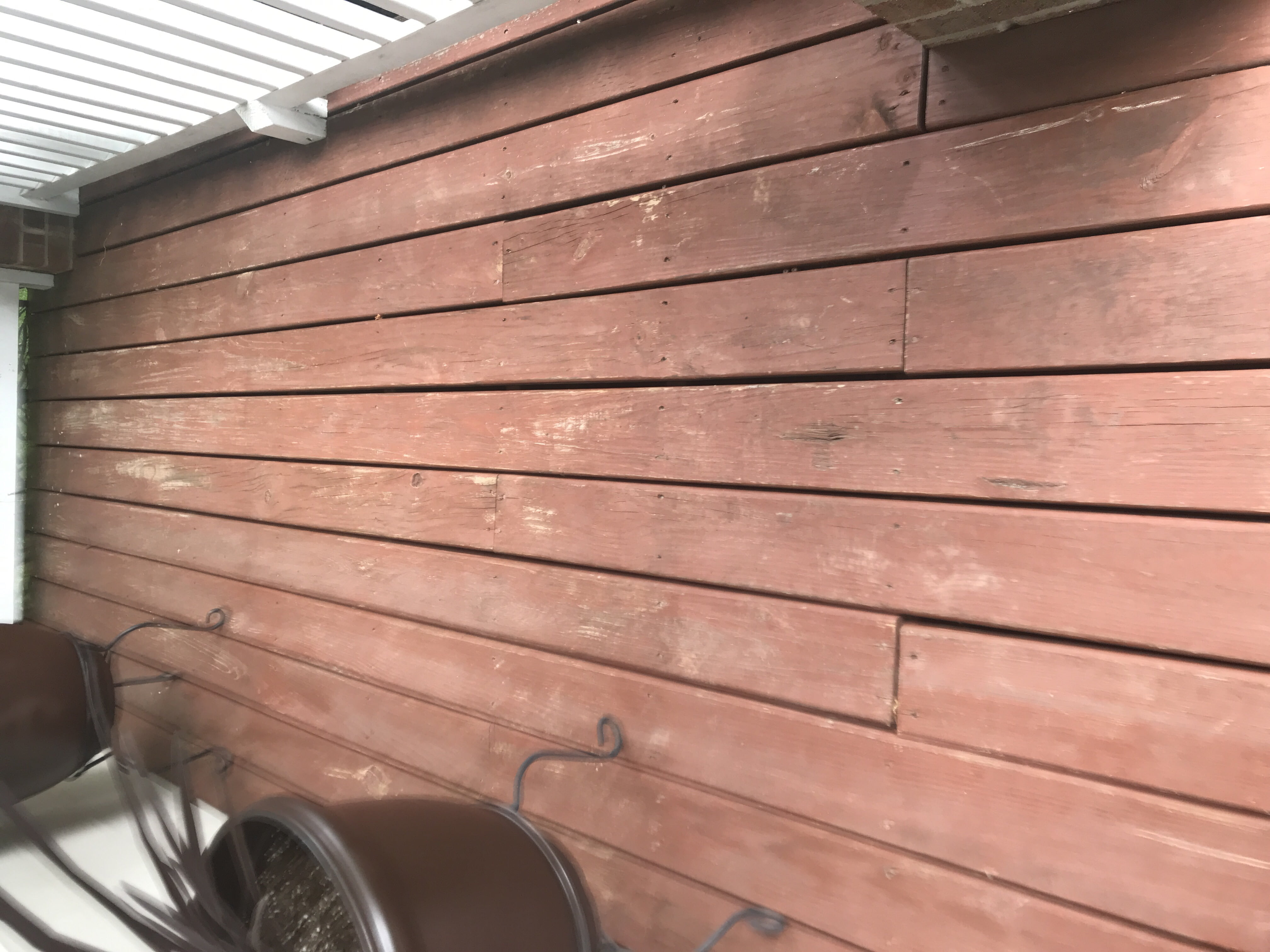

You will not be able to strip this current stain with and deck stain stripper. It looks like a paint or solid stain in many places and that means it will not come off fully. Your options are very limited based on this. You may need to cover all with a solid stain.
Thank you for replying me.
So, my option is sanding them except using stripper, and clean before solid stain? Is it really possible to stain a composite deck after just cleaning?
If it is, can you recommend a solid stain?
Thank you very much!
Yes. Correct. Use Flood Solid Stains.

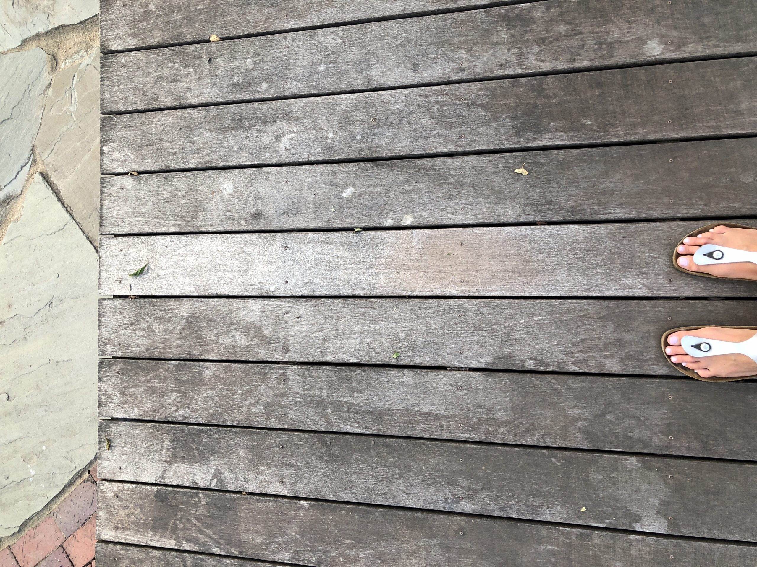

I’m a new home owner and it looks like it’s time to redo our backyard deck. I’m at a loss of where to start. Do I clean? Strip? Pressure wash? There are some green mildew spots in the areas that don’t get much sun. My aunt told me to use bleach but I’m seeing that this may not be the wisest decision.
Our neighbours tree has some cherries on it and they all fall on our deck so we have a bunch of spots. Our railings also seem to be peeling.
I’ve attached some photos. Any advice would be great! Thank you in advance
For the prep, use a deck cleaner and wood brightener kit by Restore A Deck. Pressure wash while doing this. Stain with the Restore A Deck stain or TWP stains after.

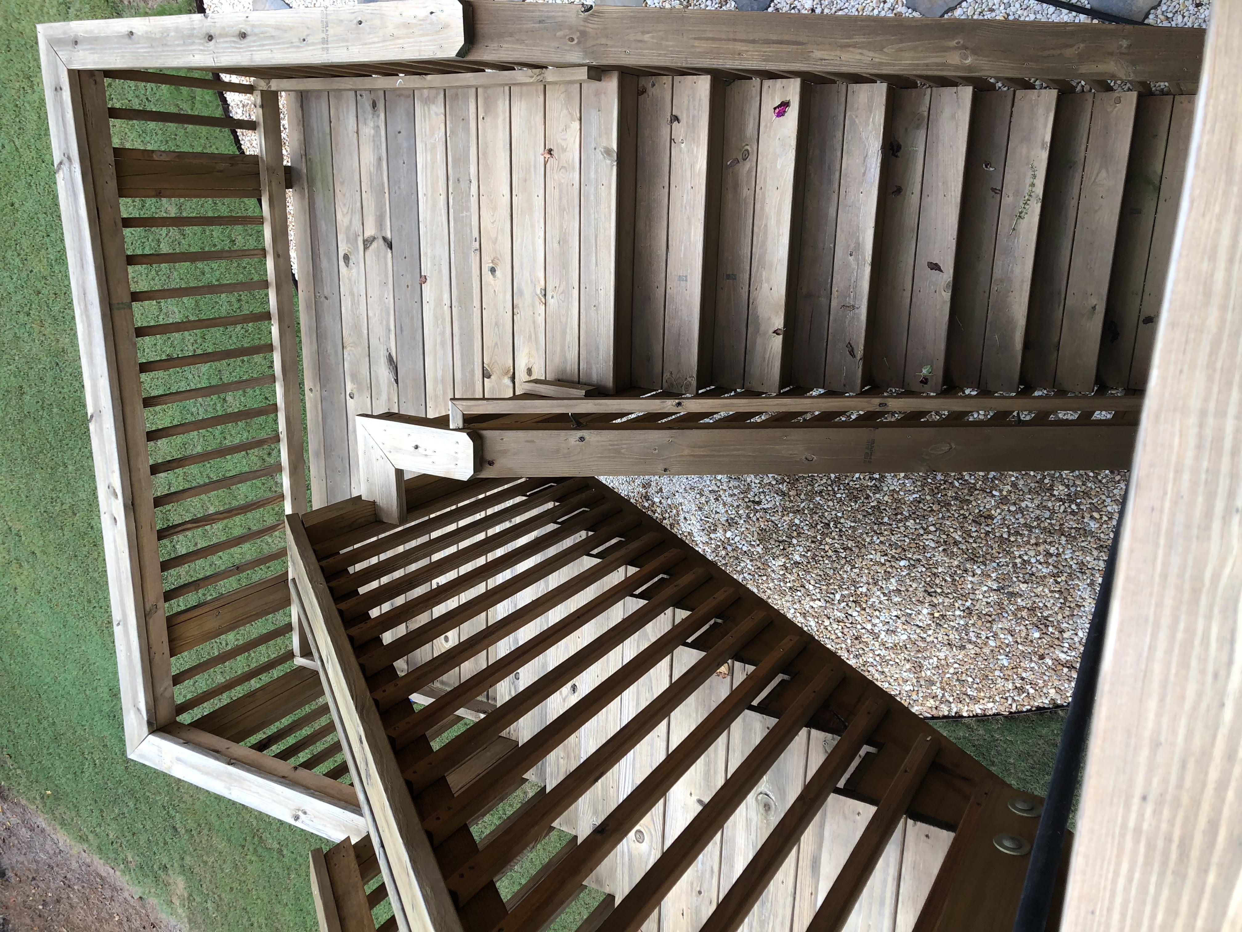

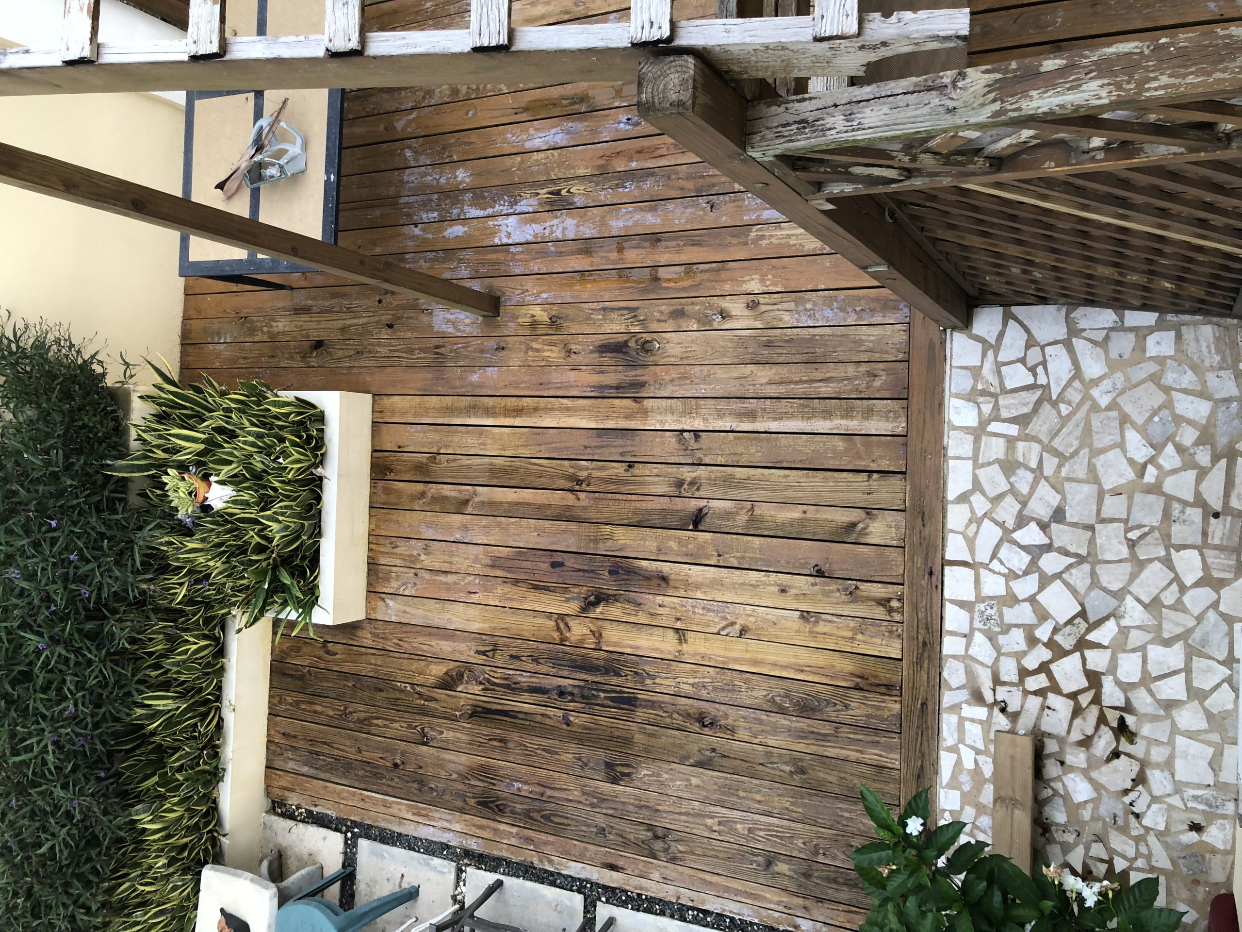

So i have been researching relentlessly and working to revive the deck on my new house. From what i can see, is the previous owner put some type of semi transparent polyurethane brown stain on the deck railings and nothing on the floor. The imgur album below shows pictures of what im dealing with. My question is should i just get new wood for the railings as they are so weathered cracked and poorly stained or is there some way to salvage them. I have been using stripper to get the parts where the stain isn’t sun damaged and cracked with a little success. I think i can use restore a deck cleaner and brightener and save the floor.
Bonus points if you can tell me what wood it is because i have no idea.
https://imgur.com/a/Bd9cJIm
Thanks for any help.
Looks like redwood.
Probably best to replace those railings.

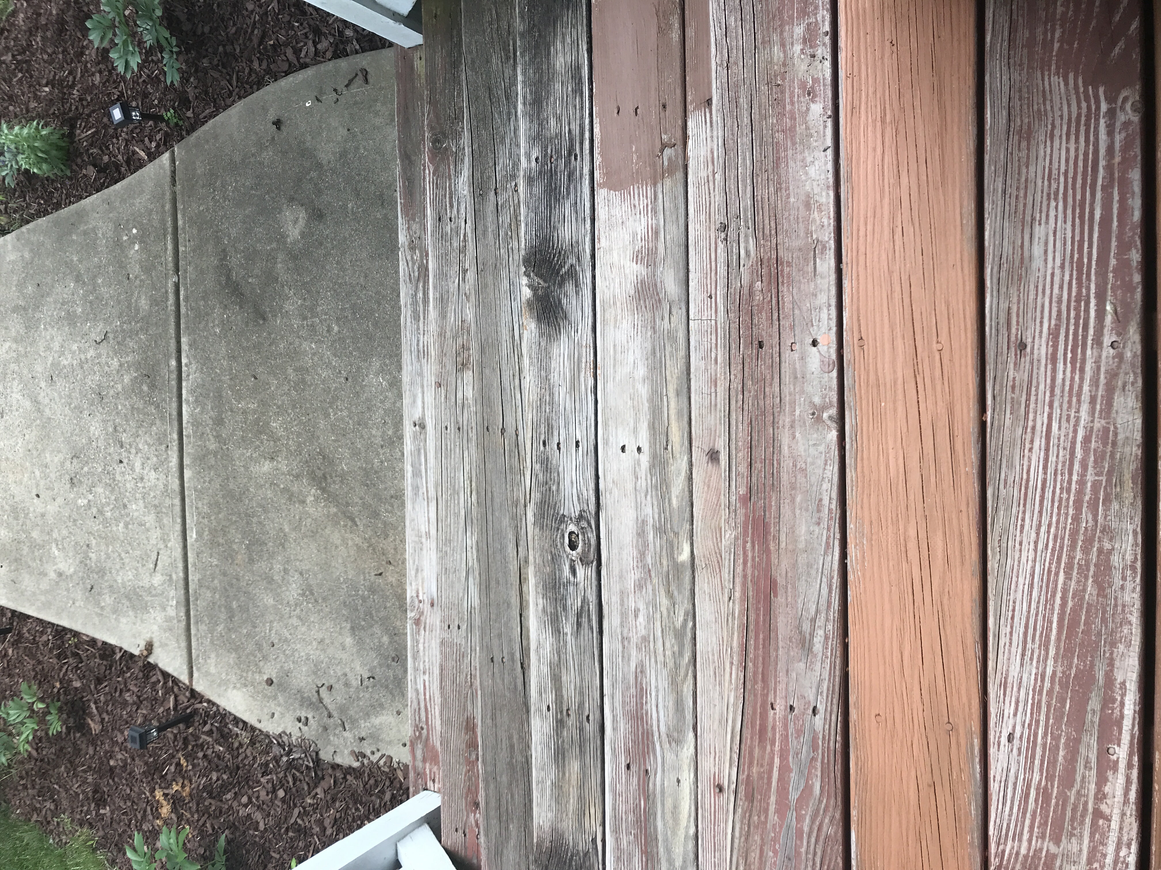

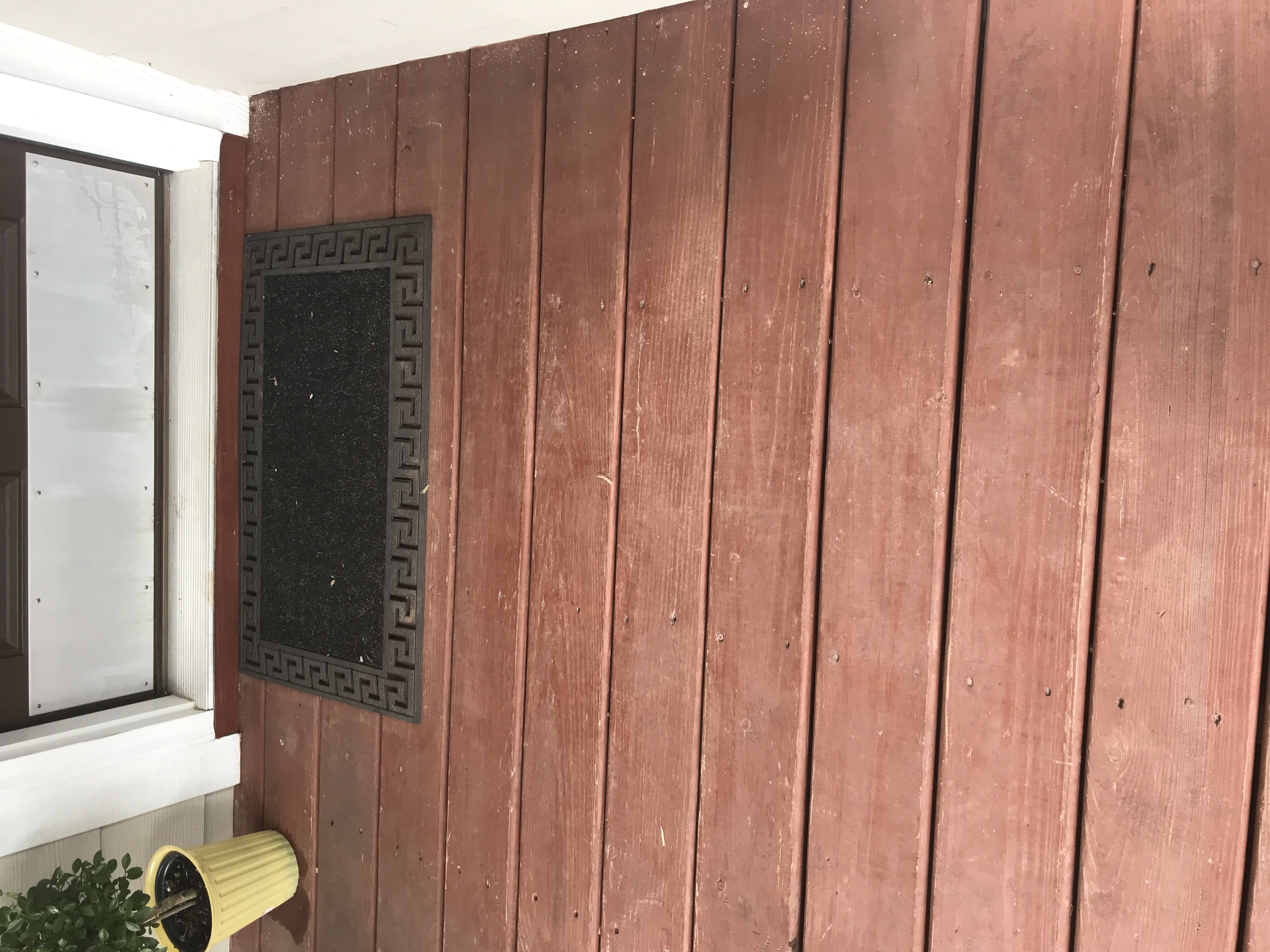

I recently moved into a house and would like to start properly taking care of the front porch. I believe it’s Mahogany; agree? I’m unsure what’s been applied to the porch previously, but there is a can of rust-oleum water proofing that was left in the basement. Two questions: 1) What prep process should I use (sanding vs. stripping/cleaning) and 2) what product do you recommend for staining (I’ve read that I should use some sort of penetrating oil for hardwoods). Thanks for the assistance!
Strip and brighten for the prep. Use the Restore A Deck prep products for this. As for the stain, try the Restore A Deck Wood Stain or the Armstrong Clark wood stain.

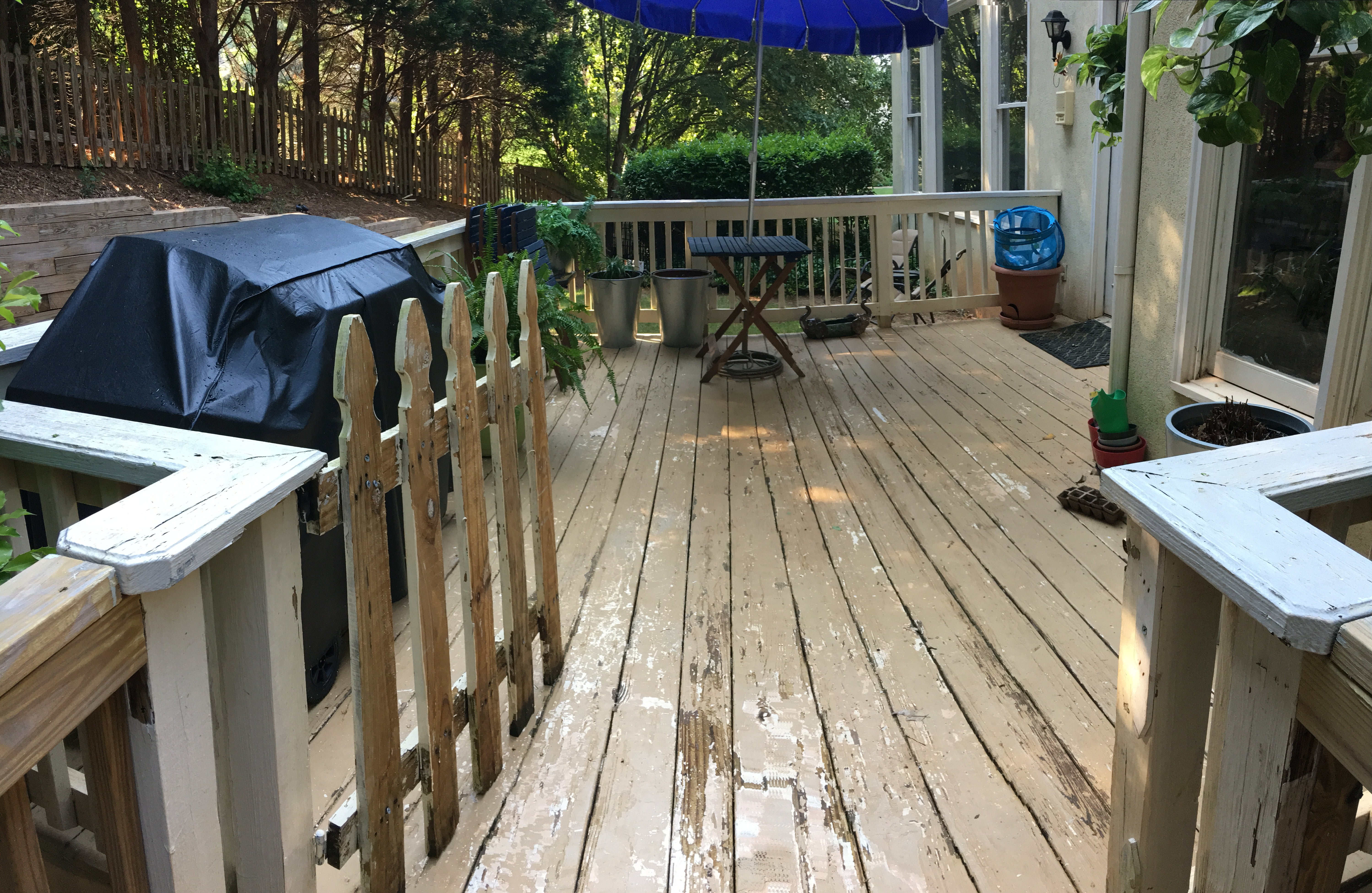

Hello, I cleaned 1/3 of this deck today with a pressure washer only. It took a lot of time to get the lichen off. My questions are: 1) should I use deck cleaner for the remainder of the deck? Since the lichen is so thick, I thought perhaps the deck cleaner wouldn’t penetrate it anyway. 2) I am going to finish with a transparent waterproofing wood finish. Do I also need to use a brightener? Thank you for your help!
A deck cleaner will definetly help make this job easier. Yes you should use a wood brightener.

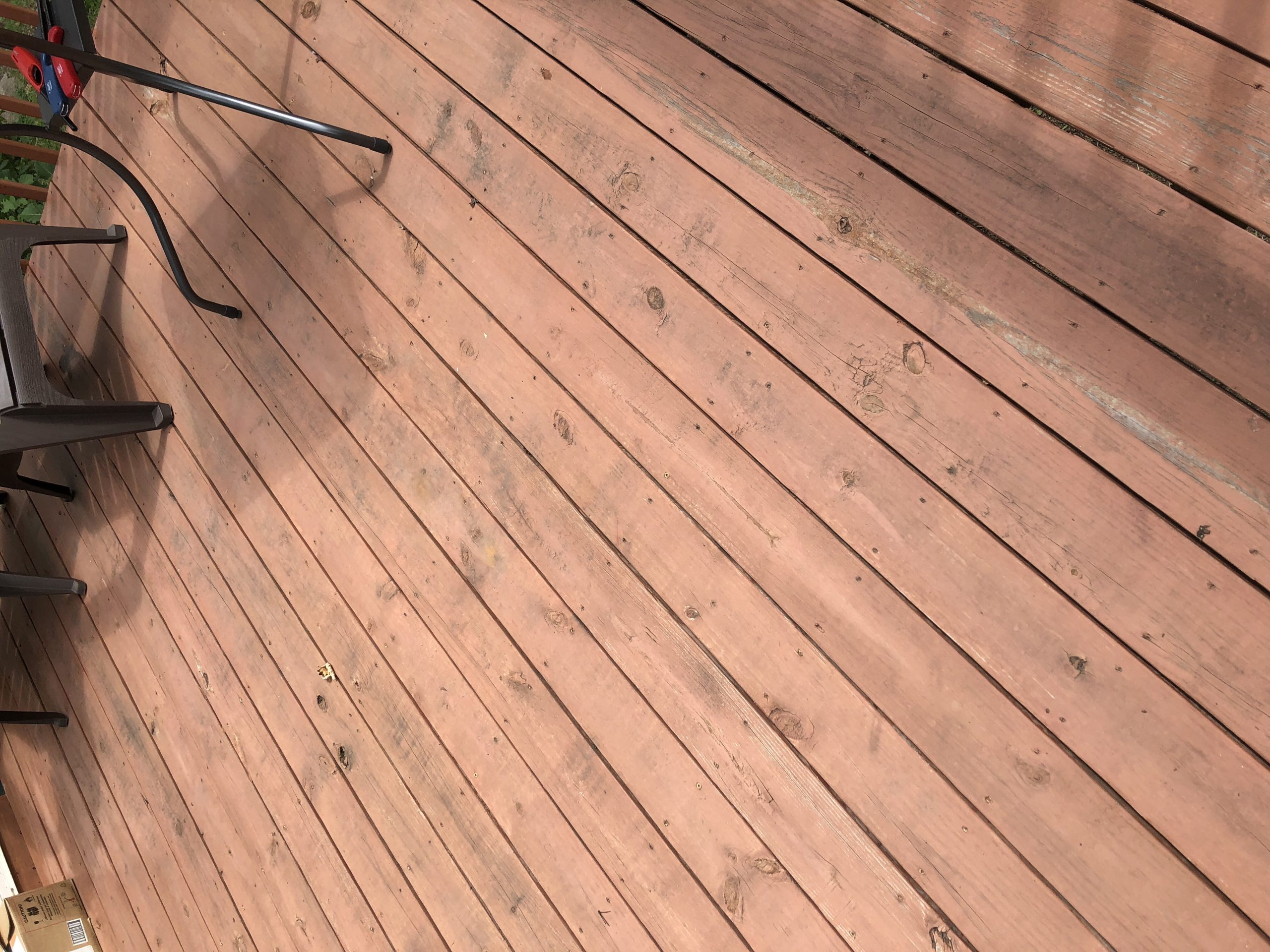

Our large 15 year old deck needs some TLC. The last stain that was applied was a semi-transparent stain. We just want it stripped, maybe a little sanding and re-stained. We keep hearing from deck businesses that the wood is in good shape, a few boards need to be replaced. Most of the deck people keep coming through and telling us re-staining won’t do the job, we should just clean it up and use an opaque stain. I’m sorry I don’t like these opaque stains, they are flat, the wood gets lost, aesthetically so unpleasing. I almost feel they just don’t want to put in the work. One deck business said it would be just as expensive to remove and re-staining as re-decking. I’m thinking my husband and I should just try doing it ourselves. We used to power wash it and stain it in the early years, maybe try a small section and see how it looks. What do you think about these opaque stains, the look, etc. and does a semi transparent stain really cause this much of any issue? Thanks, like this site.
Post a picture please. Sounds like they are not very good deck restoration contractors.

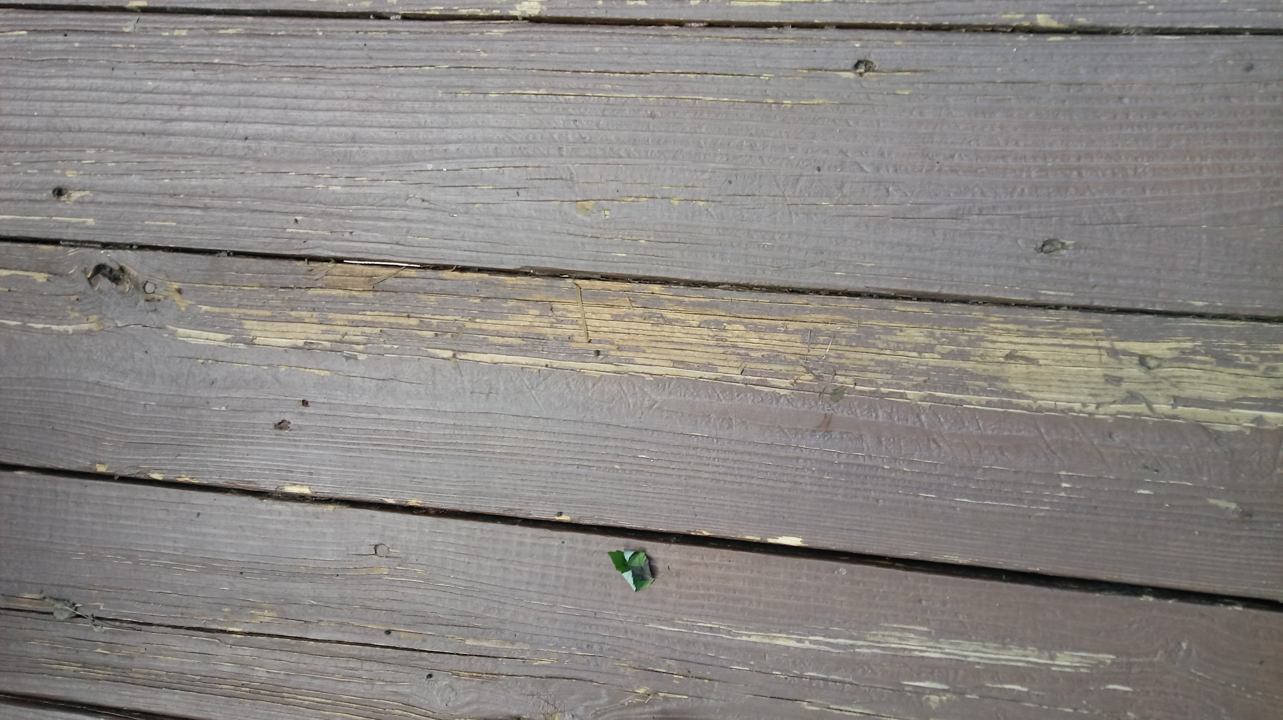

Took awhile to get back to this site. Here are some photos how the deck, including some steps, looked after we had it power washed. What do you suggest we do next, products, etc.. My husband would rather have someone do this for us as the deck is so large and we really don’t have the equipment or sadly the time to take it on. Should we be charged a large fee to do the work, how labor intensive will it be? We also want to make sure we articulate well what we know should be done, as I said we have been given advice all over the place from various deck businesses. We have a large deck. Thanks, love all your advice.
You cannot strip this and it is not semi-transparent stain. If you want to remove it you will need sand it off with power sanding. The other option is to clean and coat over this with a solid stain. Both options are labor intensive.

I have a small deck at the front of my home. As you can see the stain is peeling. I have asked advice of several people. Power wash? Strip? Clean? Sand? I get a wide variety of ideas. What are your thoughts?
Stripping will remove some but not all. You will need to sand this off.
I have a Mahogany deck that we used to stain with Cabot Mahogany flame. I had no complaints other than the color getting too dark after many years. I sanded the deck and tried BM Arbor Coat water based 2 part transparent. What a mistake. It didn’t hold up a year. ( I live in Massachusetts – tough winters ). Last year, I chemically stripped it and used BM Oil Based Translucent. One year later, after a light pressure washing with Jomax, it’s a mess again. I’m thinking of using Armstrong Clark this time or maybe the Cabot modified oil? Thoughts? Do I need to strip it again or would a brightener be enough since it’s been cleaned already.
You will need to remove the BM by stripping and then a wood brightener. As for the stain, try the AC in Mahogany color. It will be very similar in color and performance to the old Cabot ATO Mahogany Flame formula.
Hey guys! Should I be using a stripper and then sanding? The deck is flaking a bit already. Or Power Wash?
You can strip some off but you will end up sanding to remove is all.
Thanks! Should I just go straight for the sanding then?
Will do! Appreciate you taking the time to answer. Any specific grit for the sandpaper?
Start with 60 and finish with 80 grit.
Once I sand with 60 then 80 grit, should I use a RAD kit then brighten? Or can I just go straight to staining?
Yes. Lightly clean and brighten for the final prep.
We bought a home 7 yrs ago with a 20-yr old redwood deck that had been treated with something that resembled a paint. It was weathered and peeling so we stripped, used RAD, and then applied TWP. It was a huge improvement, but we opted to sand the surface 2 yrs ago to smooth out the raised grain and apply TWP again. We were happy with the results. It’s time again to do the deck, and since we are not planning to sand this time around, we are wondering if we should simply use RAD and apply TWP like we did the first time. Thanks so much for your advice!
Yes that is correct. Use the RAD kits for the prep.
I have cleaned our deck boards and 90 percent of the previous stain is gone. Should I sand the remaining spots? With what? Also, I have 4 new deck boards that have been weathered about 3 months. Is there anything that can be done to help the stain soak in any better so that it will match the older boards? All boards have been cleaned and brightened with restore a deck. I’m using Armstrong Clark semi transparent Black Walnut
New boards will always be lighter in color the first time staining. Nothing you can do to make it blend perfectly but it should be close. Sand or strip to remove all the previous stain brand before applying the AC.
My son has a large pressure treated deck that is only a few inches off the ground. Anything we have used in the past just flakes off. Is there a stain that would work or is it impossible due to the moisture in the ground.
Post a picure please. What stain brands where used before?
A Big Box Stain and also that magic product they advertised to cover everything, more like a thick paint. It didn’t make the summer.
You ae using coatings that film on top of the wood and that it the main reason it is having issues. Sand off the remaining, clean and brighten for the final prep. Stain with TWP or Armstrong Clark stains. Both are penetrating coatings.
Would Restor a deck stain work as well. I believe it is water based.
Yes, but you would have slightly better penetration with an oil like the TWP or AC.

Good day! Bought a home and owners did not maintain deck. It looks like there are two different colored layers of paint – one white layer covered later in by a taupe layer. Does not appear to have been done properly at all. My plan is to strip both layers, pressure wash, apply a brightner and stain with TWP 100 cedar. My question is what is the best stripper and brightner for this? Also is TWP 100 the best choice? We live in GA, deck oringinal and likely around 22 years old. I’m not sure what type of wood it is. It’s mostly shaded and only receives direct sunlight for 2-hours daily at high noon. We have a few days of Snow- let’s say 5. Heat in 80s – 90s during summer. Attached are photos. Note: one side with wheelchair access was added later and is unpainted.
This cannot be stripped effectively. You will need to sand to remove. Brighten after.

Hi! I have a cedar deck build in Oct 2016. In July 2017 it was sealed with blue label penofin. As you can see from the pictures, the deck turned very dark (except for what was under the rug of course!) We had it pressure washed (no cleaner – just water) and the last picture is the result. Most of the penofin is flaking off – except for what was under the rug. I want to start over and would really appreciate your advise on the following:
1. What should I use to remove the penofin? Do I strip or clean? Do I need a brightener? What product would be best to use?
2. If using a stripper/brightener method – how do I get the posts and rails? And what precautions are necessary to avoid damaging the metal spindles?
3. Will I need to sand the deck as well?
4. What product would you recommend to protect the deck once I have it back to the original state? I’m hesitant to use penofin again, but want to make sure that what I use is good for cedar and will help maintain it’s beautiful color (i.e. my preference would be to use something that’s transparent or semi transparent)? I live in Illinois and the deck is partially shaded, but does get the afternoon sun.
5. Based on the product recommended, what is the advised maintenance plan going forward?
Thank you so much for all of your help!!! There is so much information out there and it’s not easy to navigate!!
1. Strip and brighten with Restore A Deck Kits
2. It probably will not harm those spindles. Test first though. Pump spray on and pressure wash off.
3. Most likely no need to sand.
4. Penofin always turns black Try the TWP 1500 stains.
5. Redo every 2 years. Clean and brighten for the prep.
