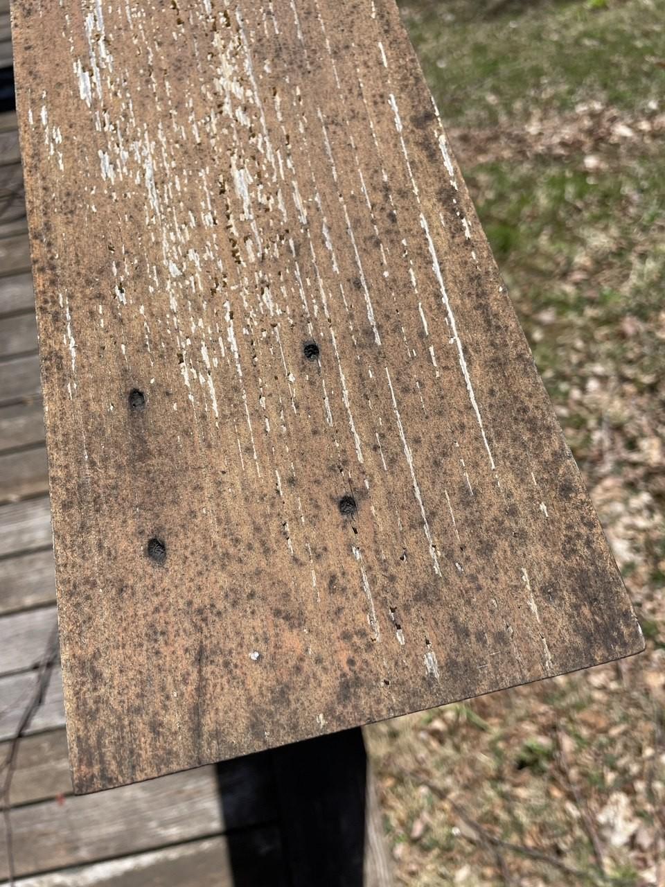

Hey Scott, thank you for all the great information and help! Our property is lake front, so I was hoping not to use harsh chemicals on this project. I used a random orbital floor sander to try to remove as much as I could, then was intending to use sodium percarbonate to clean and then brighten. I am worried what stain remains on the deck may not come up in the cleaning process and become an issue down the road. Do you recommend that I use a stripper for this, or do you think cleaner would be sufficient? Thank you!
You have two issues. One is some old stain that has not been removed from the knots. That should be fully stripped off first.
The bigger issue is you sanded off the protective coating from your screws in areas, and you now have black rust stains. A brightener will remove the rust stains in most cases, but they will come back once it rains again, so you really should replace all your screws first and then remove the black rust stains:
https://www.deckstainhelp.com/remove-rust-black-stains-from-deck/

I have been using Thompson’s Waterseal Advanced in Honey Gold for many years, last year I covered the deck but it did not last. I assume this was because i never “cleaned or stripped” the deck only pressure washed. I am wondering what is best to do before I attempt to cover again use a deck cleaner or a deck stripper?
Post some pictures of the deck.
See attached
You should strip it all down and start over. Use the Restore A Deck Stripper with both additives: https://www.deckstainhelp.com/restore-a-deck-stain-stripper-booster-thickening-gel-review/
Is pressure washer required for the stain stripping process or it’s optional and I can just use a stiff brush and a garden hose?
Pressure wash.
