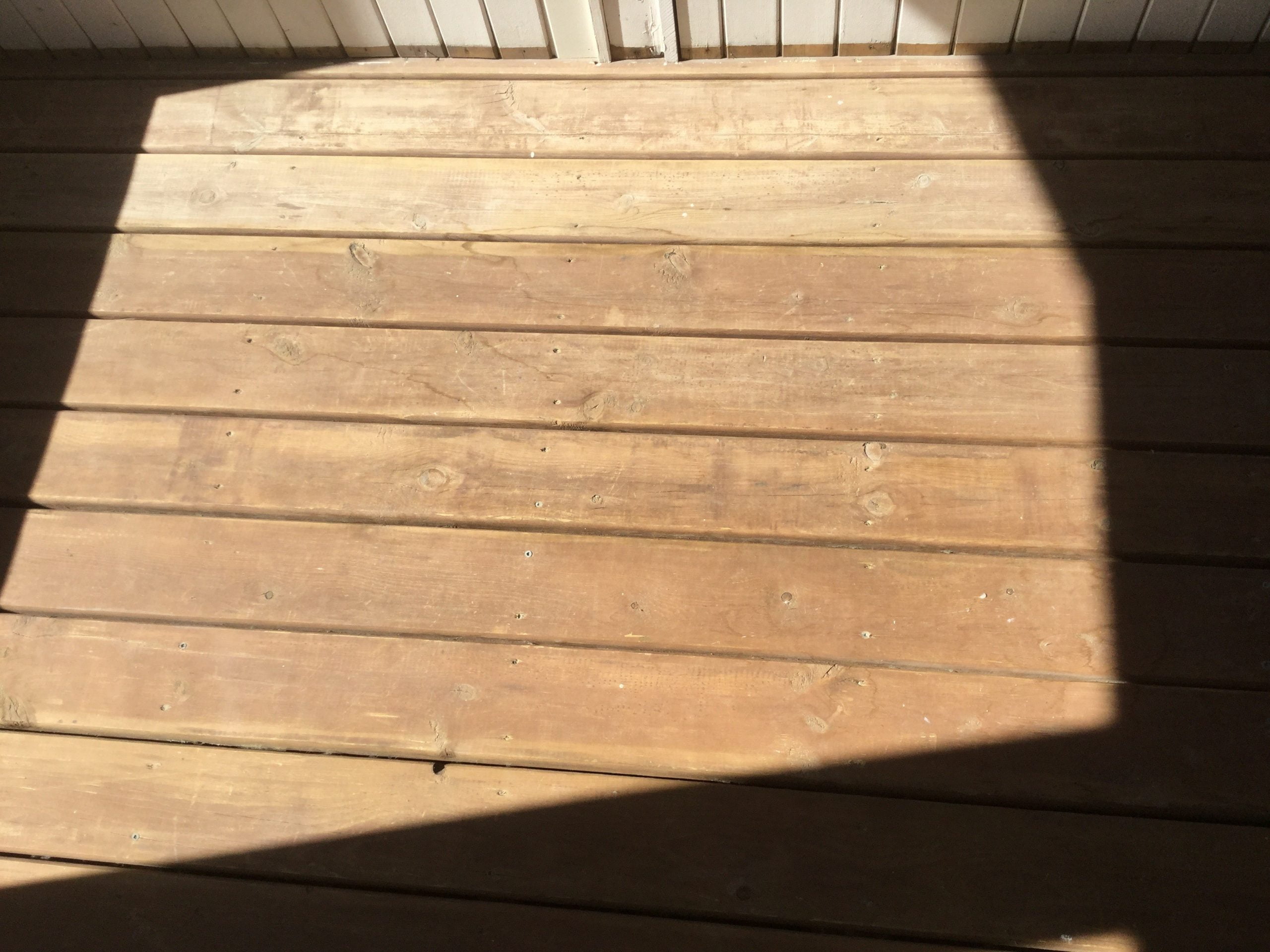

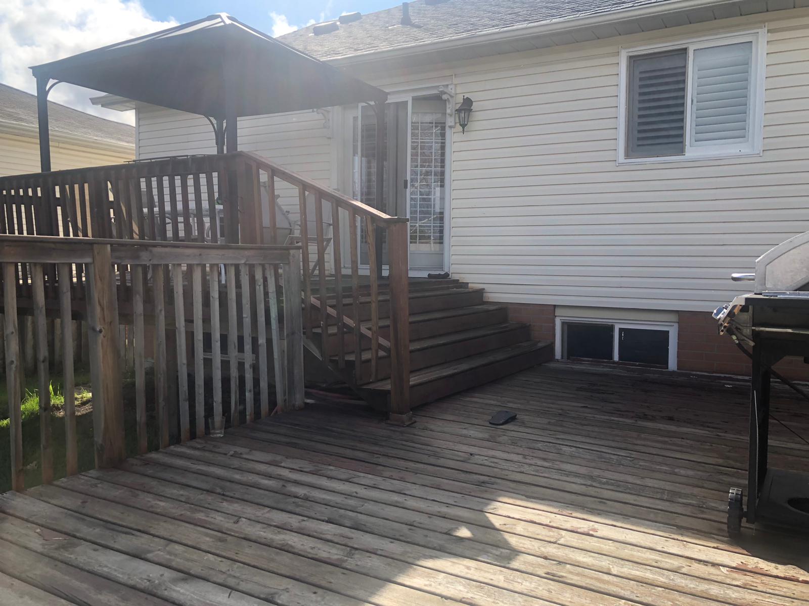

Hi, Can I get your advice on this cedar deck. I am not sure what has been done or what product types used, but its peeling, since this pic. I powerwasher it and now more stain has peeled almost like paint. Should I strip it or sand it? Your advice is greatly appreciated. Kathy
You have a solid stain. If you want it to look more natural, then you will need to remove fully by sanding. Other option is to remove just the loose stain and then cover with another coat of solid stain.

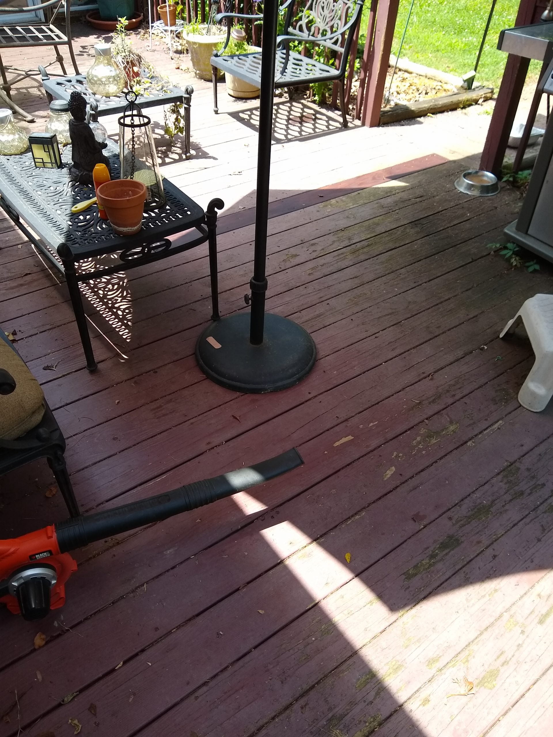

I have a behr semi- transparent tint stain on my deck and I want to apply a new semi-transparent stain it’s been 2 years since I applied a coat what’s the best way to prepare the deck
Send pictures of deck please.
Here is deck picture
Strip and brighten the wood for prep. Use the Restore A Deck stripper with both additives and then brighten the wood: https://www.deckstainhelp.com/restore-a-deck-stain-stripper-booster-thickening-gel-review/

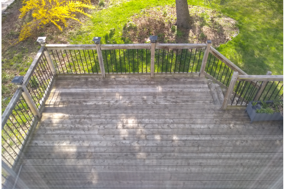

We have a large screened in porch and deck that was built with pressure treated pine 2 years ago. After waiting several months it was pressured washed and stained with 1 coat of SW semi-transparent stain in a dark “charwood” color. Though not a great product we will probably stick with it for a second coat bc of the sheer size and investment we have already put in to it. The screened in portion is fine but open deck is absorbing moisture and showing signs of green and black discoloration as it is under trees and shaded a lot. Since it is new and only been stained once we know it is time for another coat. Because the color we chose is dark and because the interior is holding up fine we would like to leave it as is and only redo the stain on the exterior. For color consistency on the outside this means doing the open deck, stairs, and all exterior framing of the screened in porch. I’m getting conflicting info from painting companies regarding cleaning vs. stripping. To keep the color from darkening too much with a second coat on the outside I like the idea of stripping but I’m worried trying to apply the stripping agent on the exterior framework on the screened in porch will inevitably harm the interior framework of the screened in. The company tells me they will cover the interior with plastic but covering the framework around the screens so nothing is sprayed through seems nearly impossible to me. This company tells me the stripper is necessary with semi-transparent bc there is still a “sheen” on some of the framework (but the open decking, stairs, and rails, have definitely lost their “sheen).” Other company’s tell me stripping is not necessary.
Send pictures.
Pictures
You should be okay to clean and brighten for prep unless the finish has worn off unevenly on the floors. If so, stripping would be best.

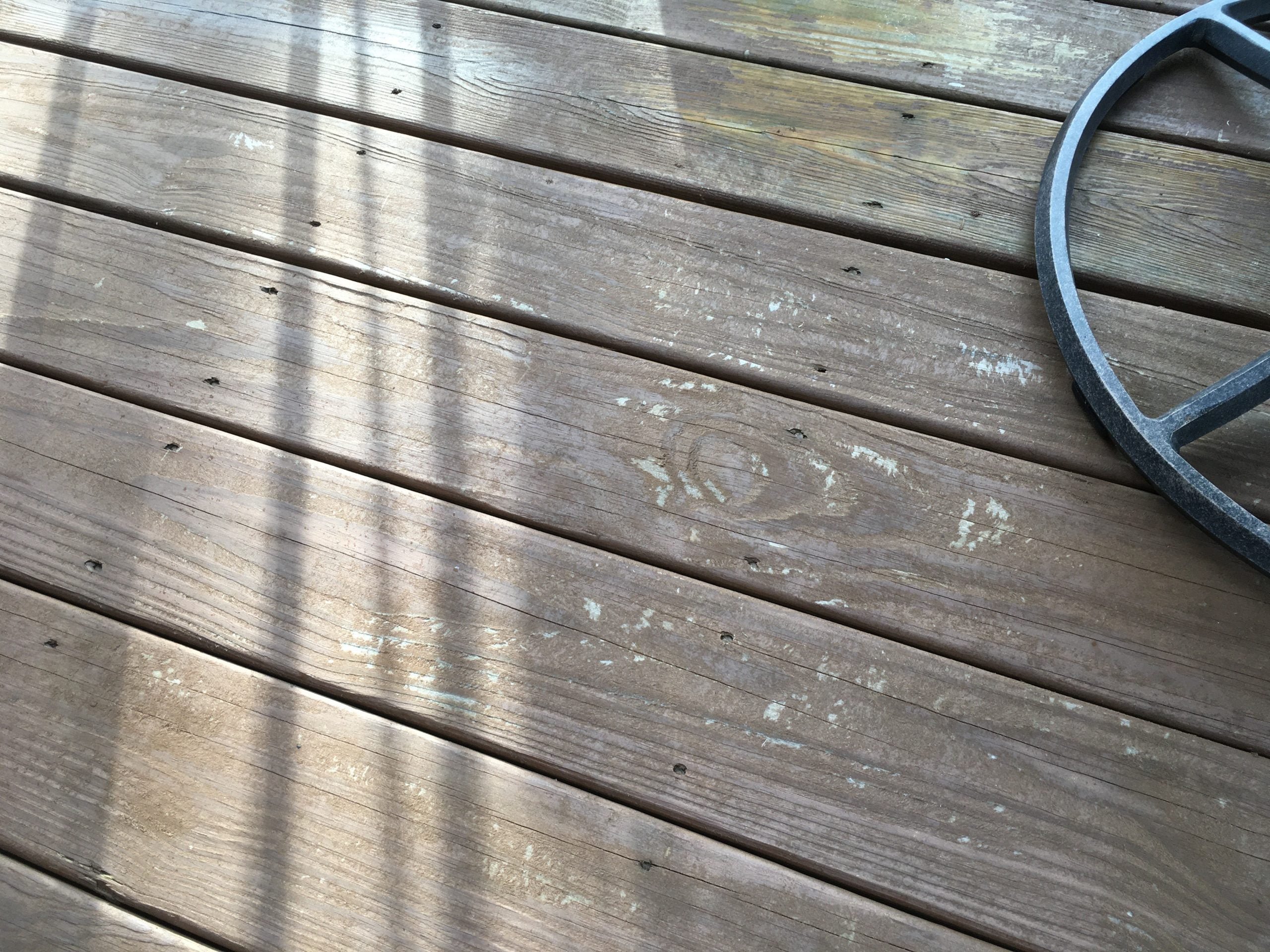

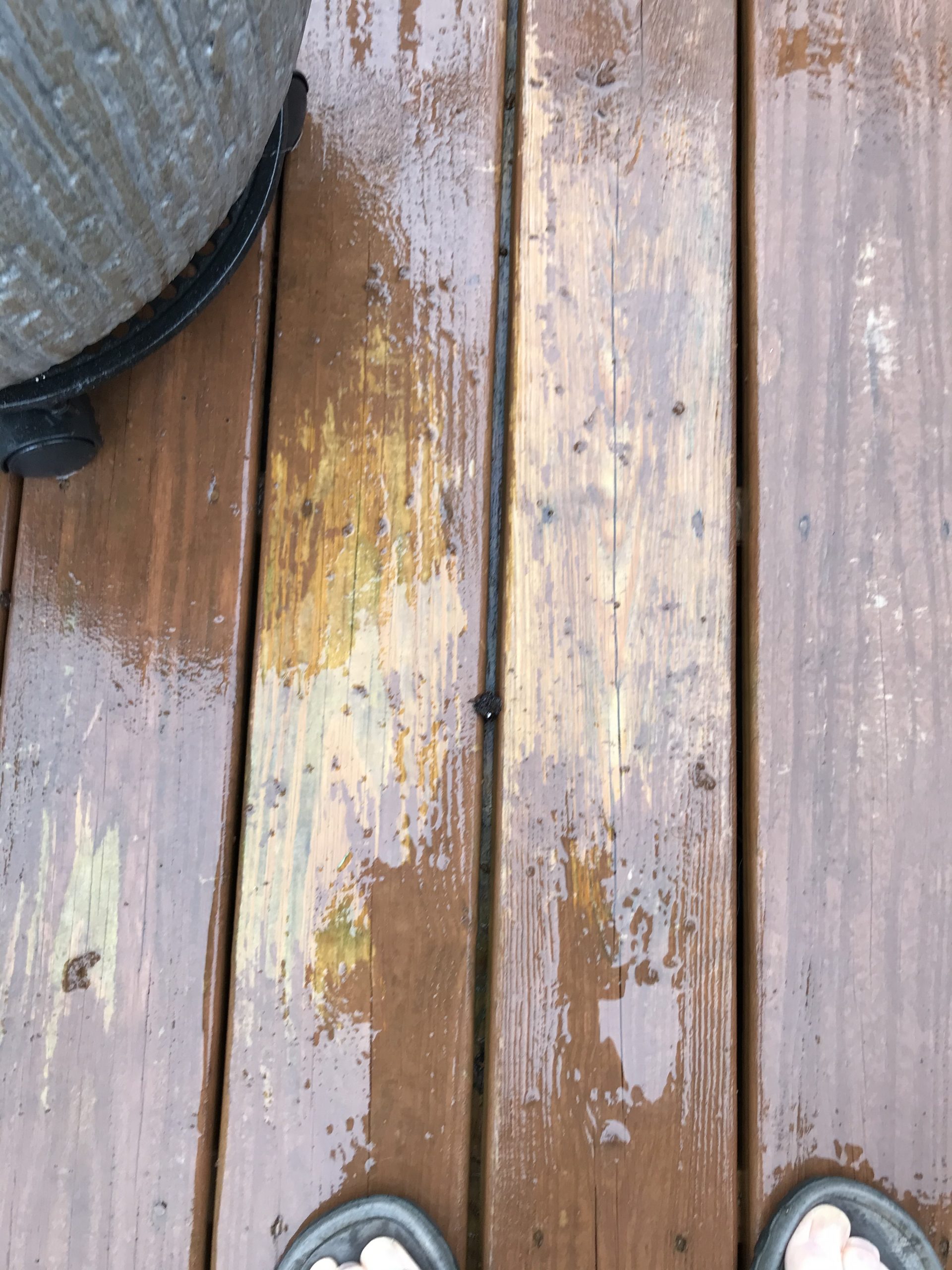

Please help! I bought a heavy duty stripper and still have spots that will not come off (the wood is very uneven so sanding doesn’t do much either).
You have a solid stain or paint. That cannot be stripped fully so your options are sand it all off or go with another solid stain to over what cannot be removed.

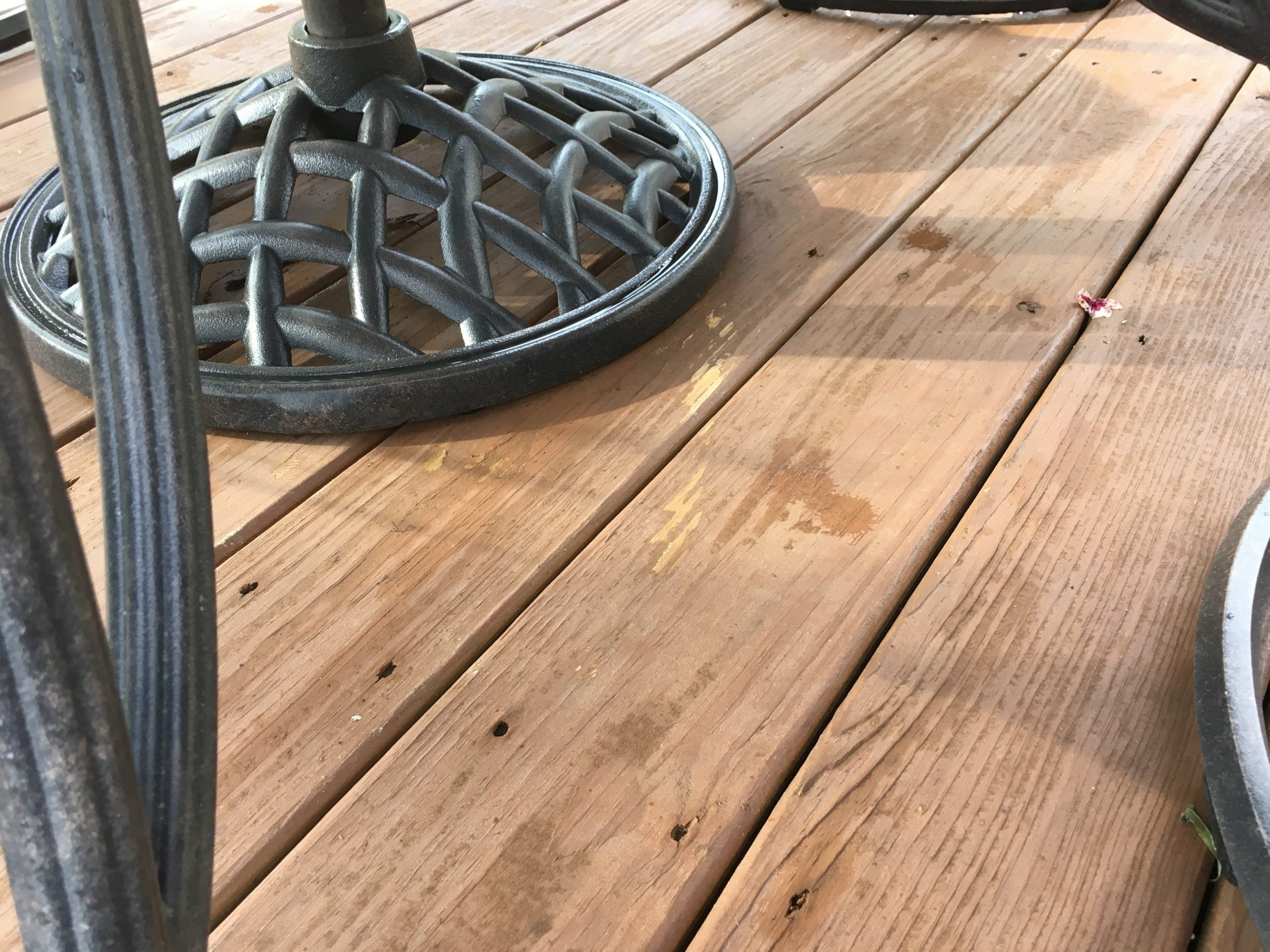

Hi, I applied Thompson’s clear coat on my patio yesterday and it darkened it considerably, which I absolutely hate. (I should have patch tested). What can I use to get it off and restore the wood to its original color? Thanks.
The first pic is what it looks like after the Thompson’s. The 2nd pic black portion is what it was when I moved in and the light area is after cleaning. I wanted the eood to remain that light.
Use the RAD Stripper and Brightener kit to remove: https://www.deckstainhelp.com/restore-a-deck-injectable-deck-stain-stripper-review/

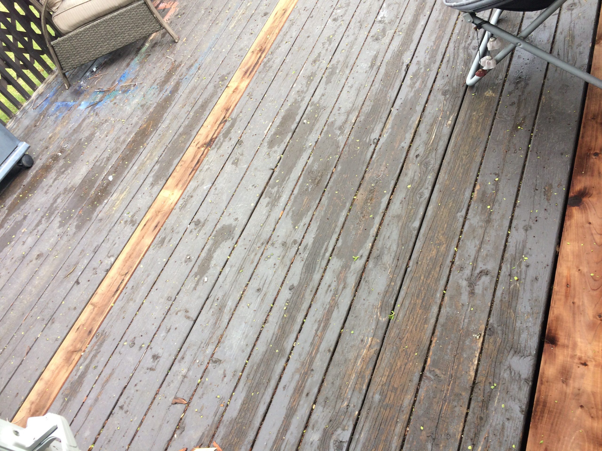

Deck location: Oregon. Southern facing deck – tall trees start blocking sun around 2pm. Cedar deck, been around a long time.
Progress to date: Pressure washer, Simple Green Deck Cleaner and bristle brush, wood filler (where needed) and 100 sand paper applied. No stain yet.
Stain to be used: PPG “Sikkens” Black Oak (just a dark color)
Issue: struggling with getting ALL the old stain off – especially in boards underneath railings. Really inconsistent stain removal, even though applied evenly throughout process. Wanted to get some input here before putting on stain. Any thoughts of whether it’s ready for stain or needs a stronger method of stain removal?
Photos posted in reply to this.
Photos here
Wood filler does not work on decks and deck stains. It will not blend when stained. Just an FYI that the filler will stand out and look white under the stain.
You should use a stripper and pressure washing on the deck to remove the rest of the old stain. Brightener after.

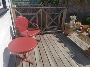

Clean or strip?
New house, old deck. We renovated shape and added new railing. From the little bit of color left, I imagine it’s been stained before. I prefer the beautiful natural look of Cedar but don’t want to reseal every year so will probably use semi-transparent stain. Any thoughts on best prep approach and then stain to tie it all together? Thank you!
Strip and brighten the wood for prep. Then stain with Armstrong Clark or TWP Stains.

Hi, what about this deck? Stripper or cleaner? I went to the shop and they gave me both, but I am wondering if just one of them would be enough. Thank you!
Strip and brighten.
Our screen room floor was made with brown pressure treated lumber about 10 years ago. The high traffic areas are faded. It has not been previously stained. What would be the best way to prepare the surface for stain so that we get even color?
You have a stain of some sort on there so strip and brighten the wood for the prep.
Pretty sure there is no stain, just the pressure treating. Will strip and brighten work for that?
There is a stain of some sort in the pics. Strip and brighten.

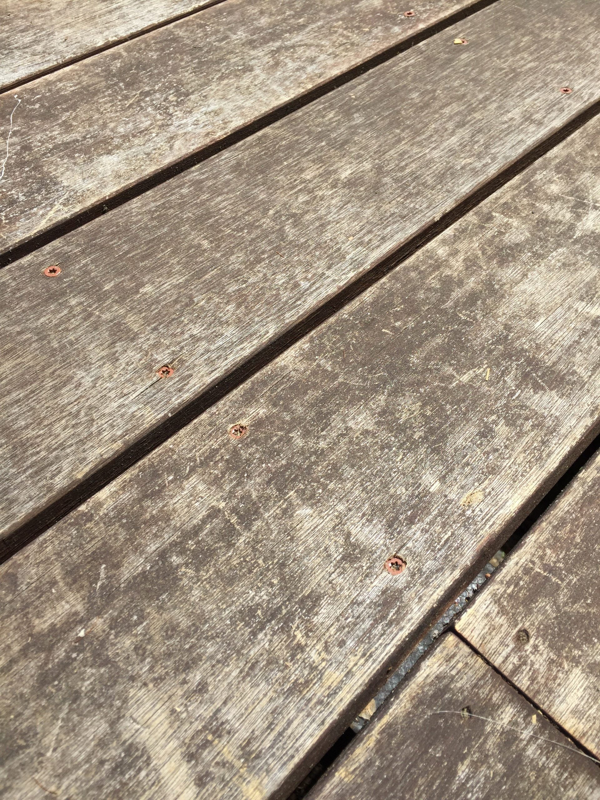

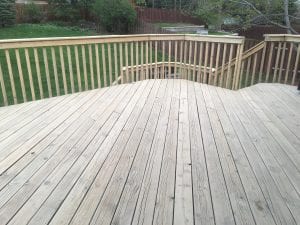

This small deck can’t be more than 5 years old. I have no idea if it was ever stained but I’d like to protect it. I can see that there is mildew/mold. If I don’t know if it was stained previously, is it best to strip it?
Here’s another
No need for a stripper. Clean and brighten the wood for prep and then stain: https://www.deckstainhelp.com/the-5-best-deck-stain-reviews-and-ratings/

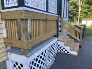

I bought this house a year ago and the deck was in dire need of repair. I’ve replaced several of the rotted boards, but was wondering what you’d suggest with regards to the pre stain prep. The stain on their has peeled off most of the boards but has some stubborn spots.
Thanks for all the help.
Strip and brighten with the Restore A Deck Stripper: https://www.deckstainhelp.com/restore-a-deck-injectable-deck-stain-stripper-review/

Hello! I moved into my house 3 years ago and have no idea what was used on the deck or railing. We have powerwashed the deck and the below pictures are what it looks like afterwards. I know I’ll probably have to strip, brighten, and stain, but don’t know which products I should be using.
We will be replacing the deck railing so do we need to wait to stain that? If so, will we have to use any other products before staining?
Thank you in advance!
This is not an easy strip. Use the Restore A Deck Stripper with both additives. https://www.deckstainhelp.com/restore-a-deck-stain-stripper-booster-thickening-gel-review/
Once done, sand off the stubborn stain that cannot be stripped. Brighten all wood after. See this for new wood for the rails: https://www.deckstainhelp.com/staining-a-new-deck/

I stripped a solid stain off my cedar deck and then sanded the entire deck. There are still grey spots near the knots. Cant tell if its stubborn stain and i need to strip again or if its something else and a cleaner and brightener will finish the job?
Additional photo.
It looks like old gray solid stain around the knots. Strip and or sand to remove.

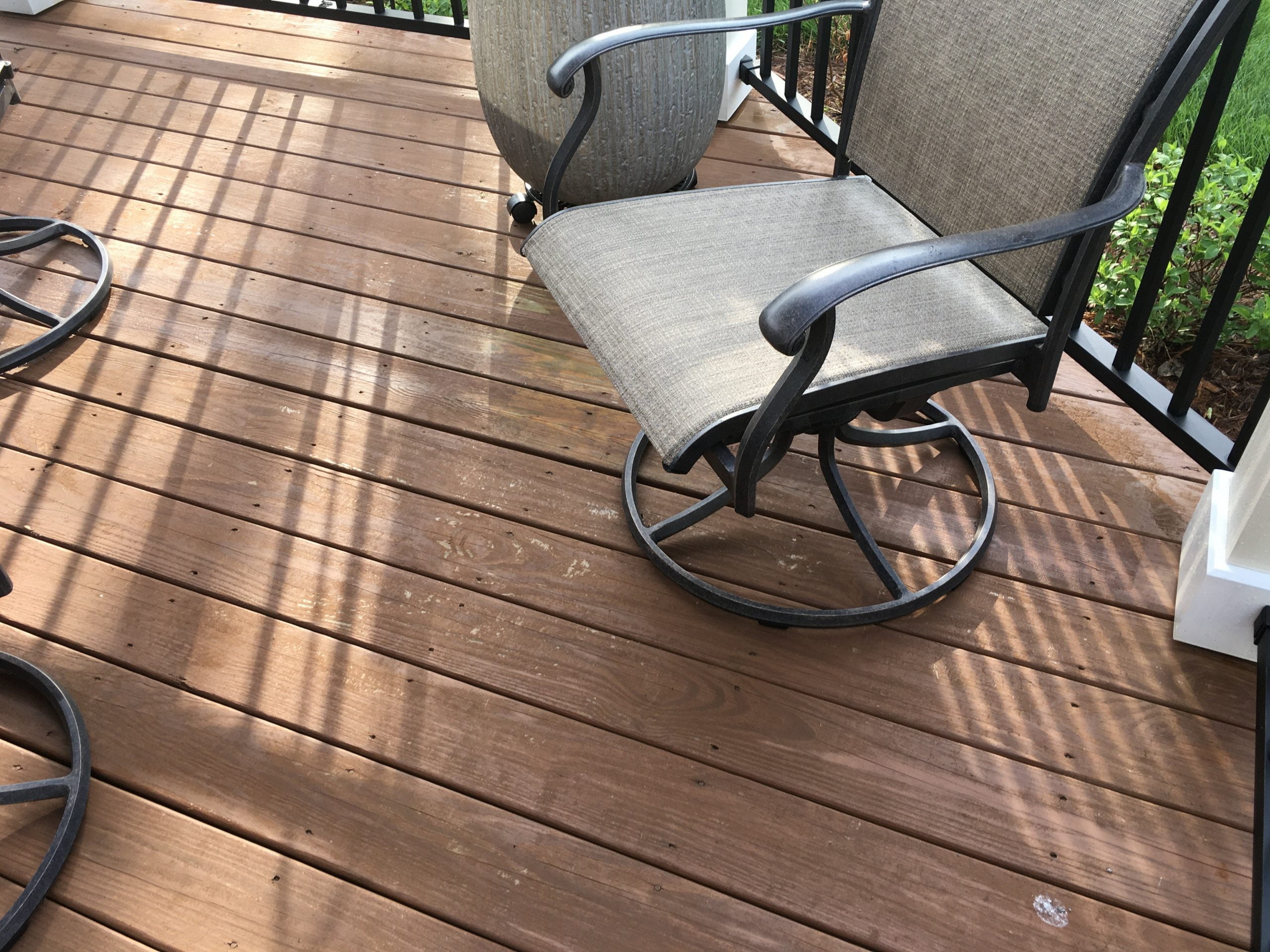

Would you recommend stripping or cleaning this deck prior to staining? Thanks!
Clean and brighten the wood.
will the cleaner brightener damage aluminum balusters like the ones pictured?
They should not.

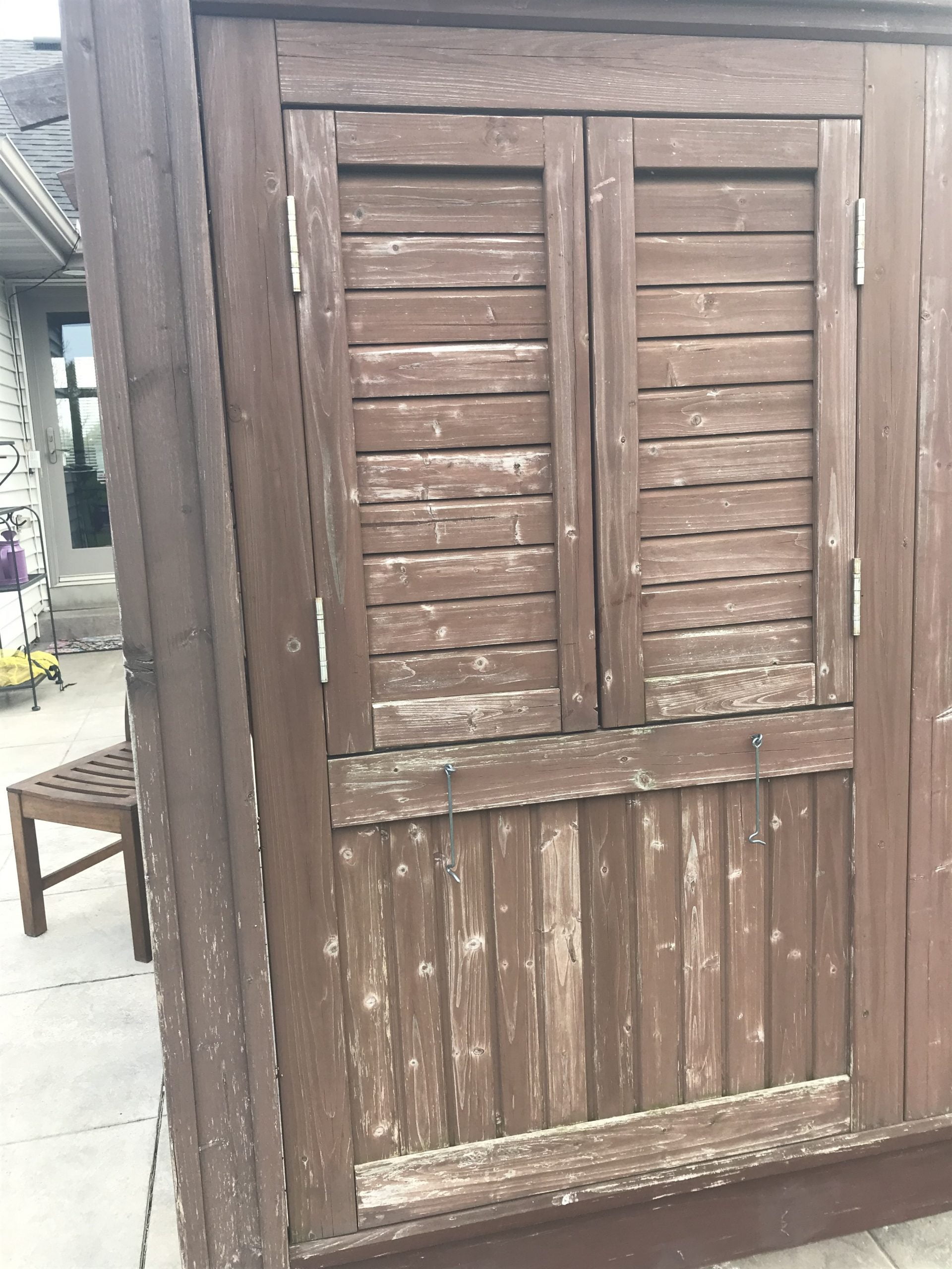

We just moved into a new house and the pergola stain is staring to wear in some areas. Can we use the Behr all in one wood cleaner and then restrain with a similar semitransparent stain? Would it be better to track down the prior existing stain and go over it again? Or do we need to strip the whole thing first? Some areas are worn more than others
Strip and brighten all and then you can recoat with a better stain: https://www.deckstainhelp.com/the-5-best-deck-stain-reviews-and-ratings/
