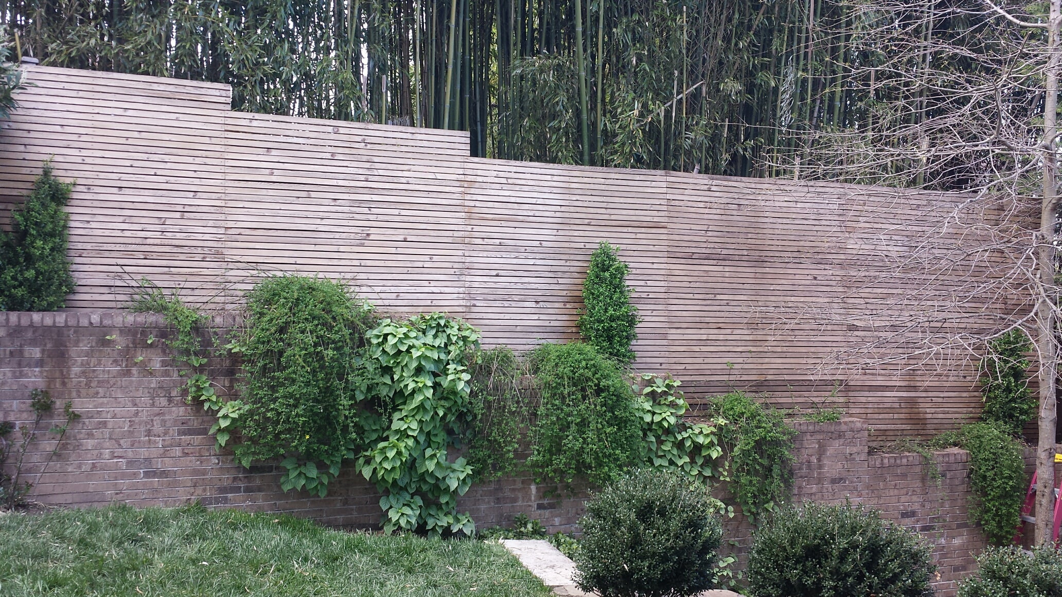

I have a redwood fence that was installed in 2016. It was stained with the cabot clear wood protector at the time of installation. I thought I needed to sand the whole thing down before moving forward with the rest of the prep work, but I am realizing it will take me a month to sand the whole thing when I think all I need to do is a stripper or cleaner and a brightner with a light sanding where needed only. The picture below (without the bbq) shows one side where I have sanded and the other is what it looks like now. The picture with the bbq shows what it currently looks like. I live by the beach so it gets a good amount of sun and salt exposure. What do you recommend? Cleaner and then brightner, stripper and then brightner, or something else? Thanks in advance for your help.
Stripper then pressure wash off. Brightener after.
Thank you. If i use the stripper on wood that is connected to a metal gate will it strip the paint off the metal as well? I don’t want to remove the paint so want to know if I should cover the metal first. Appreciate the help and quick replies!
It does not strip paint.

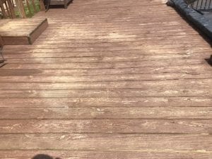

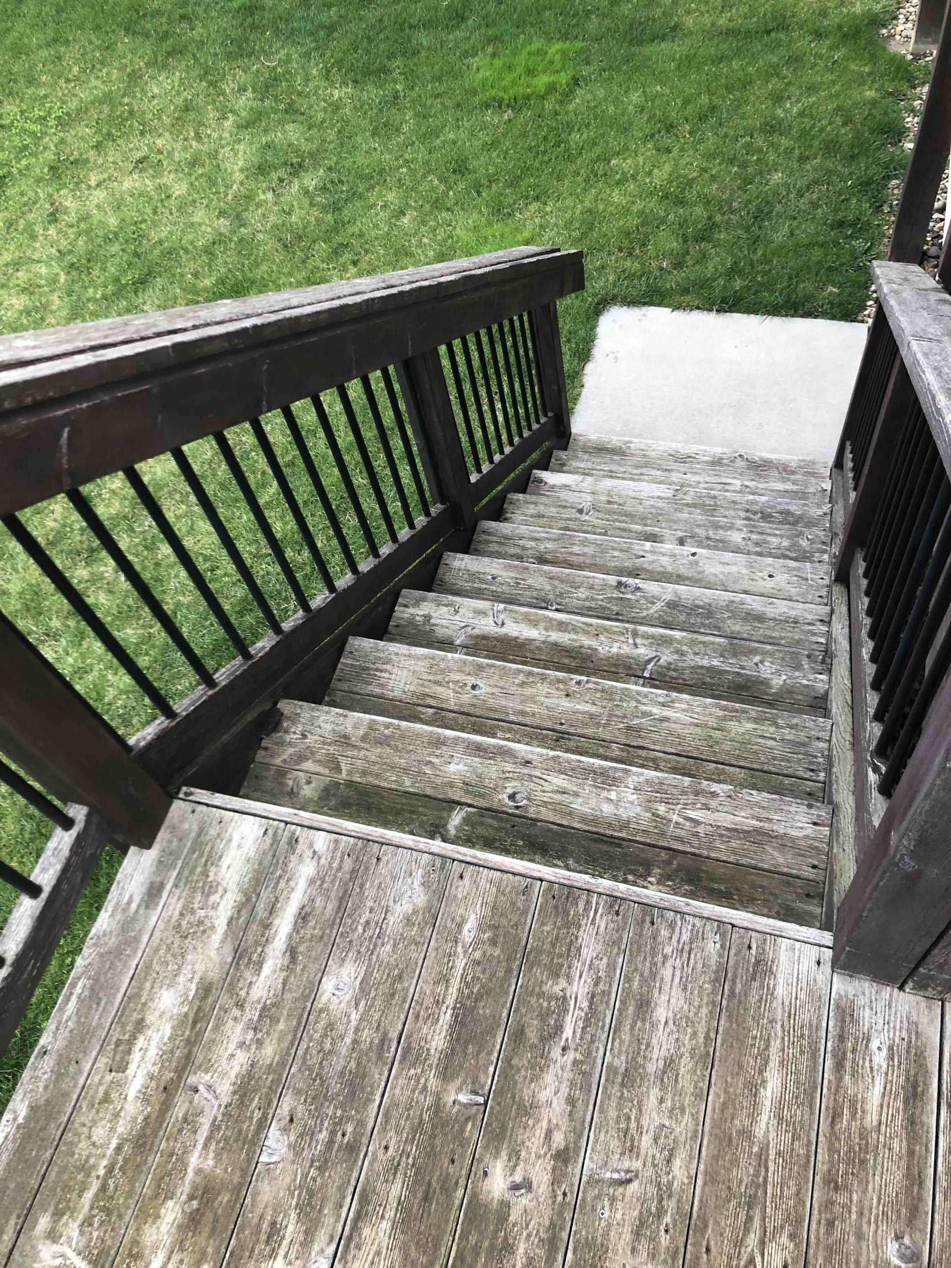

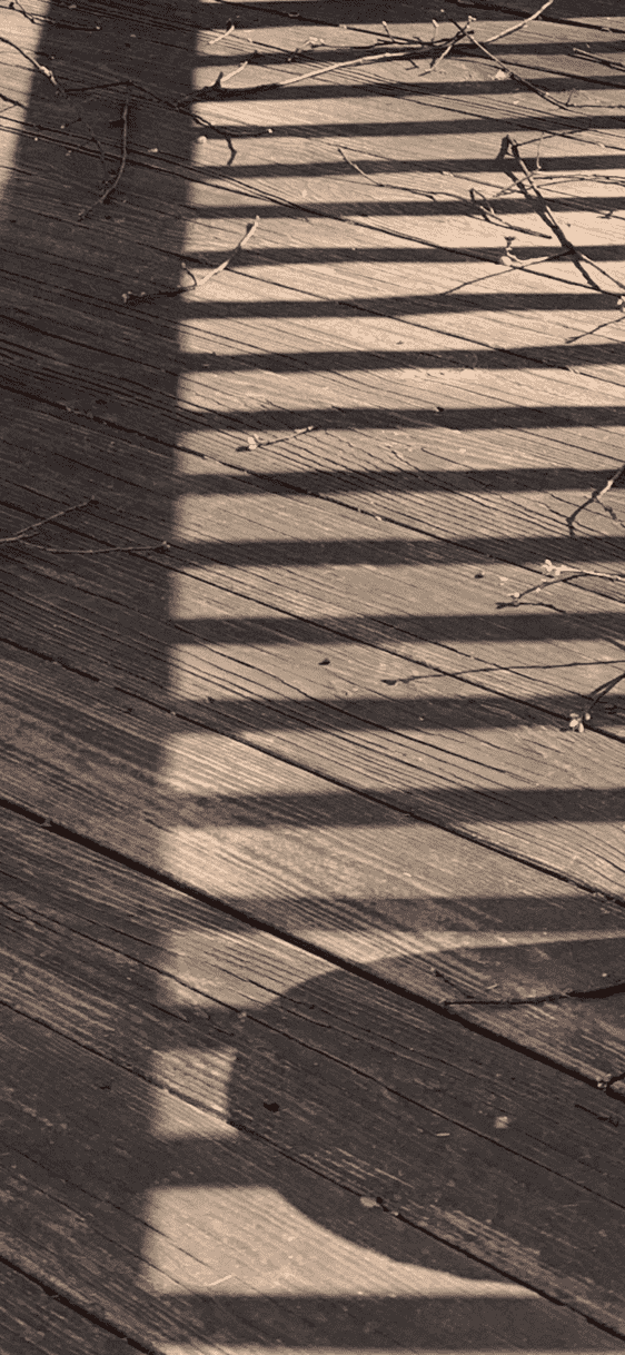

I attached a couple pictures of our deck… we stained the deck about 3.5 years ago with a Cabot Oil Based Stain. What product would you recommend to strip/clean the deck (with a power washer)? Should I follow that up with a brightener? I will then will have to sand to remove some of the splinters/etc which are there now. What type of product would you recommend to deal the deck (semi-transparent, semi solid, oil based vs. water based, etc)? Also, is it ok if it rained between power-washing and refinishing (then dried fully 24+ hours before staining)?
Kevin
I forgot to mention, we live in Iowa.
Yes, strip and brighten for prep: https://www.deckstainhelp.com/best-deck-stain-strippers/

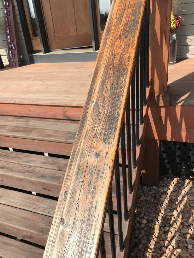

Our cedar deck is 4 years old. The railings have turned black (see pic) and we haven’t been able to get rid of it. We have tried sanding with no luck. The last stain used in this pic was Flood CWF Oil – oil wood finish in cedar color. Should we strip and do a brightener? What kind of stain should be used?
Try a stripper and brightener.

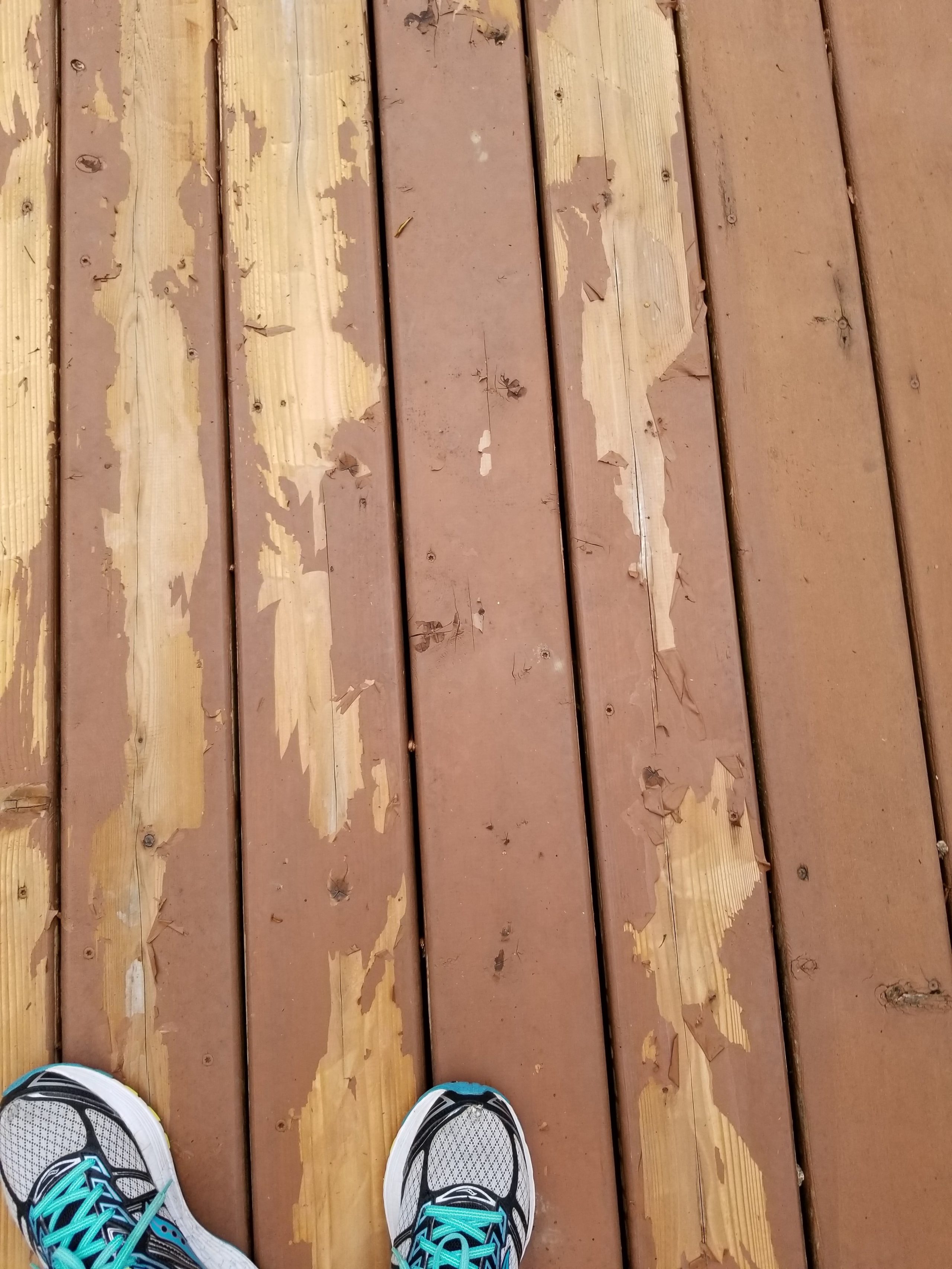

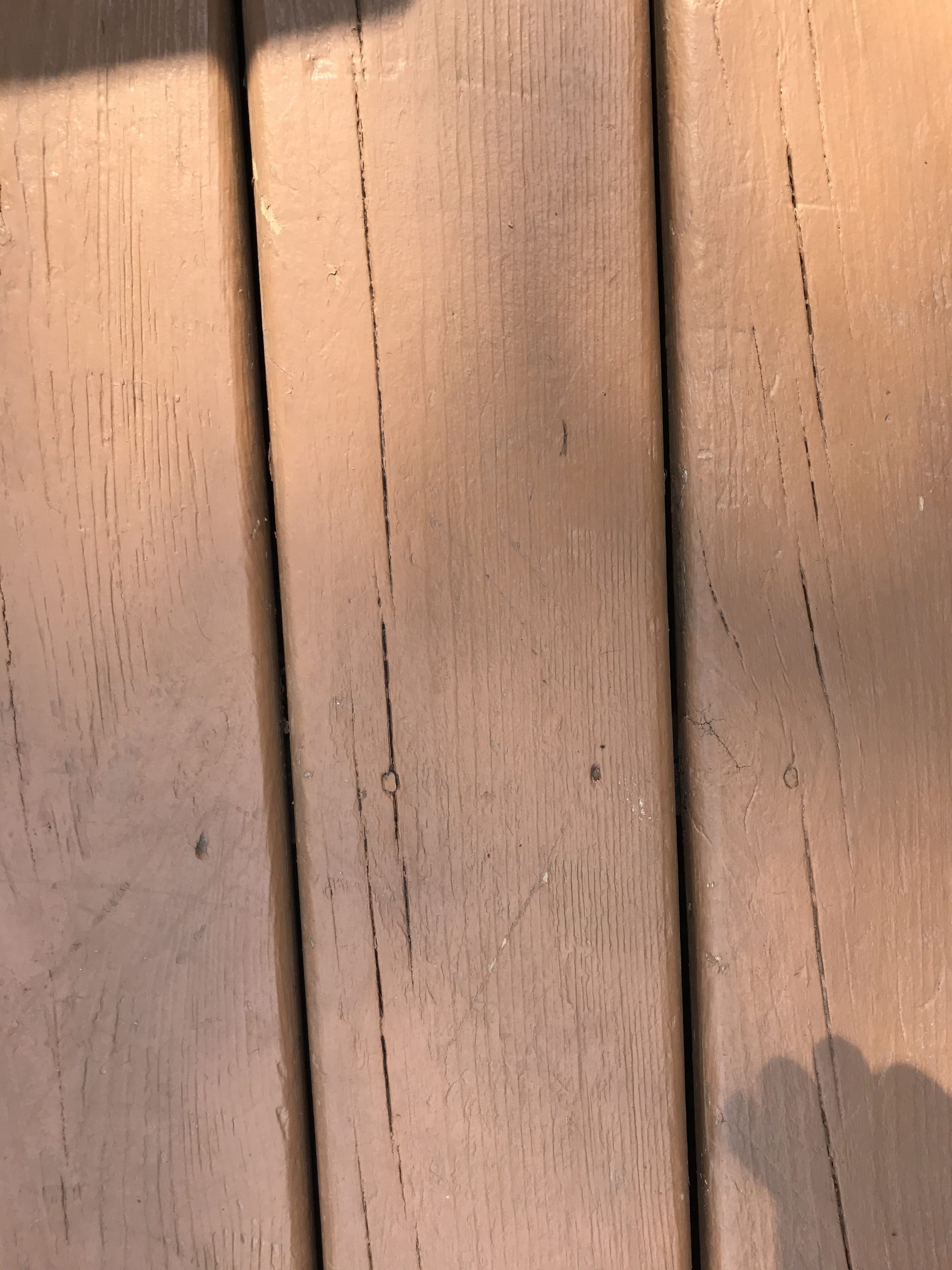

I am looking to restain a deck with a brown semi transparent. It appears there is an old, lighter semi transparent stain that is worn. Can I use a cleaner with scrubbing and light power washing for prep or will a stripper be required? Thanks
That is an opaque filming stain on there now, not a semi-transparent penetrating stain. You cannot strip this off fully and you cannot cover it with a semi-transparent stain unless fully removed. You can strip off some and then you will need to power sand to get it all off. The other option is to cover it with a solid stain.
Can you advise what the proper prep work would be if I applied a solid stain instead of a semi-transparent? Thanks for the help!
Strip and pressure wash off the loose stain. You can then cover the intact stain that is not peeling with a new solid stain: https://www.deckstainhelp.com/what-are-the-best-solid-color-deck-stains/

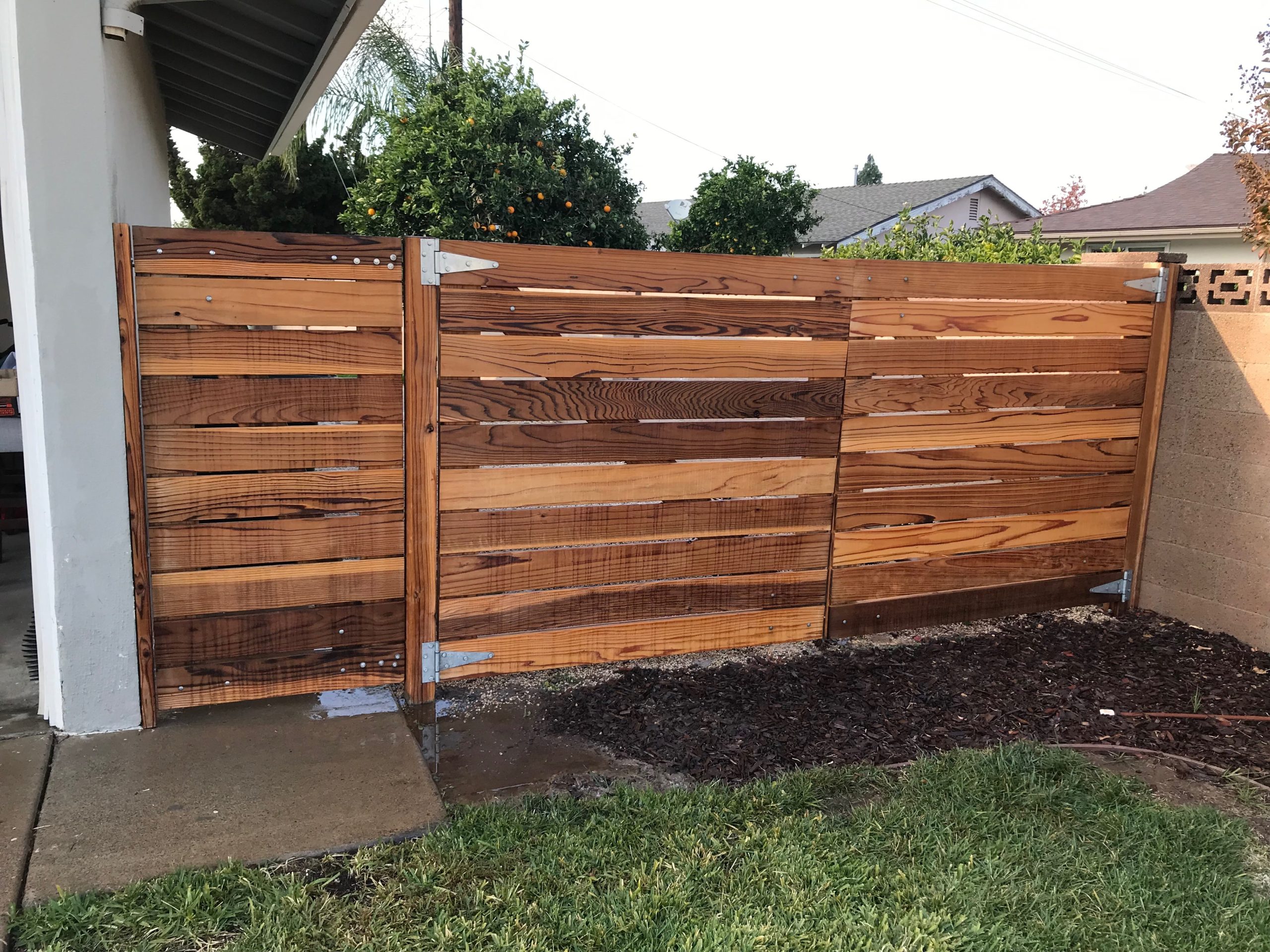

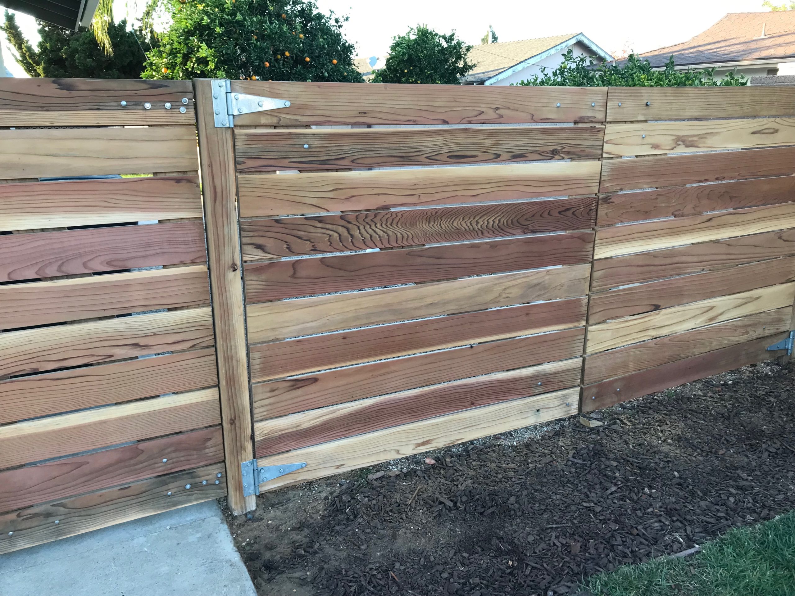

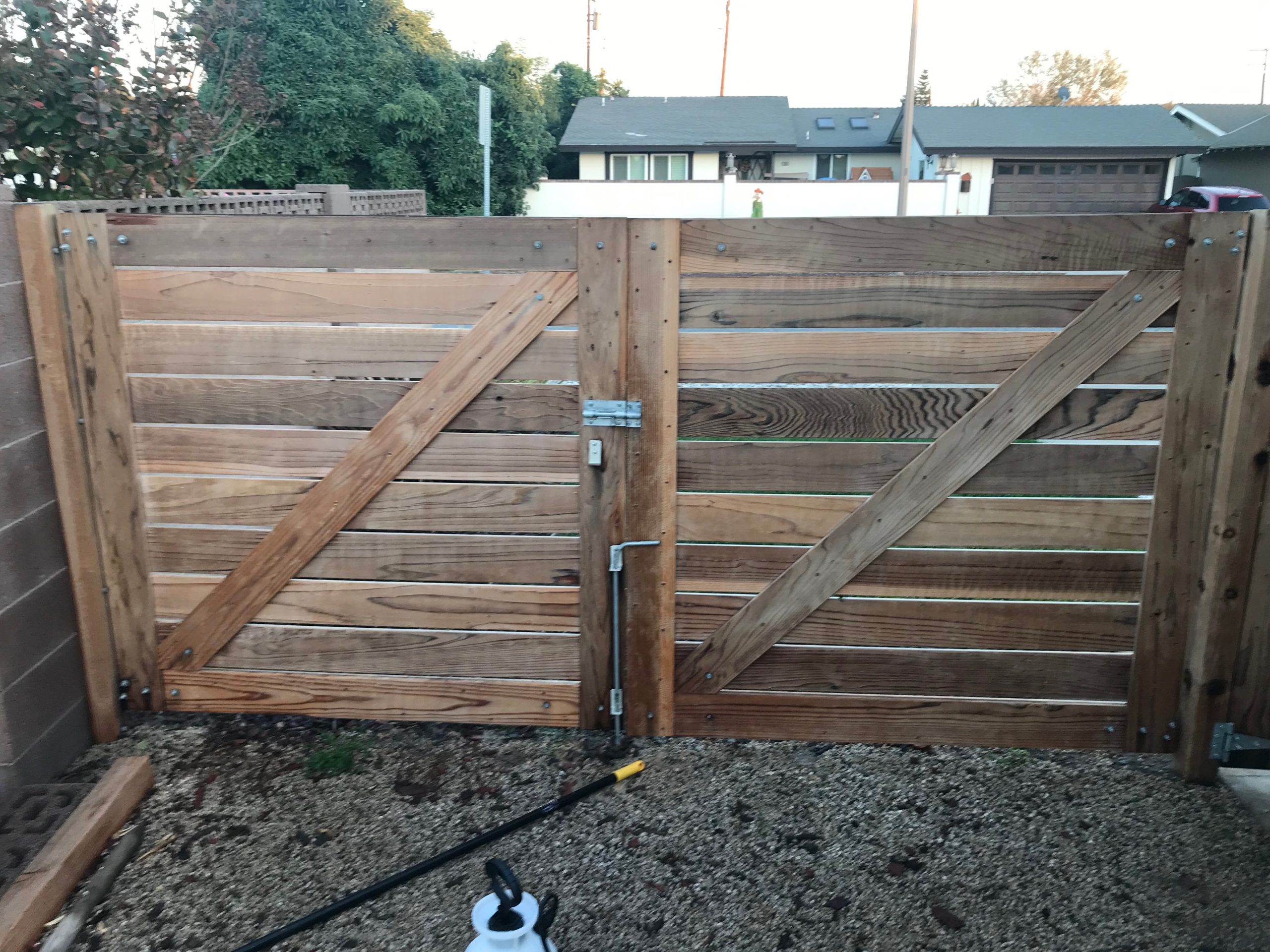

Western red cedar 1×2 horizontal fence installed in 2017. Just got around to having it stained by a contractor. He power washed, let dry for 1 day and then applied Cabot’s wood toned deck stain in Natural. The finished product was splotchy, black in areas, orange in others. I used Penofin Wood Stripper to remove stain and did it in sections over 5 days. I’m happy to see it come off, but boy did it take a lot of elbow grease! I have not followed stripping immediately with brightener. Part of fence is still drying. Could you please tell me what my next steps should be and why it turned out so poorly when done by the contractor?
I am so sorry I asked this a while back and someone closed my computer and I can’t remember which tab i asked the question on, anyway its a new deck built in Jan and we are now in April and its a bit grubby and greying already, can i use deck stripper as don’t have cleaner (and don’t want to venture out with our shelter in place) or is it too harsh? its wet out so that should help and we have a circular head on our jet wash which might be better for the wood.
No on a stripper. Use a cleaner.

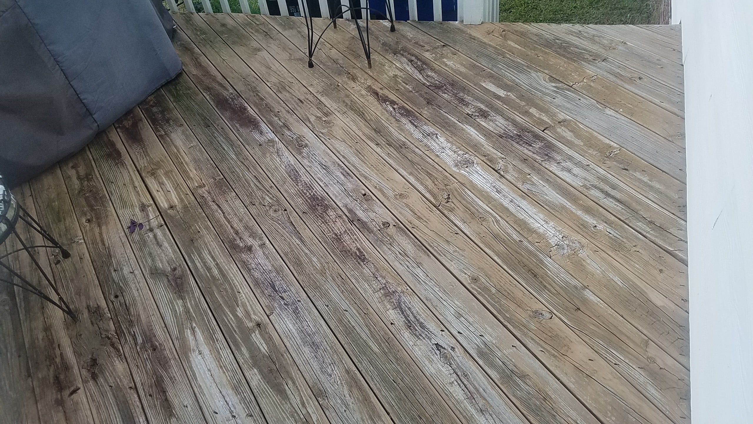

We’re moving into a new place and have never had a deck. The deck looks to already be stained or oiled but there are some black spots on the hand railing. It is coastal so I think due to moisture and sun damage. Do we need to strip the entire deck and restain?
Here’s another picture.
Yes, when you redo you will need to strip and brighten for the prep.
Another pic. This time of the outdoor deck which is still drying.
You have to remove this old coating fully. Use RAD stripper with both additives as this is a fairly difficult strip: https://www.deckstainhelp.com/restore-a-deck-stain-stripper-booster-thickening-gel-review/

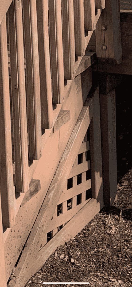

We used Penofin Verde to stain new posts and rails for our deck. The deck itself is composite. The rails tuned almost black the first winter and posts weathered to a dark color over 2 years. We’re now inyear 3.
I’m wondering if we can clean and brighten the rails and posts ow do we need to strip them? We are also concerned about the composite deck and if a wood cleaner or stripper will affect it. We won’t use Penofin again but don’t know what we will use next
You will need to strip and brighten. Use the Restore A Deck Stripper/Brightener Kits. The prep products will not harm composite wood. Look at Restore A Deck Wood Stain. It will not turn black.

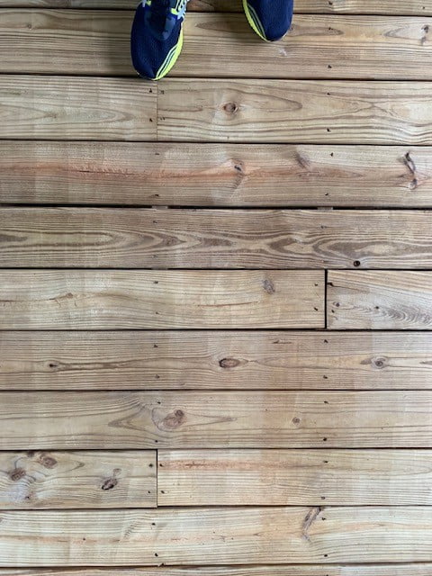

Please see attached pictures of back wood deck. I pressure washed deck to remove substantial dirt and build up. Prior stain was mostly removed as well. I now really like the original wood color look after the pressure wash. I can’t tell if prior wood stain was full solid or semi-transparent. Can you tell?
As for the further prep work prior to using a semi-transparent oil-based natural color stain:
-Should I use a ‘deck cleaner’?
OR ‘deck stripper’?
OR just further pressure wash (higher pressure) off prior stain?
Then I use wood brightener, rinse, and then use brush to apply semi transparent stain – correct?
Old coating looked semi-trans. Use a stain stripper and pressure wash again. Brightener after. Stain pad or brush to apply a new coating.

10 year old deck. Pressure washed initially 2 weeks back to remove dirt, build-up, etc. Cleaned off well. Became apparent prior stain was semi trans. Used DEFY stripper and pressure washed. Used DEFY brightener and rinsed. It has come a long way. See pics. FYI – prior semi trans stain was redwood-ish color.
Does look ready to stain? Have new TWP-100 cedar ready to go.
Feel like maybe more pressure washing with stripper and brighten because see some lines. But don’t want to overdo. Wood def dry and natural wood color and feel and appears semi trans gone?
It looks ready to go with the TWP.
Did some light sandpapering 60 to remove remaining paint.
Should I rinse / light pressure wash?
Or should I use another light round of Brightener after rinse?
Brighten and light pressure wash to rinse.
30 year old deck. Used to have a local guy clean and stain/seal with an oil based product. He retired. 2 years ago different guy “cleaned” (not stripped) and then applied Sherwin Williams SuperDeck Solid (water based). The SW is flaking off and everything needs to be redone correctly. Do I: use stripper, powerwash, brightener, then stain/seal?
Solid stain means you will need to power sand to remove fully. Clean and brighten for final prep before staining.

I need to apply a new coat of semitransparent stain to my wood deck this year. Apparently we did not properly prep the deck for the previous years stain application. The stain chips and wears poorly lasting only 2-3 years at most.
Which products do you recommend for cleaning and prep? Any advice you give will be appreciated.
Larry
Buffalo, NY
You have a solid stain on there now, not semi-trans. You will need to stick with a solid stain unless you want to sand it all off. The easiest thing to do is pressure wash to removing the peeling stain. Spot sand after if needed to remove any remnants of peeling stain, leaving the intact stain that is not peeling. Cover the current solid stain with a new solid stain: https://www.deckstainhelp.com/what-are-the-best-solid-color-deck-stains/
Behr calls it semi transparent. This is what the stain looks like after 2-3 coats of stain. You’re right that it looks solid instead of semi transparent. Personally I do not recommend the Behr product. Probably will change because it is not durable.

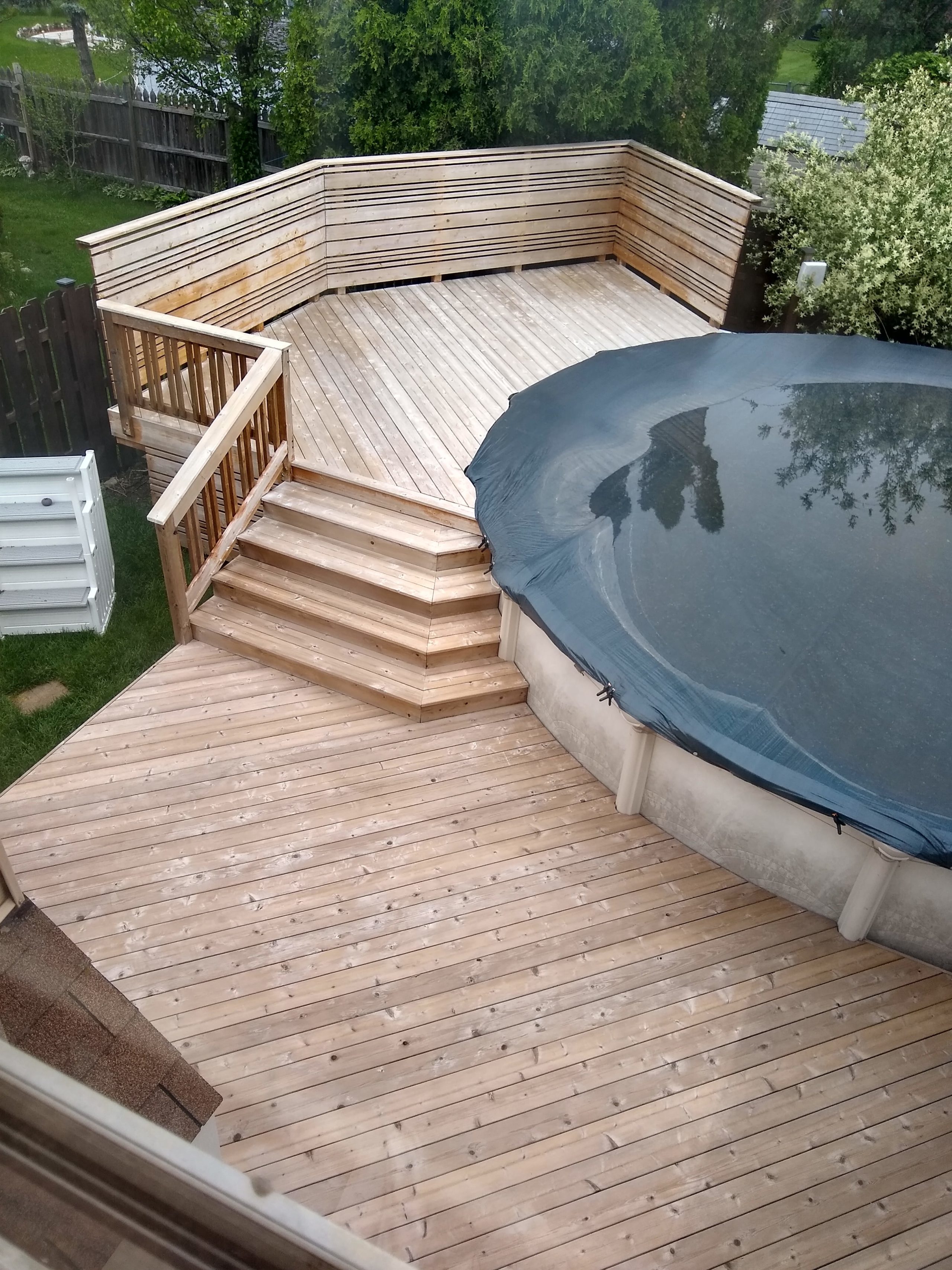

hi, we have a deck which is 2.5 years old.
I think it is treated pine.
Last year we used a Behr Transparent clear penetrating oil wood finish clear 4000. before applying we followed the manufacture’s guide for which cleaner to use. The deck did look nice after completed.
but by the end of summer the colour had faded alot. We are in Southern Ontario near Lake Ontario. the deck has full sun. No signs of mould or mildew. we would like to apply something which will last longer. ( the deck does not receive alot of traffic) the colour we would like is a light redwood. Because this was a oil wood finish. I am not sure how to prep it for next Stain. ( we would like a semi transparent.)
thanks for any advice
Strip and brighten for prep. Stain with Armstong Clark or TWP 200 Series.

I need to recondition/stain this deck. I recently purchased the house and have no information on previous maintenance, other than it looks like it was not done properly. I am seeking advice on proper maintenance (how to clean, sand, preserve with stain). There is small amount of mildew. Flaking of surface around the white areas. Plenty of small splitting. I had to replace a couple boards and they weathered all winter. It’s a quality deck with toe-nailed screws from the side and I’d like to preserve it.
The current coating needs to be removed. Stripping will not remove it fully. Strip off what you can and then sand the rest off. Brighten the wood when done. When done, stain with TWP or Armstrong Clark.

working on a pressure treated wood ramp, handrails, posts, we think it was coated with Sikkens, is there a way to
tell if it is Sikkens, I believe it is, has that plastic, opag look where it is peeling, do we have to strip to apply a new
coat of regular deck stain, or is there a primer if you want to apply a solid hide stain, thks
Tom@ Home Tech Solutions Fairfax, Va.
Yes, you will need to remove this. Stripping and power sanding to get it off fully. You do not need a primer with a solid stain.

I recently purchased a house and the fence was weathered. In the garage they had used Thompson’s WaterSeal Clear so my assumption was they applied that to the fence 2-3 years ago when the fence was new and it is greying/weathering. My thought after reading a few other sites is I will use a stripper and brightener to remove the finish and prep for staining. Found a deal at a store going out of business and bought Benjamin Moore Remove and Brighten to remove. My fence has 2 sides to it that I want to stain. So I did the Remove and then applied the Brigthen while it was still wet. When I got to the other side there were drip marks/tears going down the fence but I thought oh well it would come off as I work on this side, but it never did. Somehow either the Remove or Brighten penetrated the wood so deeply and left permanent tear/drip marks (see pictures attached). I used sandpaper to remove all of the furries on the fence, but the drips remained and tested with some stain and clearly showed through (very ugly). I then over sanded the wood to the point that the tears/drips would be removed from the wood. This changed the wood color from a yellow to more of a red (I don’t know the wood type of the fence), but the drips are gone from the majority of boards. This literally took hours though (painfully time consuming) and a few I just can’t remove. I even tried a test on one board where I re-applied some brighten and left it there for 10 minutes and the drips didn’t come out. I don’t want to damage the wood and further or re-create the problem though.
In any case, do you know a way to fix the remaining drips that are still in a few boards in the wood? Also, now that I over sanded the wood (really just the front is over sanded the back was just sanded), am I okay to apply the stain to it still or do I need to let the wood weather. I plan on buying TWP semi-transparent stain and maybe staining a week later, but want to ensure I haven’t screwed things up.
You might want to wait until Spring to finish this for a couple of reasons. The sanding may have reduced the ability for the stain to soak in fully and evenly and a good deck cleaner and brightener in the Spring will hopefully remove the drip marks. If it were us, we would wait.
Is it an issue leaving the wood raw/untreated for that long? I’m in California so don’t need to wait for the seasons necessarily. I attached a few more pictures since there can only be 3 at a time. 1 shows the drips up close that I mentioned. 1 shows the finished sanded front of the fence where only a couple boards still have drips soaked deep in the wood. And the last picture is the other fence that I haven’t touched yet as once this backfired, I plan to not use the same products and handle the other fence differently.
No, it is fine leaving until Spring.
Okay thanks. How many months should I wait? Can I get away with 1 month and doing it in January or should I wait longer? As I mentioned, it’s really just the one side that was over sanded where the other I just sanded off the furries.
2-3 months.
Okay thanks, are you able to tell what type of food it is from the picture?
Sorry for delayed response. We had to fix some issues with the web pages loading. The site should be much faster now.
As for the wood, (I assumed you did not mean food) not sure. It looks like cedar but not the normal western red cedar that is used. Eastern or Spanish cedar?
Sorry I think my reply didn’t go through so I’ll post again. I live in California so I don’t necessarily need to wait for the seasons (it won’t get too cold or snow). Is it a problem to leave the bare wood unstained/treated for that long? I understand cleaning/brightening would bring it back to life if I wait, but just making sure the wood won’t be harmed being exposed for so long. Also, just hoping that the 2nd time around I don’t get the same drips happening again. If I stain the freshly sanded wood you think the stain will fail?
I attached 3 more pictures. The first shows the drips before sanding that you can see what I am talking about up close. The product just penetrated the wood too deeply and unless you sand deeply, they wouldn’t come out. Although as I mentioned, almost all have been removed on the front of the fence now from sanding. The 2nd is the finished fence after sanding it thoroughly. You can see the wood has more “red” showing through than before.
The 3rd picture is my other fence that is on hold until I figure out how I am finishing this one. My new plan would be to use a cleaner/power washer and brightener on this fence. Would you recommend that instead? I know there was a clear coat applied on it, but it is pretty warn and trying to avoid the potential stripper issue I had before. Or maybe it was just a product/application issue I’m not sure.
You need to strip off the Thompsons. Apply the stripper to both sides of the fence at the same time. Do one or two sections of the fence. Pressure wash off, repeat until done. Brighten all wood at the stain time when done with the stripping.
Okay, thanks for the insight. If my neighbors side wasn’t treated previously, can I use Stripper or should I buy Cleaner too? I plan on buying the RAD product instead wondering if the previous Benjamin Moore product I used was bad.
A cleaner is only needed if untreated.
