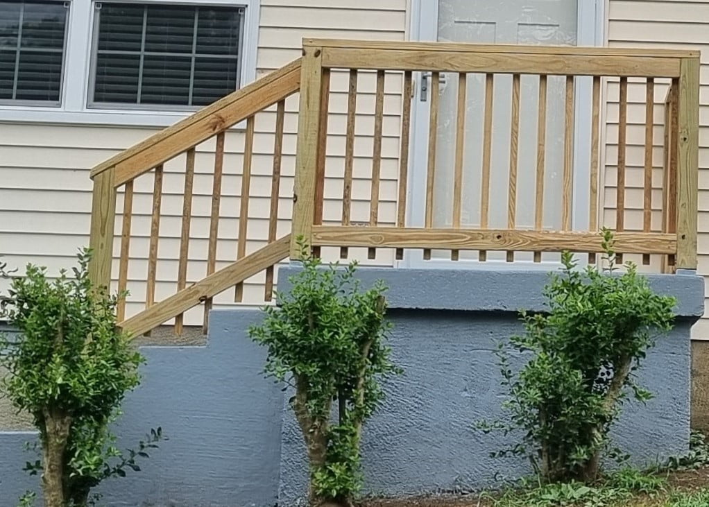

I have hand rail that was installed about 2 weeks ago.
This is treated pine 4×4 ground contact general use wood and other types I do not know since my contractor bought it at home depot. So whatever is at home depot. I have. Probably treated wood.
I am at the mercy of the contractor for finishing the job, which includes staining or painting.
He said to wait a few weeks to allow the wood to dry more. (this is all new to me)
He also filled in some holes with stainable woodfiller in some areas, because he was rough with the driver and over sank and splintered a lot of different segments.
So I have woodfiller on top that needs to be sanded in several spots
He is supposed to come back this week to apply my chosen stain or paint and if I don’t get this person to finish now, I probably won’t be able to get this finished at all as he won’t come back.
What is the best way to deal with this at this stage so that I don’t shoot myself on the foot and make this worse?
I am sure he will want to come and sand down the woodfiller with a power sander, clean dust with a rag and then stain or paint one coat and be done and gone.
I already paid him. I have attached a picture.
Need to know what to have him do so this project is finished the best way possible with what I am having to deal with.
Thank you for your comments.
You need to wait a few months, not weeks. Prep before staining.

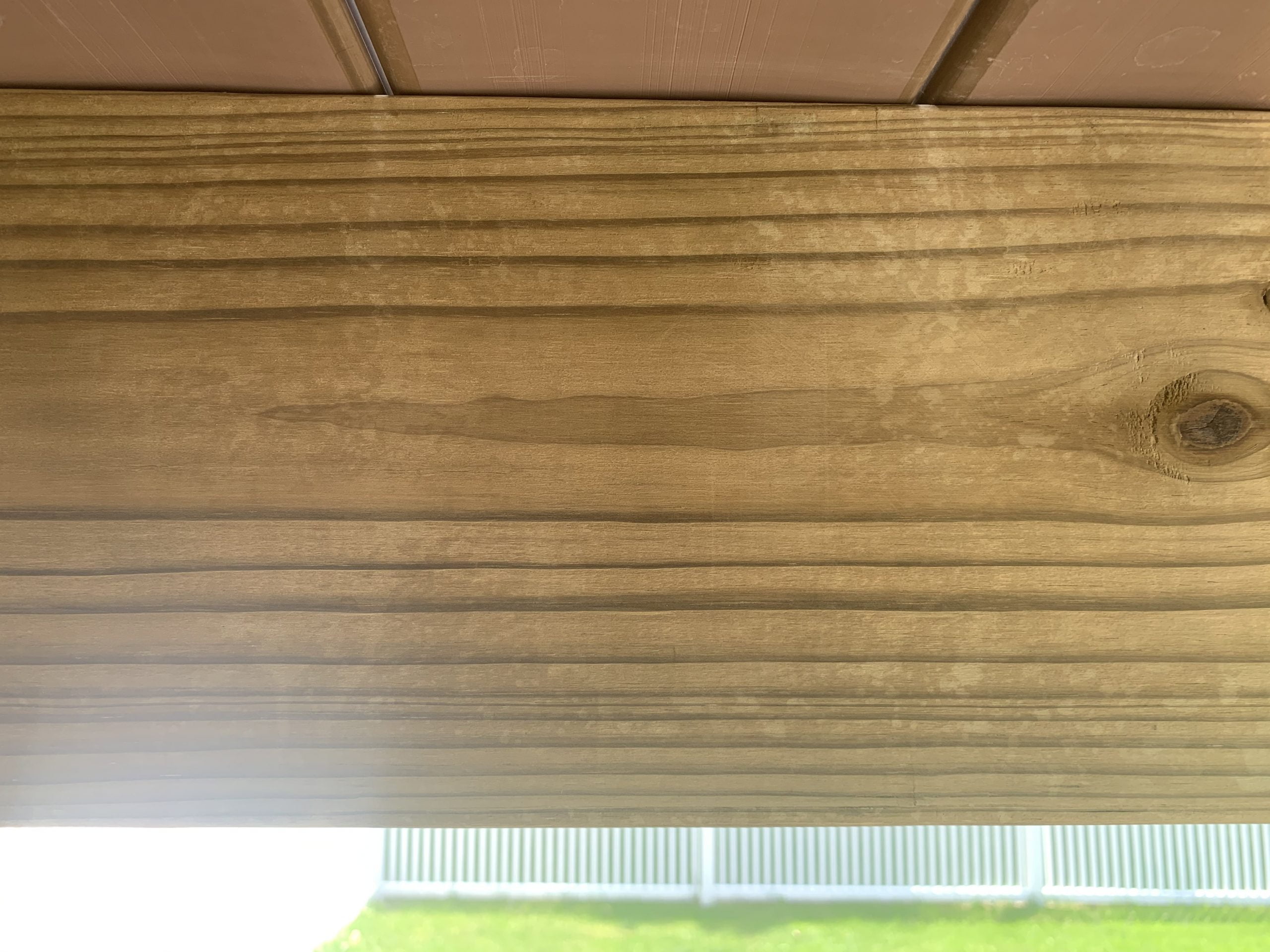

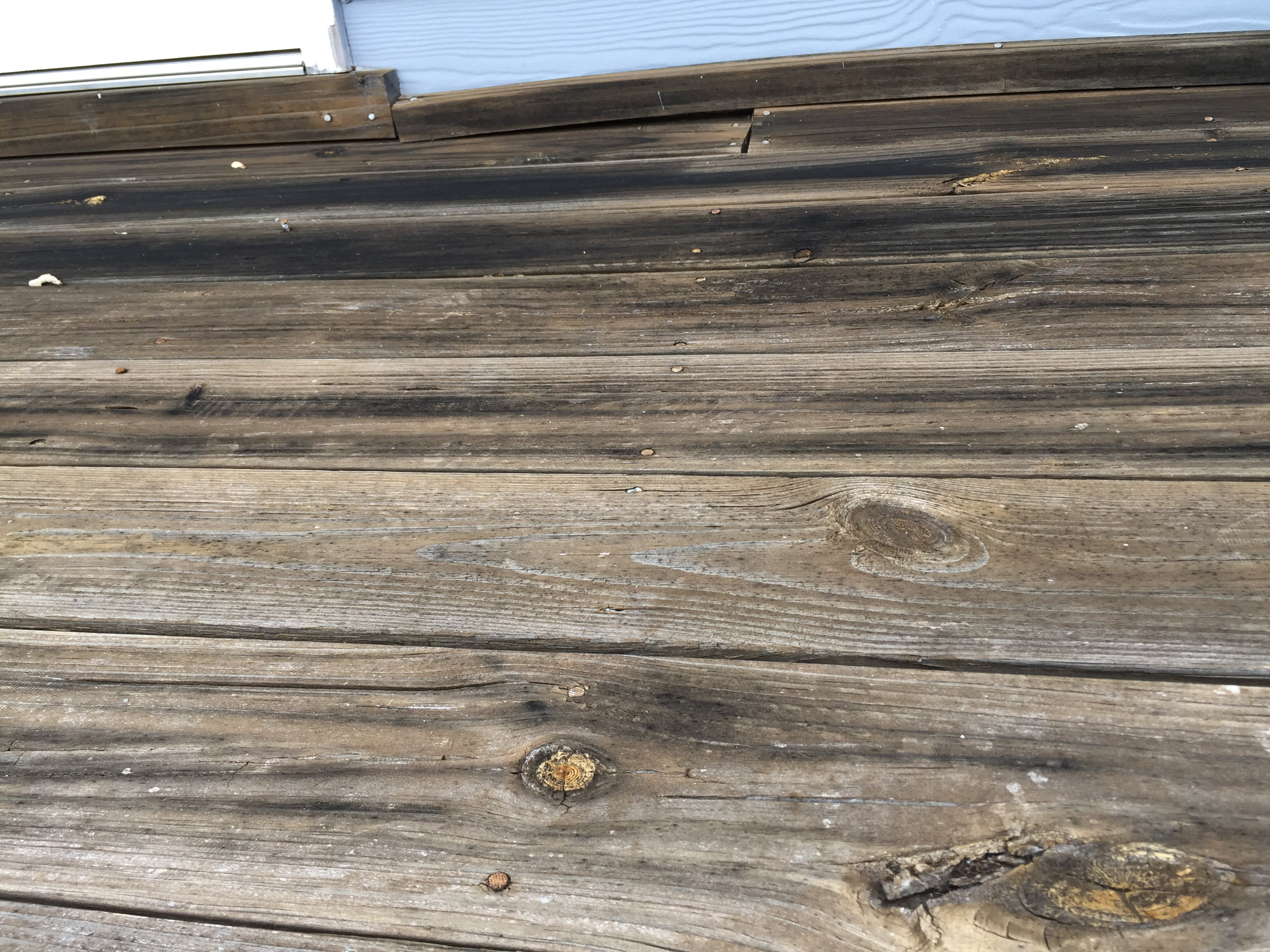

One year old deck, had some mildew in the framing and used a 3-1 bleach water that that left some bleached marks on the joists. Probably dried quicker than expected before it was rinsed. Pressure treated pine framing. Is there a recommendation to treat or will staining be fine at this point. Any stain recommendations?
Post pictures of prep. As for the stain, use one of these brands: https://www.deckstainhelp.com/the-5-best-deck-stain-reviews-and-ratings/
Here are some pics.
Here are the photos
Go ahead and stain.

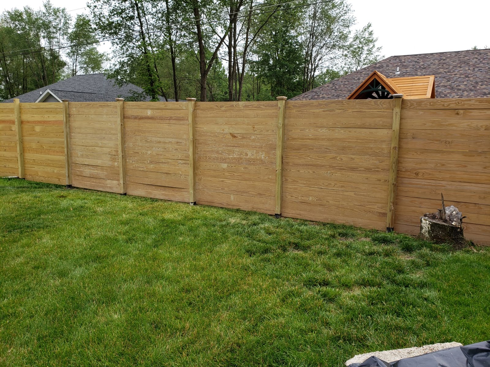

What is the best stain to use on a new pressure treated pine wood fence?
Try Restore A Deck Semi-Transparent Stains or TWP Wood Stains.

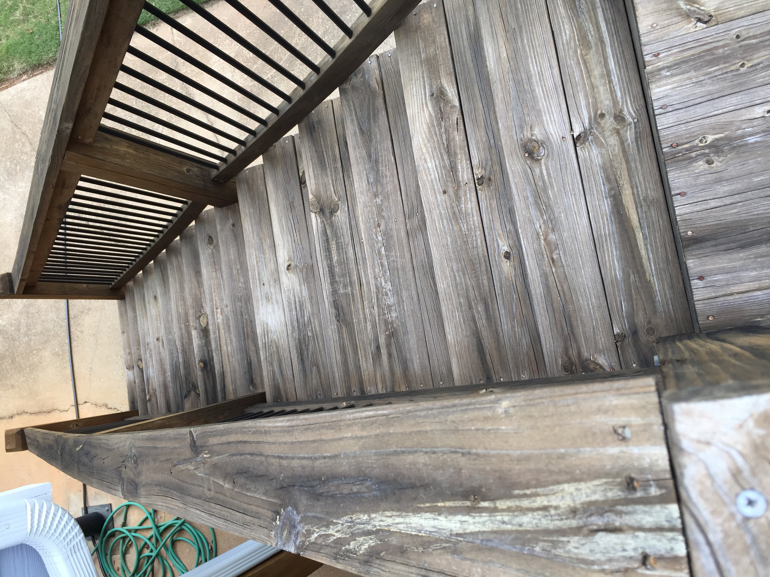

The deck is in North Georgia. I’ve stained a pressure treated pine deck and stairs about 2.5 years ago with TWP. It is weathered worn and grey appearing. The handrails are warping, nails popping. (I didn’t know to stain it until 2.0 yrs after it was installed.) In it’s present state; is it salvageable?
—should I use stripper and brightener or cleaner and brightener?
-How often should I restain? Thanks (picture included)
Yes you can salvage this. Prep with the Gemini Restore Kit and restain with the TWP.
