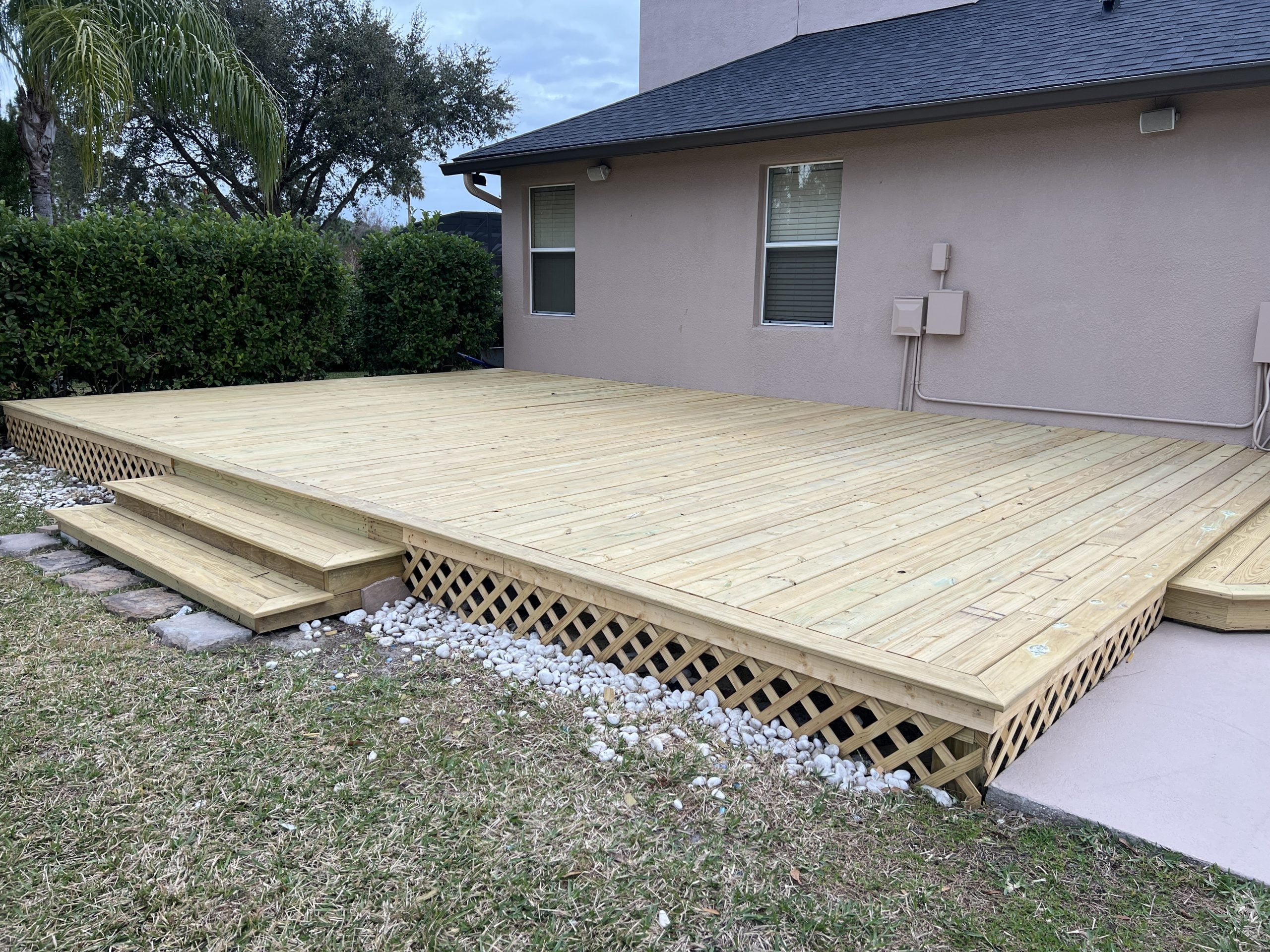

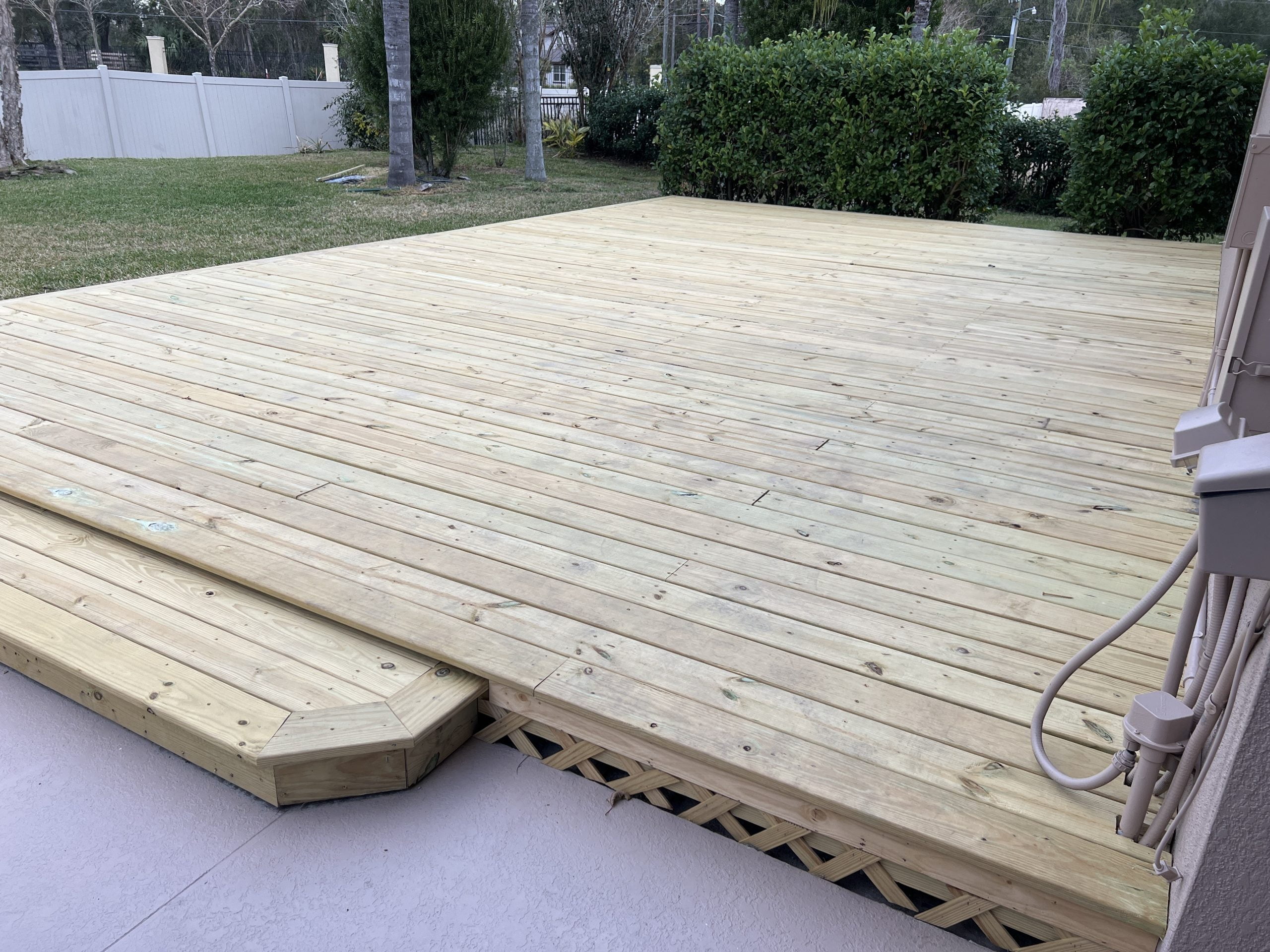

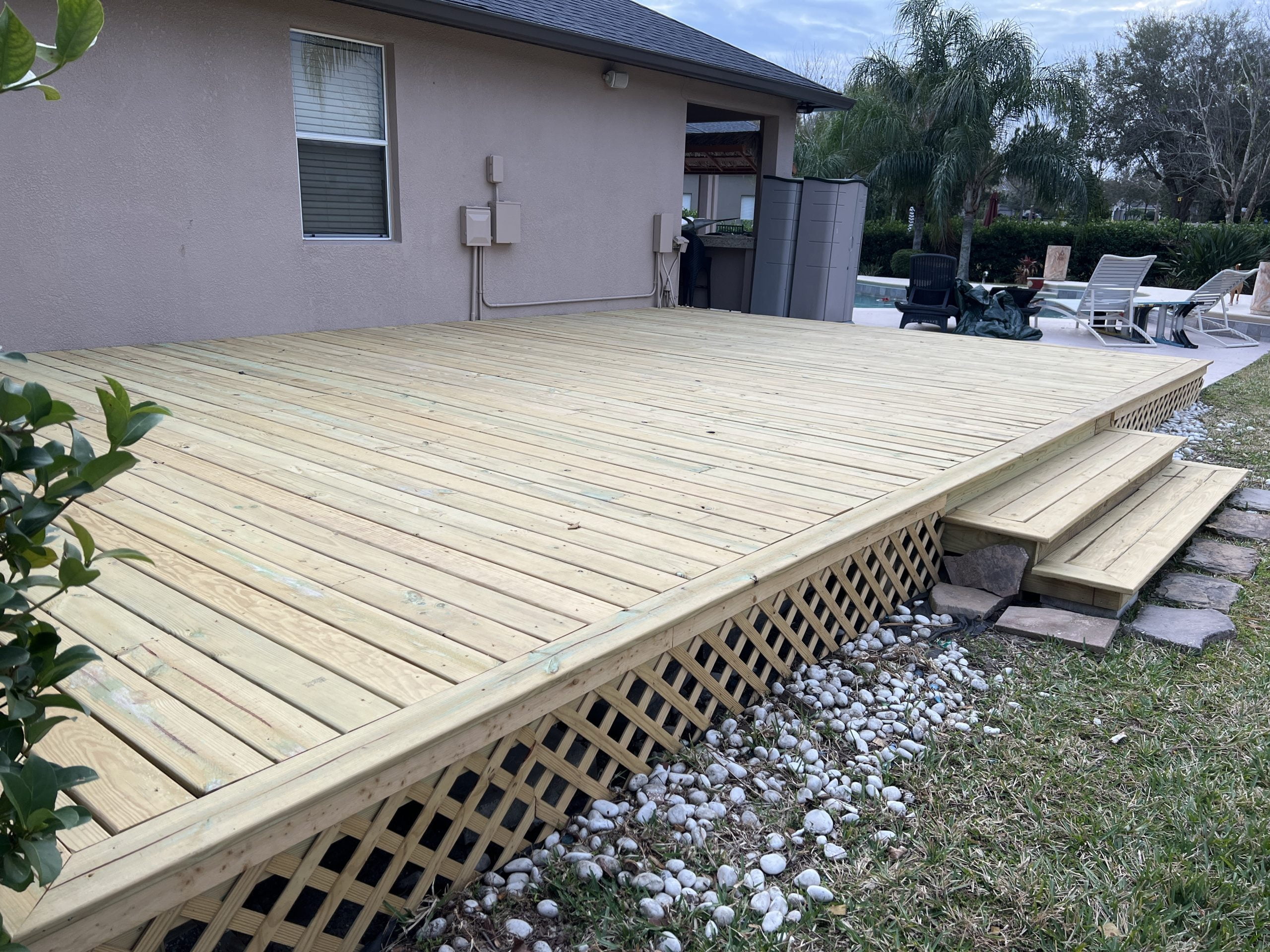

I’m not sure how long to wait to stain this pressure treated wood? I live in Florida. It was done being built jan 7. So I wait a few months or can I do it now?

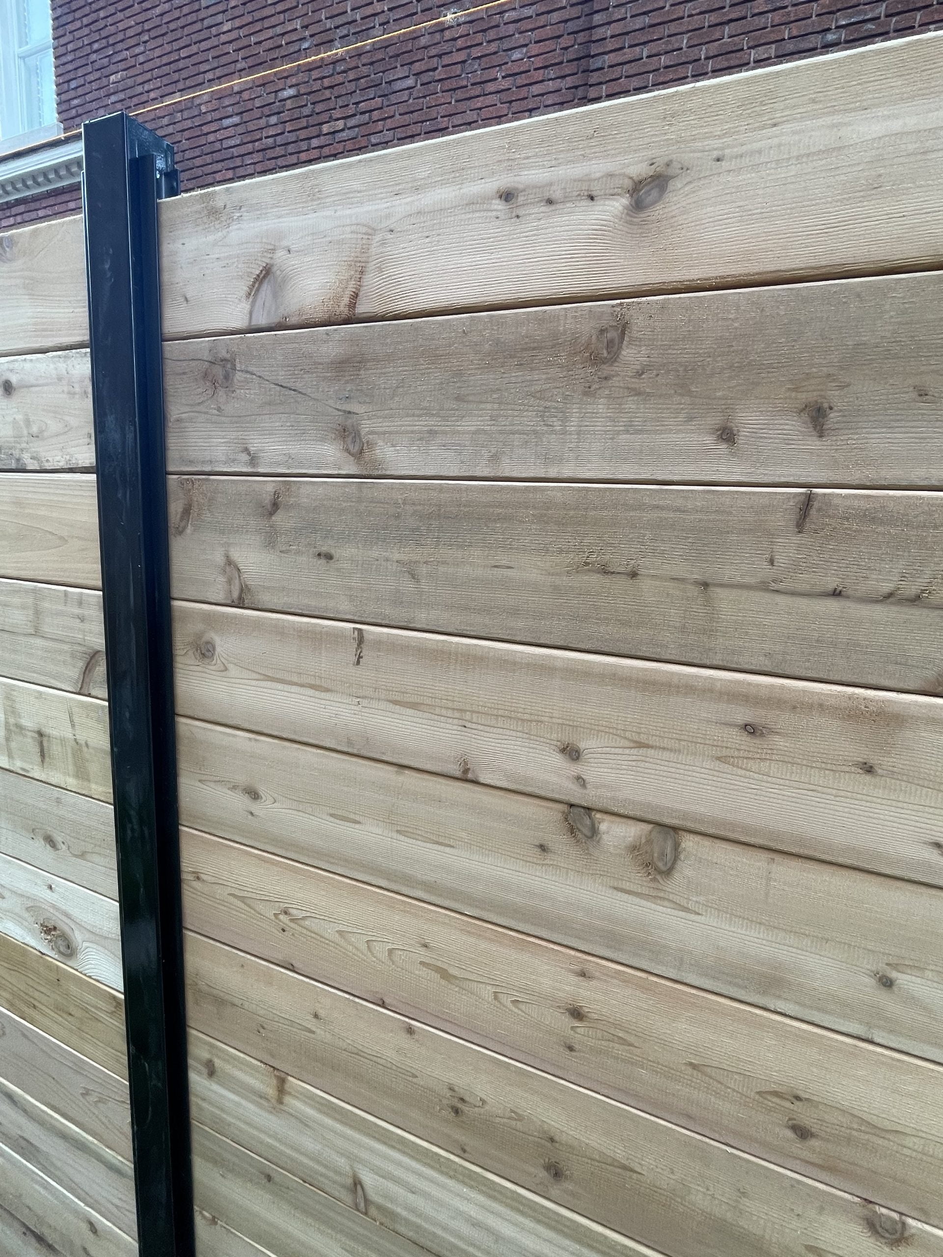

Will be staining deck railing made of rough western red cedar. Really just want to protect and enhance the natural wood tone/color/grain, not really interested in changing the color. Contractor recommended SW Woodscapes but I’m reading about TWP on your site. Recommendation? If TWP, which one??? The oil based cedar tone?

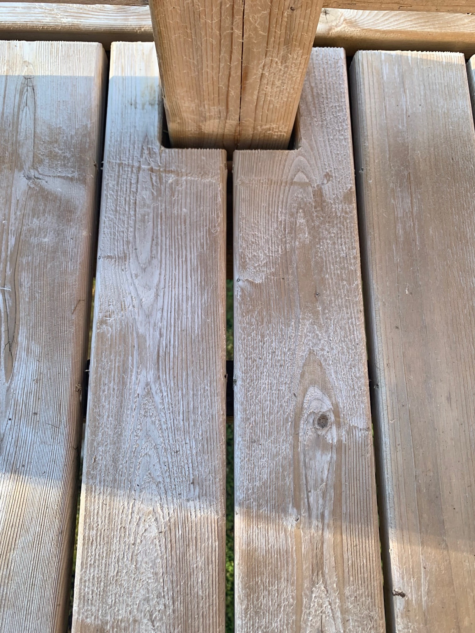

Before seeing your website I washed my 8 month old cedar deck with a mixture of bleach, TSP, and water in preparation for staining. This left varying degrees of white stain marks all over my deck (especially around wood knots) that are very difficult to remove. If I stain over will it show through? Should I sand it off? What is this caused from? At this stage wishing I just left the deck alone to naturally weather……comments?
The cleaning mixture I used also was fairly aggressive on the wood fiber creating quite a bit of pulp slurry that stuck to everything. The ratio of bleach, TSP, and water seemed pretty typical (average) of all my research.
Scott M
Scott M
See attached photos.

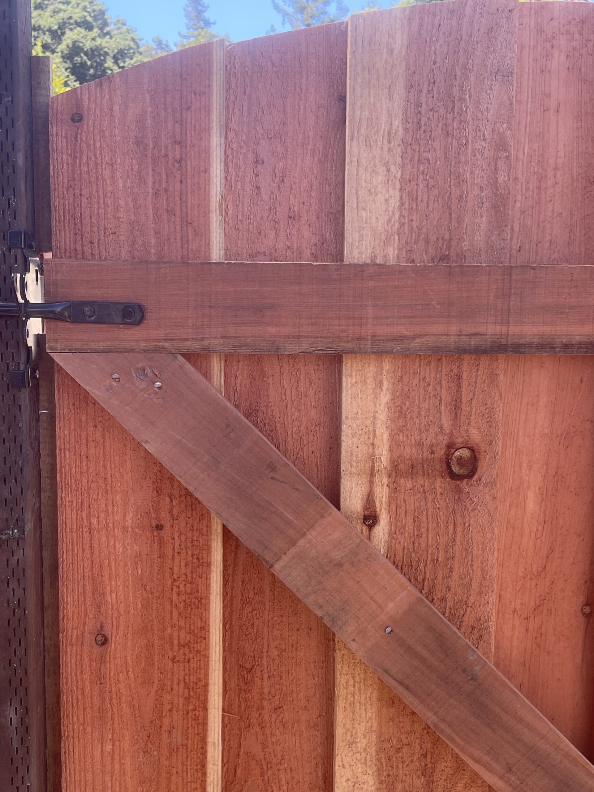

Here’s the picture of the new redwood fence. Rough hewn?
Joe Khirallah
Joe Khirallah
Hi, I just put in two days ago a new redwood fence, looks roughhewn to me, picture attached. Would like to stay in right away if possible. Want to prevent any and all UV fading, hate that gray brown color. Any advice for top two or three semi transparent single application redwood stains?
PS thought I posted this comment/question somewhere else but I can’t find it now so apologies if this is duplicated

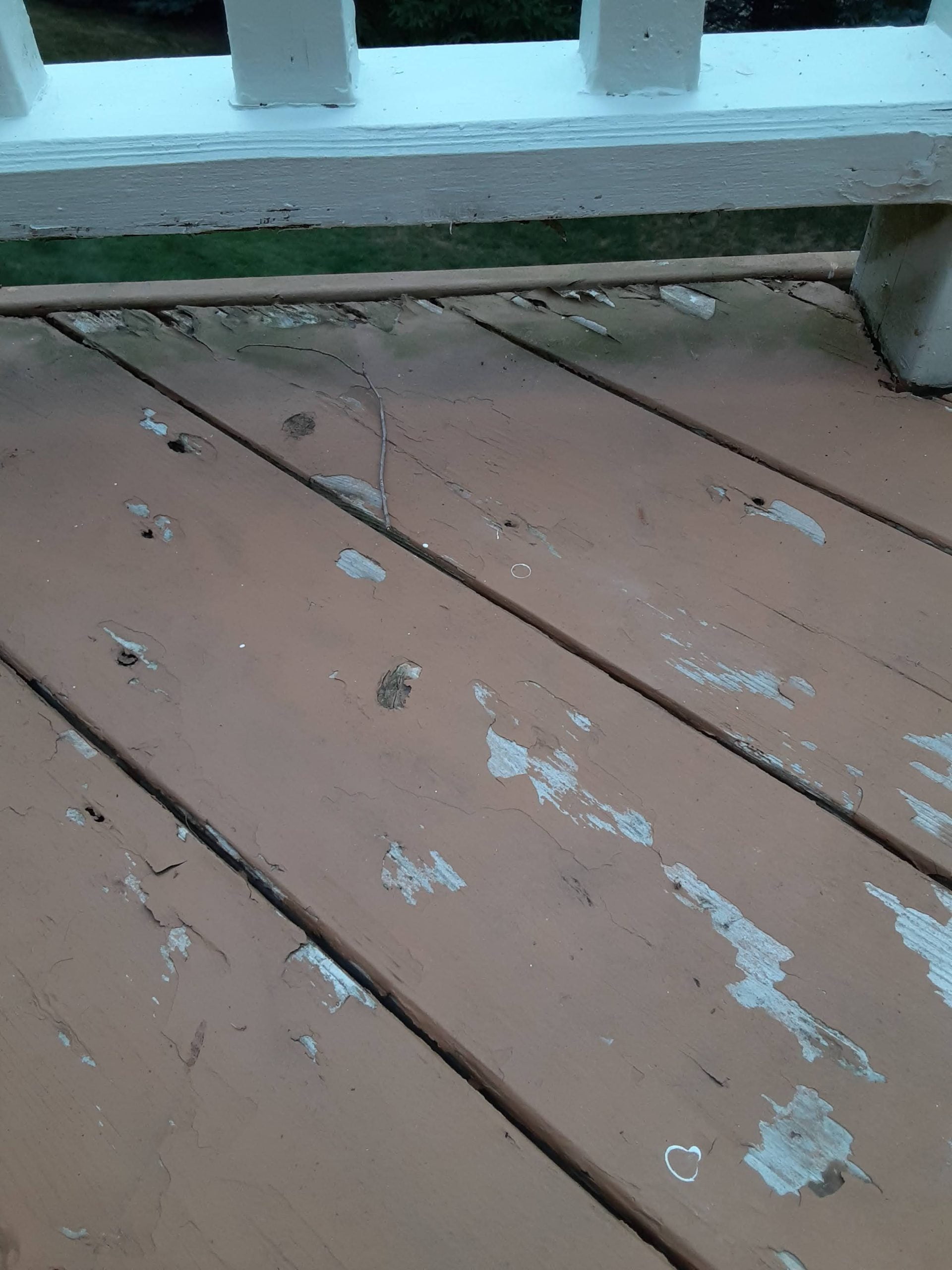

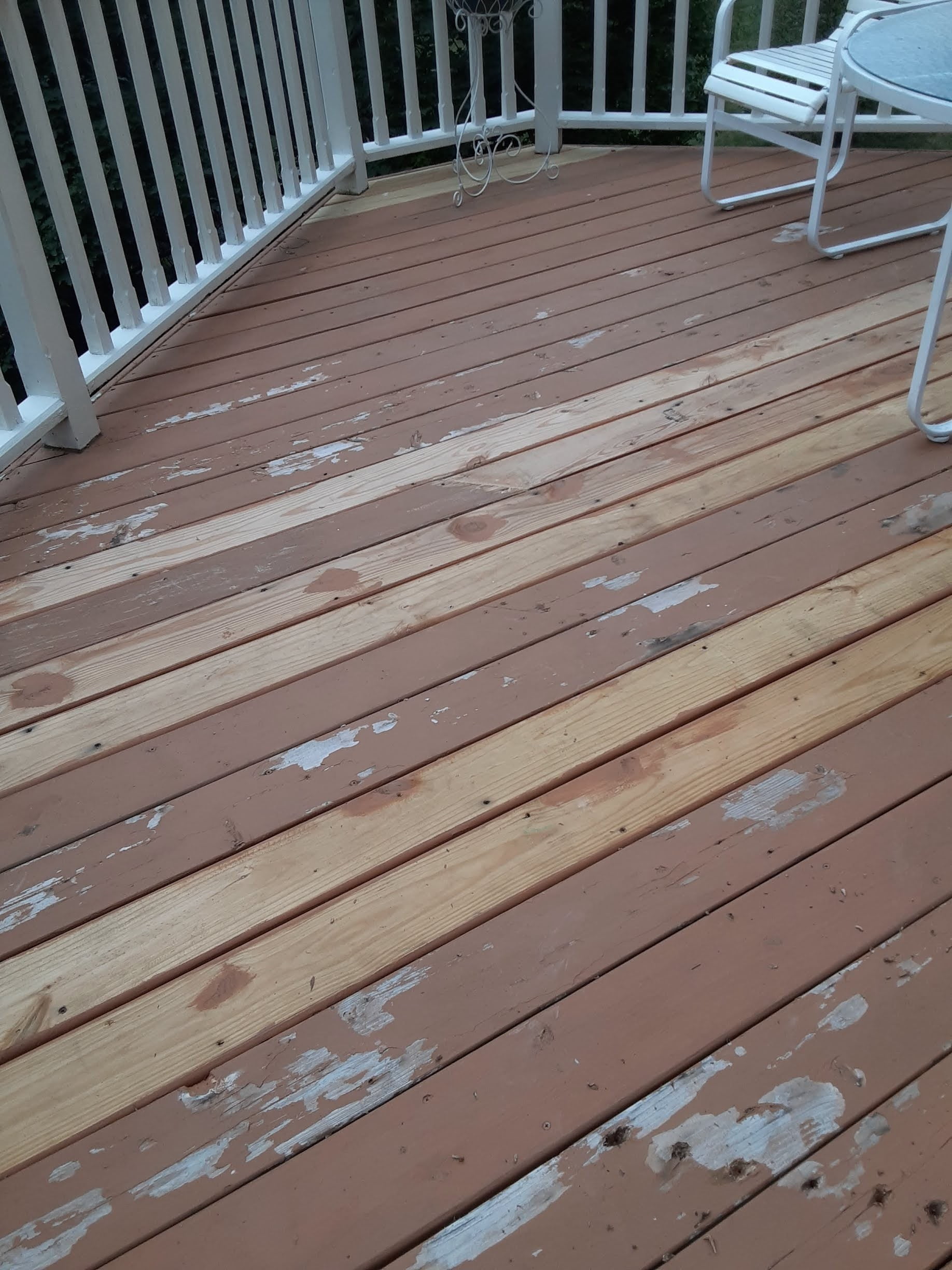

North facing deck in lower Michigan. 21 yrs old. Treated 1×6.
Original stain likely solid as peels and flakes every year. No absorption. Olympic Max solid last @10 years to spot or restain all yearly.
Currently replacing about half rotted or cracked boards. Can I strip remaining old solid stained boards? Sand ? So match new. Recoat all with brightener and semi trans ?
dave
dave
Thank You. Looks like I’ll replace most boards (about half replaced as of today) and try stripping and sanding the rest (were olympic max solid stain), then brightener and semi trans with “restore a deck” you recommend. A lot of my 21 year old boards peel every year, are soft and rot at ends where there is a trim piece that covers the cut ends and I think traps water. Replaced several last year which not peeling yet. 3 Pics attached. Given condition, any thoughts vs. just power wash, brighten and do another solid? appreciate your site and expertise.
Thx. At this point after 21 yrs I’ll keep replacing until I run out of energy, then sand the @ 10 that replaced and solid stained last year. Wait 60 days. Brighten all and semi stain.
From my pics and your articles, sounds like I didn’t wait long enough and prep well originally even if I did start with semi t, and solid recoating was bad choice over the years for Michigan flooring.
If you can see routed spindles in pics, any local Oakland County sources you like that might have them?
Thx. Thinking I can sand many of 21 yr old boards rather than replace, or is that about the time to replace in michigan? Also, if I read correctly you recommend not using solid stains for flooring in michigan…too likely to peel after just couple years?

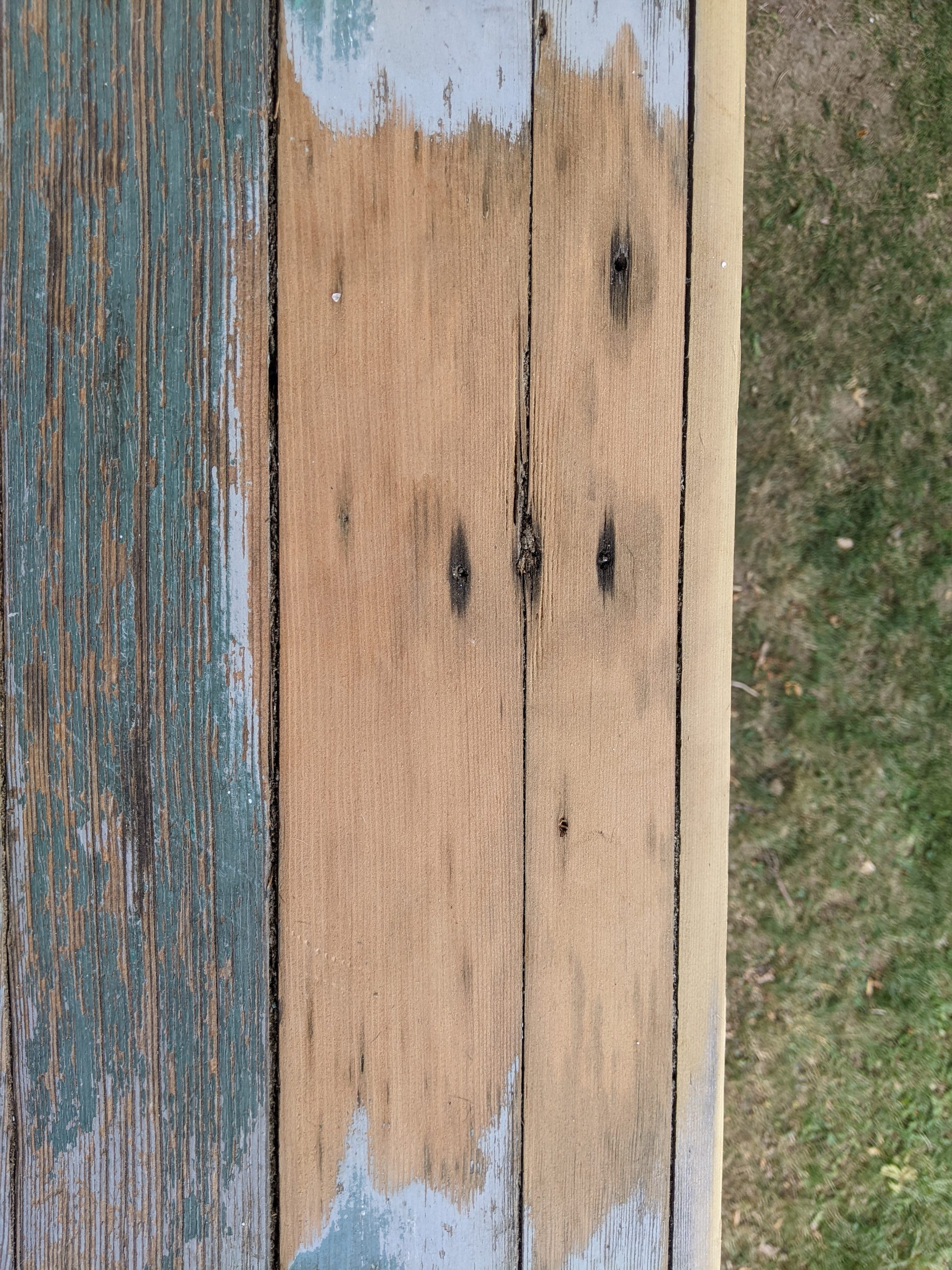

We have an old (installed around 1950-1960) covered deck. It is north facing and the wood is like an interior wood floor. This is in the front range of Colorado. Someone once said they thought it was redwood but I’m not so sure. It is currently painted with a couple of layers. We intend on sanding it down to bare wood again and re-finishing it. We had hoped to whitewash it but all the products to do that seem to be interior based. Should we treat it like any other deck and sand it down, wait 3 months and then stain it?
