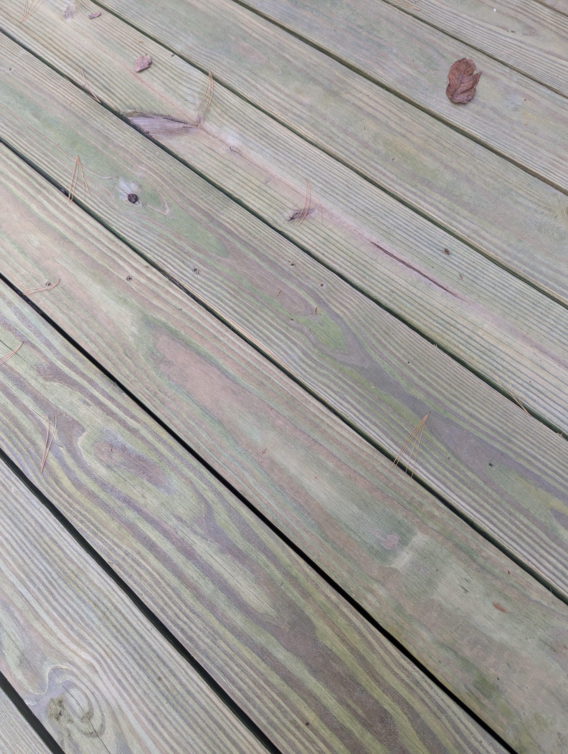

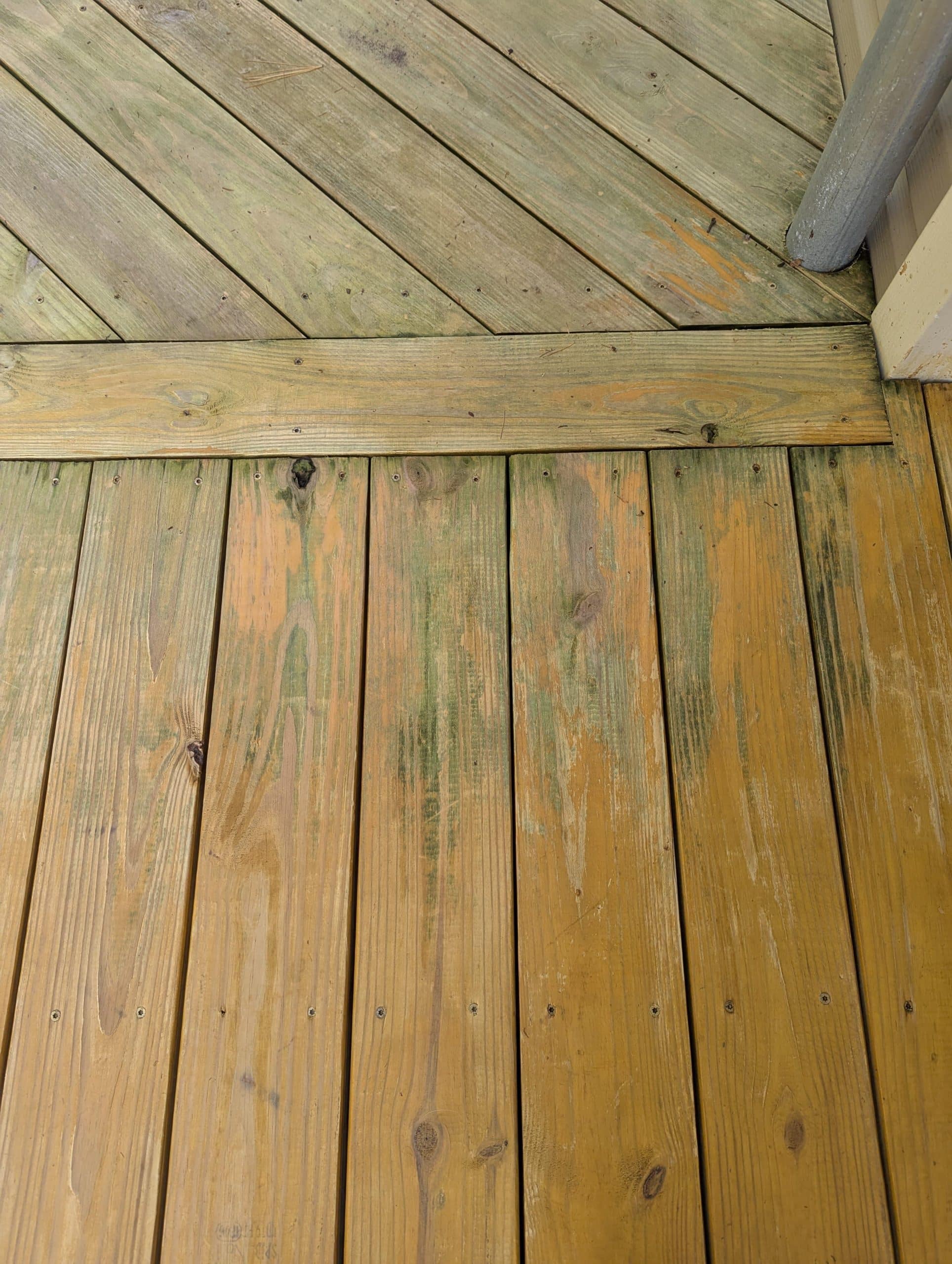

I have a semi-Frankenstein deck due to contractor issues. The oldest boards are ~5 yrs old, & it has never been treated. I’m in NC.
Details:
Current state:
Handyman did RAD cleaner & brightener a couple weeks ago; I suspect poorly rinsed & brushed. Majority of it looks clean, but several spots are clearly green when wet, which I assume means algae. It isn’t very noticeable dry, slippery when wet & I could scrape it off with my fingernail.
Debrief:
The handyman followed manufacturer instructions for mixing & dwell time, but it looks like he used a pump sprayer and/or hose with minimal water pressure due to failed/leaking vacuum breaker (fixed now). I also don’t think he had a proper deck brush and used an old dollar store broom I keep outside to sweep leaves. Might that account for results?
Next steps?
Cleaner & brightener:
Cleaner: oxygen bleach+dish soap+borax
Brightener: oxalic acid
I found something for the oxalic so I wouldn’t have to get powder & mix it.
It’s marketed as cleaner that’s effective for mold-algae-mildew. Since the deck has already had RAD treatment, would oxalic be effective enough on its own? It would be great to eliminate a step.
Sanding: If minimal fuzzing, is it necessary to sand everything?
I wondered if there are a options—any with fewer steps or milder manual labor. I’m recovering from a shoulder injury (non-dominant side), and if one approach would be easier on it, would be great.
Stain: Using Armstrong Clark Natural Oak.
I’d be grateful if you could advise on a protocol. Thx!
Need pics of the prep so far to see what, if anything is still needed.
You can add the pics in the comments.

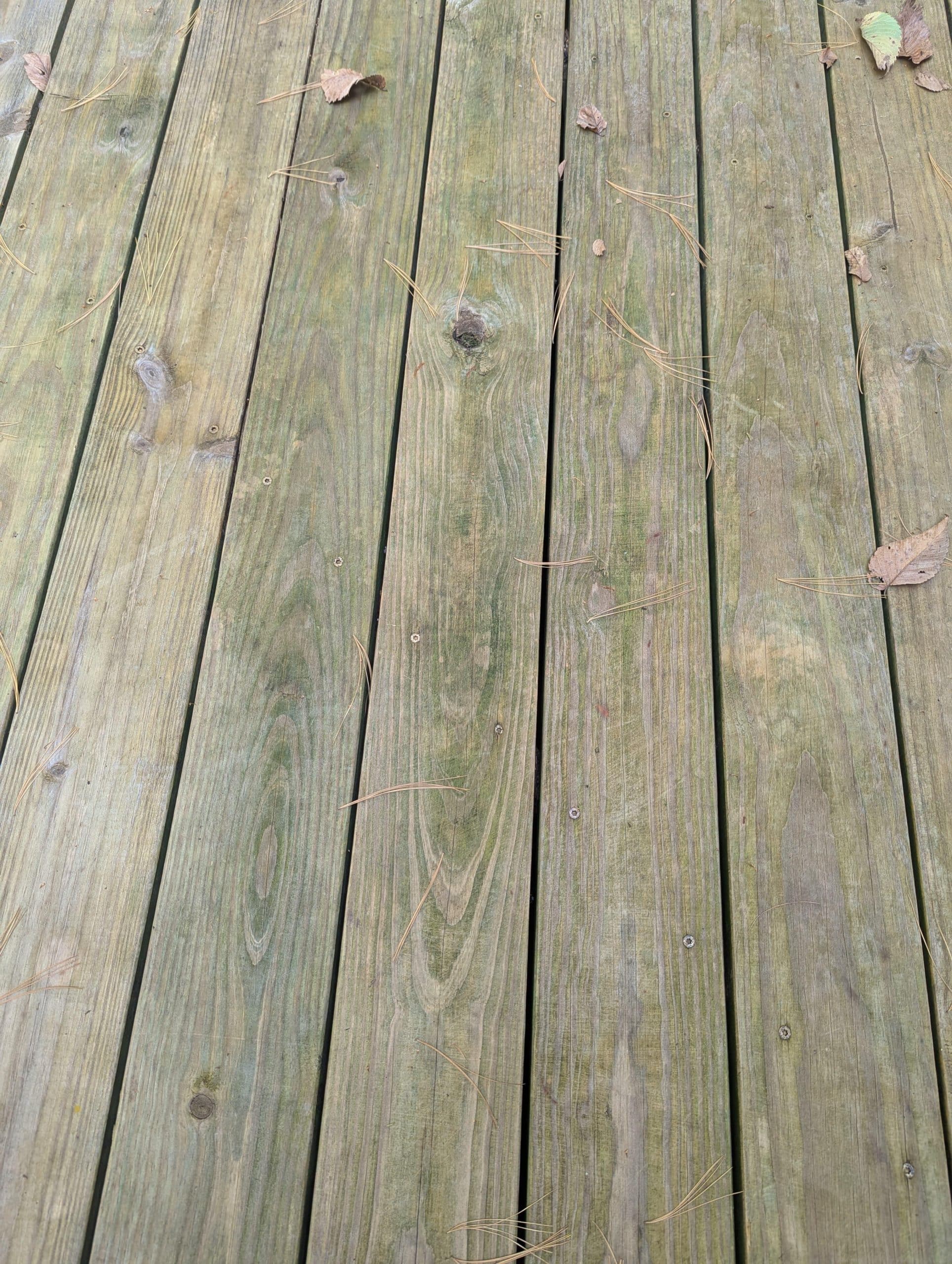

We have a 6 year old deck that has been cleaned and stained with restore a deck products. this is our third cleaning and our boards have a green hue to them we have actually cleaned the deck twice with the cleaner and scrubbed with a brush and power washed. Will this green color ever come off ? Should we strip? or just re stain the boards ? Is there any other product we should use?
Pictures? You can add them here in comments.
Our deck has a lot of shade and not much sun. Could it be that the green is deep in the wood ?
It seems to be embedded, but stripping and brightening should get it off.
Does this algae hurt the wood or just the look of the wood? If you use the stripper do have to use the cleaner again as we already used the cleaner?
Thanks Heidi
Just strip and brighten, not need for the cleaner. It should be removed before stain is applied.

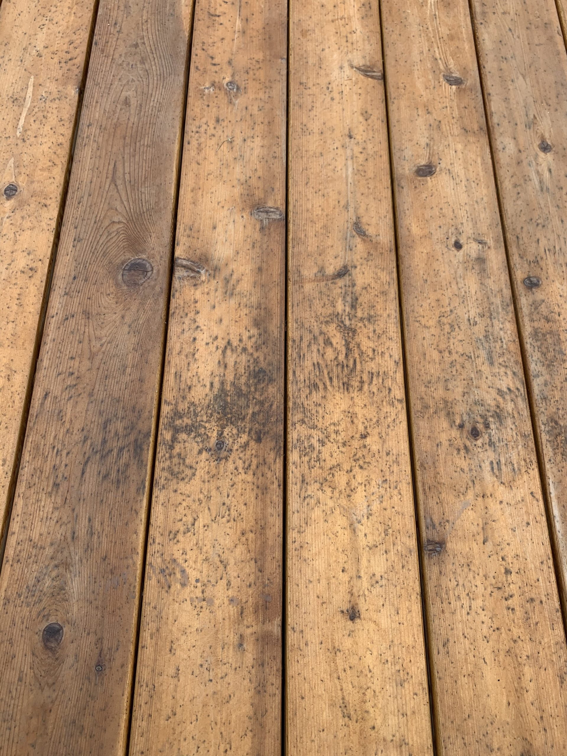

Cedar Deck couple weeks old.
Black stains all over. Was coated with Tompson water seal, black spots appier, than sanded and I apply penitrating oil, two weeks later , the same
It is either mildew or rust spots. What did you sand with?
With electric sander that use sanding paper, a part of it i used a planner
You should not have stained the new wood right away. https://www.deckstainhelp.com/staining-a-new-deck/
Looks like rust spots to us. Best to strip off (this will remove it if mildew) what you have on there, brighten the wood (this will remove rust), and then let it sit until next Spring to properly weather. Clean and brighten in the Spring and then stain with a proper penetrating semi-transparent stain: https://www.deckstainhelp.com/best-semi-transparent-deck-stain-reviews-2020/
