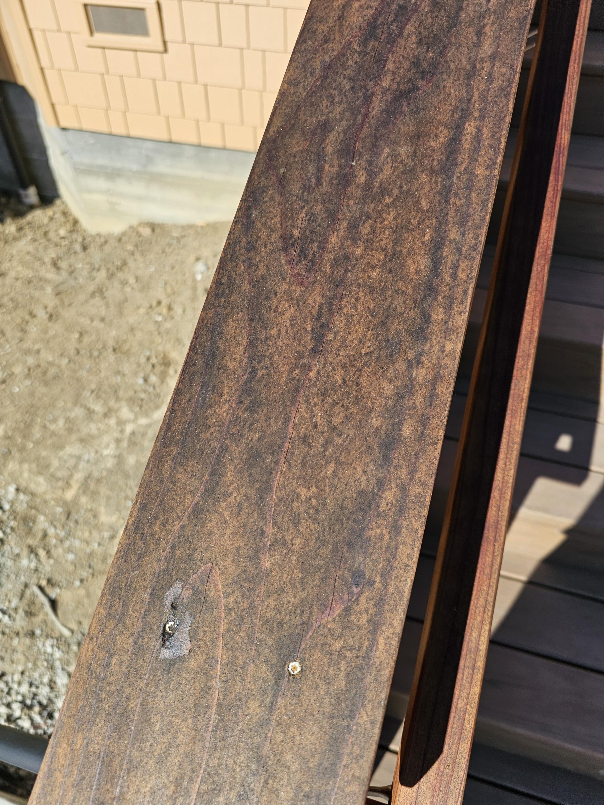

Any idea why these brand new boards developed mildew/mold just weeks after they were stained? My contractor used Penefin.
Also, why did the stain drip all over the deck after a few weeks? There was no rain, only morning dew/condensation.
The rails seem fine but the top boards are all like this. How do you suggest I repair and renew this? Which products and in which order?
Thanks much,
Yes, that is mildew. Most of this is related to the Penofin itself. Not only does it smell bad, but it has issues with darkening over time. Usually, it takes months or a year, but yours is accelerated. I’m not sure about the drips. It seems it never fully cured.
You should strip and brighten to remove and start over with a better stain brand that does not have these known issues:

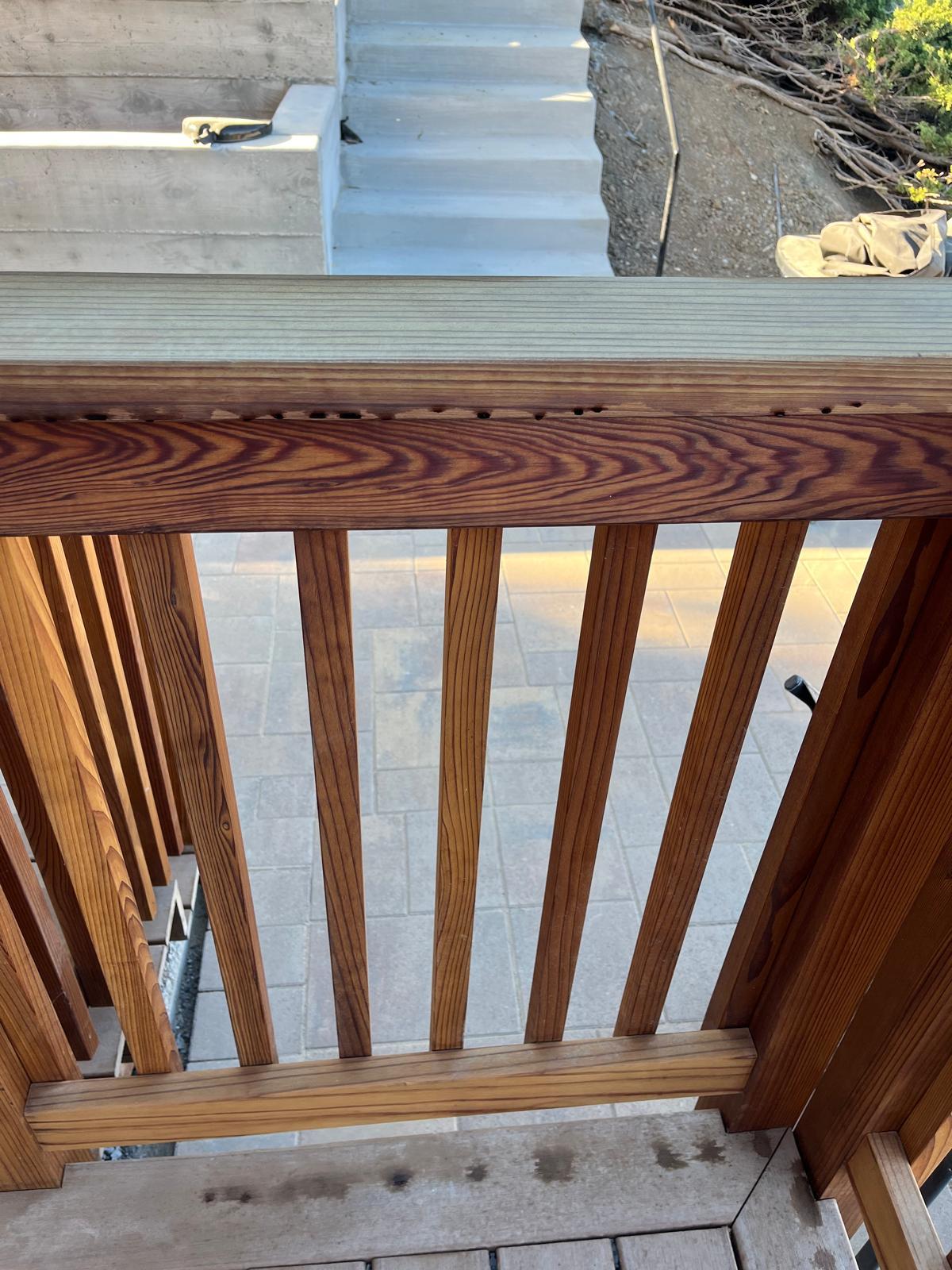

I have a covered screened porch with a tongue and groove ceiling. The contractor put an oil base water proofing on it-two years ago. There are a few boards closest to the screen that have some mold/mildew on them. I have washed it by hand but not all of the mold came off. It seems to be under the waterproofing. I would rather not strip those boards in case they will look different than the other boards. Please tell me if your RAD Guard mildew cleaner and preventer would take care of my issue. I would have to apply the product by hand. Thank you for your help.
No, if the mildew is under the coating then the only way to remove the mildew is to remove the coating first.

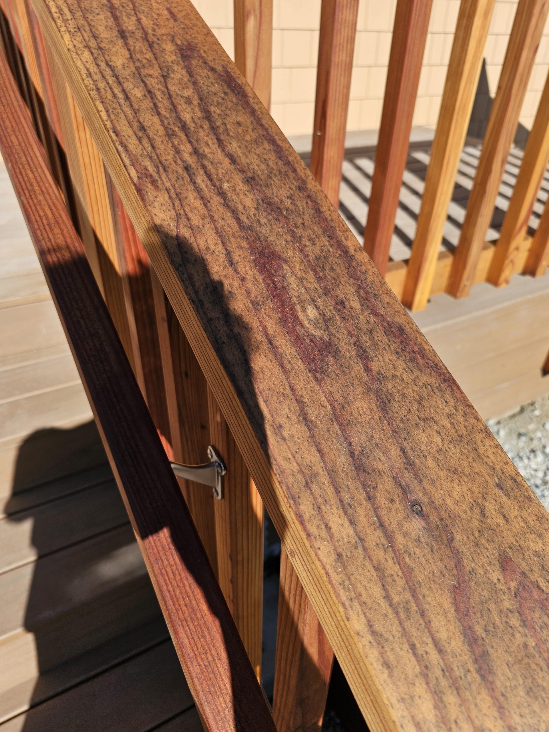

Pic attached is the mold and mildew built up on the oil based stain and after it was power washed off with a lot of effort.

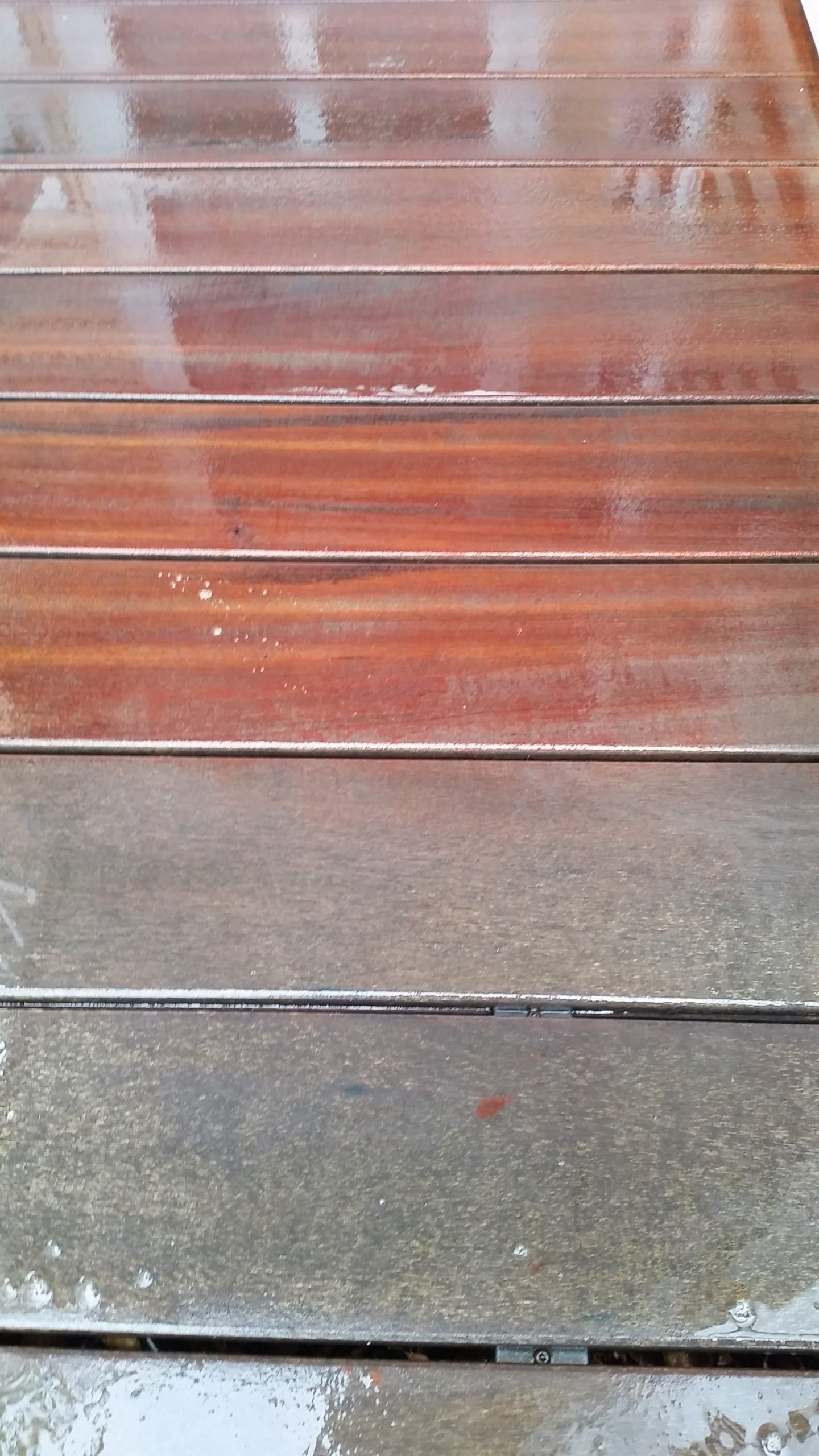

I have a Brazilain hardwood deck at my lake house that is very near the water. The deck can only except an oil based stain and has previously grown mold and mildew very quickly. So thick you can scrap it off with your fingernail. I just had the deck stripped and sanded. I want to know if i apply a new coat of oil based stain can I apply RAD on top of the stain to prevent the mildew build without discoloring the stain?
Yes, the RAD Guard will help here but it is not true that you can only use an oil based stain. Many penetrating water based stains will work on exotic hardwoods. Example: https://www.deckstainhelp.com/restore-a-deck-wood-stain-for-exotic-hardwoods-review/
