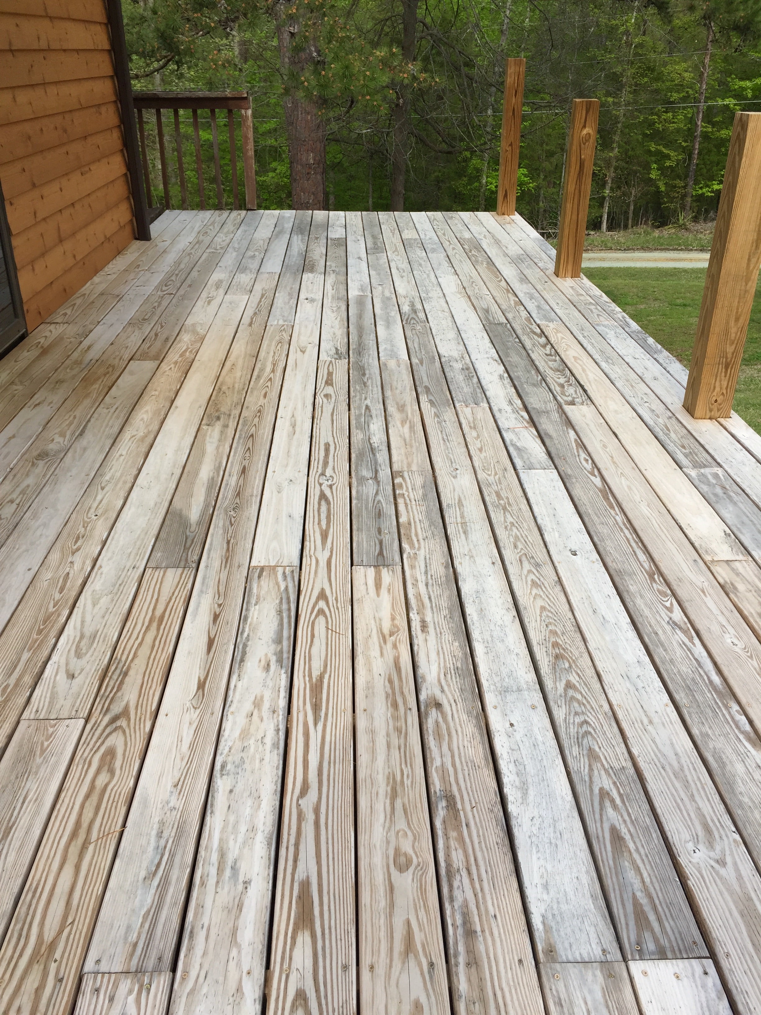

I installed new deck boards last August and want to stain now. I have big differences in surface color where I had an outdoor carpet and a piece of furniture as you can see in the photo. I wanted to use a semi transparent stain but am afraid it will look really bad. Any ideas on how to handle this?
It looks like there is a stain coating on there already?
No. The very light circle area is where I had a piece of furniture all winter. The ‘mid light’ area is where an outdoor carpet was for the fall and the darker area was always uncovered. I was surprised at how different the amount of weathering was. I used a deck wash but it did not change anything. Wondering if I have to sand the dark areas before I stain or would some type of brighter work?
Brightener will not even this out. Try sanding and then brightener after.
Thank you. Will give that a shot next

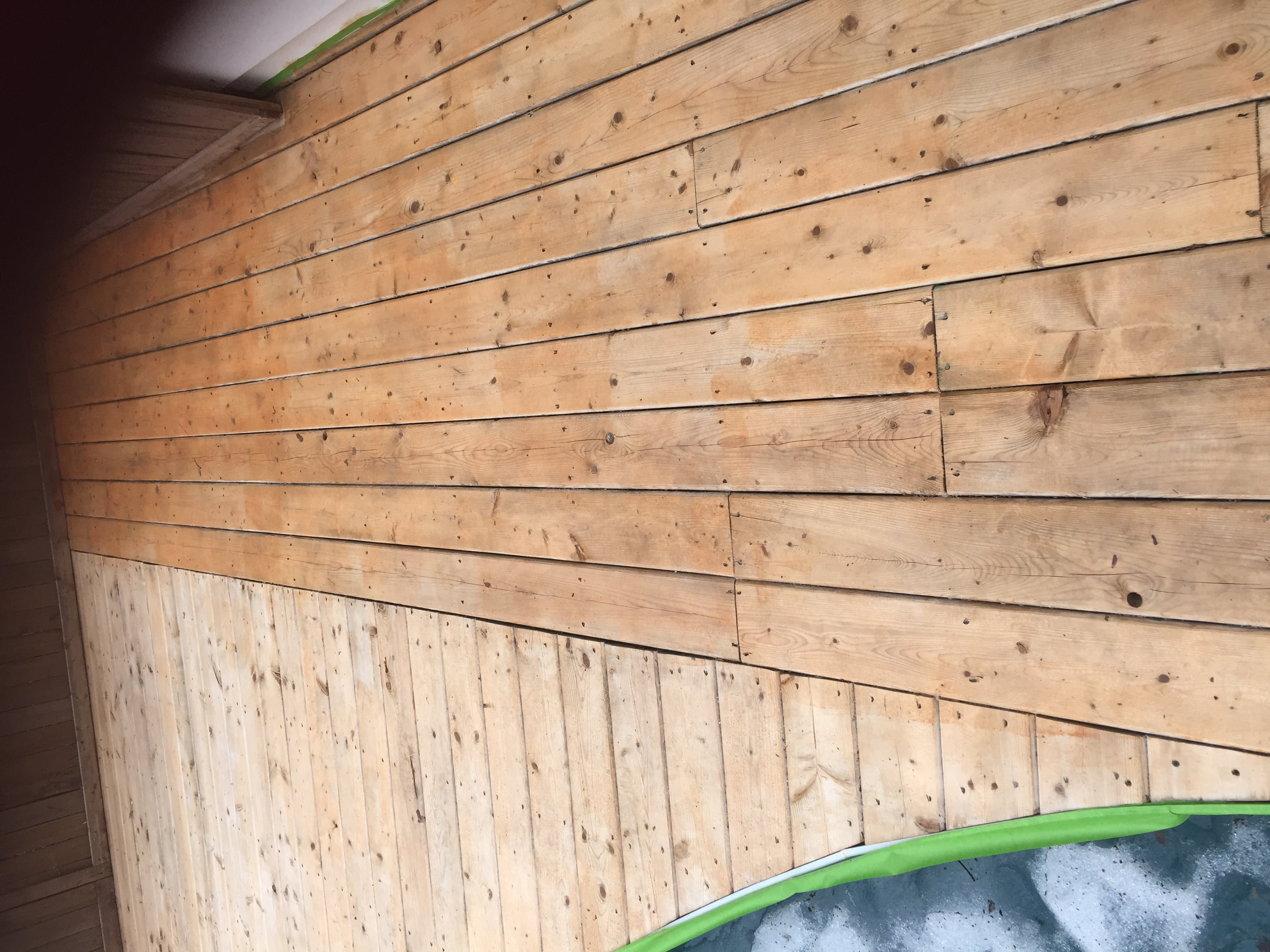

I made a major boo boo and need help. So I waited 18 months after my cedar deck was installed and used the Restore A Deck cleaner and brightener and it looked great at first. When it was all dried thogh, I found there was a lot of tiny grey hairs that didn’t come off with the scrubbing.
And I don’t know where I read wrong (or maybe my brain just doesn’t work because I have a new born and a toddler) and sanded the hairs off with 120grit and then stained a section of deck and stairs. Only after that did I realize the Armstrong Clark Semi Transparent stain I have says max 80 grit sanding and now that I’m reading this page again I see that I’m not supposed to sand new wood period.
Well as expected, the stain absorbed some, but not very well and there is a film of stain sitting on top of the wood and hasn’t curd fully. It is still a bit greasy after 3 days.
So I’m wondering what my options are now. For the unstained portions of deck, I figure I need to go back and sand that at 80 grit now before I stain it. Should I spray it with water after sanding; does that open up the pores at all?
And I’ve been using a scrub brush and mineral spirits to remove the film on the stained boards. I’m wondering what I do after that? I’m really trying to avoid stripping it as I have painted combface trim risers and powder coated aluminum railing posts that I don’t want damage.
Do I let it sit for a year with what little stain did absorb and go back and sand it at 80 grit then? Or just clean and brighten and then restain after a year?
The deck is cedar and I am located in Victoria, British Columbia, Canada. The deck gets morning and early afternoon sun. Shade from mid afternoon onward.
Thanks in advance for your help
Use a stain stripper to remove the AC. Brighten all the wood again after. The fuzzies are oxidation fibers from sitting unstained for 18 months. Buff those off. See here:https://www.deckstainhelp.com/wood-fuzzies-furring-on-deck/
And what about the unstained portion of the deck that I sanded to 120grit. Should I just re-sand with 80 grit? Should I do another clean and brighten?
Thanks again.
Yes on both.

Hello, thank you for your article on staining a new deck. our deck is about 7 months young 😉 and we are wanting to stain it before summer gets here.
I saw that you said not to sand the wood because it will not allow the stain to penetrate. So what should we do with the rough spots that can cause splinters 😬…
I took pictures of some of the areas that I am worried about.
Thanks for your help in advance.
If you need to sand splinters, just lightly hand sand those areas. Do not power sand and use 60-80 grit paper.

Guys I need help. I wanted to surprise my husband by staining our new pool deck while we was away. So I used Olympic deck cleaner followed the instructions and loved the results. I let it dry and taped off the pool and surrounding areas I didn’t wait stained. I picked Olympic semi transparent cedar natural tone. At first I was loving how it looked it motivated me to finish it all. I was careful and made sure to leave a wet edge so there wouldn’t be lines but once I got to the last section the stain is so much darker then the rest. I could see a difference when I poured it out of the can. I hope in the morning it would be better but it all looks nothing like yesterday. :(. It is about 24 hours later. We r expecting rain tomorrow and I’m praying it will just wash away. What did I do wrong and what can I do now? I really just want to have a nautral look to the wood. Our deck is made with spruce. We cannot have pressure treated with the pool chlorine incase of splinter etc. Thanks. But someone please help!!!! Pics r of opposite ends of the pool. See the color difference. Ugh!!!!!!!
The only and best way to fix this is to strip it all off and start over. It does not wash away. :sad:
I figured that’s what I would end up needing to do. Just wanted to see if anyone had options. Can I ask once I strip it what would u recommend for around a pool?
Armstrong Clark would work well.
