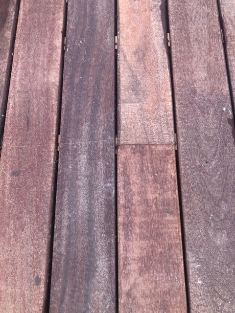

I just had an IPE deck installed with a mahogany top rail. I purchased Cabot Australian Timber Oil (Natural) to oil the top rail where guests frequently put their drinks. Is this a good product for use on the Mahogany top rail? Is it ok to leave the Ipe deck just weather and turn gray or should it be treated too? If treated, how long should I wait? Thanks for your help.
Jim Speros
Cabot does not work well. The IPE should be stained as well. Look at these brands:

Hi can yu plz suggest what should I do with this decking. I would really appreciate if you can plz briefly explain the procedure and what paint needs to be used on it. Thank you so much
That is IPE wood. Strip and brighten the wood for prep and then stain with one of these brands for IPE: https://www.deckstainhelp.com/ipe-exotic-hardwood-stain-review/

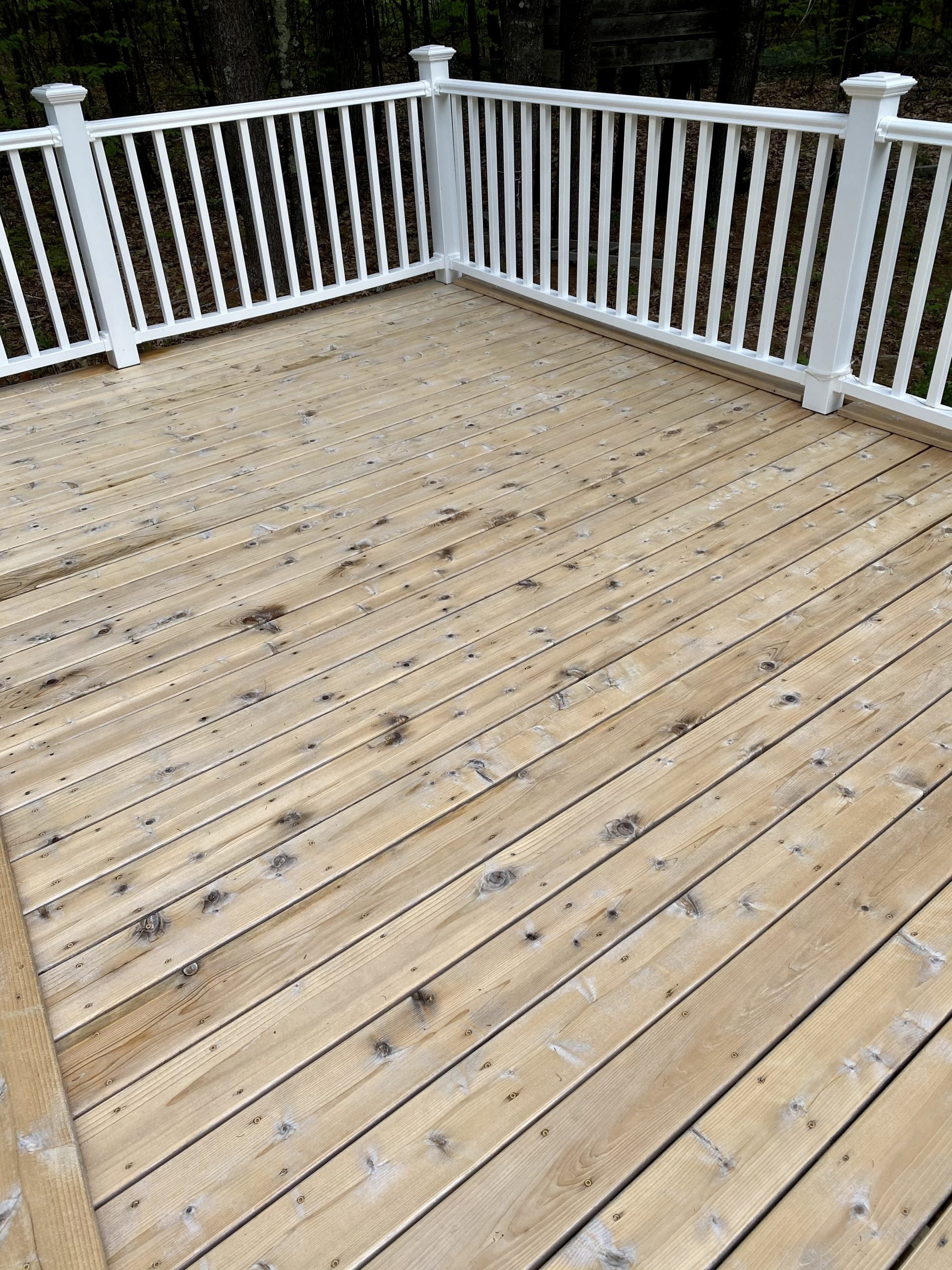

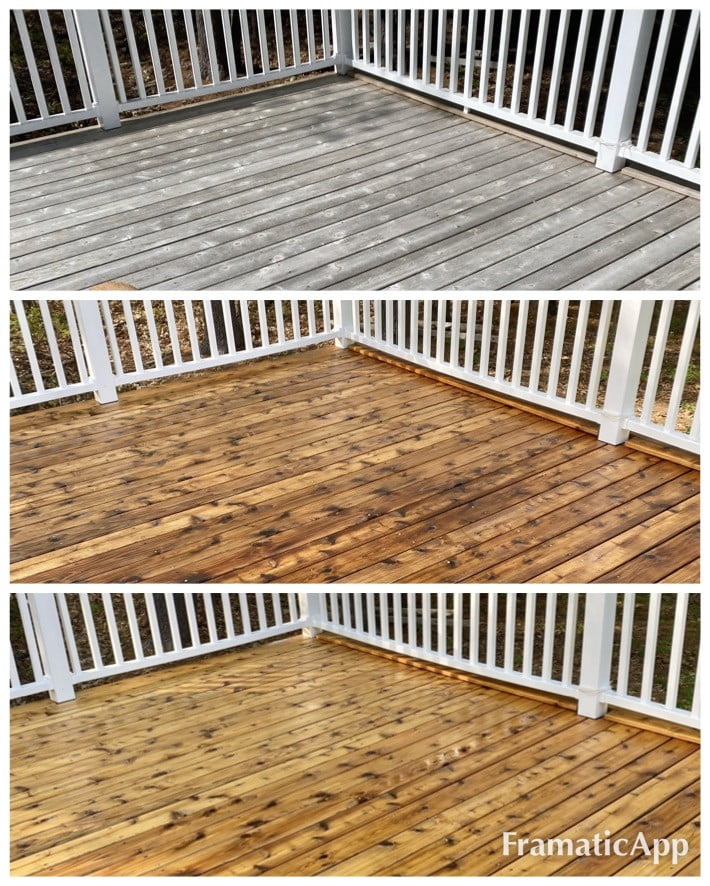

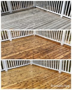

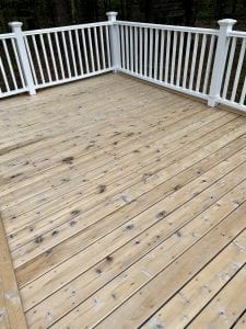

Thank you!! I’m back! Great results from RAD cleaner and brightener. I got stain samples from Armstrong Clark and RAD and used them on an extra board. The AC took hours to soak in. The RAD soaked in immediately. Does that matter? Is soaking in quickly good or bad?
Thank you so much! You’ve been so helpful. Photo is original, after cleaning, after brightening.
Soaking in is good. Prep looks good so far.
Great. Then RAD it is! I like their color choices better too. This is dried this AM, lightened quite a bit. Maybe rinse once more and dry 48hrs before staining? Ready to order stain now. And get going next weekend. You’ve been so helpful. Thank you. Thank you.
No need to rinse again.
Thank you!!!!
Note: The dark spots in the corners are from rain yesterday

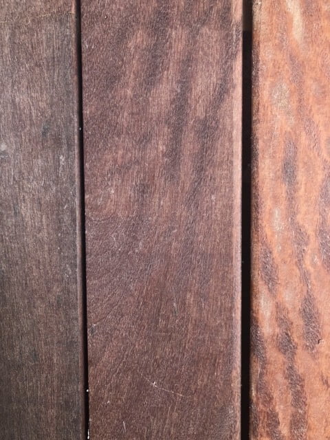

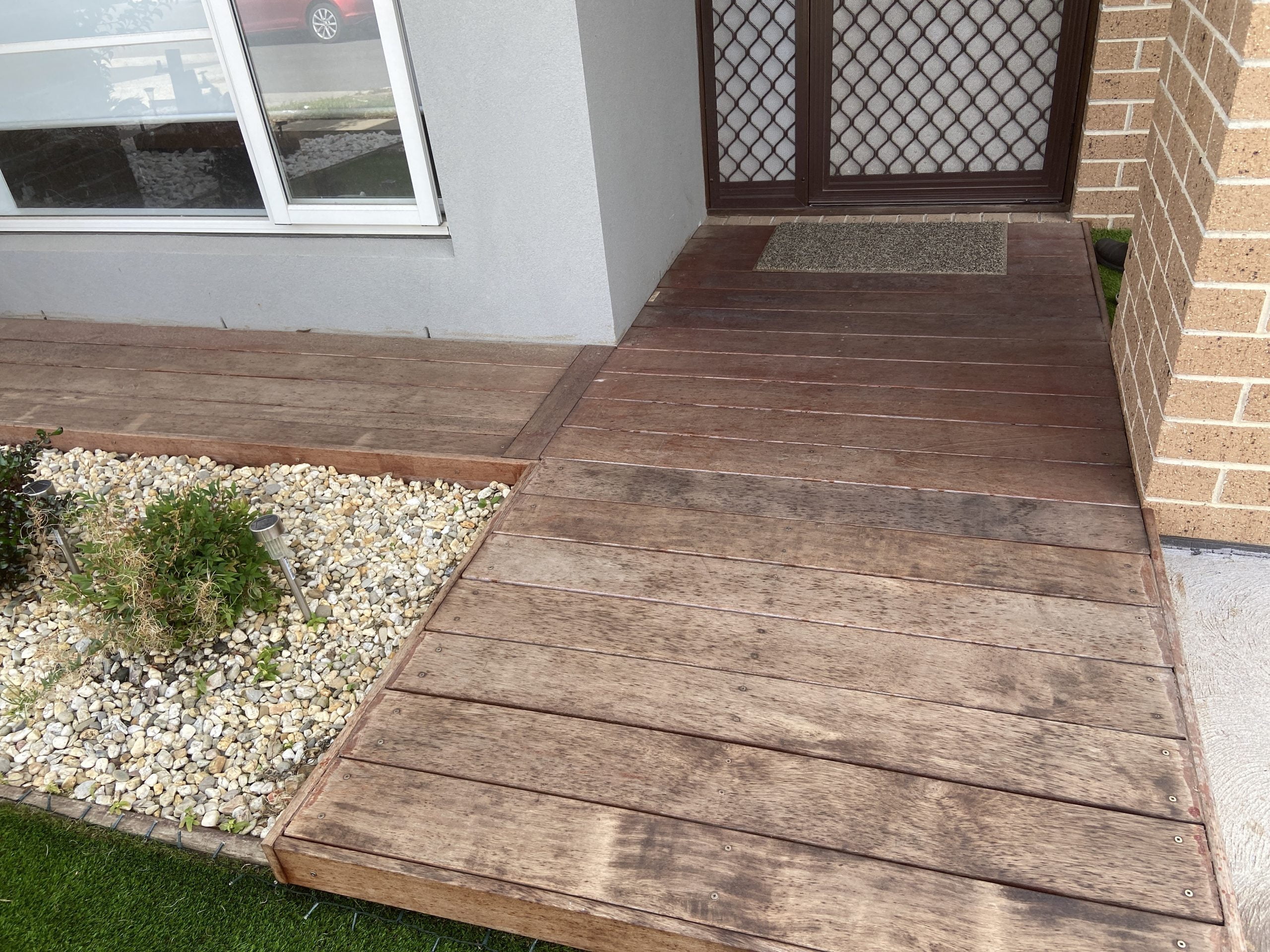

I oiled my brand new ipe deck (left without oil/stain for 2 months) but 6 hours later it rained quite hard. Not sure if it was because of this but there’s a light whitish haze on it which won’t come off with a simple detergent wash. Not sure what to do. Will a more dedicated cleaner help? Do I need to re apply oil? Thanks in advance.
Post a picture of deck and what product did you use?
The oil that came with the deck from the seller. Not much info on the tin apart from ‘teak oil’
Note: The dark spots at the corner is from rain yesterday
It just looks washed out. Try another coat to a board and see how it dries.
Thanks for the advice. Shall I use a deck restorer/brightener such as Owatrol NET-TROL before I add the oil?
No, never use an additive into the oil.
As you’ve advised to re-oil it due to wash off, shall I use a bleach/water solution to clean it first? Or perhaps a deck detergent? Thanks
Just wash with water and then let dry.

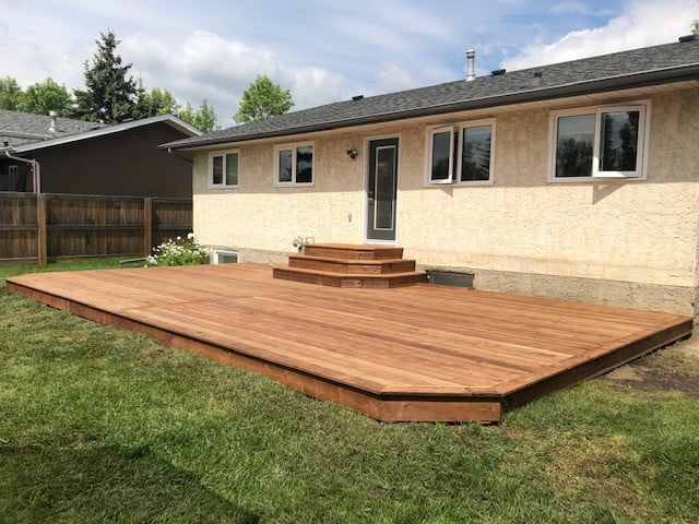

Hello, we live in Edmonton Alberta Canada and built a new pressure treated pine (brown) deck in May 2020, deck gets full sun all day with harsh winters, looking for advice on semi-transparent stain that will stand up to the full sun and harsh winters and that is available in Canada or that can be ordered into Canada, great site by the way. thanks
TWP 200 Series or Armstrong Clark Stains. Make sure to clean and brighten the wood for the prep.
I may prefer the RAD or Defy colours over the AC colours, would the water based RAD or Defy be inferior to the oil based AC or TWP?
No, they would both work very well.
Also the deck is basically on the ground with little air flow, any potential issues with stain failing from moisture below?
What experience do you have with the TWP WS series stain?
We tested it once and it was okay. Not much besides that.

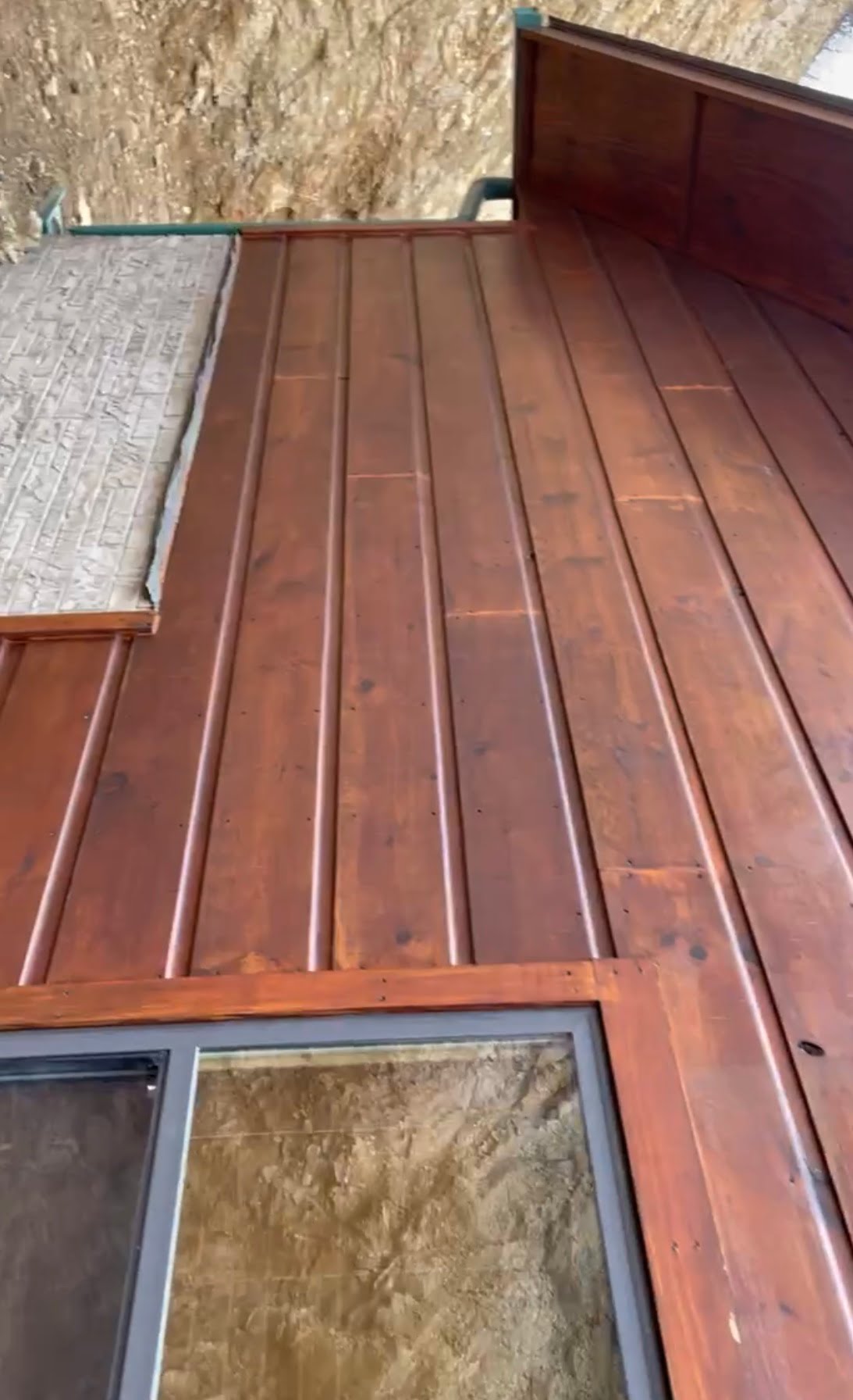

Help please! Just bought a cabin in Tennessee, the wood siding on the exposed wall needs work, the sheltered side looks good. I have no idea what was used. Suggestions please!
You will need to remove all to fix, but it does not look like it can be stripped. You will most likely have to media blast to get it all off. When removed fully, use a penetrating stain that can be cleaned and reapplied easily down the road:

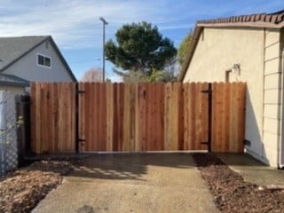

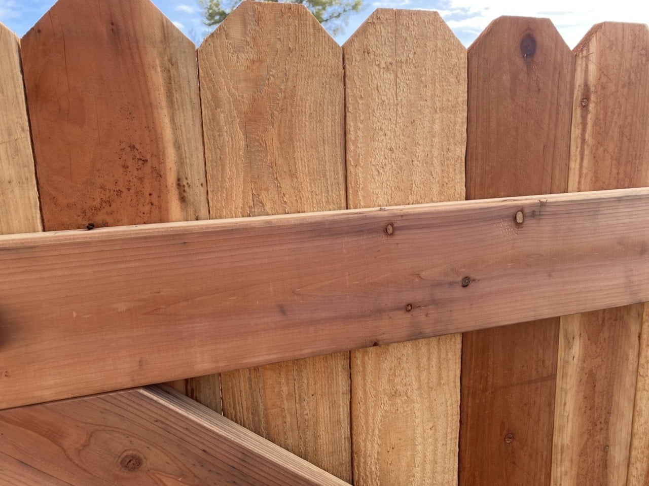

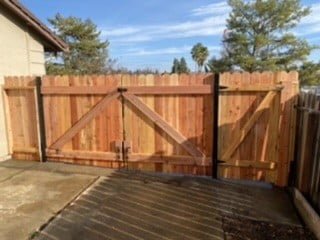

I have some confirmation items and a few questions on a new (Redwood) gate I had installed. Dimension are approximately 17’x6’. The installing company office said to wait 30 days before staining, but the crew on-site said he’d stain it right away (confusing and conflicting info). So, I looked at the wood and believe it is ‘rough’ sawn wood, but attaching photos to confirm.
My questions:
1. If rough, I didn’t need to wait for weathering (even if manufacturer suggests waiting xyz time), correct?
2. I live in Northern California (just outside of Sacramento), and it’s been raining since the installation about 2 weeks ago. So, if it is rough wood, I need a window to still clean/prep the wood, and wait about 4 days to dry, and then stain, correct?
3. I was planning on applying with a brush since it’s not too large of a project and to cut down waste. It seems that on your site, brush application with roller is ideal. So I should be fine there, correct? Versus applying with sprayer and following up with roller.
4. I was looking at the Armstrong Clark semi solid Sierra Redwood to keep it as natural looking as possible (but still get some UV protection). Do you feel that’s a good choice?
5. How many gallons would be needed with brush application? Dimension are approximately 17’x6’.
6. Since so new (only installed about 2 weeks ago), would just water and scrub brush be enough? If not, is using just the restore-a-deck cleaner enough? Or, the brightener is recommended as well?
Thank you in advance for taking the time to go through all this!
1. Crossboards are smooth, the rest is rough. You should wait and prep.
2. Wait 3+ months, prep, stain 2 days later.
3. Brush or stain pad. Do not roll.
4. AC works very well. Their Redwood Tone is lighter though and more Natural than Sierra Redwood.
5. 2 Gallons should work.
6. You need a full prep after the wait.
