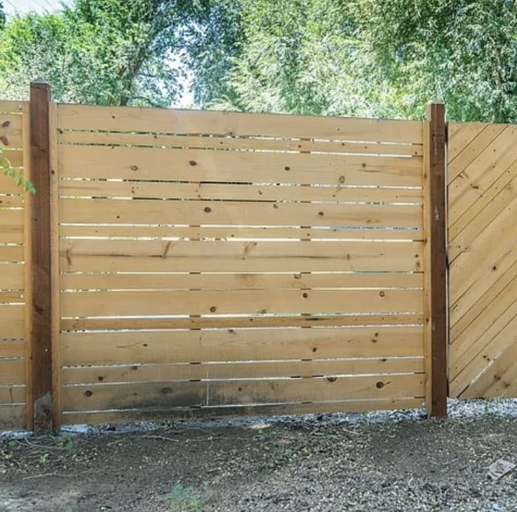

New Rough Sawn Wood
There is no need to weather or prep new-bought sawn wood. It is very absorbent and will not have a mill glaze. Just make sure it is clean, and you can go ahead and apply your wood and deck stain.

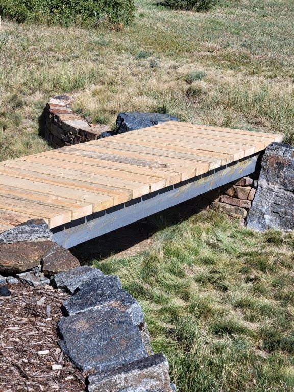

I have a bridge that I just replaced the planks with rough sawn ponderosa pine. Planks are 3″ X 10″ X 5′. They were cut at a local sawmill about 4 weeks ago and wood was pretty green. I cleaned them with a bleach solution and pressure washed them before I put them on because they got a little mold/mildew on them from how I had them stacked the first couple of weeks. The support structure underneath is the same wood installed 8 years ago but was still in good shape. It was treated with AC semi-transparent stain a couple of years ago (Driftwood). I want to clean/brighten and stain the entire bridge with the same stain as soon as I can. Do I need to let the planks dry out before I do that? Everything I see on your site and others about rough sawn wood says I can stain right away, but when I called the online dealer I purchased the AC stain from last time they told me I should wait 6-12 months before staining. I want the wood to last so just trying to clarify what I can/should do. Thanks!
You can stain right away if rough sawn cut. Just make sure wood is dry for a few days after rain or prep.

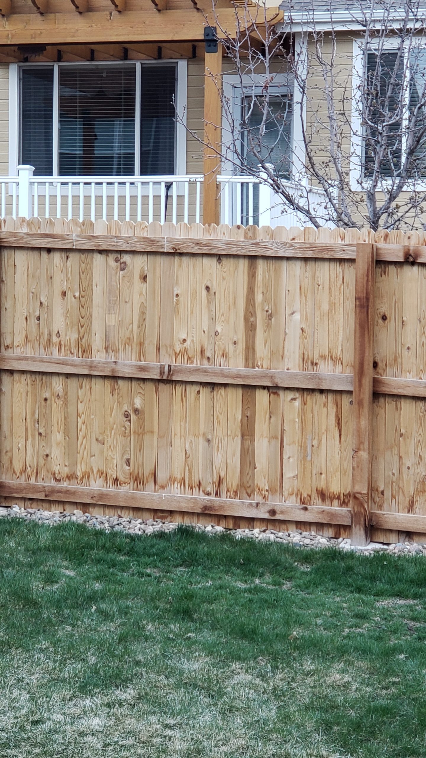

Hi, we bought a house that has an untreated pine fence. The boards are not pressure treat. It’s been up a year and has no fuzzies. We are in a hot dry area of Washington state. Any suggestions for stain would be appreciated.
Restore A Deck Stains or Armstrong Clark Stains.

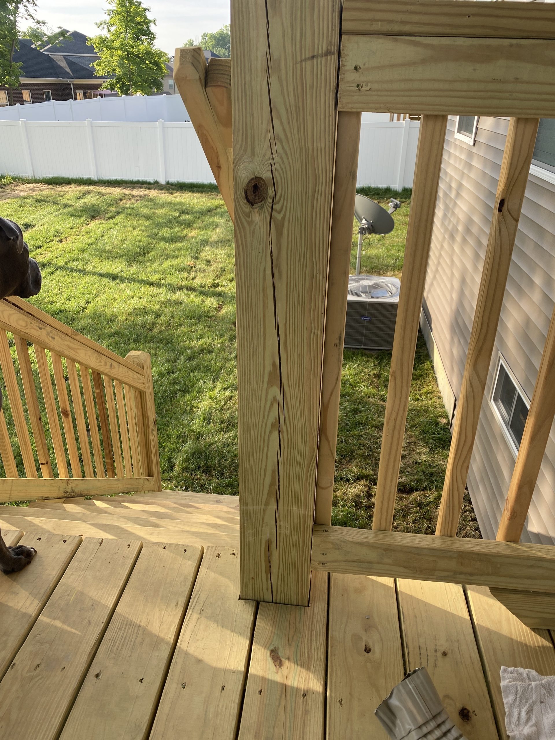

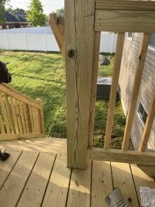

If a newly installed deck is turning black in some areas should it be power washed immediately?
No need to prep until you are about to stain the deck.

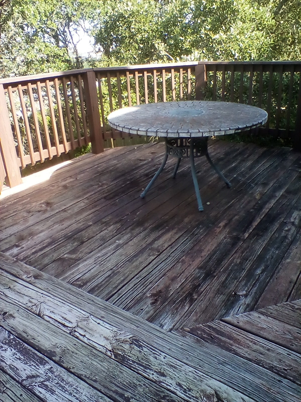

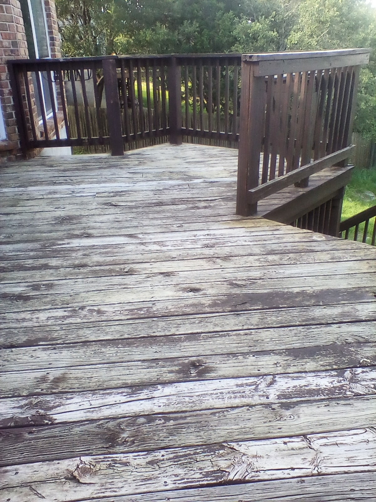

Have 19 year pressure treated fir deck with cedar top rails and bannisters. Has previously been stained with Olympic dark brown semi transparent stain. Held up particularly well on vertical surfaces… peeled and wore excessively on horizontal surfaces/deck. Need to replace a few boards and looking to strip and brighten deck and stain deck and other horizontal surfaces with an Armstrong Clark or TWP semi-solid stain, and recoat Olympic intact stain after pressure washing, for two tone affect. Live in SW Texas…deck gets Eastern exposure to sun most of the day. Good or bad ideas?
Do you have any pictures of current condition?
Pics show current condition…
Strip it all down with the Restore A Deck Stripper and both additives that they offer. Brightener after. Use the TWP Semi-Solids as they have more options for a two-toned deck. Here is a picture using their semi-solids.
Thank you appreciate the insight/advice…

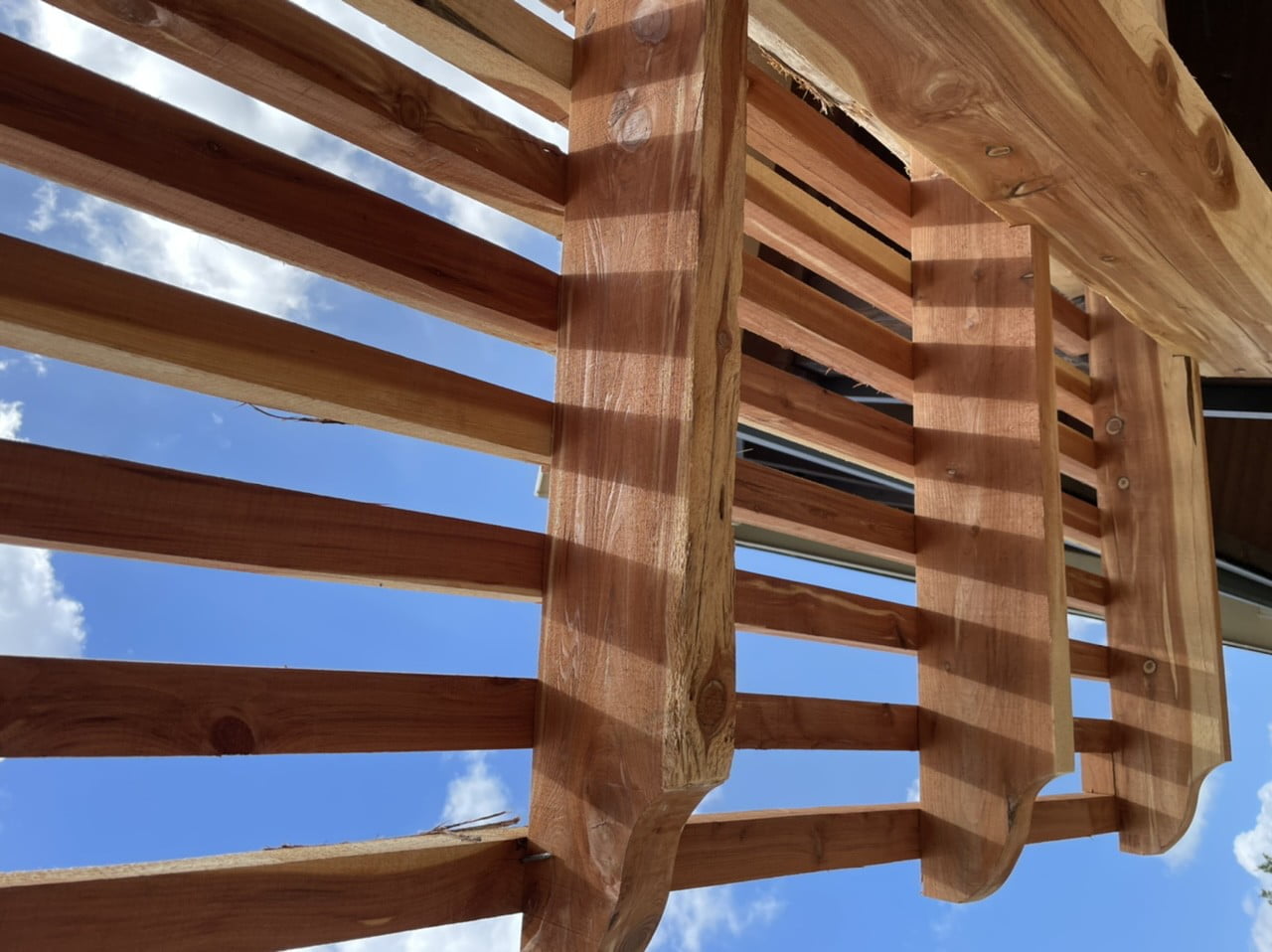

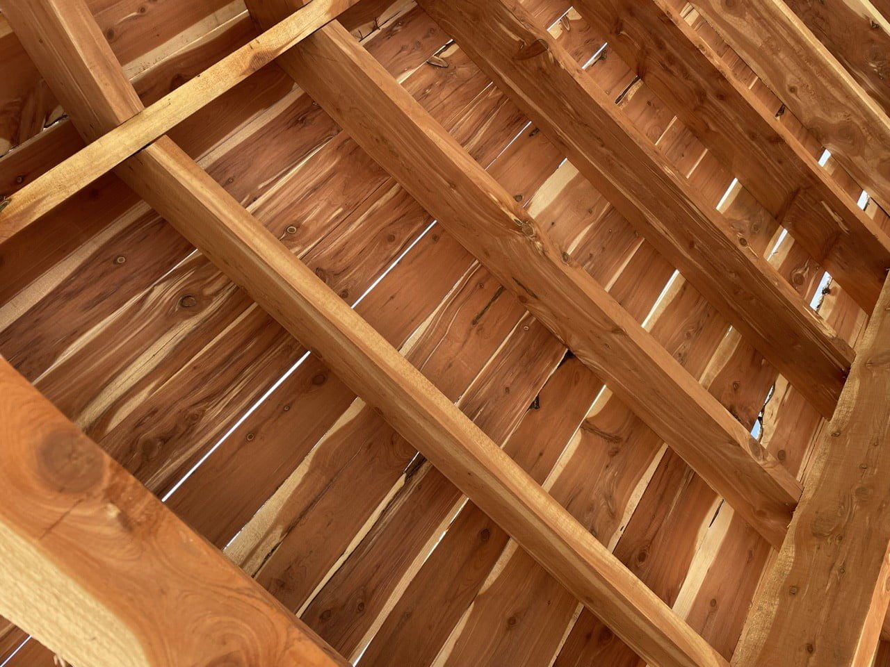

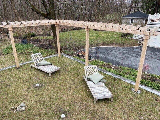

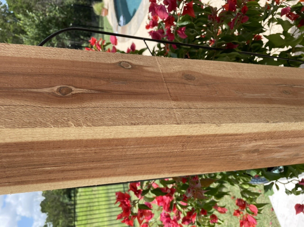

We have a new aromatic red cedar pergola and pavilion – I don’t know if it is considered rough or smooth. Should I use twp product now or wait for it to season for a bit?
Rough sawn. You can stain it now. Use the TWP 1500 Series.

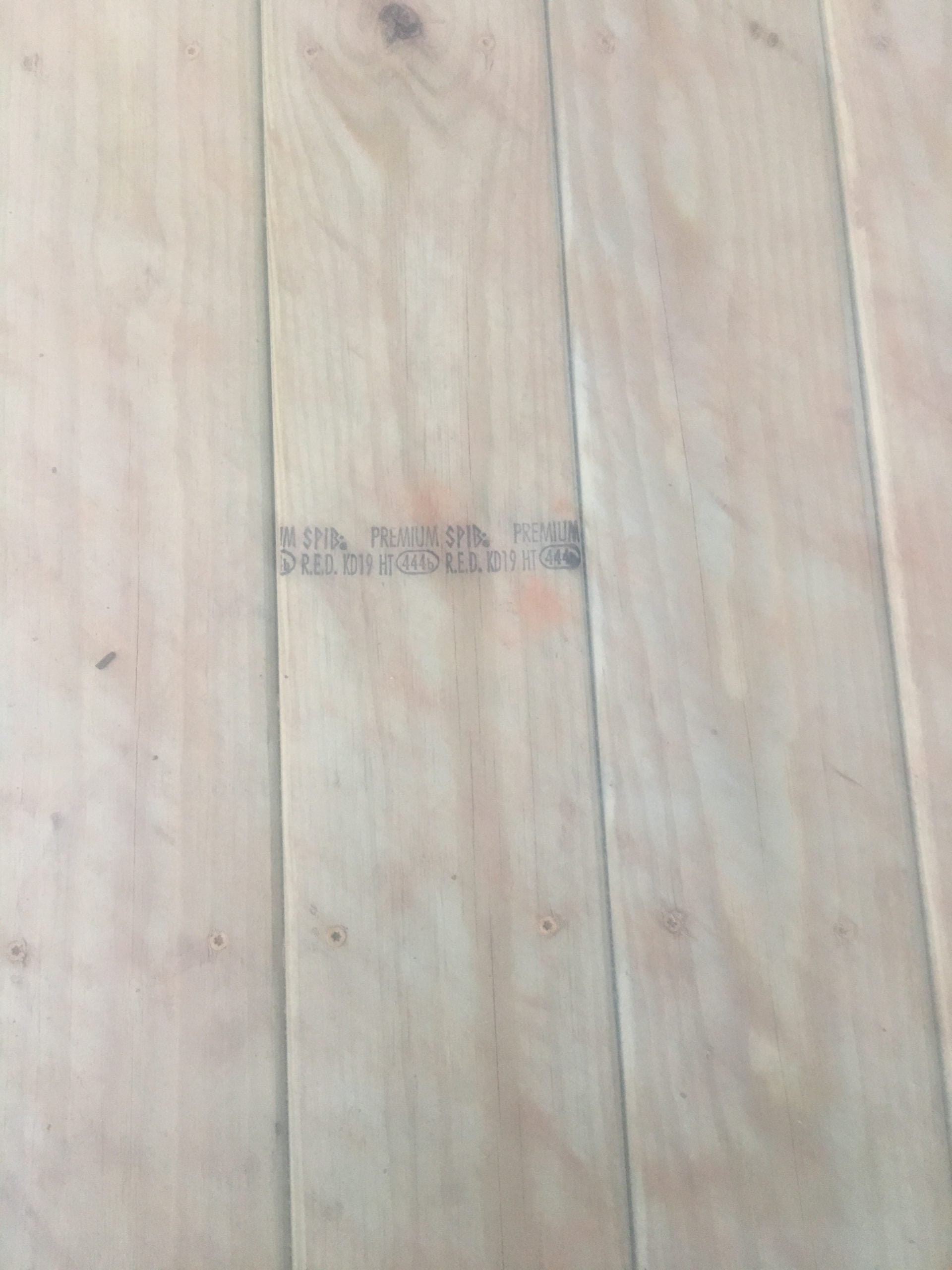

I tested our new cedar decking by putting water onto a section. The water beaded and was absorbed within 3 hours. Is this a sign that I can stain my new deck?
No. You have to weather and prep as the above article explains.

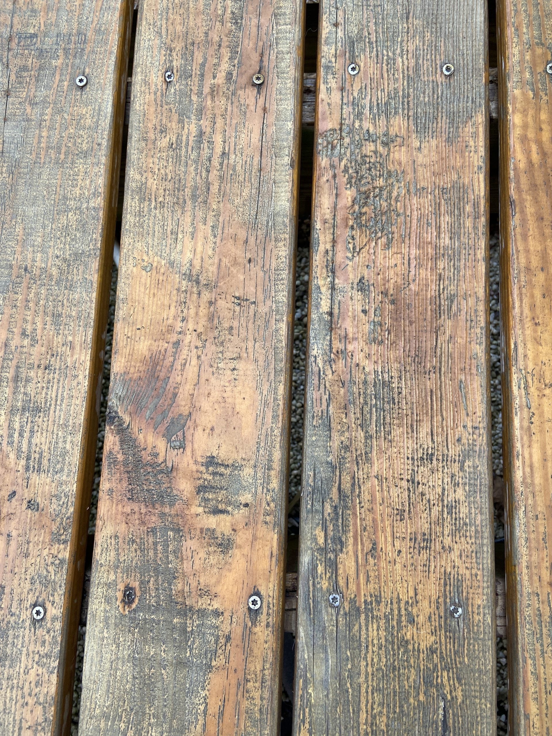

I have a trex deck 10 years old. Previous owner (bought house in2019) they used a Thompson sealer and hasn’t worn well. Was splotchy and sun faded. So, I scrubbed & cleaned the deck & hosed completely. I used a a Valspar one coat exterior sealer CLEAR. Went on well, however where I over lapped in some areas it looks like it has a yellow pollen . How can I correct this it’s not all splotchy ?
I tried buffing with fine steel wool…. Not working. HELP!,!
You cannot spot fix this. You will need to remove all and start over. Never use steel wool a deck. It will metal that will rust and leave black spots in your wood.
When you say start over, what exactly should i do? How do i prep the deck and with what product do you recommend?
Then what sealer do you recommend?
Strip and or sand to remove all, brighener after. Use TWP wood stains or Armstrong Clark Stains. See here for the best options for stain.

My redwood deck was built in Sept 2019 and has been weathered. I would like to clean it and then stain it, but would like the natural color of the wood to show. Can you recommend what to clean it with and then what product to use to stain it. Also any recommendations on the best way to apply the stain? Thank you.
Use the Restore A Deck Cleaner and Brightener Kits for prep. Stain with Restore A Deck Stain in a light color like Natural or TWP Stains in Honeytone.

I recently had a deck built on 4/5/21
It’s just over a month using the brand yellow wood, I am now seeing what appears to be splitting of some of the deck boards, and two of the post. Is the normal part of the drying process?
Yes, that is normal and not a big deal.

We are in Parker, Colorado. We had all new cedar fencing installed in November 2020. We were told to wait to stain/seal and have an oil based natural stain in mind to match our front panels which have done well with the product (Cabot Australian Timber Oil). Spring is here and we are noticing water bleed stains. Did not expect this! What do we do about the water stains? Thank you!!
There is no way to prevent this. Cleaning and brightening prior to staining will help to remove some of it and the stain will hopefully blend the rest. Might want to consider a better stain option as Cabot changed their formulas, and it is not as good as it used to be: https://www.deckstainhelp.com/best-semi-transparent-deck-stain-reviews/

I built a linear-ish pergola last October using 5×5 white cedar fence posts and 1×6 white cedar deck boards (smooth). It has been weathering ever since, untreated, through a Massachusetts winter. I am planning to use TWP 1500 (unless advised otherwise!). Is a cleaner/brightener an appropriate step to take before staining, given that it is a vertical/elevated structure and has not been walked on or gotten especially dirty? It has definitely weather/lightened a bit in the last 7-8 months, but has stayed otherwise clean.
Yes, that is correct prep.

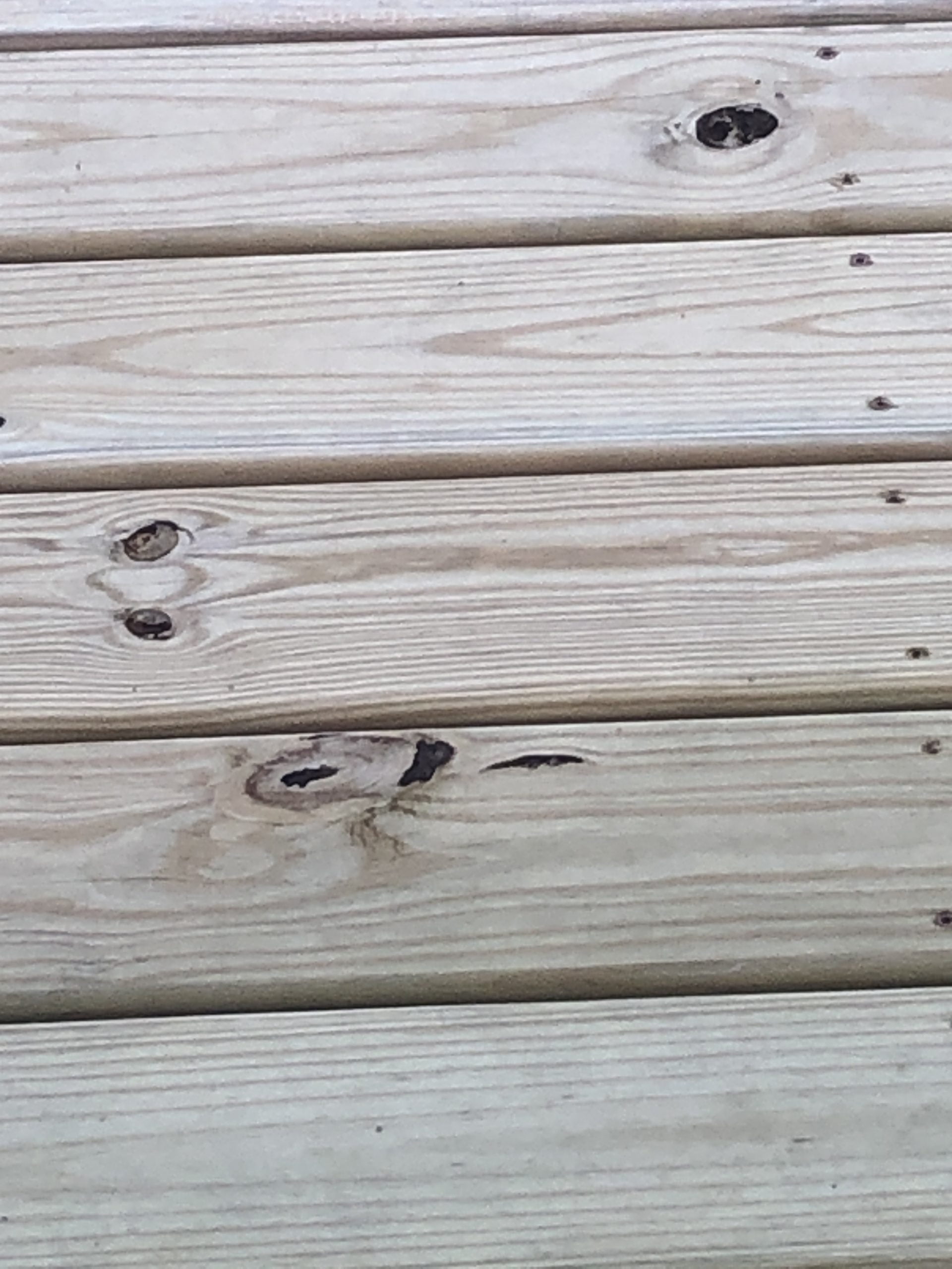

Last year we got our deck wood replaced. The knots on the pressure treated are coming off, review attached picture.
What should we do to prep it before we stain it this year. We are going to stain it ourselves as we did not like the shortcuts that were taken by the contractor.
We live in Michigan and the deck sees at least 10-12 hours of direct sunlight everyday,
Your guidance will be much appreciated
Clean and brighten the wood for prep using the Restore A Deck Kits. Stain with Armstrong Clark or Restore A Deck Stains.
Thanks for prompt response. Should I use any kind of wood fillers ?
Replacing that deck boards is the best option ?
Never use wood filler on a deck. It will not stain to blend.
Knots falling out is not a big deal, just leave as is.

I’m building a pergola out of new, smooth cedar in the very wet and rainy PNW. I understand that I need to let the wood weather for 3 months before applying my sealant of choice. Will the wood be alright sitting in the rain for three months, or does the term “weathering” primarily refer to UV light exposure?
It will be fine. Make sure to prep before staining.
Trying to see what kind of wood this is and how long to wait to stain with semitransparent stain
Pressure treated pine. You will need to follow directions in the above article.

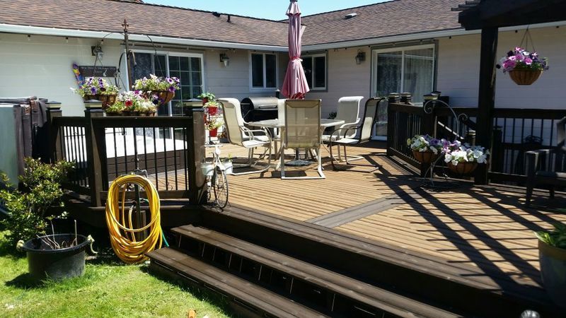

Hi. We live in Northern Califonia and just replaced our very large, old deck with a new deck made of redwood. The deck is south facing and gets scorched in the summer, with temperatures often in the triple digits. What deck stain will last the longest and wear the best in these conditions. We need it to last as long as possible as re-staining will be a massive project. Thank you.
After wait and prep, try the TWP 1500 or Armstrong Clark stains.
Thank you. I looked into each of these after your response to my original question and neither specifically mention how they hold up in extreme heat. Can you recommend any reading material on the subject of redwood deck stains that hold up in summer heat? Thank you.
They both hold equally well and with no issues in high heat.

We bought our house two years ago tht has a small painted deck. It looked like it was in good condition. By the second year, the deck was peeling and it was clear that several of the floor boards had rot and the railing was in rough shape. Over the summer, I replaced all of the floor boards and railing with new PT wood. I kept the existing foundation and stripped off all of the remaining paint. The deck has been cleaned and brightened and I’m trying to figure out if it would be better to stain the deck before winter (I live in New England) to protect the old wood or to just wait until next spring to do the whole thing. What do you recommend?
Wait until spring.

I just finished installing a new cedar tongue and groove horizontal fence. One side is rough sawn. The weather here in southwest Pennsylvania is turning cooler with highs in the mid 50’s and lows in the mid 30’s. I have cleaned the wood with tsp and then brightened with oxalic acid. I’ve been doing research on staining and have found conflicting information with regard to weathering of the new wood. I’ve been leaning towards products such as Wet Wood Stain and DRP Best because of the temperature and lots of rain. These products say they can be applied in these condition with optimal results, but then I came across your site which says to wait. I am concerned with waiting until the spring time to stain and how much graying if any will occur and the prep work to bring it back to its present state. When the fence is wet either by rain or me spraying it absorbs the water and seems to dry fairly quick. All of the T&G material I’ve used for the project has been stored indoors. The dimensional lumber is rough sawn and stored outdoors but covered.
What would you recommend for my application from the above information? Would it be better to wait until spring and apply a “true” oil based product. Do these damp and wet wood “hybrid” products compare in wearability to true oil based products? Are higher VOC oil based products better to use if available? Lastly, I’d like to like to apply the lightest stain as possible to accentuate the natural state of the wood and still provide optimal UV, mold, mildew, and algae protection. Your thoughts?
Spring for sure. Prep and stain then. Use one of the top brands in the above article in their lightest tint. You would need the TWP 1500, not the 100 for PA.
What are the pros and cons of the 1500 vs. 100? Also, why not use one of the wet wood products? There is a small section of the project I need to stain now since I have to build a shed in this area and I really would, at least, like to stain this area so I don’t have to take the shed apart in the spring to do so. So, with that being said, under these circumstances what would you recommend?
The ones you mentioned are poor. If you want an all in one deck stain then use the Restore A Deck Stains. No pros or cons with the TWP 100 vs 1500. Just different VOCs.
