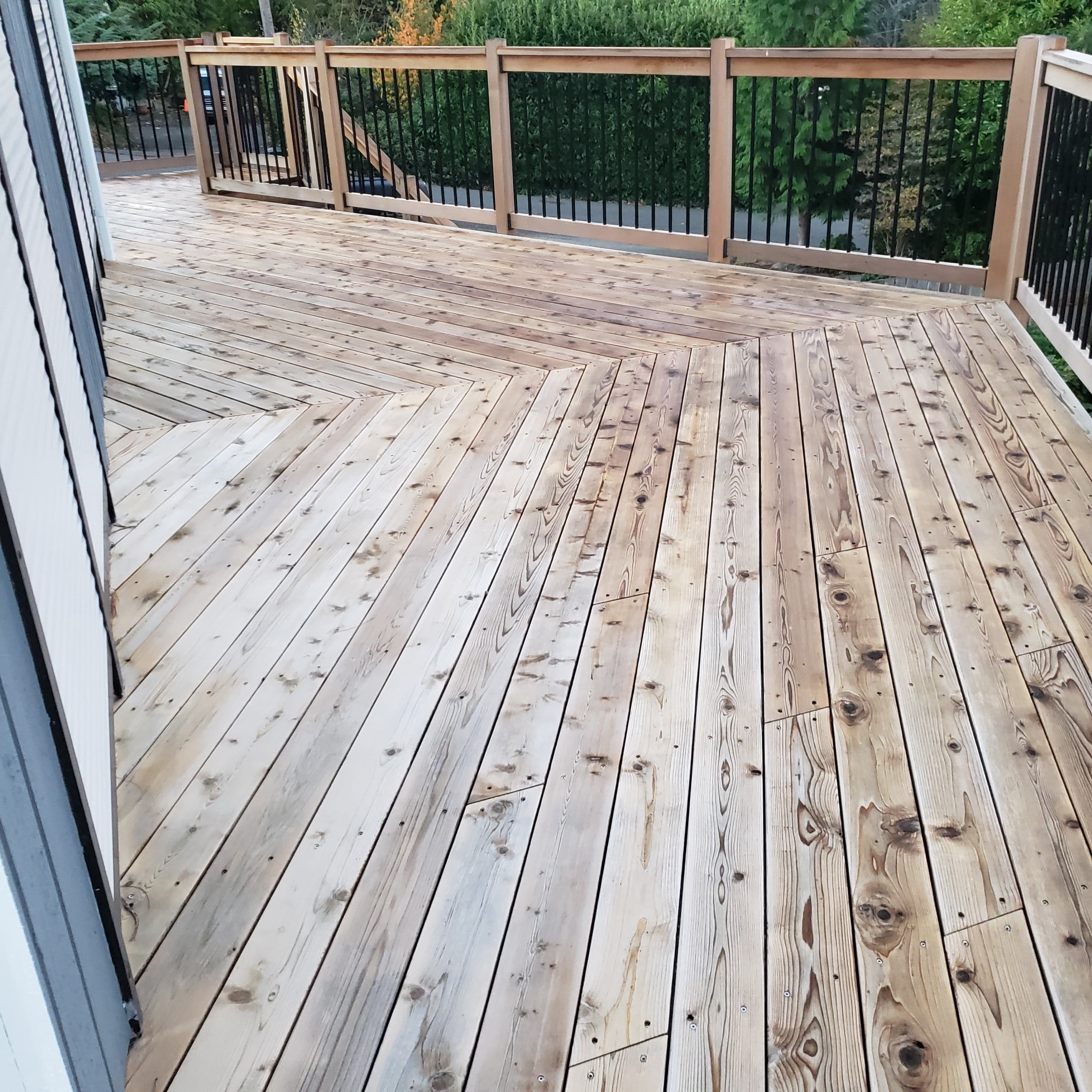

We would need to see pics posted to properly help you with the prep needed.

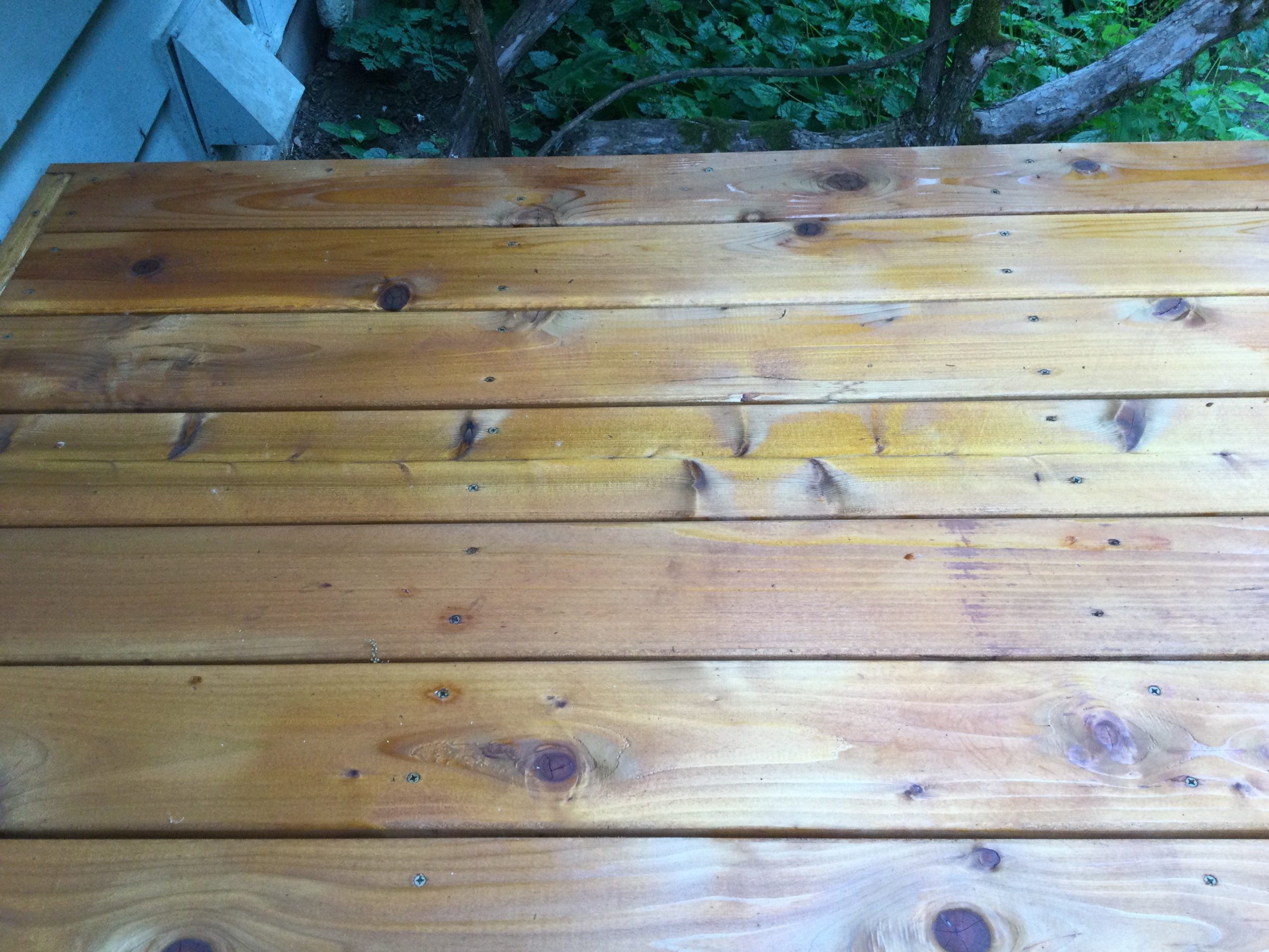

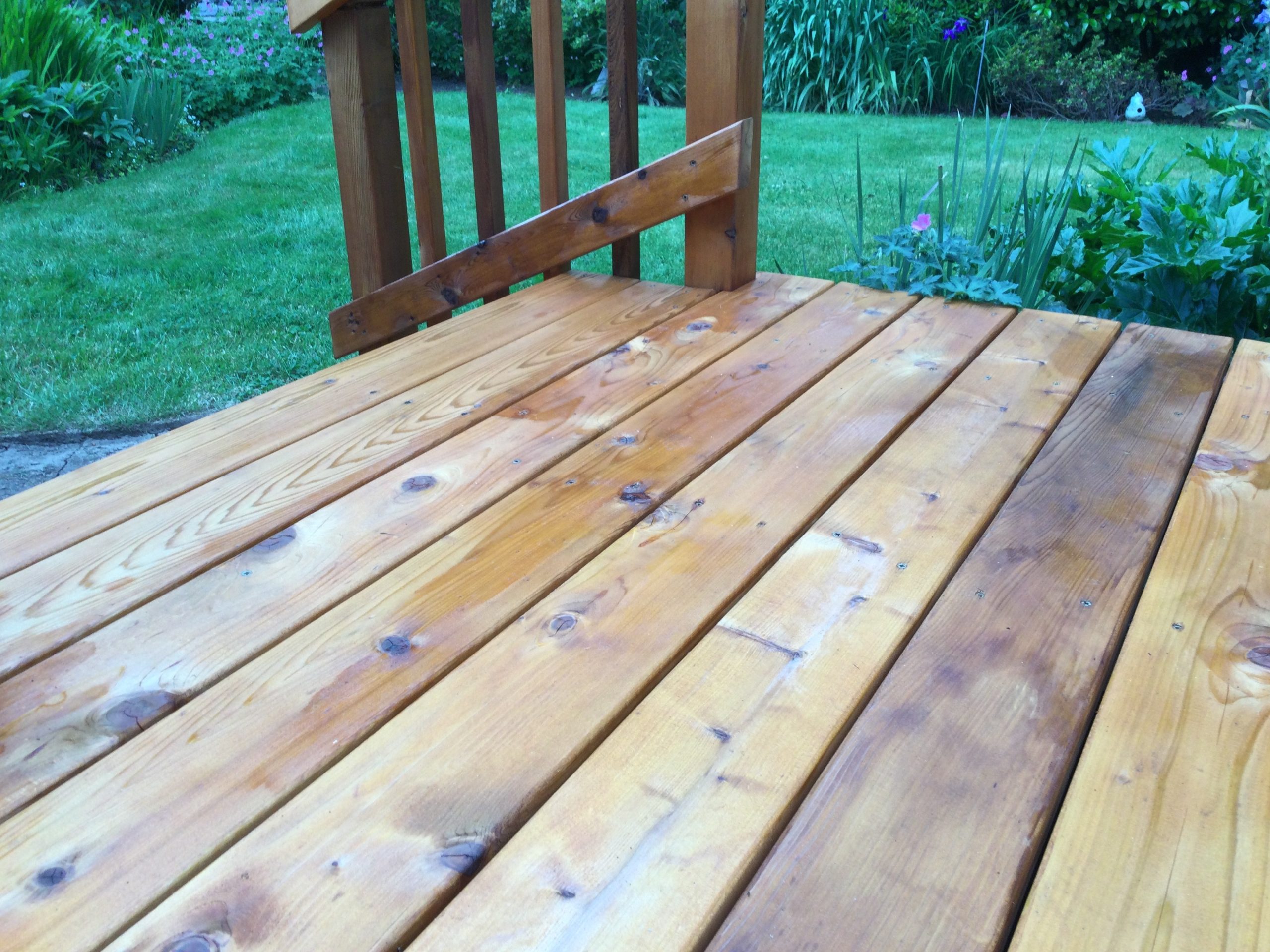

When the deck is wet it is ok looking with ALL the knots (I’ve been told they will fall out within 5 years😡) when dry it’s horrible. Light areas around every knot, blotchy, shiny areas.
Pictures finally attached
Actually, it looks normal with the knots. Knots stain lighter in color do the density of the wood there. They also do not fall out in 5 years.
If you want to remove and start over, use the RAD Stripper/Brightener Kit with bot additives:
So are you saying this “normal look” is not from letting the new deck weather before staining? If that is the case, don’t see a reason to strip, weather and redo in 2-3 months, if it will look the same. Right?
The knots being lighter in color is normal no matter if you weathered or not. The glossy areas are from not weathering the wood properly.
Thank you for your time and advice. Will just live with it until next year. Will look for a large outdoor rug🤨

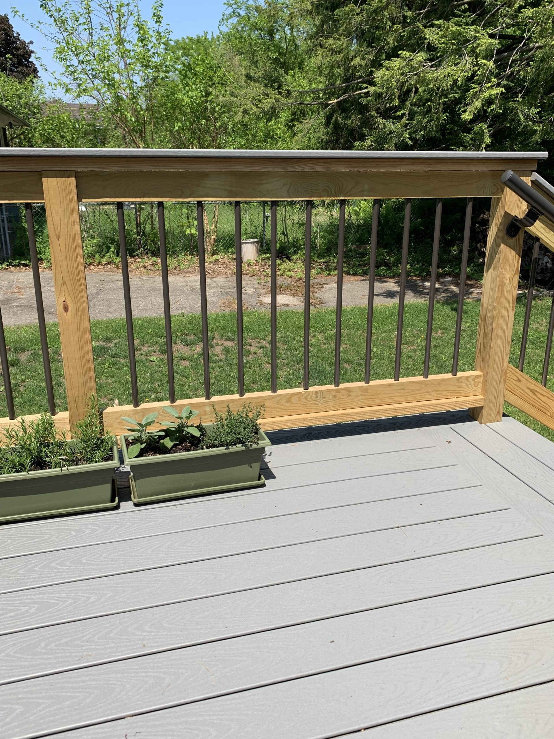

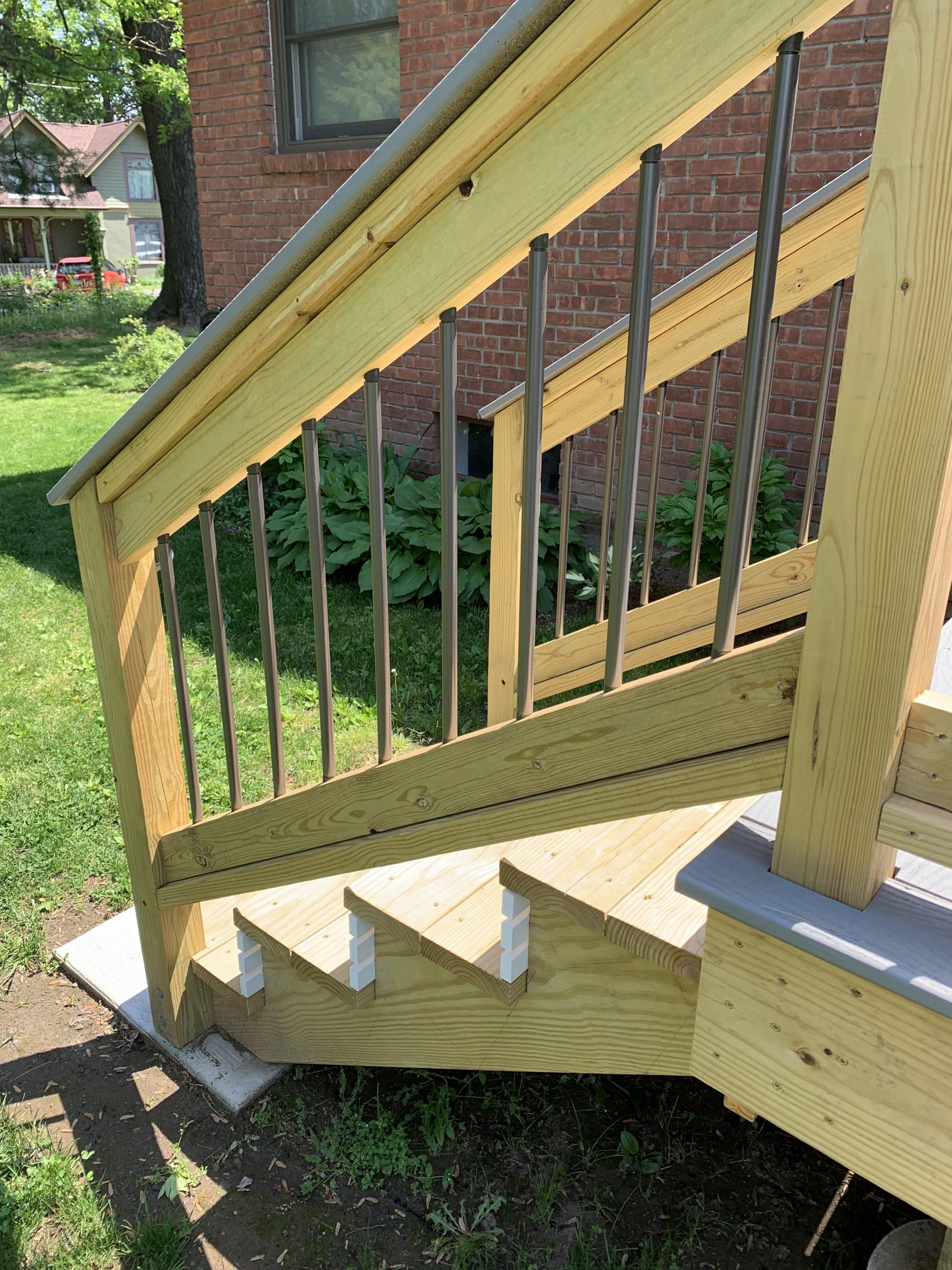

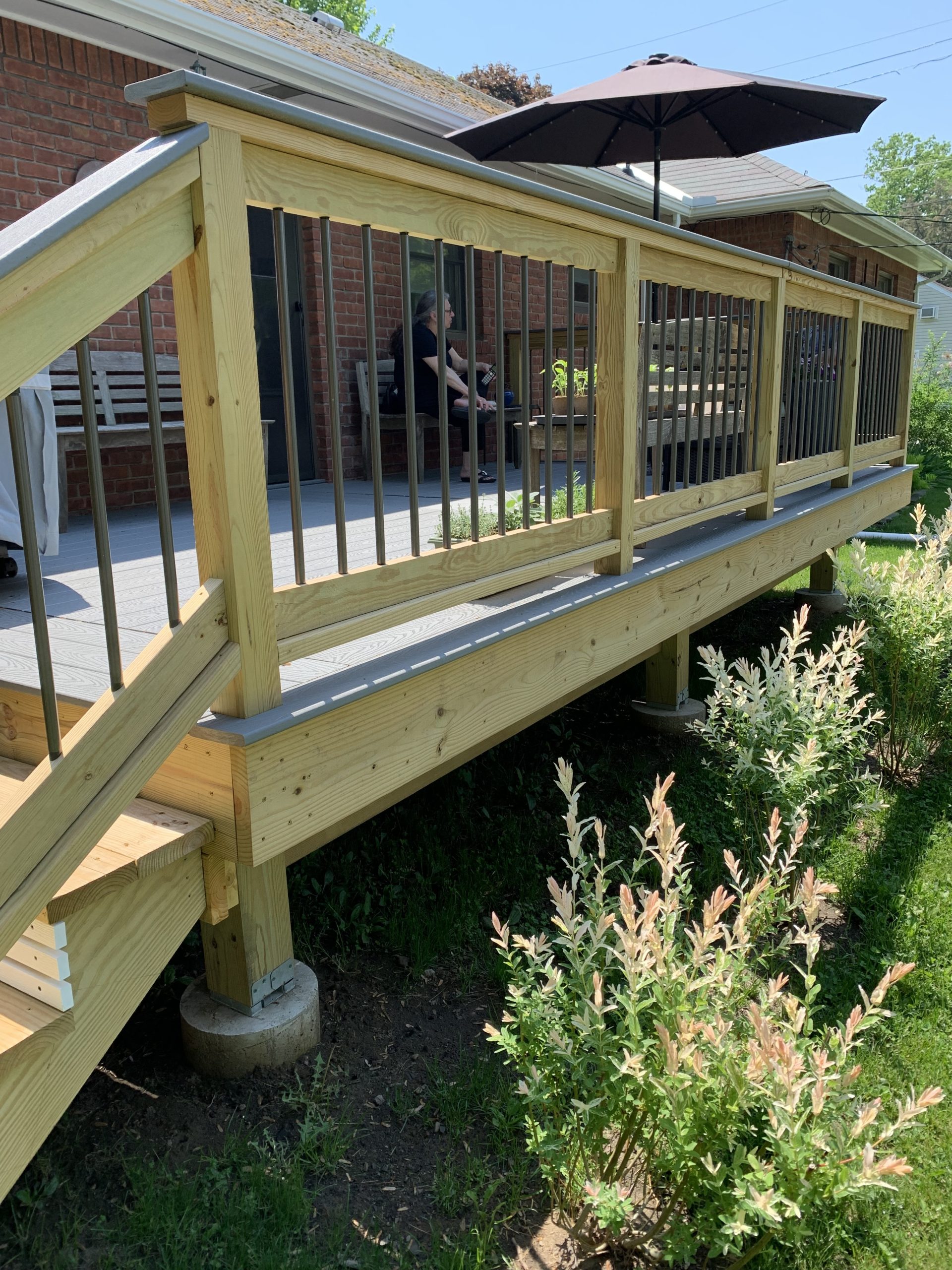

My new deck railings are pressure treated pine with aluminum balusters. I want to clean the wood prior to staining but am concerned that the cleaner may damage the balusters. Can anyone recommend a product that will remove mill glaze but not damage aluminum?
Post some pics of the balusters.
Pics as requested
The prep products will not harm those. Make sure to rinse with water when done.
Thank You for your quick response, much appreciated.

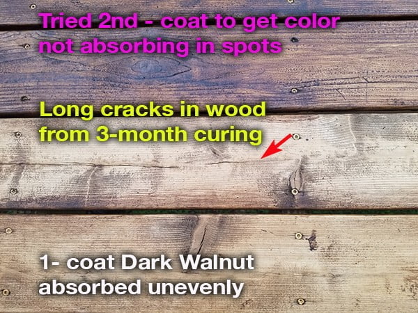

Maybe Restore-a-Deck is not for a novice. I waited 3-months to stain cedar. I followed the directions, used Restore-a-deck cleaner, then restore-a-deck brightener. The cleaner was washing up some small amount of gummy sap from wood, then I rinsed, The brighter became slightly foamy and opened up wood fibers making wood rough, soaked in for 15 minutes. I rinsed well. The next day wood is dry, so I stained it Dark Walnut. I think the chemicals made the wood absorb more in some areas and not in other. The deck is a blotchy mess and not the deep dark color I expected. I think all the chemicals ruined my wood. The product says not to paint a second coat. But it is not dark color.
My neighbor gave me Ready Seal to sample on my scrap cedar wood. Simple, easy without color gain if you go over an area and the wood did not get blotchy. Water beads up on the wood nicely. The color was not a deep dark walnut I expected. I plan on sanding my deck and stain with Ready Seal next year. I will not use the Restore-a-deck chemicals. Ready Seal is oil based and Restore-A-deck is water based. Will this be a problem?
It is easily used and applied by novices but you did miss some key steps in your process that caused your issues.
-When washing the Cleaner is removing mill glaze and graying/oxidation. The “sap” you saw was not sap but oxidized wood fibers that have to come off. This is normal and would happen with any prep product on a new oxidized deck. It looks like in your pics you did not fully remove the oxidation/graying before staining.

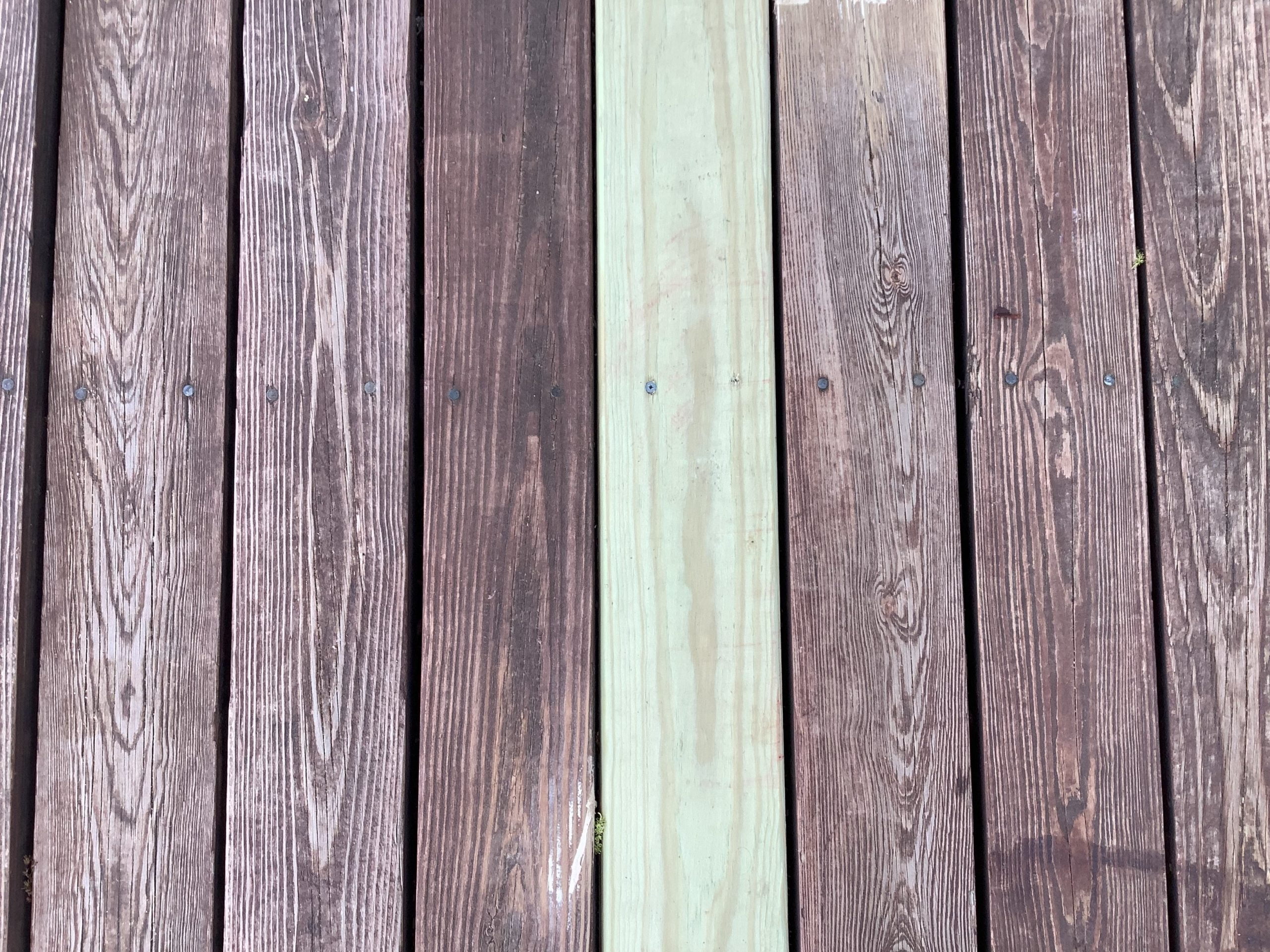

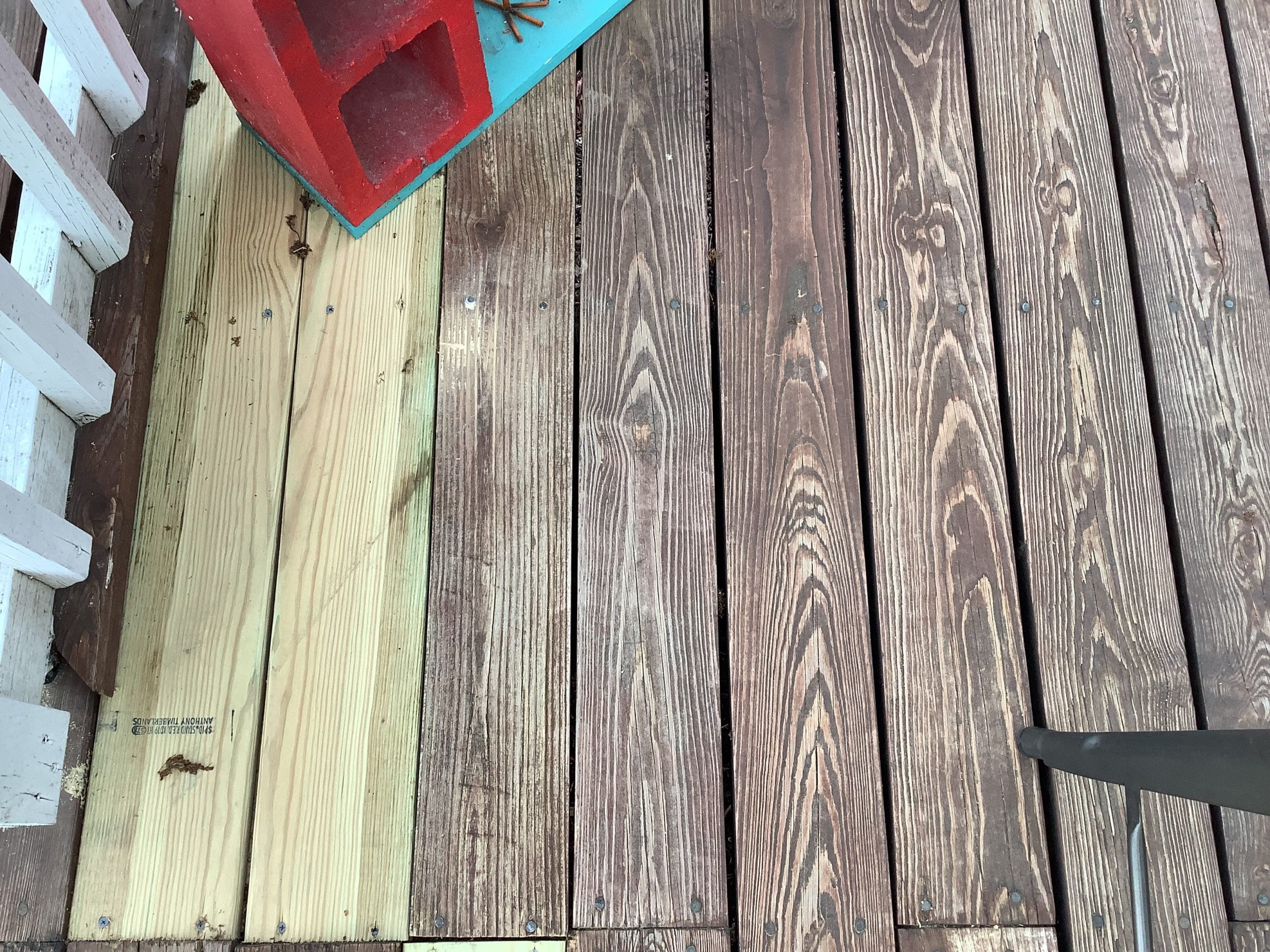

I scrubbed and cleaned our deck for the purposes of staining this spring but had to replace just a few boards. Should I stain like I planned and wait to stain the new boards or wait to stain the entire deck this fall? Deck is about 600 sq feet and I replaced 5 boards in random places. Thanks!
It would be best to do in a few months but since it is only 5 boards, you could strip and brigthen all now and then stain. Those 5 boards will need another coat in 6-12 months.
Personally, I’d stain but dodge the new boards and then begin their stain next year. If you stain using a brush, it’s easy to do just one board. Pressure treated has all kinds of chems that need to dry out and if you stain too soon, you’ll be fighting those new boards the rest of the life of the deck. I’m a rule folllower. Wait the year for those few boards.

Hi, I am having a 6×8 covered front porch and a 12×22 covered back deck added to my manufactured house next week. I had planned to pre-stain all the lumber before construction began, but after reading your articles, I see that I need to wait 4-12 months to let the lumbar weather. I still have a couple questions.
1) My floor and steps are being made out of trex, so it will just be the posts, rails and underneath of the floor and the roof that show through the 2×8 rafters. The underneath roof will be T111 to look like boards rather than plywood. Do I need to wait to paint those also?
2) I want to use a semi-solid stain and have it tinted to match my house and trim colors. Do you know if either of your recommended stains are tintable?
3) I live in Heber AZ 85928. If I cannot find either of your recommended stains or they are not tintable, what do you think of Behr or Valspar if they come in semi-solid oil or solid oil that is tintable?
4) I believe my builder is using a combination of douglas fir, pressure treated lumber, and laminated beams. If I use a semi-solid stain, are they all going to come out a different color?
Thanks so much,
Pam Barrett
1. Yes.
2. Tintable stains mean they will be opaque or solid in color. Not semi-transparent or semi-solid. For a good semi-solid with a wide color pallet, try TWP Semi-solids.
3. Behr and Valspar have some of the worst ratings and reviews on the site. Do not use them.
4. Yes, slightly.

Here is a photo of the deck in Brunswick Maine
Pressure treated wood deck, Brunswick Maine, built one year ago. It has not been cleaned, sealed or stained. I want to use ready seal pecan. I am confused as to what cleaner to use. I don’t know the type of wood it is. Should I wait until spring or do this now? What kind of cleaner should I use? First time doing something like this.
Thanks much,
Use the Restore A Deck Cleaner and Brightener Prep kits for this. Stain with a penetrating stain such as one in the above article.

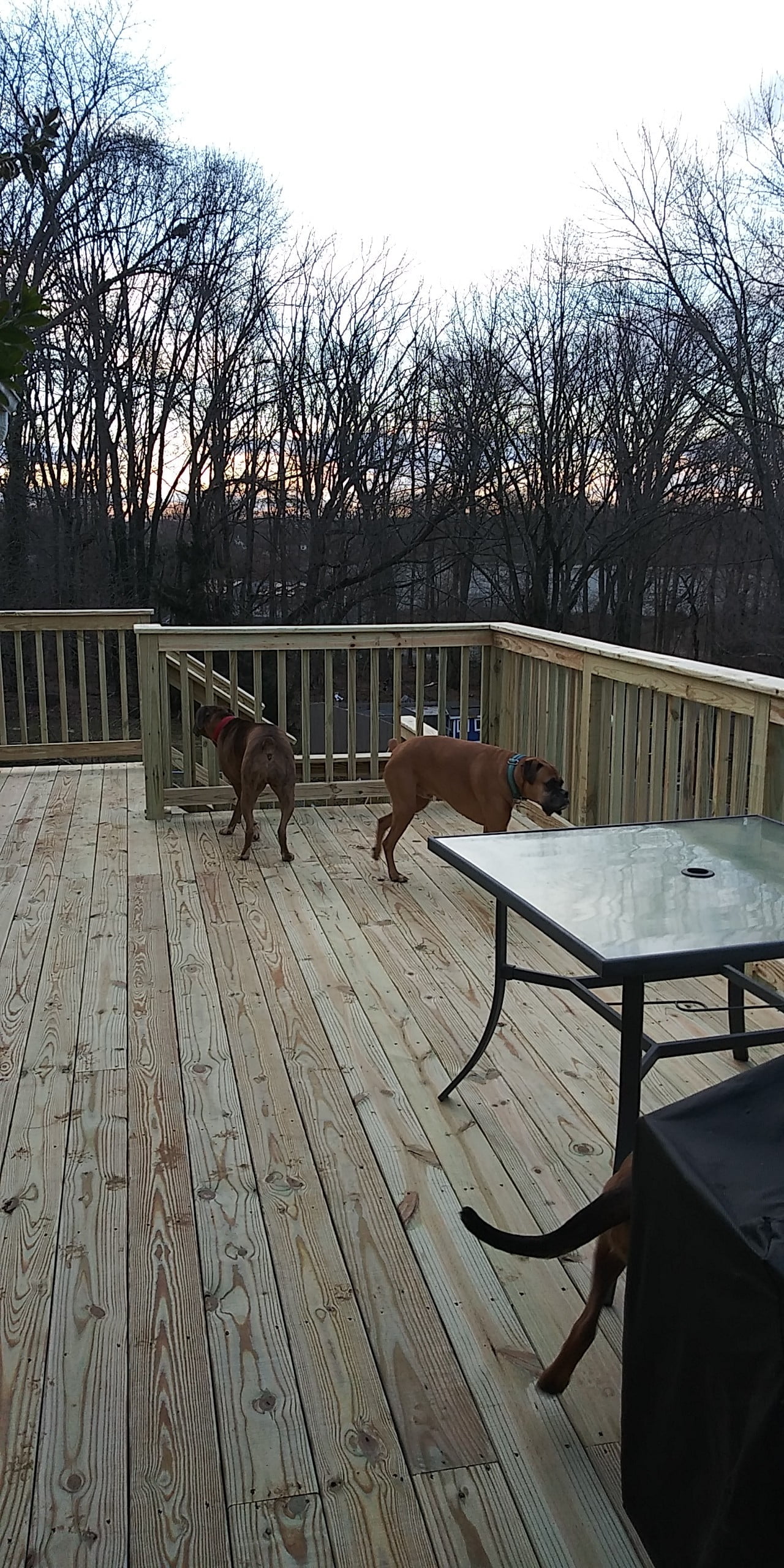

We had a new deck put up in early March. We are heading into winter. No beading of water now. There are a few dark spots and the deck is starting to lighten already.
I assume we will have to clean and brighten first.
1. Should we power wash first and allow to dry then use the cleaning kit?
2. I would love to keep it natural or actually a honey color transparent. Is it.possible to recommend a color?
3. Our biggest concern is that we have 3 large active dogs. I’m concerned about the damage thier nails can do. Is there a product or stain that would be best to use to add some protection.
Would transparent still be safe to use?
Do we sustain the lattice at bottom of deck?
I need to research my area here in Baltimore, MD to find a person to provide this service.
1. You use the cleaner while pressure washing. Brightener after.
2. Restore A Deck in Natural or TWP 1515 Honeytone.
3. No stain is immune to large dog nails. Does not matter the transparency, they will get worn away in high traffic areas.

Hi, We have just installed a new redwood deck, replacing the old one. I am concerned about the weathering process, from your instructions I should wait 1-3+ months for the deck to weather. I am based in San Francisco where we will soon hit “raining” season which is on and off from Nov-May, will this rain impact the new redwood deck or should I protect it when it rains ?
Pictures included of redwood deck.
Really like your site , very informative!
No issues, just wait until next Spring to prep and stain. It will be fine.
